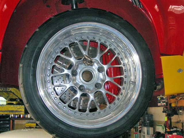

xitspd
post May 16 2005, 06:51 PM
Technology and Tradition 3.6 and 914-6
Posts: 1,305
Joined: 17-November 04
From: Foothills of Mt. San Jacinto, CA
Member No.: 3,136
Marv,
Picture attached is a 993 TT front caliper and rotor with a 17 inch rim.
Dan
