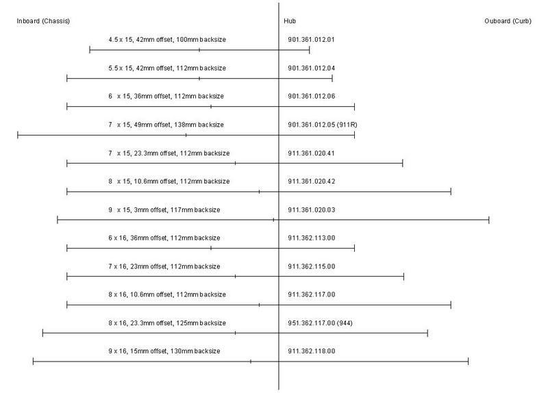

This chart shows the part number for the early 6x15:

Here you go:

5-lug Porsche Wheel Specs

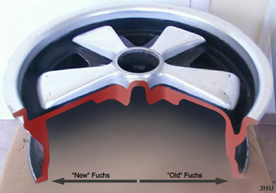

cool picture showing the differance....
Classic thread nomination?????
