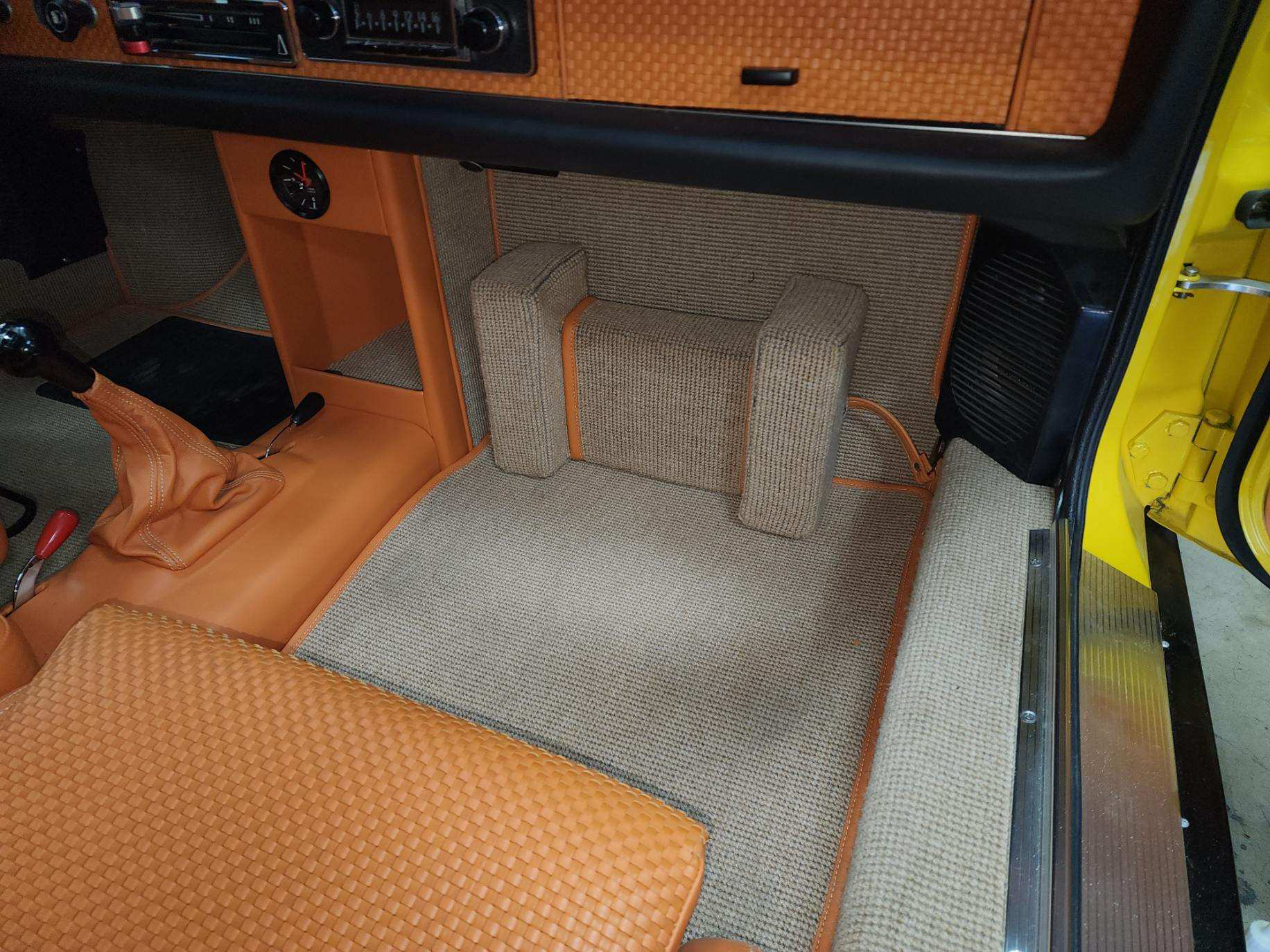

In my sights for the future is to install a square weave German carpet kit. (IMG:style_emoticons/default/beerchug.gif)
[/quote]
Just so you can see what that looks like in a six. German square weave made in Italy
Bob B

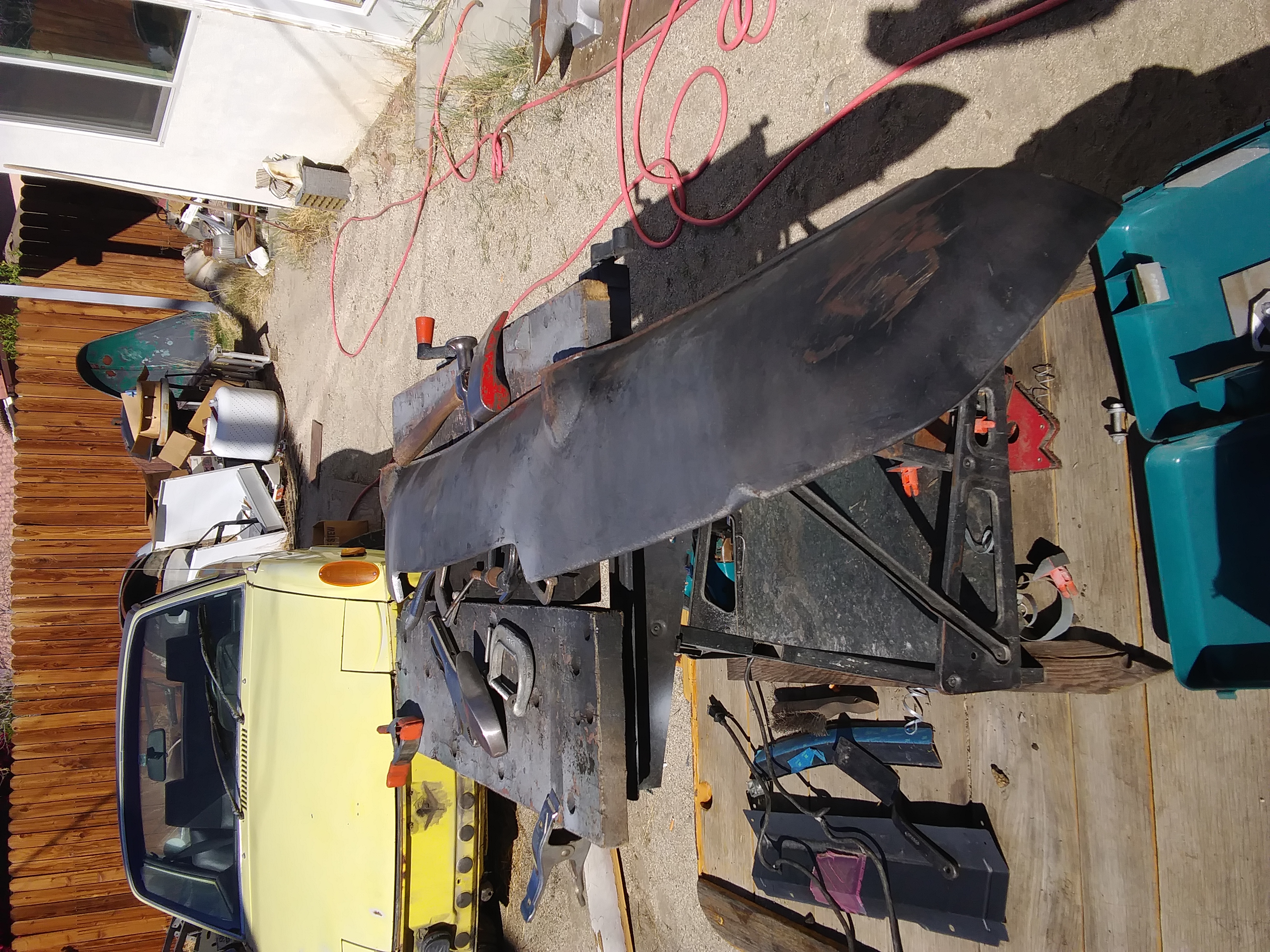

Bucci
post May 21 2023, 06:23 PM
Post #1831
Bucci
Posts: 121
Joined: 11-August 08
From: Carlsbad,Ca
Member No.: 9,407
@Cairo94507
If you have not modified your bumper, I highly recommend doing the oval cut out like Ferry Porsches 914-8…! I think it’s a classic look and you get more airflow, then the smaller square notch on just the valance.
I spent a lot of time 25 years ago folding the factory front sheet metal back to make right angles so there’s more rigidity/ structure in the nose panel after you cut the hole for the oil cooler.
Pics below.
Cairo94507
post May 22 2023, 06:37 AM
Post #1832
Michael
Posts: 10,766
Joined: 1-November 08
From: Auburn, CA
Member No.: 9,712
@Bucci - Thanks for the reply and the pictures. That is almost what we are doing. I traced the valance opening for an exact template and that is what the bumper opening will look like. A mirror image of the valance.

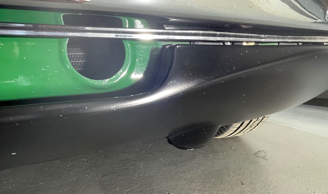

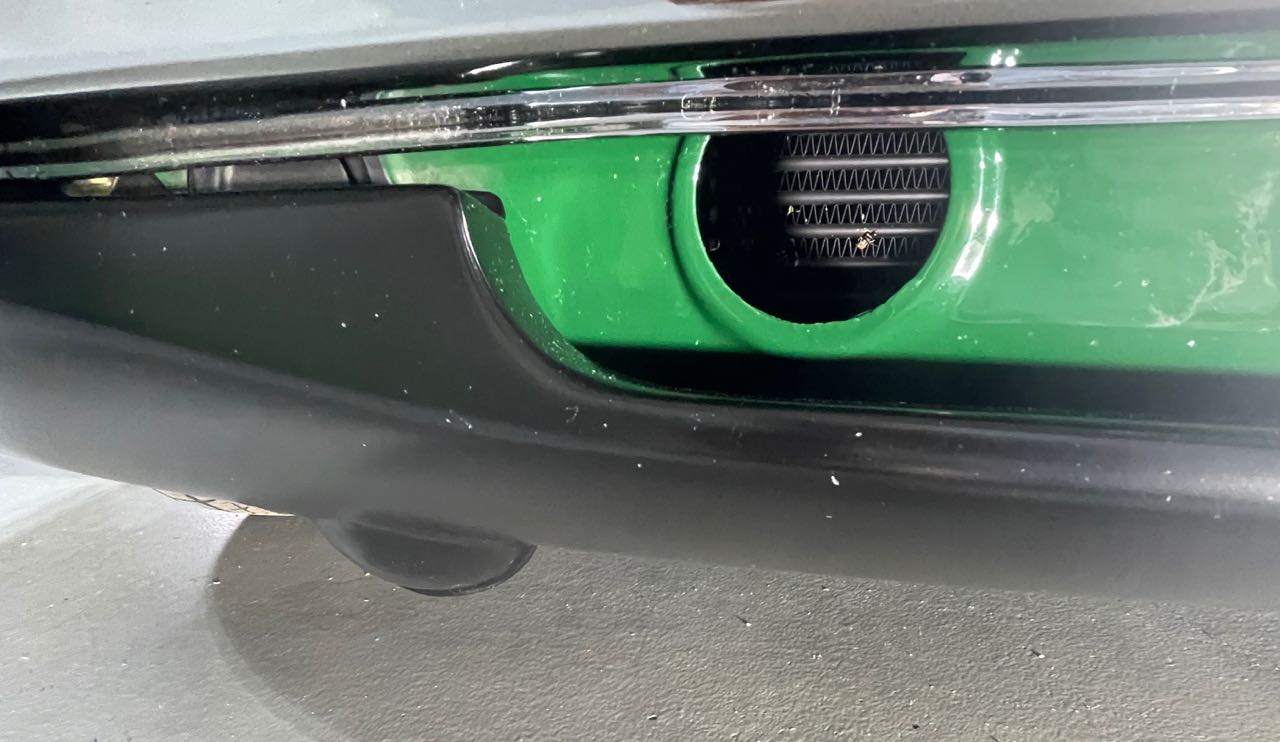

Shivers
post May 22 2023, 08:28 AM
Post #1833
Posts: 3,587
Joined: 19-October 20
From: La Quinta, CA
Member No.: 24,781
QUOTE(Cairo94507 @ May 22 2023, 05:37 AM) *
Hi, when I was doing mine I noticed that the cuts had a curve to them.
But from the front the opening looked straight.
Shivers
post May 22 2023, 08:32 AM
Post #1834
Posts: 3,587
From: La Quinta, CA
Member No.: 24,781
You can see the curve here. From the side it looks like a bit of a frown.
Will mirror image give you the effect you want. Just an observation

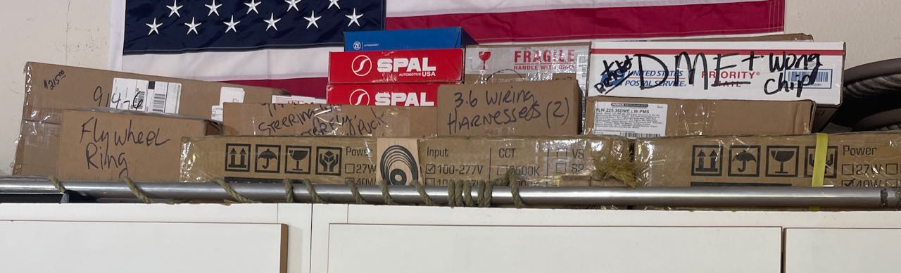

OK, I know.... why mess with this car? The 3.2 runs great and I am very happy with the performance and reliability. It starts every time and just runs great. Of course, then I had to come across Chris's for sale ad for the '95 3.6 motor with only 18K miles on it. I tried to resist, and did for a couple of months, but found myself constantly looking (and hoping) someone would buy that baby. I guess it was meant to be that it would end up in my garage slated to go into my car.
We plan to pull the 3.2 out toward the end of October and begin the process of getting everything right for the 3.6 to thrive. I have bought quite a bit of stuff from Patrick Motorsports so when the time comes, we should have everything we need to just install, wire and fire it up. What could go wrong, right?????
I have the 3.2 listed for sale here and on the Pelican site.
http://www.914world.com/bbs2/index.php?showtopic=367139
For now, here is a picture of the 3.6. (IMG:style_emoticons/default/wub.gif) :
And here is shot of some of the parts; can't wait to get to it:
