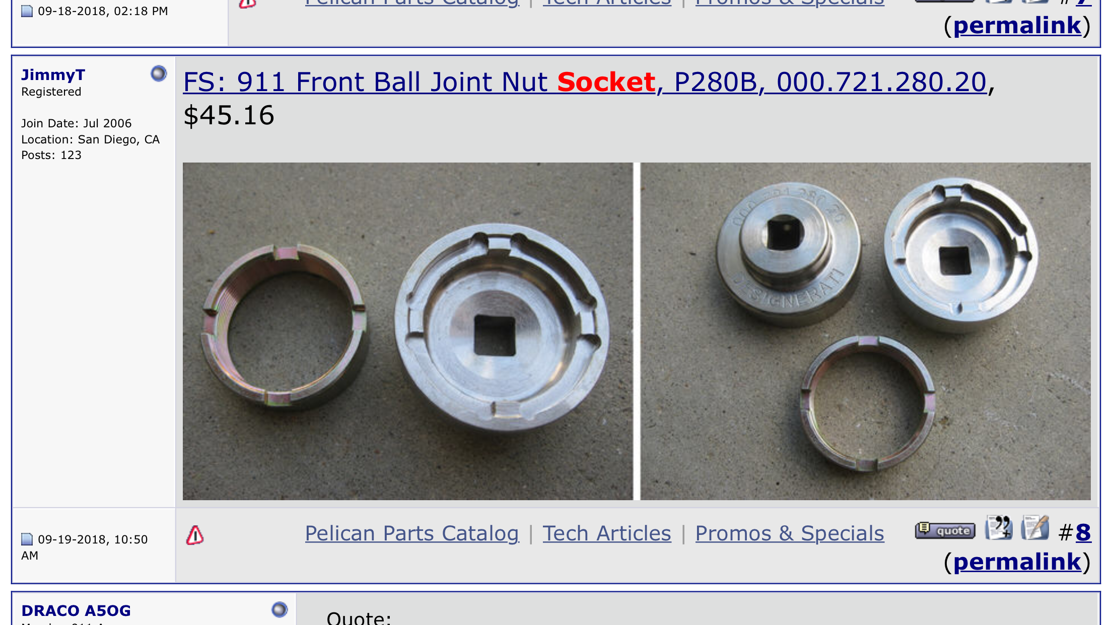

as the title states what is the best way to remove the ball joint from the control arm with out the proper tool?

theer   Try heating the housing (with a torch) then hold o...   Jul 28 2017, 04:34 PM
Optimusglen   He's wondering about the ball joint from the c...   Jul 28 2017, 04:34 PM
toolguy   do you mean the steering tie rod to strut? Pickle...   Jul 28 2017, 05:14 PM
Mark Henry   The round 4 slot nut on the bottom? There's a...   Jul 28 2017, 06:21 PM
Mark Henry   I think it's this one https://www.amazon.com/P...   Jul 28 2017, 06:28 PM
rgalla9146   The one that does the steering is a tie rod end. ...   Jul 28 2017, 06:49 PM
mepstein   Buy the proper tools. The pickle fork is cheap. Th...   Jul 28 2017, 06:59 PM
Mitox   Just buy the tool. As stated earlier they're ...   Jul 28 2017, 06:59 PM
porschetub   Buy the tool,really not expensive,if you own a 914...   Jul 28 2017, 07:08 PM
rgalla9146   OOPS, I just checked at Baum tools. It is n...   Jul 28 2017, 07:09 PM
Valy   The tool won't get that crown nut out. Use a b...   Jul 28 2017, 07:48 PM
mepstein   The tool won't get that crown nut out. Use a ...   Jul 28 2017, 08:12 PM
cary   The tool won't get that crown nut out. Use a...   Jul 29 2017, 08:17 AM
914Sixer   Make sure you soak the nut in PB Blaster overnight...   Jul 28 2017, 08:21 PM
mepstein   We use a lot of liquid heat at the shop to remove ...   Jul 28 2017, 08:41 PM
tazz9924   i got in on and off real good with a pipe wrench a...   Jul 29 2017, 02:01 AM
