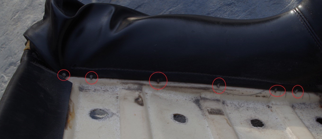

Here's a helpful link with pics...
http://www.914world.com/bbs2/index.php?showtopic=71844
I've done 4 seats and the tips I can add are...

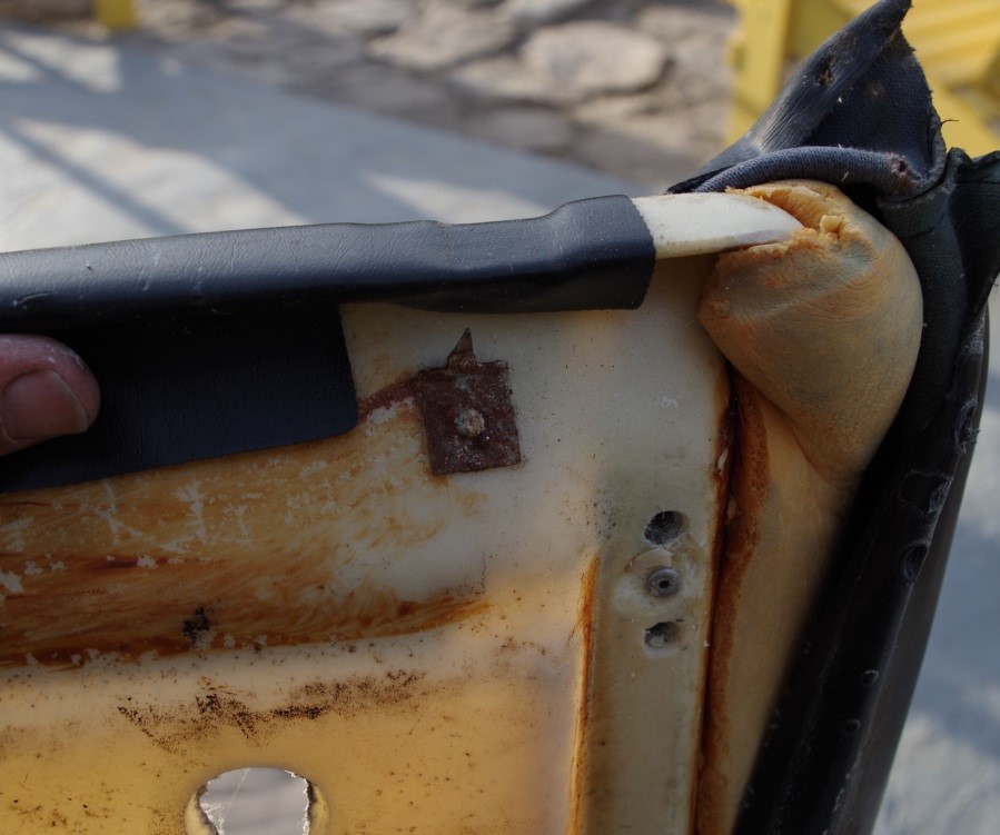

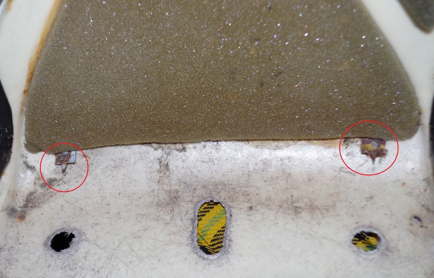

-be careful bending the barbs. They're sharp and love to stab you. They're also NLA so be gentle.
- also use caution on the bottom two barbs closest to the rear of the seat. They're held in place with pop rivets and the fiberglass around them can be crumbly.
- get yourself some 1/2" open cell upholstery foam. You'll need it for the lower sides, which are definitely compressed by now. Otherwise you'll have wrinkles.
- put some plastic wrap over the foam as you slip the bolster on to help it slide.
- heat the bolster material in the sun to get it more pliable.
- use a good strong contact cement for the top "ears"
One final note...you'll notice that the new material is considerably thinner than OEM. From what I'm told, thicker is available, but the texture isn't right. So we have to deal with correct looks, but a tougher install since the foam really needs to be full for the bolster to fit tight. It's doable. You just need to take your time. Good luck and PM me if you need help.

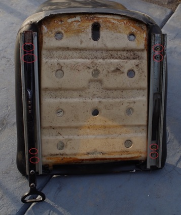

Remove the 4 allen bolts with washers and set aside for later. The seat adjuster handle need not be removed unless you are replacing yours. There is a short pictorial how to on this thread on world -

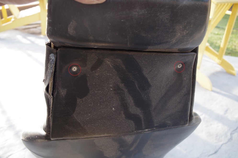

Start by removing the 2 screws on the back of the seat at the headrest flap.
This will allow you to get at 2 hidden screws that hold the base of the headrest.

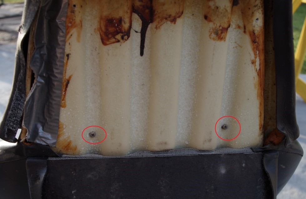

At the base of the seat there is a wire that holds it down, you will need to dislodge the wire to allow the center section to come up, if not out.
There are 2 pointed prongs at the base that hold the wire on the base of the center section securely at the base. I chose to carefully bend these up using the standard flat screwdriver. You can then pull the base down to release.

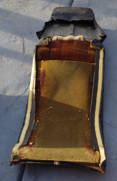

This will leave you with the center section ready to remove. The headrest tilts slightly back to allow it to come off the fiberglass top that it molds around.

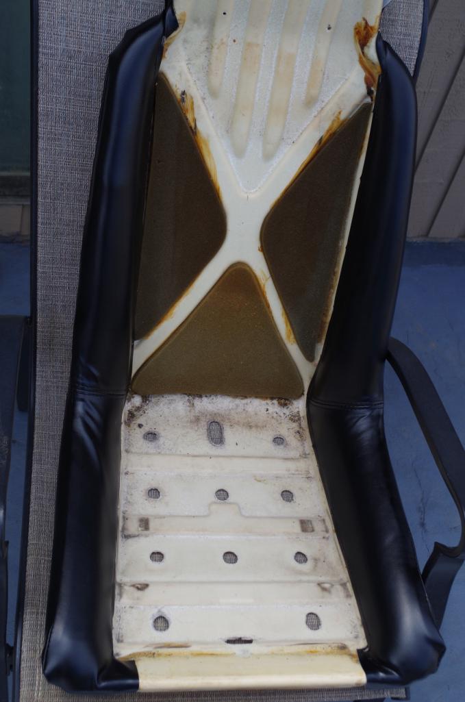

With the center removed you can now have full access to remove the side bolsters.
You will want to start with the hidden prong under the front base of the seat.
Mikey914

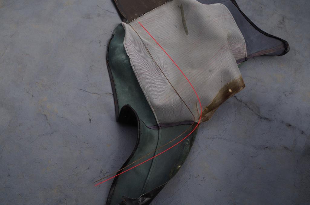

Once removed you will need to harvest the metal from the old piece. This is most easily done using a small sharp knife to cut the stitches.
Mikey914

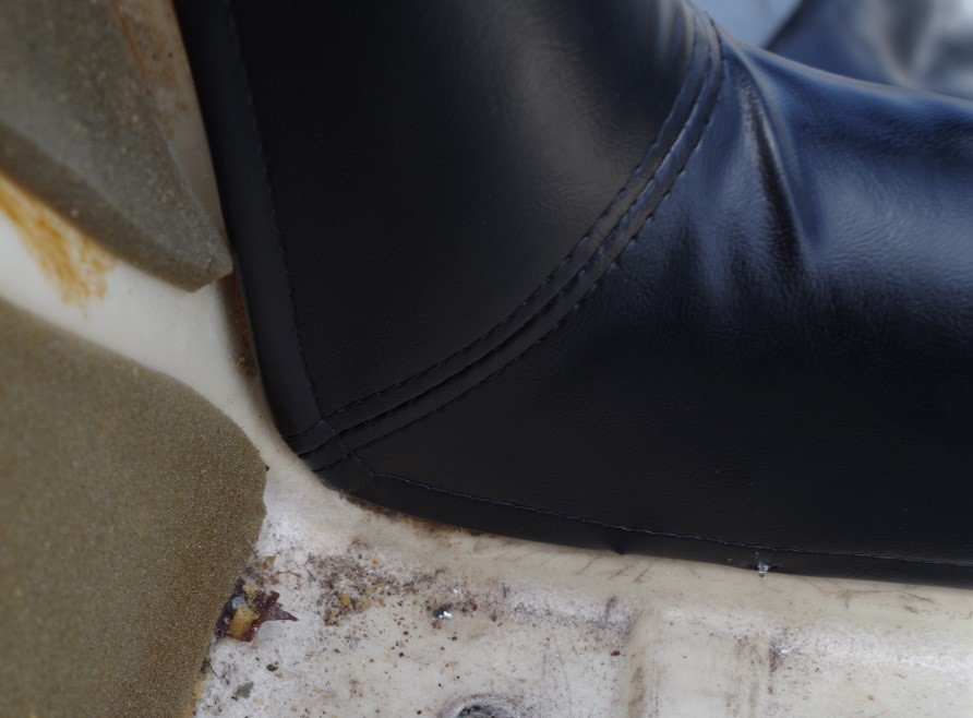

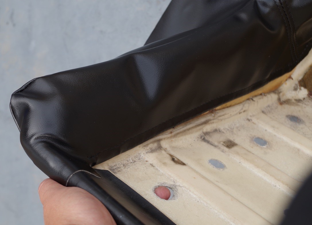

Each side has one. Once removed, you will need to thread into the new section. Make sure the loop on the metal is at the top by the headrest, so you will feed the un looped section through from the top. This takes a little patience, and when you get to the corner you will need to be gentle as the path is more restricted and more difficult to find. With a little probing, you will be able to get it through.
Mikey914
post Aug 11 2017, 03:41 PM
The rubber man
Posts: 12,772
Joined: 27-December 04
From: Hillsboro, OR
Member No.: 3,348
Once you have the metal in you can begin the reassembly.
I supported the seat in a folding camping chair as I found it worked well to get it to a level that I could work and was readily available.

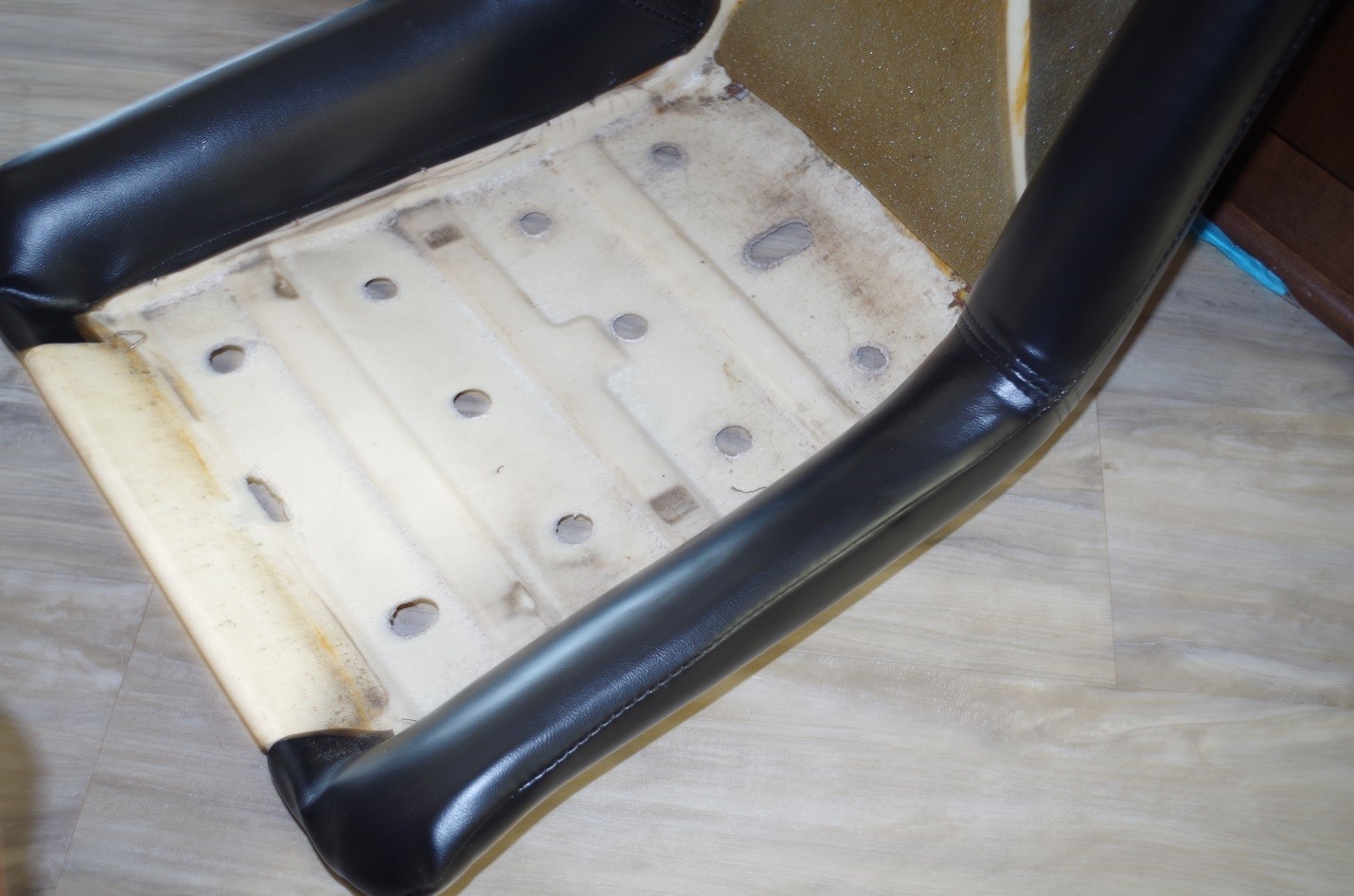

I started at the front base and secured the first 2 prongs on each side Making sure that I had the same amount of material on each side.
Mikey914
The rubber man
Posts: 12,772
From: Hillsboro, OR
Member No.: 3,348
I then proceeded to work my way back trying to keep the material even on each side.

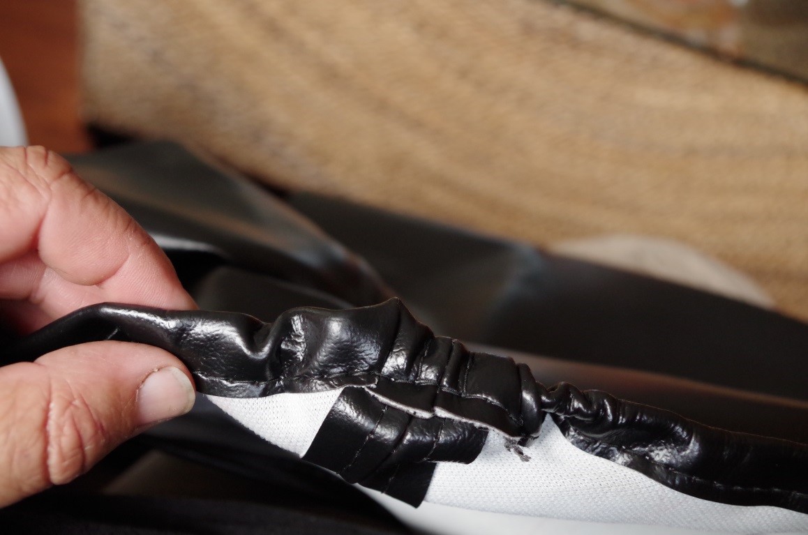

Continue up the side slowly making sure that you are securing it evenly as you progress. The fold on the seam in the last picture will stretch out, but your work here makes that much easier.
When this step is finished yours should look something like this.

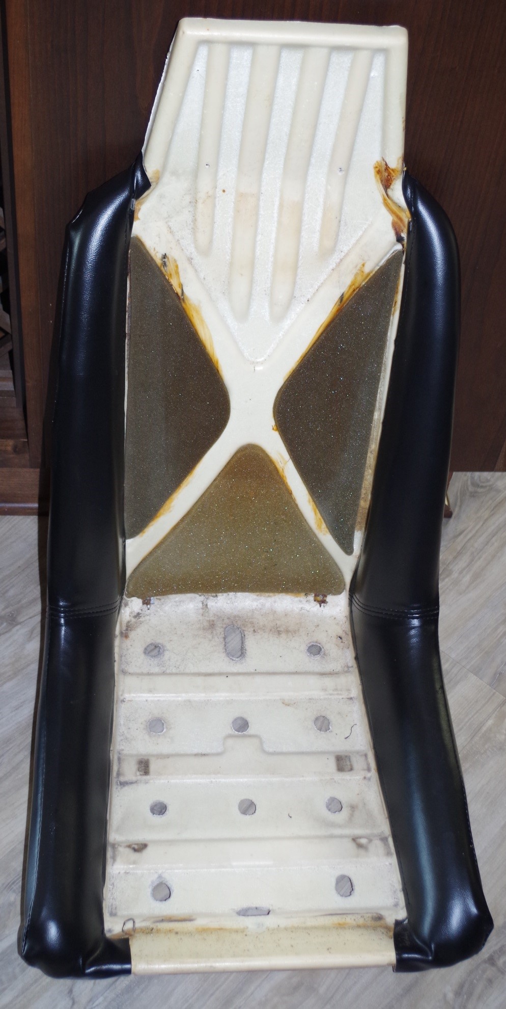

Now is the best time to secure the base back on as you will be using the contact cement to tension the vinyl. I prefer the Camie 313. Once tensioned and glued, re attach the based. Your completed product thus far will look like this.

Really nice fit on those replacement covers Mark great job,my seats are in great condition but the drivers side in particular was a bit baggy,I found a few of the metal spikes had pulled out where the rivets go into the fiberglass.
It was a bitch to fix them but when refastened properly then whole edge of the fabric tightened up on the internal wire....problem solved.
Is it hard to contour the floor vinyl around the edges ? I presuming its fairly thin for this reason or atleast whats left of mine appears to be thinner than say the seat material.

Not too hard to contour. We are adding slits like the OEM on the part that covers the adjuster "bar" on the floor area. It will make folding the edges up like OEM easy (you don't have to cut).
