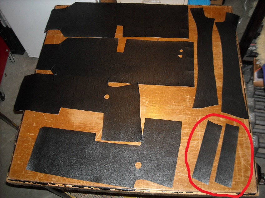

Installing my interior and saved all the old pieces for patterns. But I don't know where these two pieces go. The markings on the old ones are really no help.
car did not have a console or deposit box.

I'm pretty sure it's the front of the crossmember under the seats. Just to cover the paint/transition at the end of the carpet.

Don't they glue to the top edge of the back wall at the outside shoulders of driver and passenger ?

QUOTE(rgalla9146 @ Aug 11 2017, 10:14 AM) *
That would be the longer strips above the red circled ones. Mine actually wrap around the seam and are secured by glue and the door seal.

(IMG:style_emoticons/default/agree.gif) Mark has them both right.
Test fit those short pieces & they should wrap perfectly on the front of seat cross member, just between the raised areas on the side, then mark & mask the floor so you can spray that surface neatly without too much overspray clean-up afterwards (assuming you're using one of the 2 surface spray adhesives like 3M 77, 90, etc.).

Mark is right about the ones above the circled pieces, they mount vertically and wrap around the door pinch weld.
The ones that cover the crossmember have notches for the seat recliner tooth piece. They are the upper left pieces

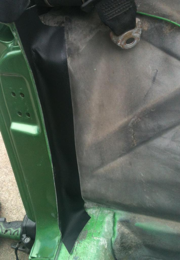

Attached is a picture of my old rotten 1970 interior showing the last visible vestige of the rectangular piece in question.
Dimensions may help.

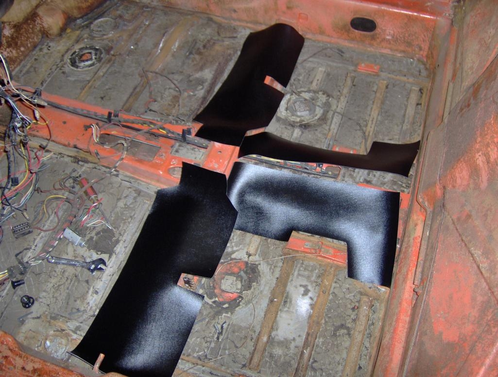

These go like this
Matt may have a better picture of the seat belt area.
These come up more often with the carpet replacement as most are gone or in poor condition. A detail that really finishes out the interior

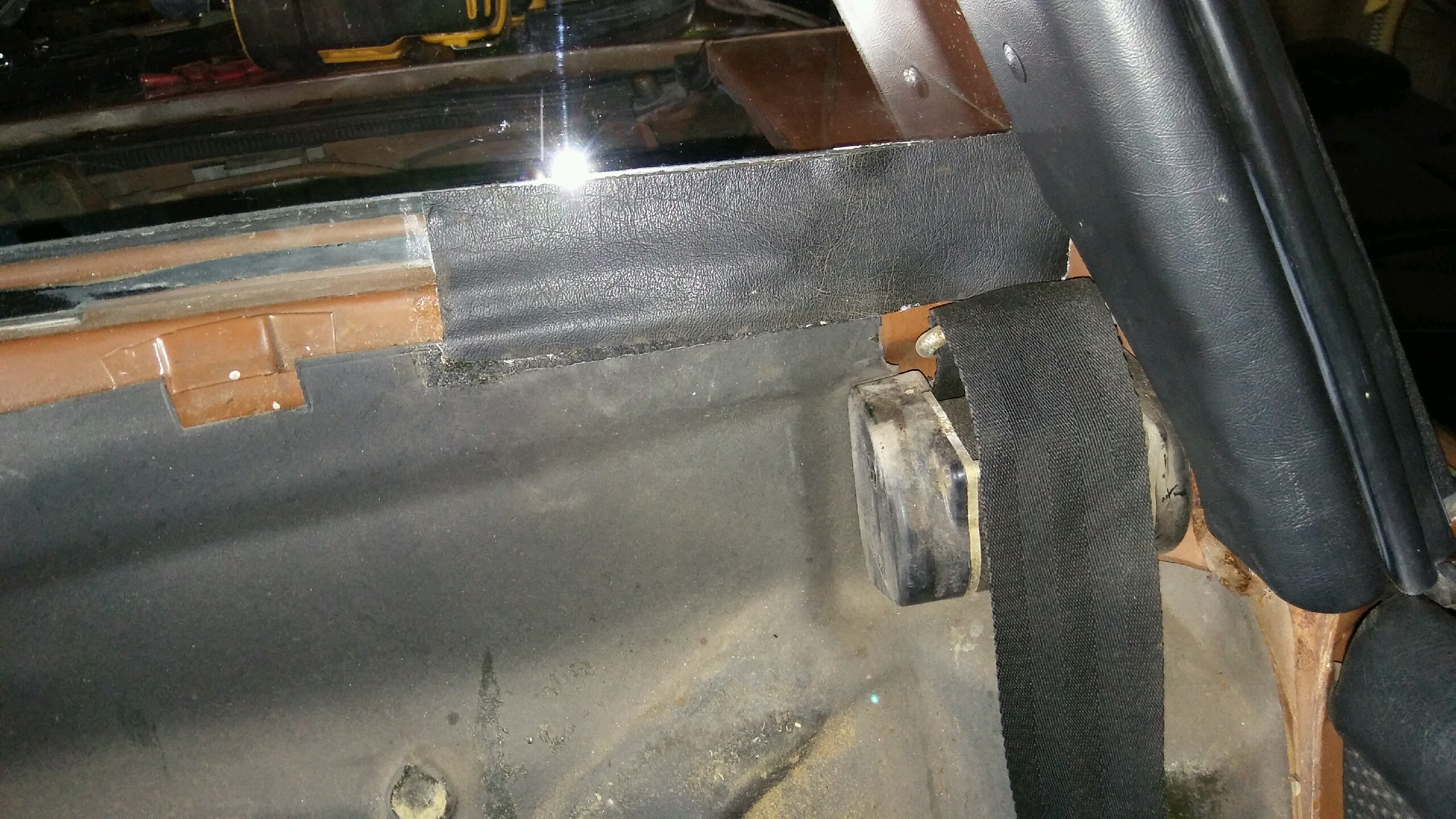

Matty900
post Aug 11 2017, 09:57 PM
Posts: 1,340
Joined: 21-February 15
From: Oregon
Member No.: 18,454

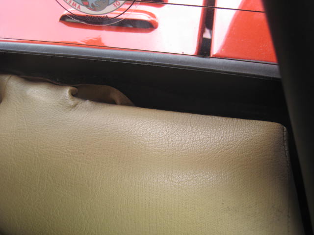

They go in the area below the rear window that you can see behind the back pad.
Matty900

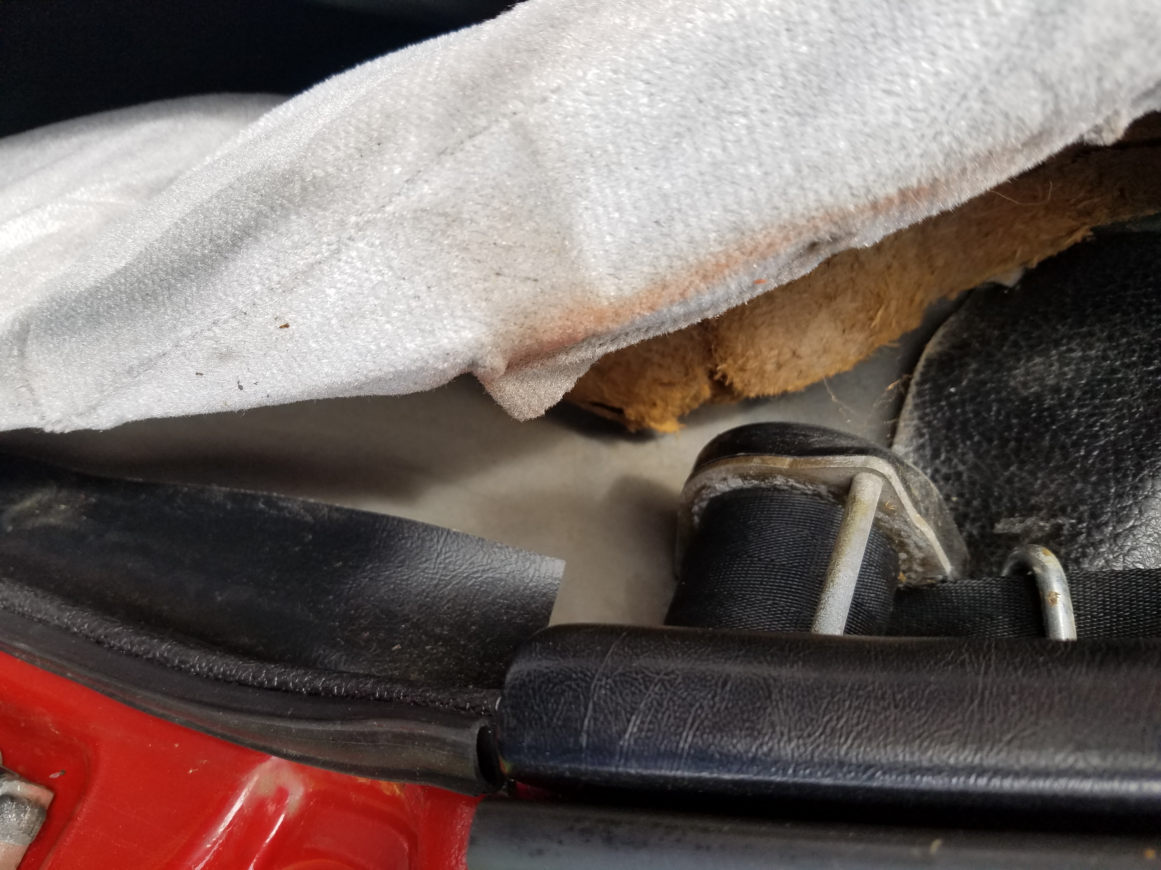

Member No.: 18,454
Here's another one
Matty900
post Aug 11 2017, 10:00 PM
Posts: 1,340
From: Oregon
Member No.: 18,454

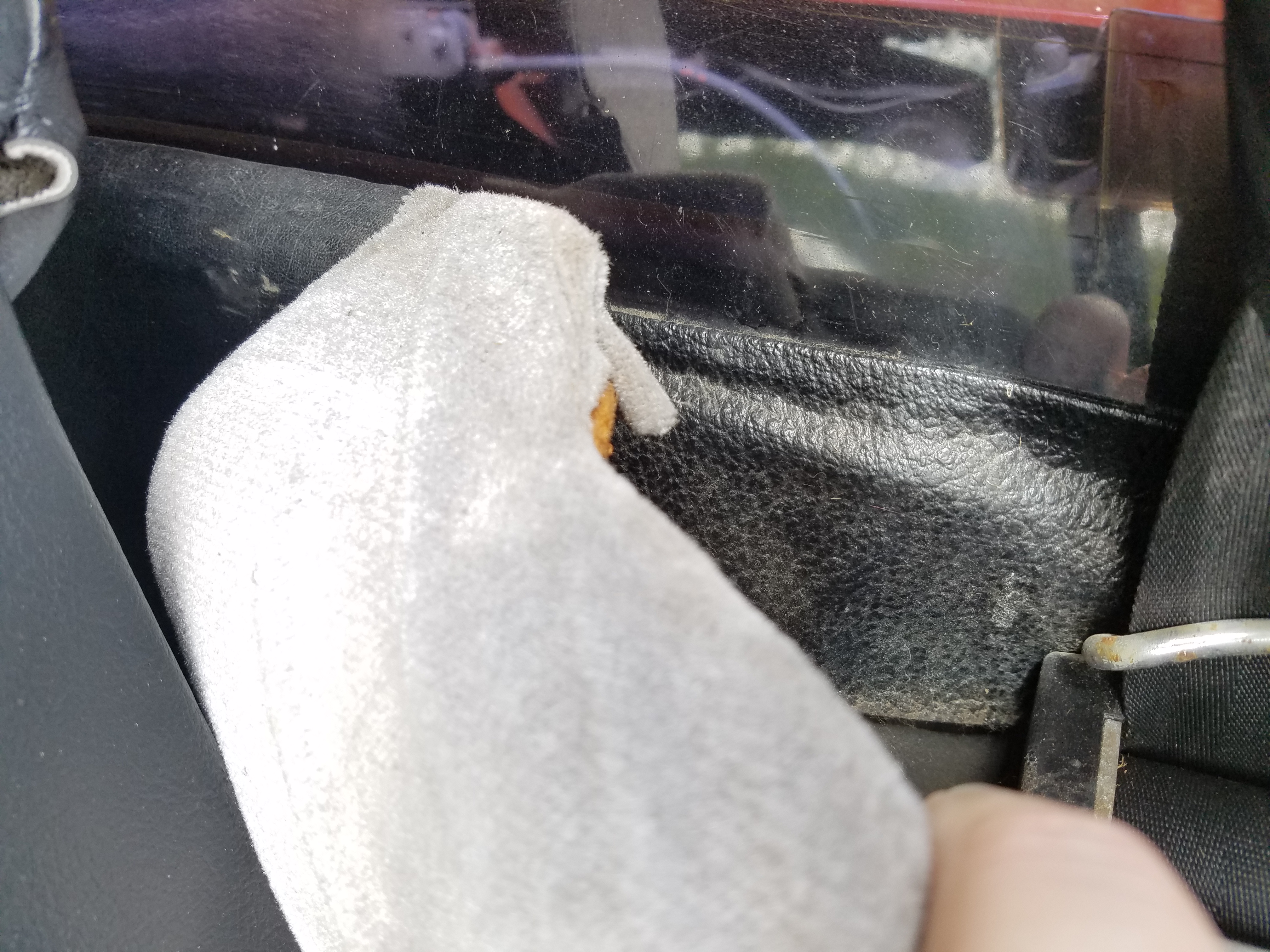

A customer sent me this photo. It was the 1st time he has seen it and had done 7 cars

Olympic 914
post Aug 12 2017, 06:50 AM
Posts: 1,795
Joined: 7-July 11
From: Pittsburgh PA
Member No.: 13,287
QUOTE(Matty900 @ Aug 12 2017, 12:00 AM) *
That is the picture I needed. Looks like this is where they go.
Thanks much...
