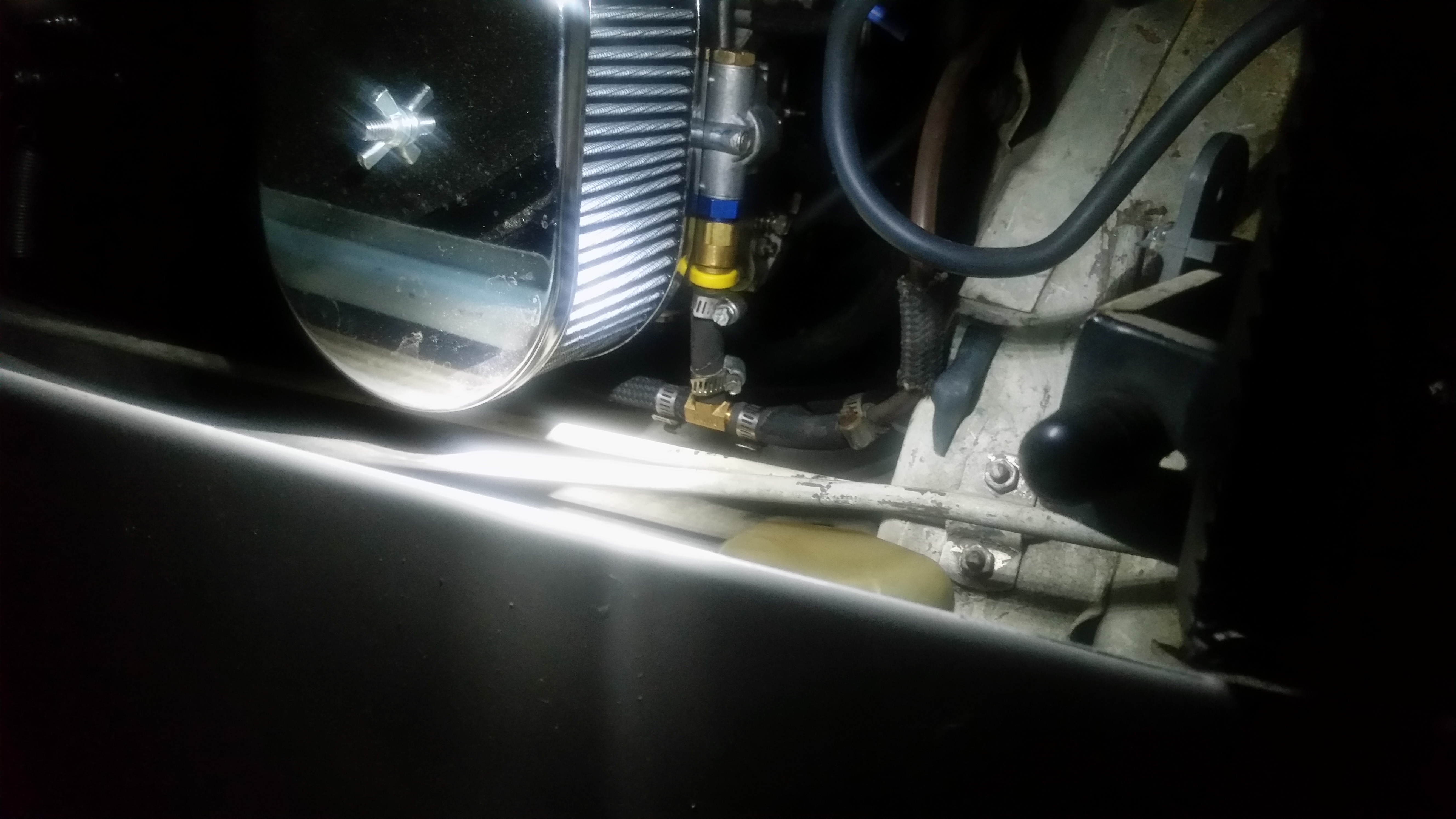

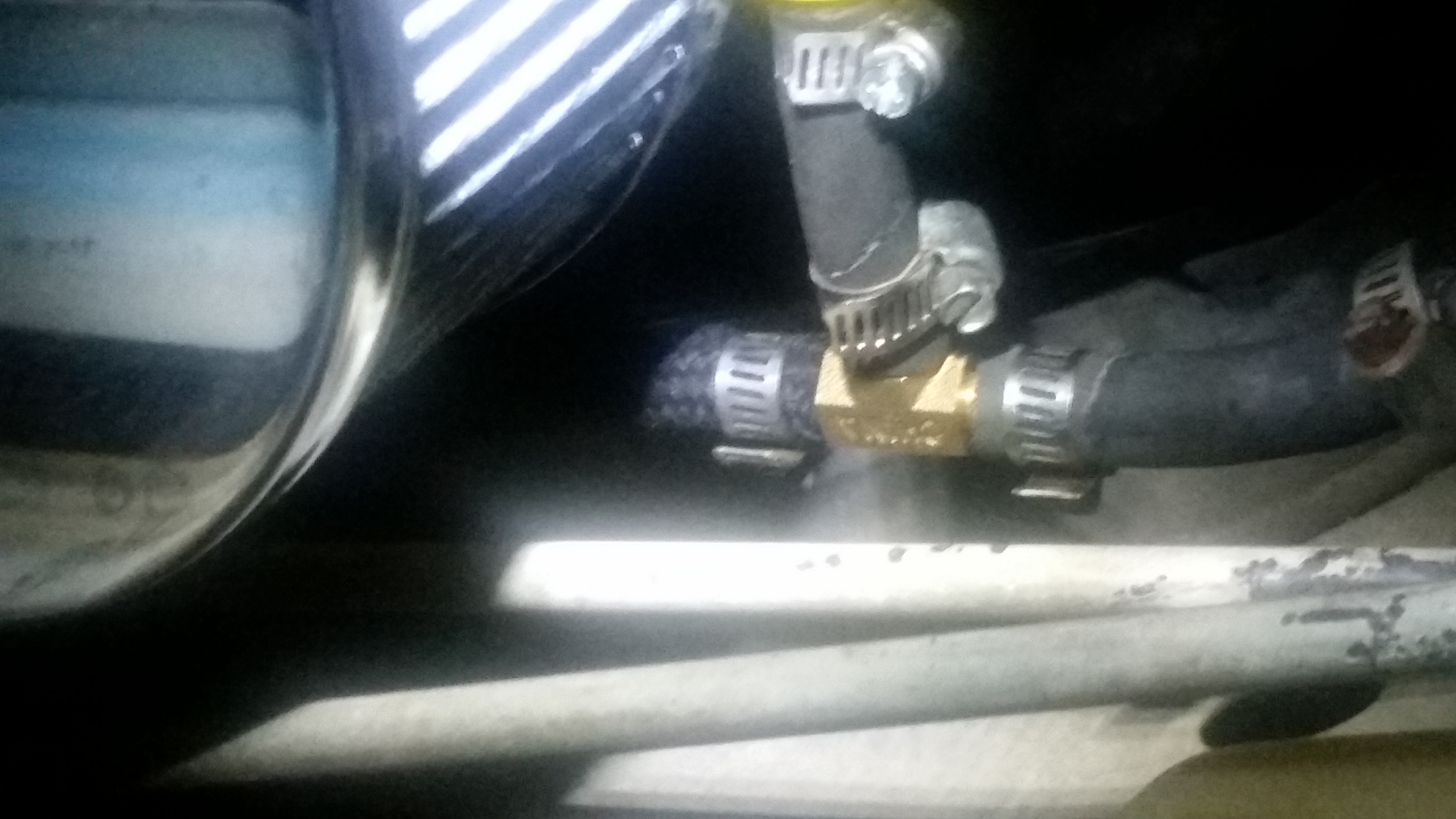

Its get wet around the
Gold tee and surrounding 3 closest clamps
And will drip a nice puddle but as soon as the car is running driving
Drip go's away , even after turning off the car and restarting
Never comes back until the next sunday drive .
But then there it is again
Bolt clamps are swiveled around

It get soaked in gas dripps a little then seals up

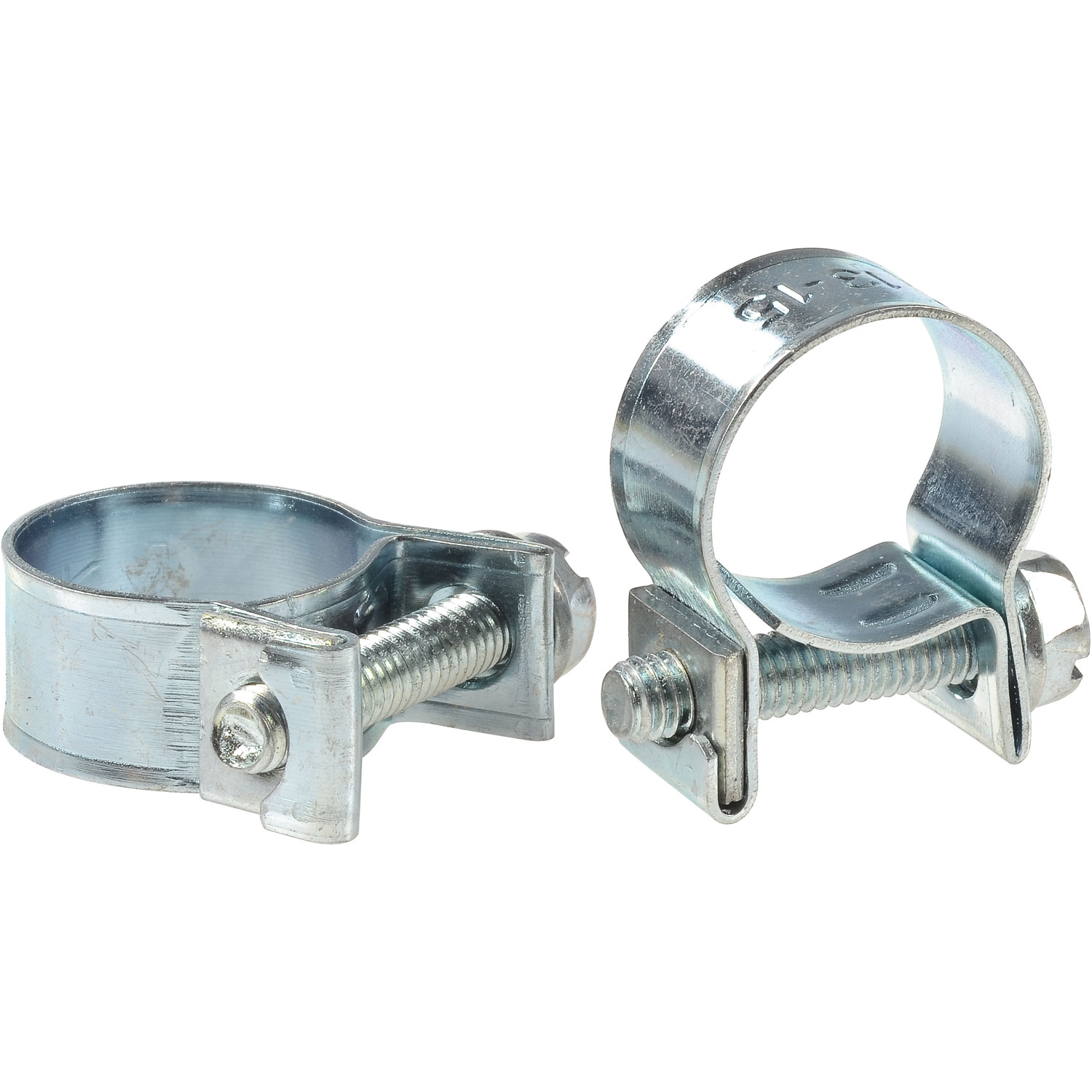

Replace those clamps with fuel injection clamps. Your clamps can cause leaks.
post Aug 12 2017, 05:26 AM
914-6 GT in waiting
Posts: 20,281
Joined: 19-September 09
Member No.: 10,825
(IMG:style_emoticons/default/agree.gif) Need proper clamps and the hose might be too large. Should be a tight fit.

(IMG:style_emoticons/default/agree.gif) & Is the Tee a barbed fitting or threaded fitting? Is the rubber stiff? What is that yellow ring? Hint: Take a piece of a paper towel and wrap around each joint. Pressurize and quickly check for wet spots on paper towel. One pin head drop of gas will make a quarter sized splotch on the paper. Makes it quick and easy to locate which one is leaking. (IMG:style_emoticons/default/beerchug.gif)

What is that white line on the verticle hose in post #2? Mish mash of hose varieties.

Replace them. Replace them all. NOW. New proper fitting hoses, and fuel injection style hose clamps. Or this...

QUOTE(76-914 @ Aug 12 2017, 06:27 AM) *
When i pressurize i assume you me turn on the car or
Put it to the on postion so fuel pump runs up ???
Because if i just run pump before cranking key
No leak (IMG:style_emoticons/default/bye1.gif)

You have at least two different types of hose that I can see and the WRONG hose clamps. Replace them. SOON.

What kind of fuel pump are you using and what is the output pressure. It shouldn't be more than about 3 1/2 PSI with carbs.

Useing a rotary fuel pump , supposed to be 3 to 5 psi .
