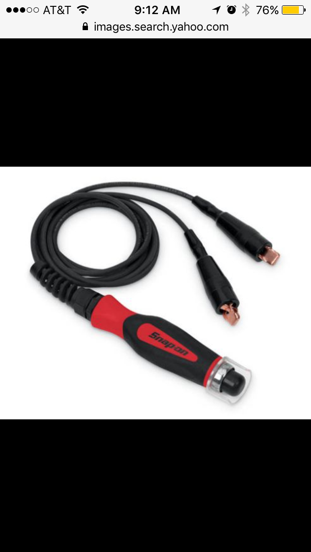

ndfrigi
post Aug 20 2017, 10:14 AM
Posts: 2,967
Joined: 21-August 11
From: Orange County
Member No.: 13,474
try using like this to start ur car
