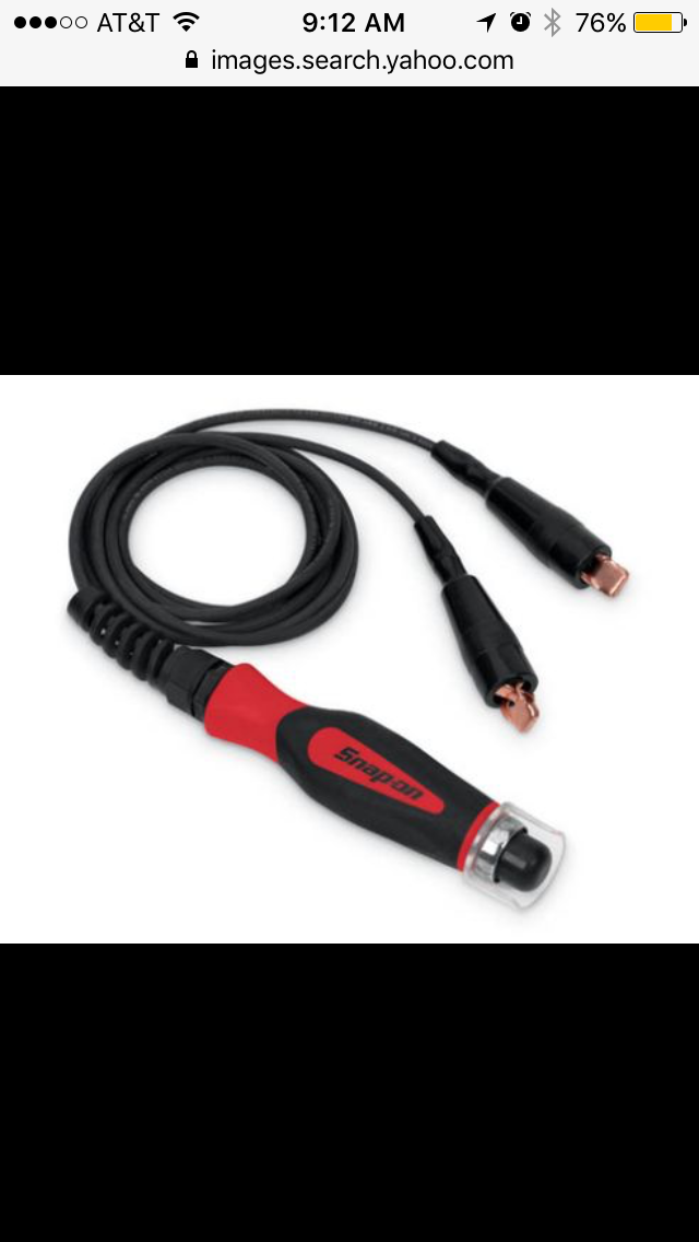

try using like this to start ur car
click here.
