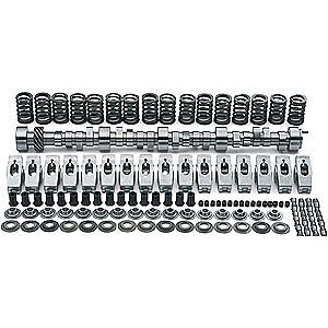

No I have the factory GM Hot Cam kit for the 86. It has hot cam and all valve train parts. Springs, retainers, trick roller rockers. That was $650. A long time ago. Attached Image
