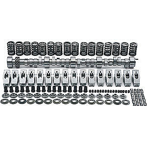

Don't know why you couldn't find a cam that bolts into the 86?
SummitRacing.comJegs.comI've been looking at one of these for Dad's 454.

FiTech Go EFI – 600 HP System No I have the factory GM Hot Cam kit for the 86. It has hot cam and all valve train parts. Springs, retainers, trick roller rockers. That was $650. A long time ago.
