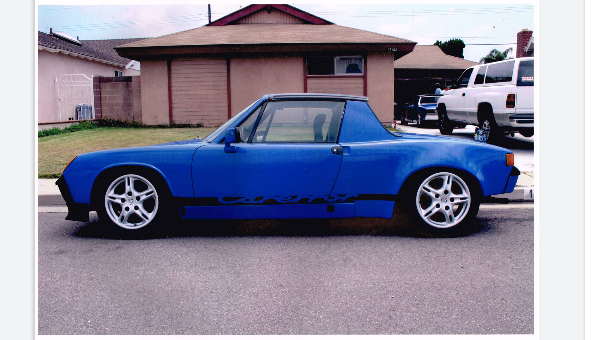

Trying to find motivation to keep her going and use her before I run out of time. I moved her to the workshop yesterday and today I put her transmission back in her. Need to change the gas tanks out as she has a 6 gallon tank in her now and I have a nice little 1.5 gallon tank for her. Only good for about 5 minutes of run time.

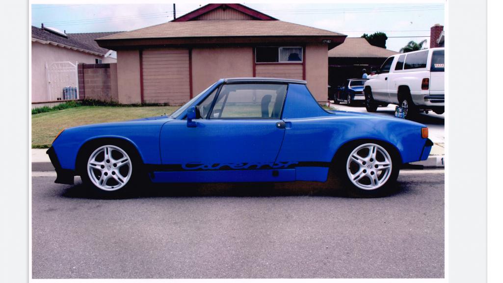

I backdated the picture because she looks totally deferent now. So I guess I should do that more often.
This picture is by Carl La Fong, sorry if I miss spelled it Carl. She has Carerror script on her side. At that time I had just decided to make her my race car.
While driving the freeways of LA dressed in that livery she was passed in her lane by 911's 3 times. No one takes the time to read Carerror they only see Carrera.

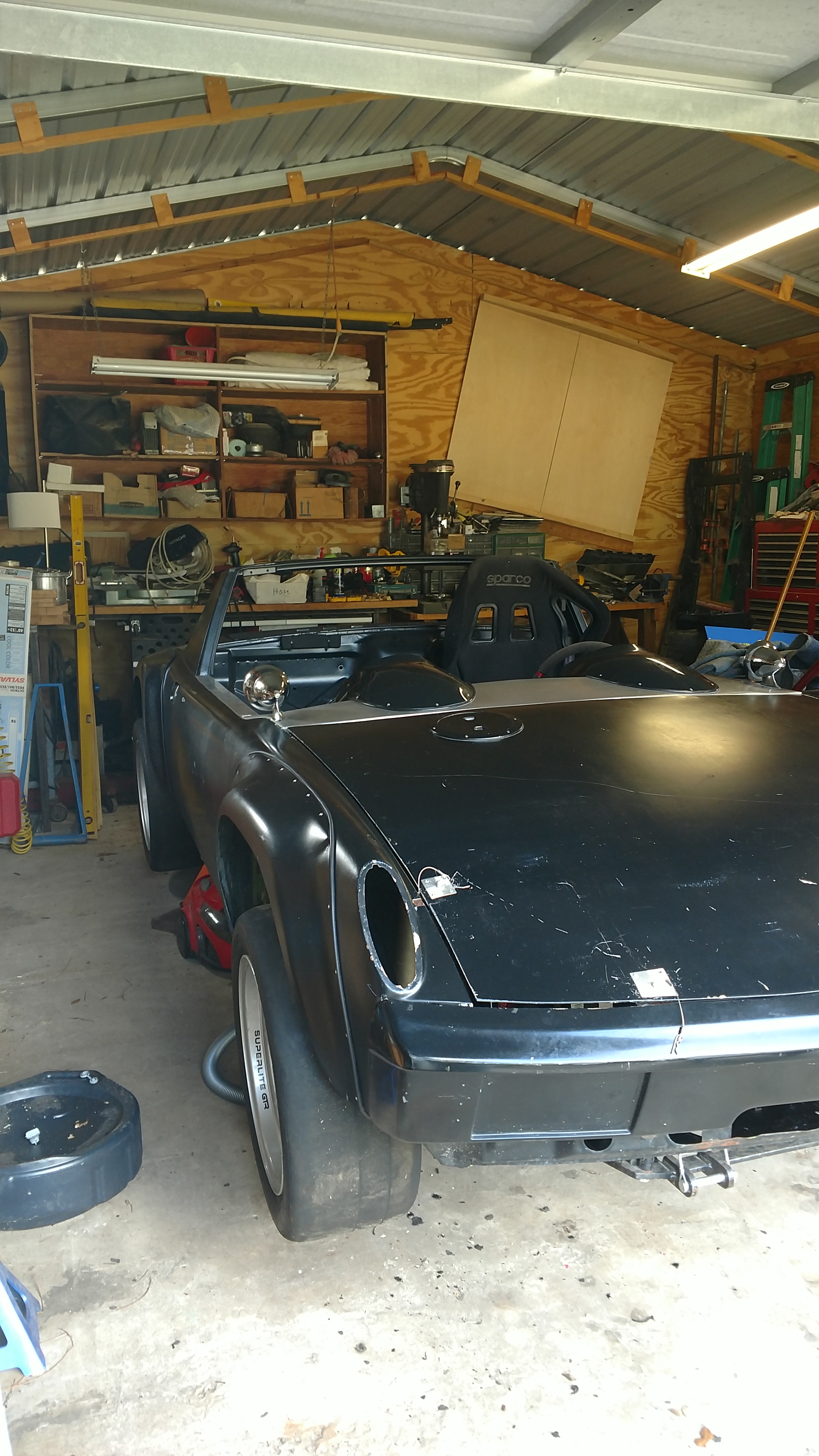

Wish I could. Phone is so slow it times out before it can send a pic. Laptop doesn't talk to the phone. (IMG:style_emoticons/default/mad.gif)
Now I can.

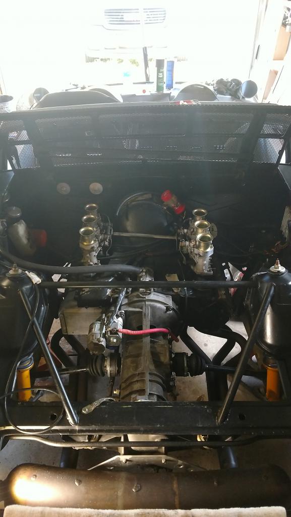

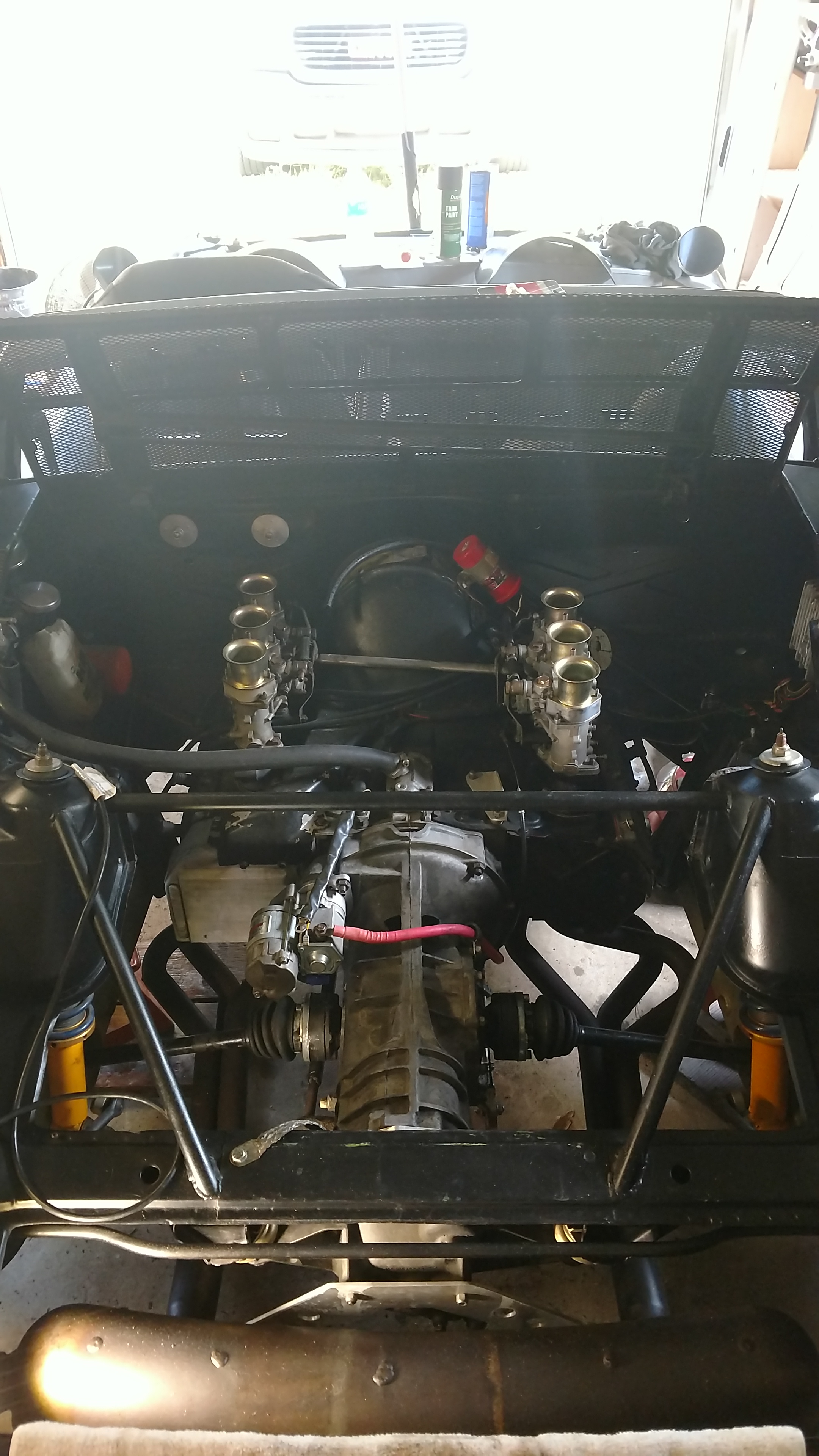

Today finished the shift linkage, clutch linkage, throttle linkage, muffler, starter wiring, battery location hot lead to the starter. Still have the carbs to clean and fuel lines in the engine bay, a bunch of electrical issues, change the tires and maybe next week have start up.

Getting more things hooked up today. Pulled old fuel lines in preparation for new lines. Battery Terminal and wiring, found and installed ignition switch and connected it to the circut board under the dash, installed the steering wheel,
Gotta check the wiring under the dash, make sure it is ready and won't short out when I go to start it. Fuel lines, charge the battery and change the tires. Put some fuel in her.

Changed the battery and got the motor to turn over. Hadn't heard that in a year and a half. Tidied up the cables under the car. Now need fuel lines from the fuel regulator to the carbs. Put some fuel in and she should fire right up.

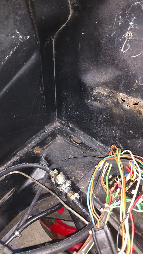

Carerror is a rust free California car.
Skillfully patched and welded repairs. If Thomas would have seen this he would of cut the car up.

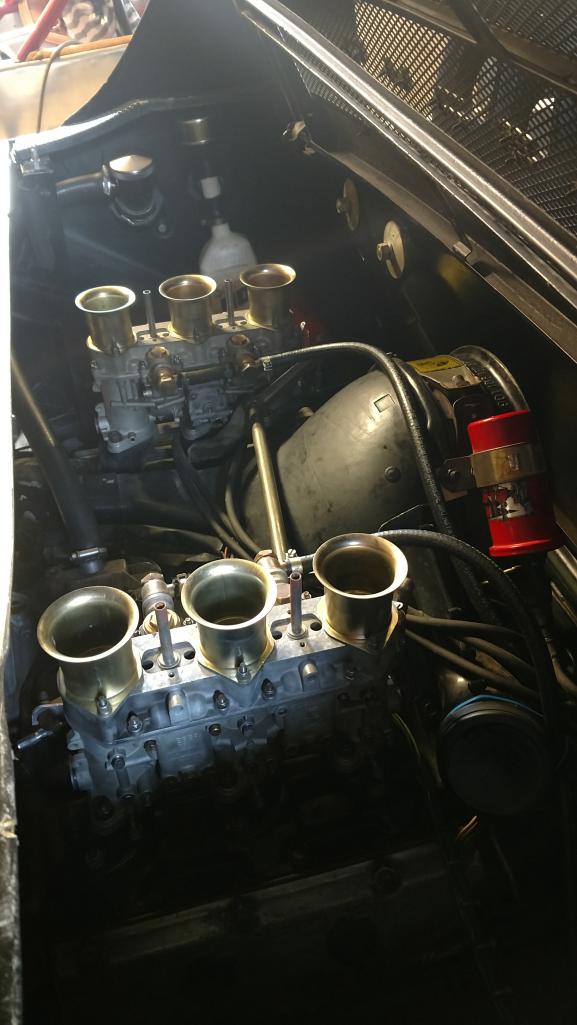

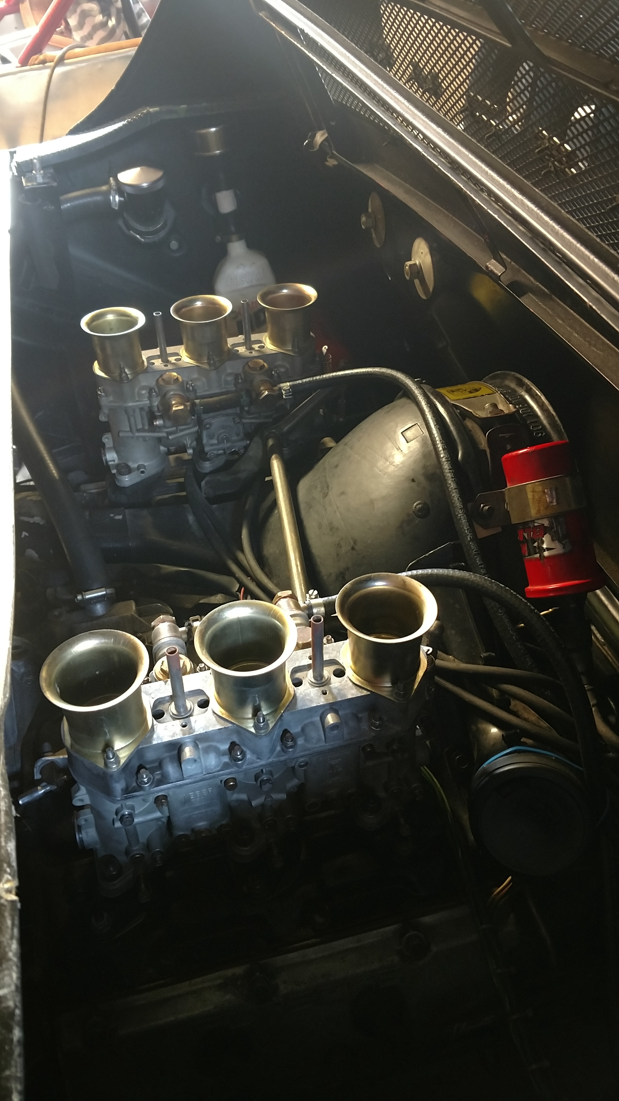

Finished the carbs and got ready for fuel. Maybe tomorrow.

Carerror got start up today.
