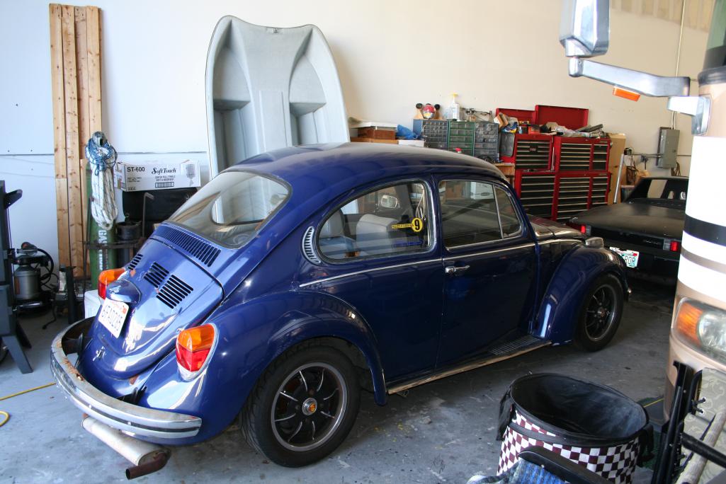

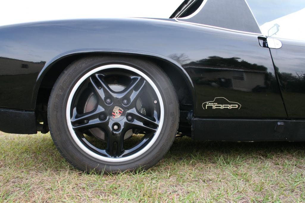

Trying to find motivation to keep her going and use her before I run out of time. I moved her to the workshop yesterday and today I put her transmission back in her. Need to change the gas tanks out as she has a 6 gallon tank in her now and I have a nice little 1.5 gallon tank for her. Only good for about 5 minutes of run time.
I backdated the picture because she looks totally deferent now. So I guess I should do that more often.
This picture is by Carl La Fong, sorry if I miss spelled it Carl. She has Carerror script on her side. At that time I had just decided to make her my race car.
While driving the freeways of LA dressed in that livery she was passed in her lane by 911's 3 times. No one takes the time to read Carerror they only see Carrera.

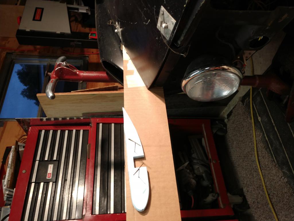

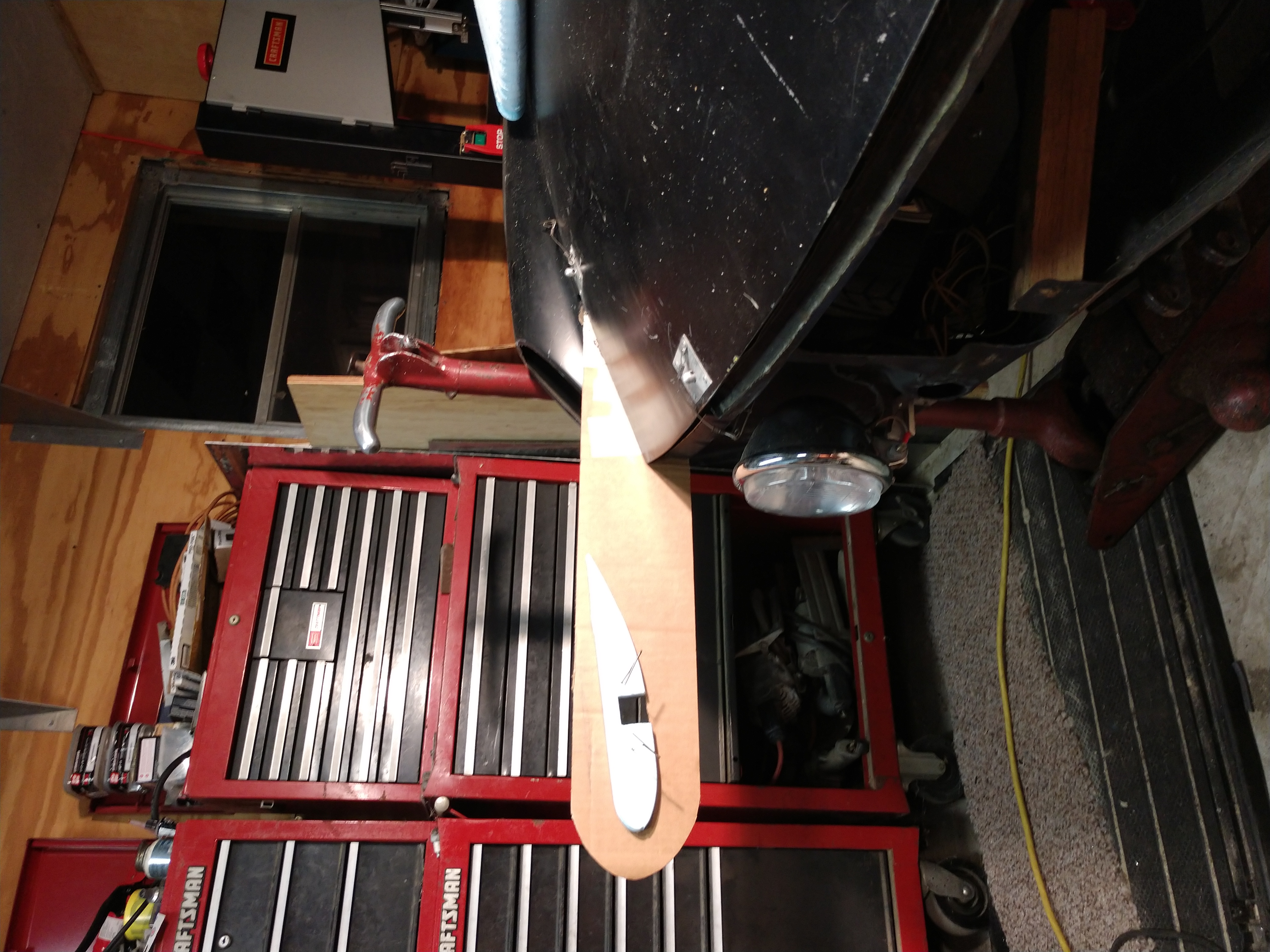

914 Ranch   Kind of taking shape, what I had in mind but I got...   Dec 8 2018, 02:57 PM
914 Ranch   Another pic, probably just as bad.   Dec 8 2018, 03:01 PM
914 Ranch   I wanted to have the foil in the shape of the nose...   Dec 9 2018, 03:34 AM
914 Ranch   Got the foil rough sanded today. Working on gettin...   Dec 11 2018, 08:08 PM

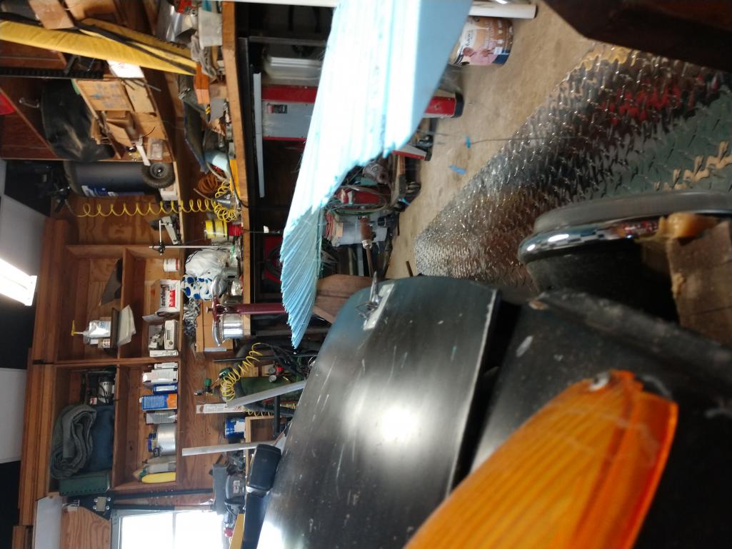

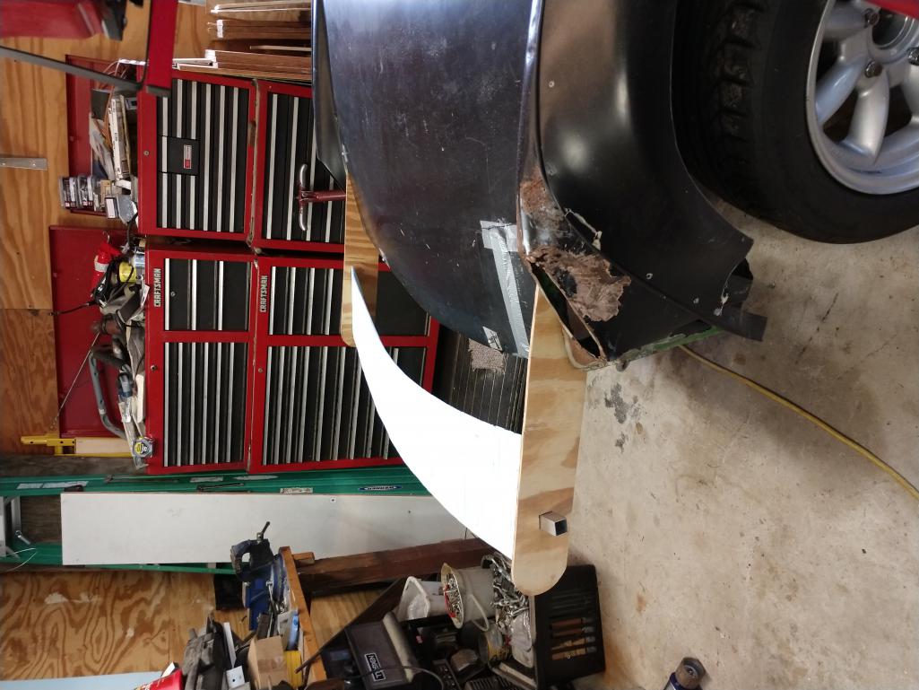

914 Ranch   Looking at how the foil sits on the goosenecks. ...   Dec 15 2018, 04:54 PM
914 Ranch   I think I like this one better. Out 1.5" a...   Dec 15 2018, 06:13 PM

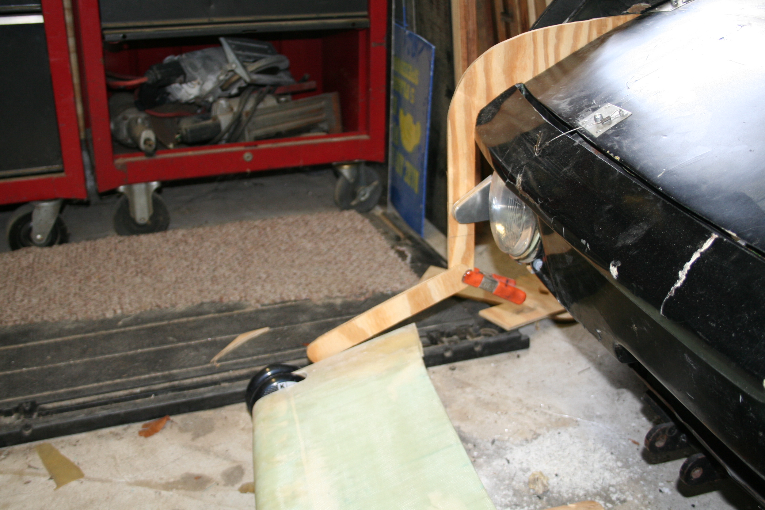

914 Ranch   More sideways pics. Mocking up the foil. I still l...   Dec 16 2018, 09:38 AM
stownsen914   Good idea to put it out front in clean air. If you...   Dec 16 2018, 10:38 AM
sixnotfour   Good idea to put it out front in clean air. If yo...   Dec 17 2018, 05:14 AM
stownsen914   great info.. low in front on z 914 there is a bri...   Dec 18 2018, 10:42 AM
sixnotfour   :)   Dec 17 2018, 05:09 AM

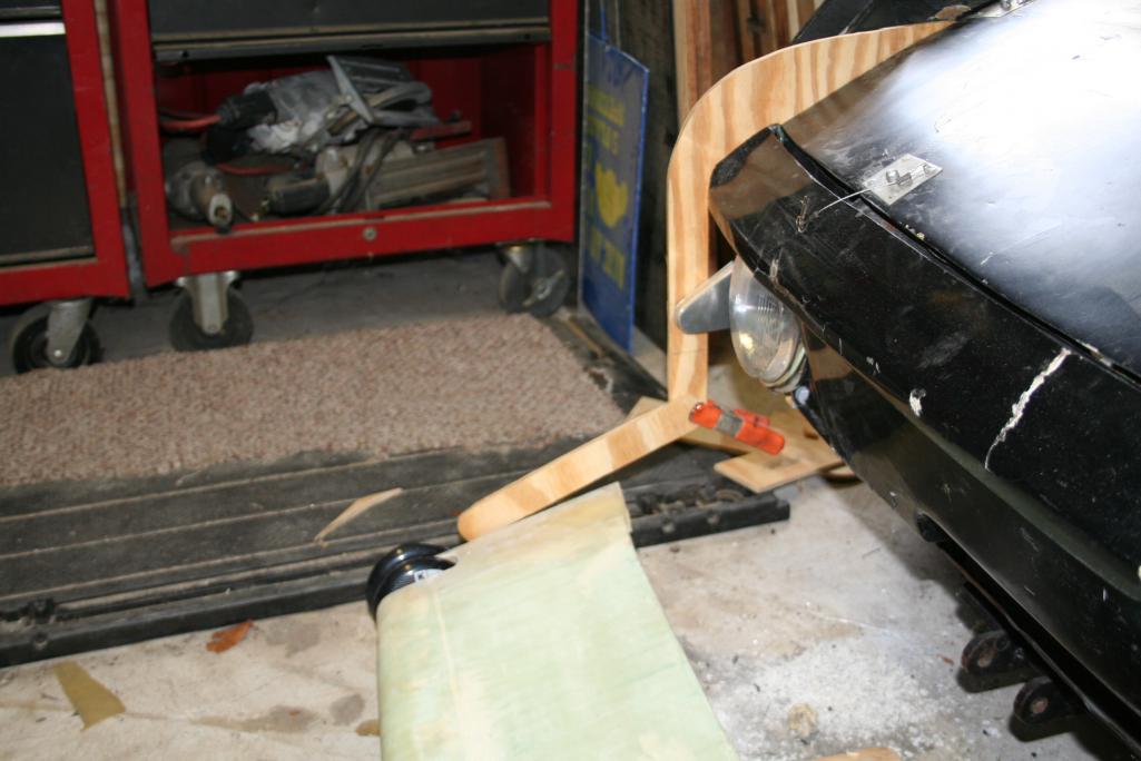

914 Ranch   To close to the body will cause flow problems with...   Dec 18 2018, 04:29 PM
914 Ranch   Maybe I should have done a swan's neck like wh...   Dec 19 2018, 12:01 AM
stownsen914   The side mounts like you're mocking up are pro...   Dec 19 2018, 05:01 PM

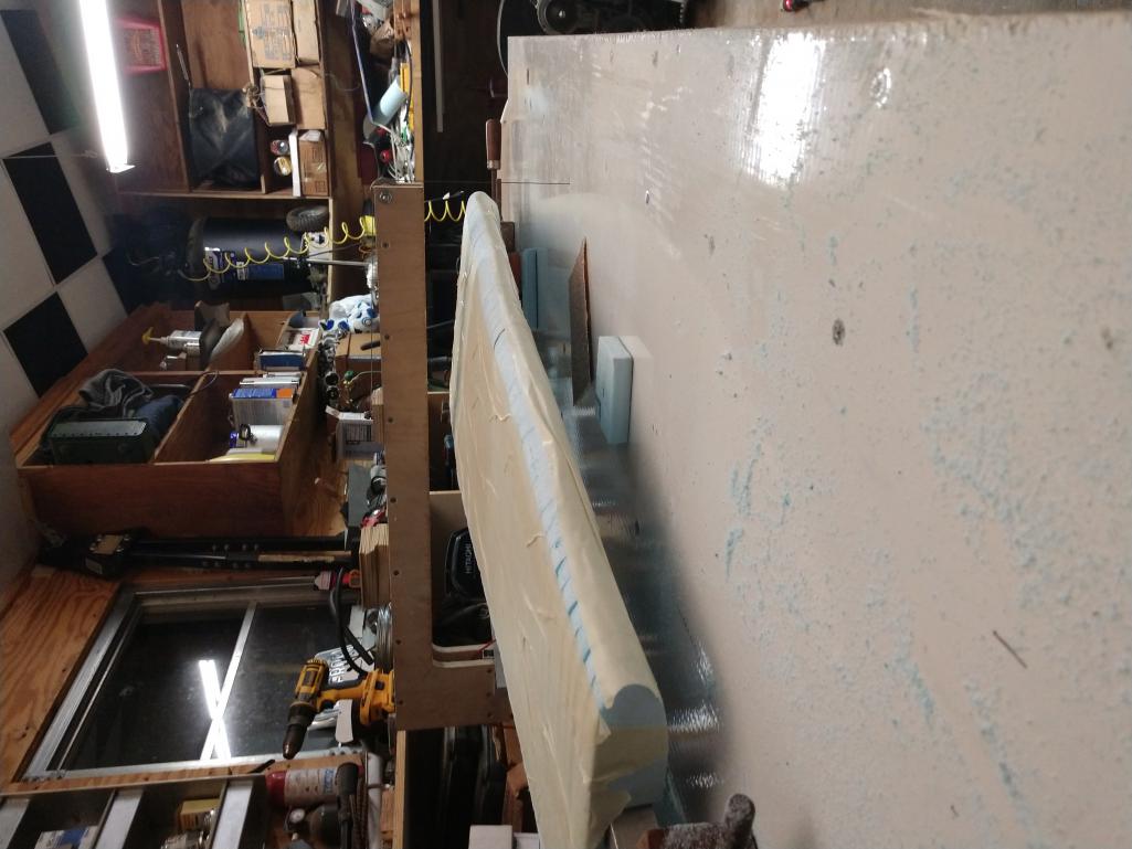

914 Ranch   Still sanding and have about 6 or 8 layer's of...   Feb 13 2019, 04:57 AM

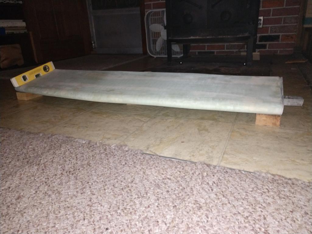

914 Ranch   Yesterday I blocked the front foil up on the floor...   Feb 13 2019, 05:46 AM

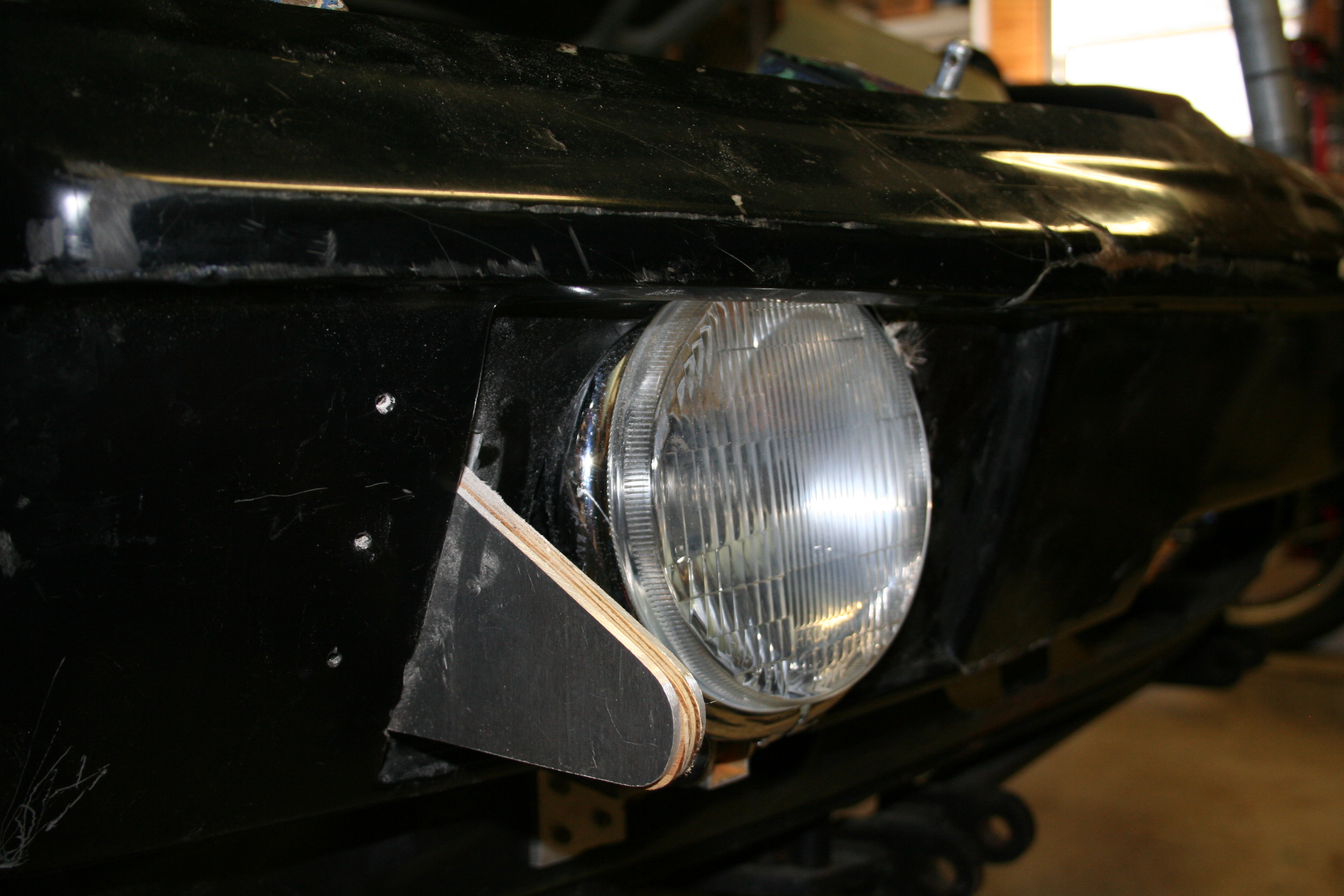

914 Ranch   Not much but I did make the cut out for the right ...   Feb 20 2019, 02:45 PM

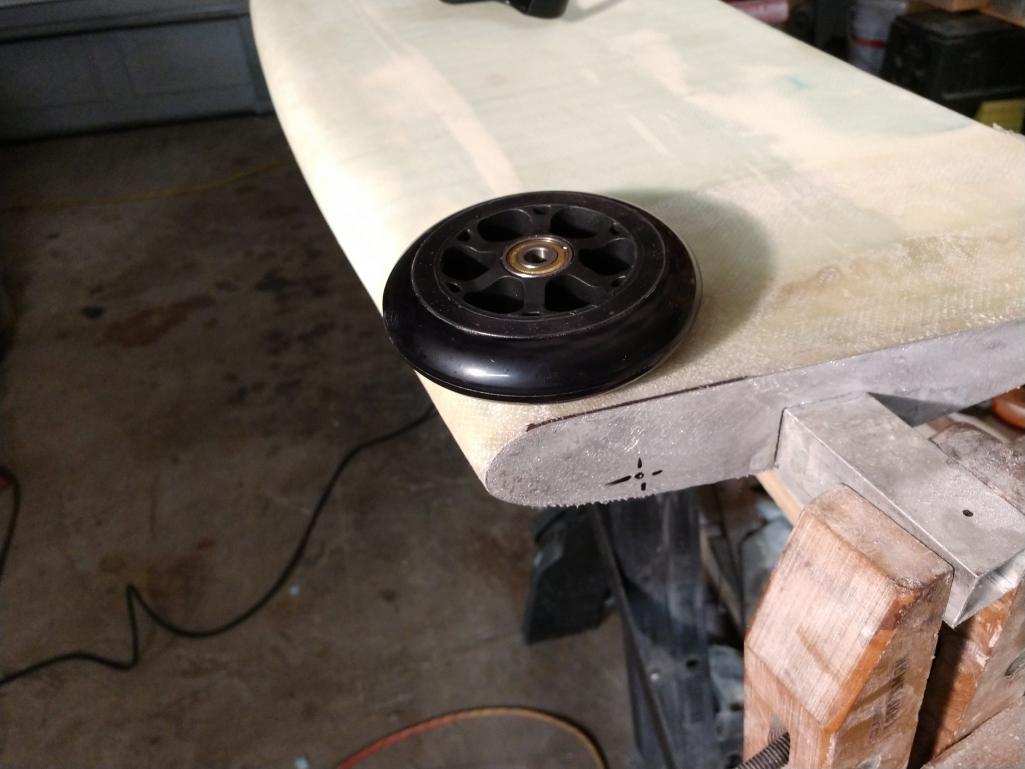

914 Ranch   Got the wheels mounted. A few more layer's of ...   Feb 22 2019, 04:21 PM
stownsen914   Are the wheels to protect the wing from hitting th...   Feb 23 2019, 08:49 PM
914 Ranch   Yes, I plan on mounting the wings nose 3" off...   Feb 24 2019, 02:28 PM

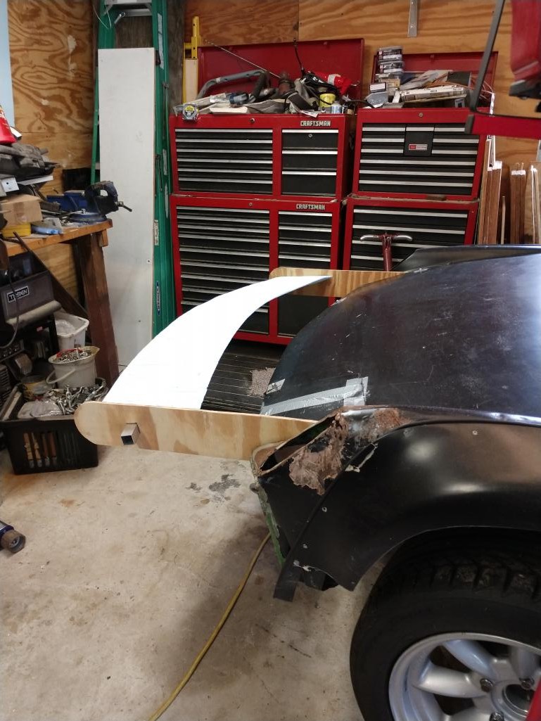

914 Ranch   Apparently I like to do things twice.   Feb 27 2019, 07:20 AM
914 Ranch   I've come to a dilemma about the wings. The ta...   Feb 27 2019, 07:24 AM
stownsen914   For the wheels on the front wing, just make sure t...   Feb 27 2019, 01:29 PM
914 Ranch   I was thinking that it needs to have a pivot and s...   Feb 27 2019, 04:34 PM
Cracker   Hey Joe. If I am understanding correctly you are t...   Feb 27 2019, 09:15 PM

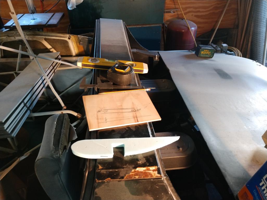

914 Ranch   Working on the brackets today. Some progress. F...   Mar 4 2019, 09:52 AM
914 Ranch   More of the Swansneck, got the rough patterns done...   Mar 5 2019, 03:01 PM
