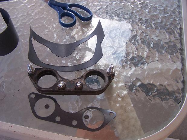

I made my own paper gaskets from gasket material from my FLAPS.
Cut the holes for the bolts and sandwiched the paper between the 2 spacers and bolted together. Used a razor knife to cut to shape. Took about 15 minutes to make 4 gaskets.

When I replaced the gaskets on my old 1.7 back in 2013, they came with paper. When I replaced them on my 2270 a year ago, they did not. Both times I bought them from Pelican. I attempted to use the non-paper-having ones anyway, and the result was a vacuum leak. You will have to add a paper gasket to each side of the phenolic. Depending on how long your intake studs are, you might be able to use the cardboard/paper ones that CB Performance sells, which I was able to do just barely. Or you can cut out your own paper ones, as someone else mentioned.
