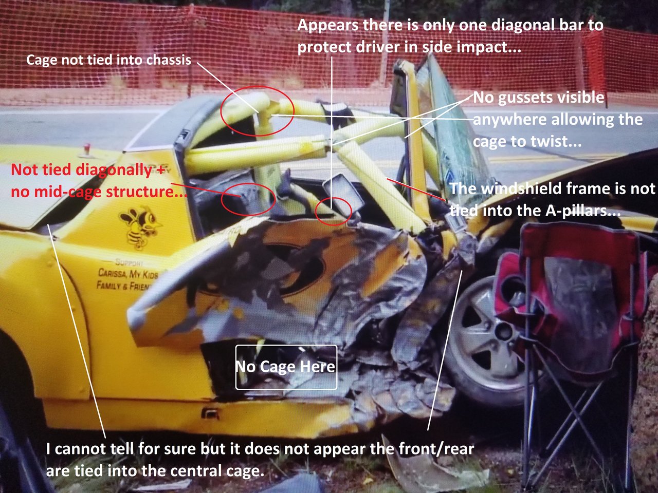

I don't see how it's evident that the cage was significantly inferior. (IMG:style_emoticons/default/confused24.gif)

That was a few years ago. Look that boy is lucky to be alive. The right door and right front absorb the impact and the bad cage may of saved him.
Those big boulders where in the wrong spot for him on that day.

Cracker
post Aug 31 2017, 08:32 PM
Posts: 2,148
Joined: 2-February 10
From: Atlanta (area)
Member No.: 11,316

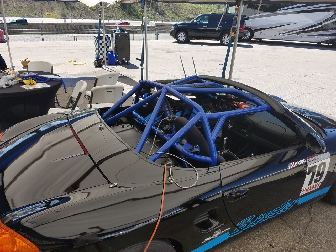

Where do I start? Look at the basic observations...
By comparison sake - I have also attached a picture of a Boxster Spec racer at this Springs PCA Club Race at Road Atlanta. This car is stupid slow and yet super safe (and not potentially flying off cliffs into bolders!) - see the deficiencies now?
Tony
QUOTE(MikeInMunich @ Aug 31 2017, 07:43 PM) *
Under-Kill
Over-Kill
