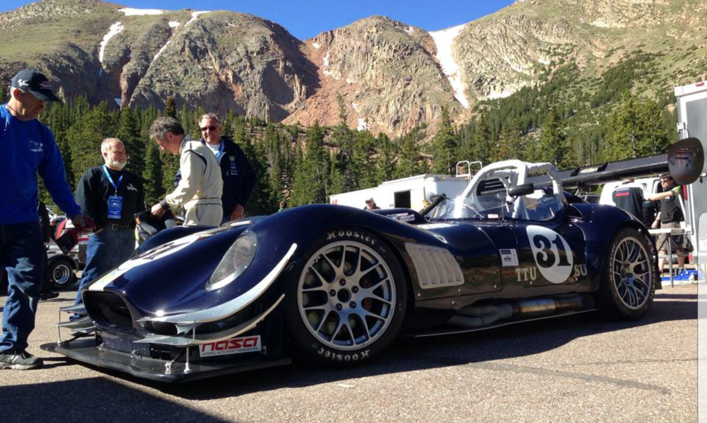

My neighbor (Mann) runs this spec built Lister (Beck carbon body) and is 1/2 of the Knoop/ Mann Lister team. It's an 800hp n/a LS based engine, placed front-mid in a tube frame. This car runs all sorts of venues (vara, NASA, Goodwood, etc) including PPHC. There is mostly 99% asphalt paving now at Pikes Peak and lots of grip.
Rick Knoop and Julian Mann are experienced road racers , but the hillclimb is a handful. Not lots of practice time allotted either...more going on down in the town below with pre-race parties and such (IMG:style_emoticons/default/blink.gif) photo credit Dean Kirkland Attached Image
