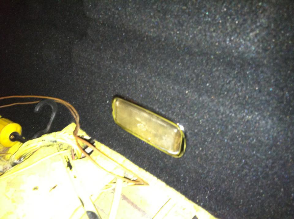

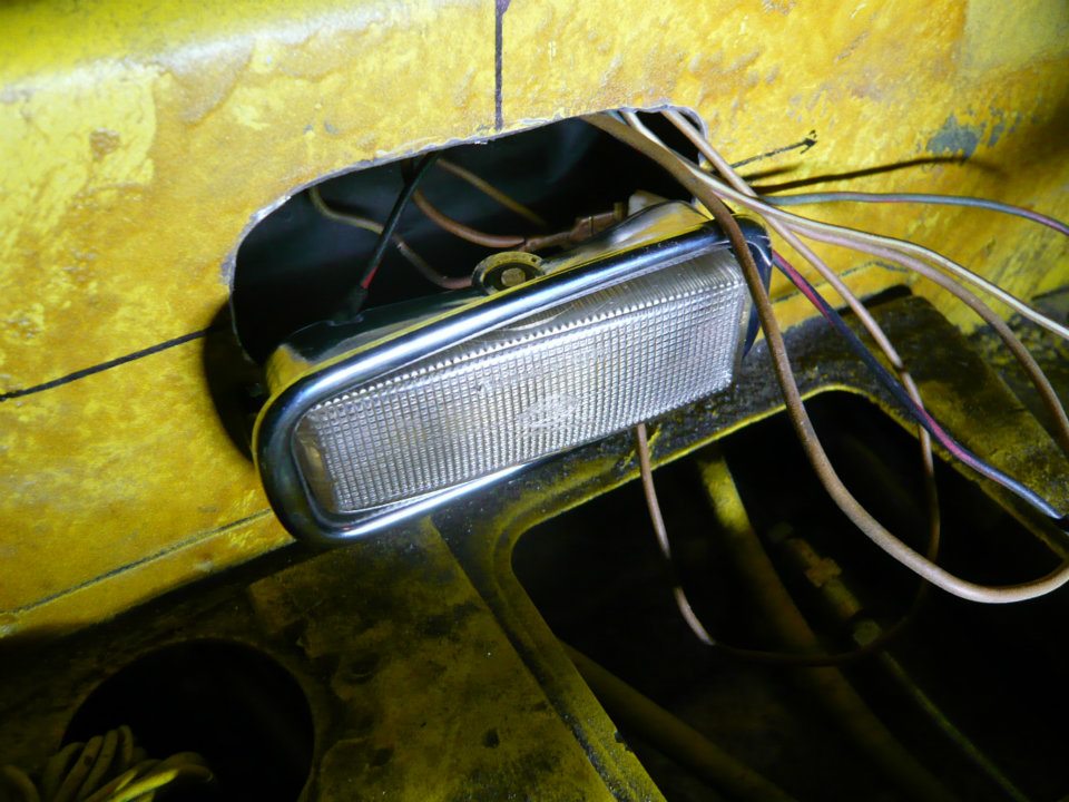

Not in #11 (IMG:style_emoticons/default/ohmy.gif)
Arne, the problem you'll have with this light in the back pad is, it grounds to metal on the sides. The back pad is foam all around but, this is why they have the ground wire up there so, I'm sure you can figure something out...

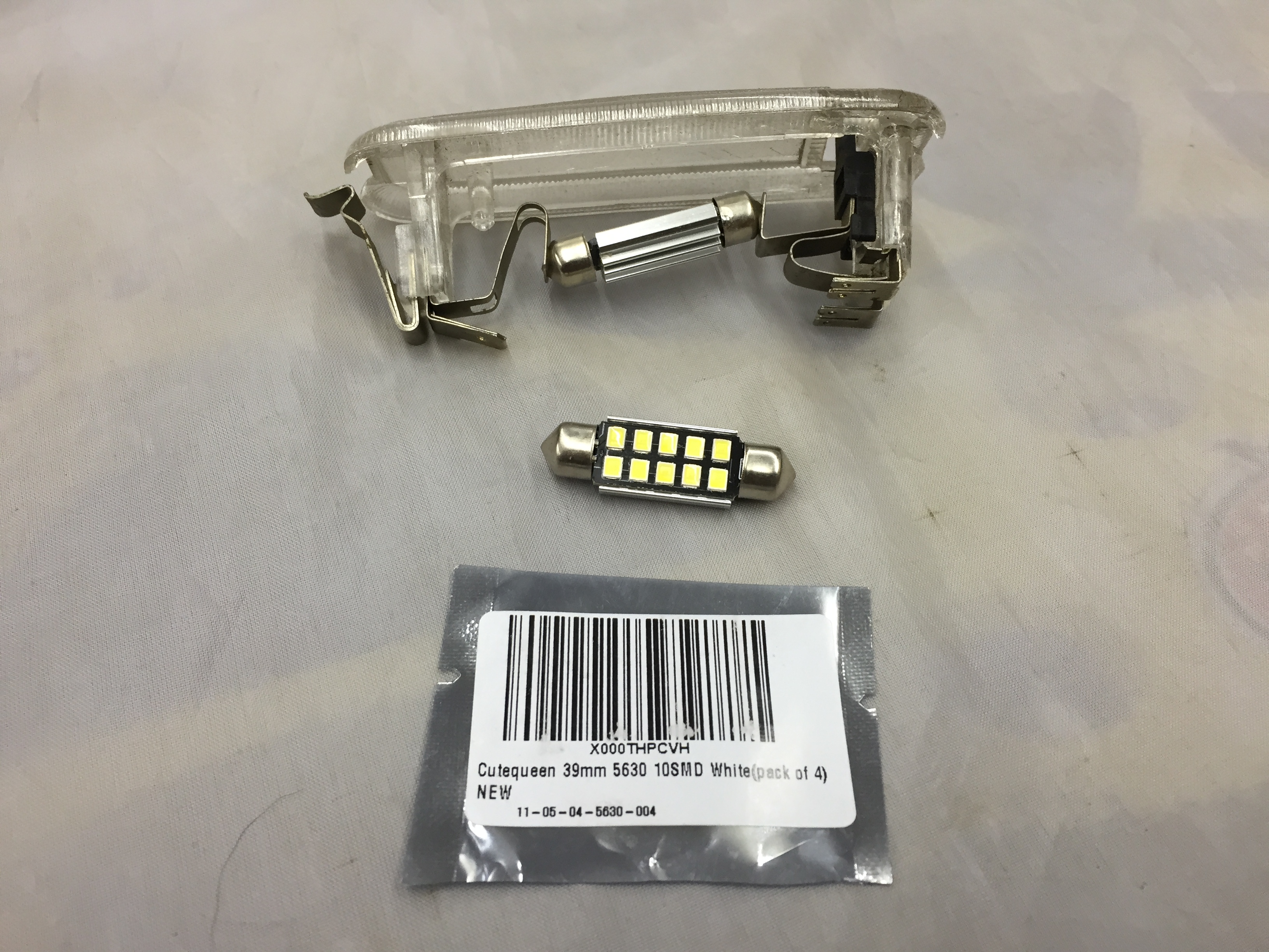

I found this replacement LED bulb to replace the original bulb. It's much brighter than the factory one, but unfortunately still runs hot. I was hoping that the LED would be cooler than the original to help preserve the original fixture as heat is the main culprit in making them more fragile. If anyone knows of a cooler running USB, please share the info.Attached Image

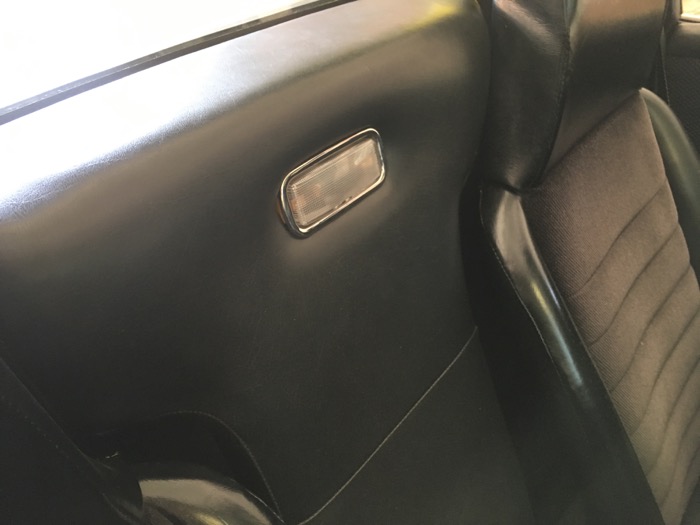

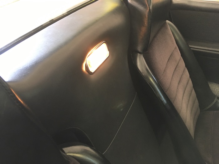

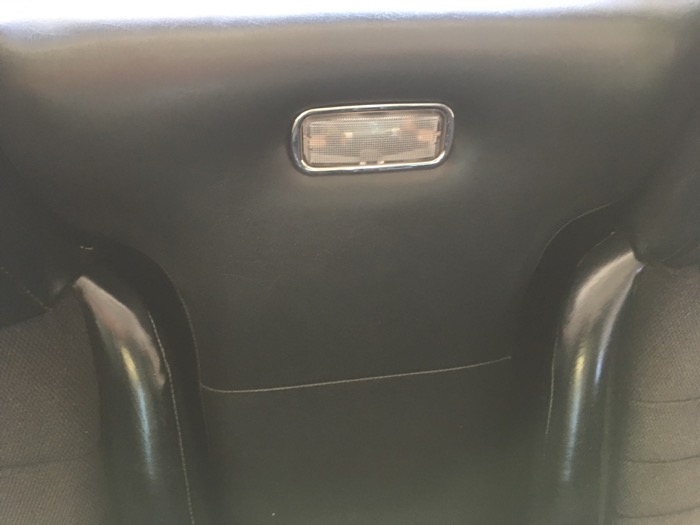

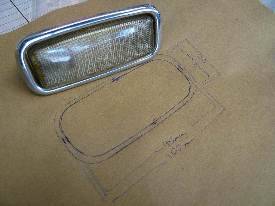

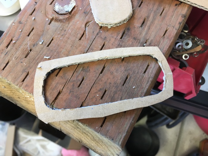

The new Type 3/356/911 light is installed, and works perfectly.
The opening in the back pad needs to be enlarged on all 4 sides. I made a cardboard template to get the rough size transferred to the back pad. Overall opening size is 95mm x 38mm with rounded corners similar to the stock opening. If your back pad still has the metal tabs for the light to clip to, both tabs will need to be trimmed by 3-4mm each side. (I used a Dremel with carbide cutoff wheel.)
The new light has three terminals to connect, so all three stock wires are used.
  • Terminal on the end of the bulb gets black/red.
  • Terminal on opposite end (with the pivot switch) gets brown/gray (the one from the door switches).
  • The third terminal is part of the stainless bezel. and points straight to the rear. That one gets the double brown. Depending on how tightly your back pad fits, you may need to bend that terminal 90° for additional clearance.
In the middle position, the light works with the door switches. Pivot to one side to be on all the time, to the other to be off always.
