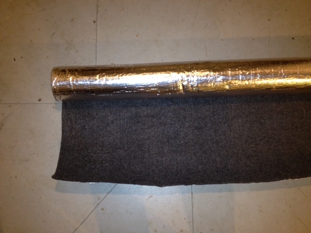

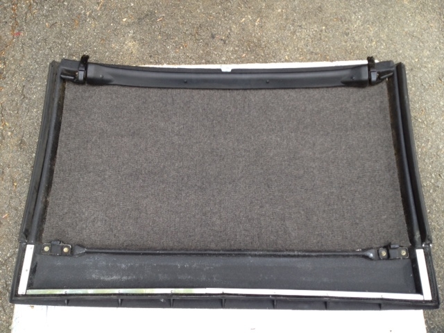

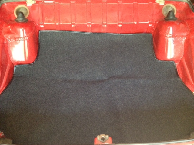

I bought this stuff at pep boys for about $15 a roll. It was enough to do the headliner and rear trunk. Cut with a sissors. Not the same as perlon but it's a very heavy felt. Worked fine for what I was after.
And yes, the car was quieter with the headliner than without.
