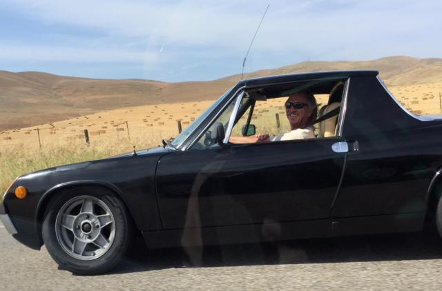

Member No.: 17,068
205/60 15s on deep sixes......
These fill the wheel wells nicely.

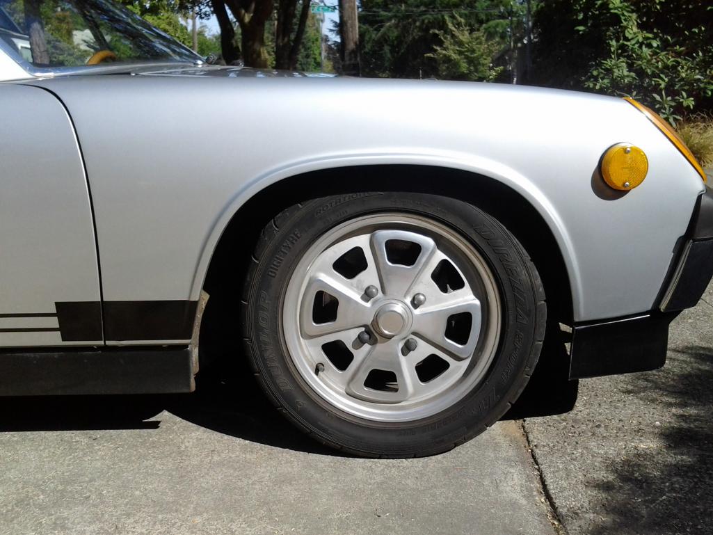

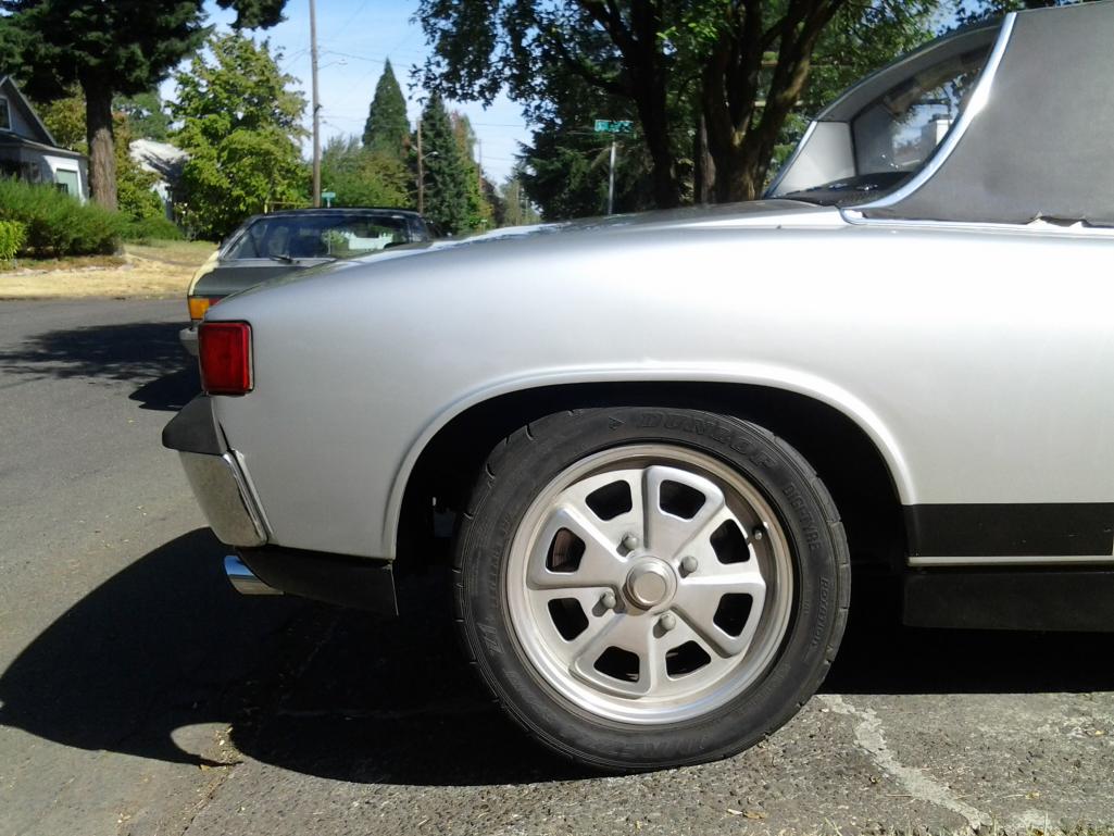

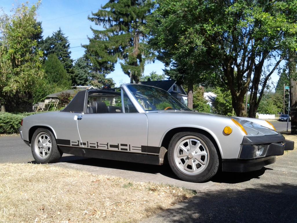

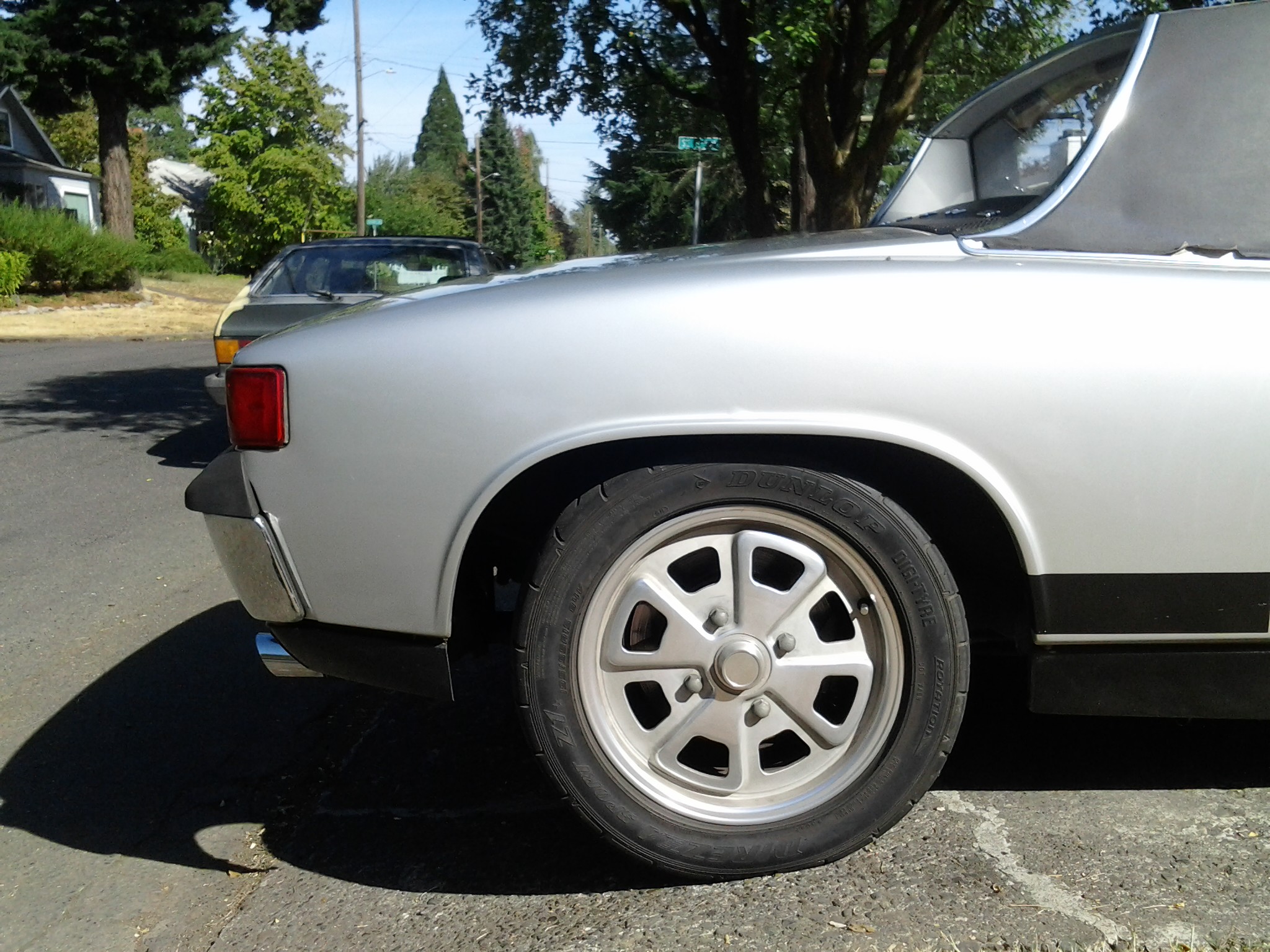

Here is how the 195-55-15s look on a stock set-up. Just installed the LE spoiler from 914rubber too. There is enough clearance to get in and out of my driveway.

QUOTE(steuspeed @ Sep 14 2017, 01:38 PM) *
Those look sweet. That is what I was thinking of with mine. Larmo's look nice too, and show me what I can do w/ a different rim on them
