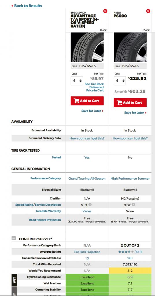

Used to run 205/55R15s. Liked the width and performance, but eventually looked wrong to me. Less so now, as period 914 race cars ran race tires of similar dimensions.
Even so, I like 195/65 and 205/60, and there are a couple of interesting choices in both categories. Remember that nearly any tire of today is a faaaaaar better tire than anything the 914 came equipped with.
The Pirelli is N-spec (Porsche approved) and is probably the only summer performance tire available in one of these sizes. Looks great on the cars, with nice sidewall bulge and it is sure to fit the wheel wells on most 914s. The Yokohama is a great autocross tire (there are almost certainly better ones) with a great, simple sidewall but a pretty alien tread pattern. The BFG Comp T/A has long had me wondering about how it works on a 914, as the look is period right on a 914 so long as the white letters are faced in to hide them. As seen on the recent super clean 914-6 GT tribute that sold on BaT for $55k....

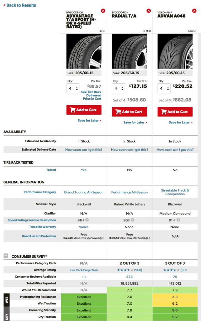

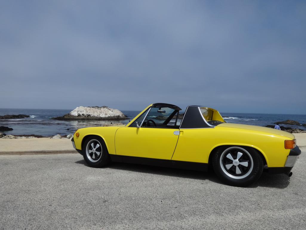

195/65-15 Michelin Exaltos on 6x15” Fuchs look right to me.Attached Image

George, your car looks terrific. (IMG:style_emoticons/default/smilie_pokal.gif)

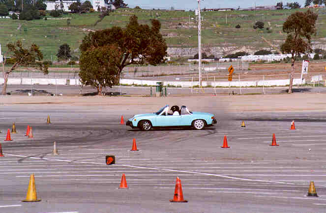

I used to run 195/50-15s. I liked them at the time. Eventually, I liked them less.
(IMG:http://www.914world.com/bbs2/uploads_offsite/forums.pelicanparts.com-121-1505109211.1.jpg)
I had originally used 195/60-15 in the same make and model, and found several differences when I went to 50-series tires:
- Lower gearing for better acceleration out of corners
- Stiffer sidewalls resulting in (slightly) more grip
- Better feedback from the tires
- Harder ride due to shorter sidewalls
- Freeway speeds required ~500 RPM more
- On a few autoX courses I had to shift up to 3rd and back, costing me some time
When I went to 50-series tires, I was finally able to feel the car well enough to catch a slide before it evolved into a spin. I had never done that on the 60-series tires.
Eventually, having to run higher RPMs on the freeway did get to me. The type of tires I wanted to run were also becoming harder to find in 195/50, so I wound up going with 205/60-15s.

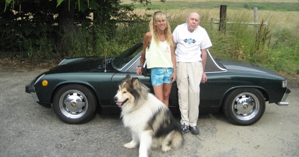

Hey Darling Dave, I totally agree with you I love the 195/50ZR/15 (made by Yokohama - nla for the A-008 type)which I need to replace, can't even find any ZR rated tires anymore.
I've talked to you a couple of times on the phone years & years ago and you've always had Rock Solid advice.
So, here's my question.
I deffinately want to stay with the low pro's no debating that one - your dead right world of difference! But I would like to have more accurate speedo & I wouldnt mind having lower rpm's.
Where the 'Rub' is (forgive the pun) that my tires I have on my chrome rims are 185/65/15. the drivers rear clearance is super tight, can't even get my pinkie in between tire and well. do you know if these chrome rims are totally offset? or are they the same as the Fuch's? (I'll upload pic of the chrome ones)
I will be putting the new tires on my 2.0 L. OEM Fuch's .....so, If I were to go a little bigger with still a 50% would that work? Could you suggest any sizes to check out?
Sorry to ask this, there is no tire shop nearby so I will be having to order over the internet, so I cant just go down to a shop or anything of the sort, that and like I said - great advice before - thanks.
