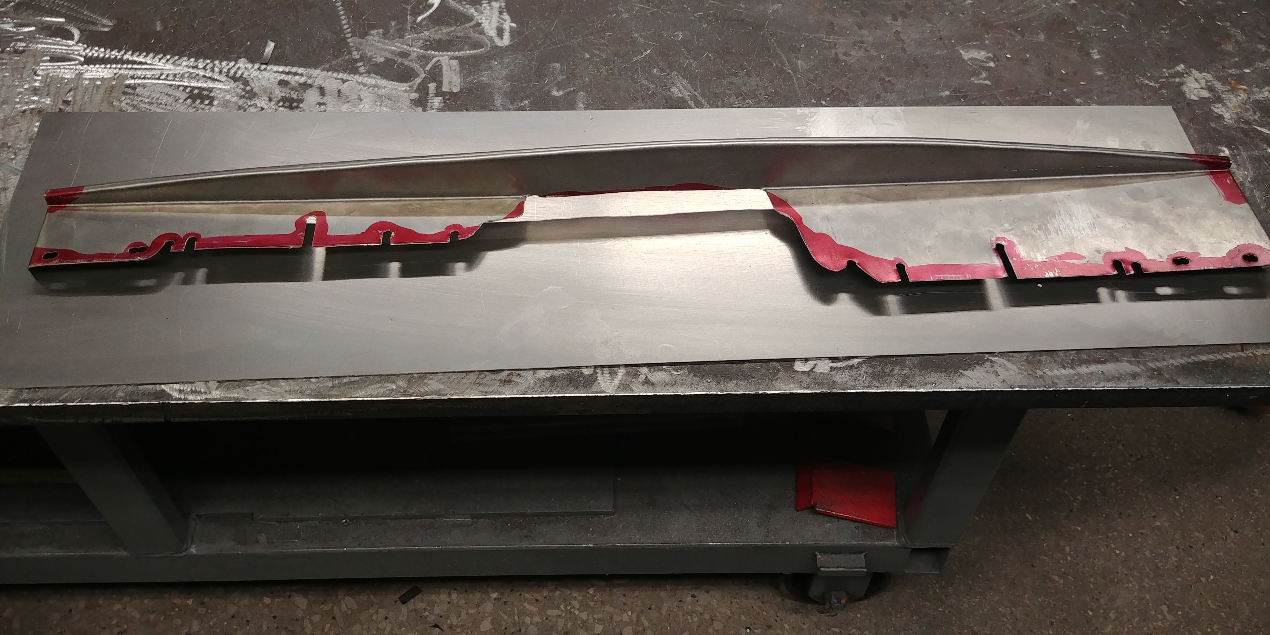

One odd thing - I was missing the guard for the front of the A-arm on the passenger site. Anyone have a spare? Here's the part:
(IMG:http://www.914world.com/bbs2/uploads_offsite/i.imgur.com-21443-1513486808.6.jpg)
(IMG:http://www.914world.com/bbs2/uploads_offsite/i.imgur.com-21443-1513486808.7.jpg)

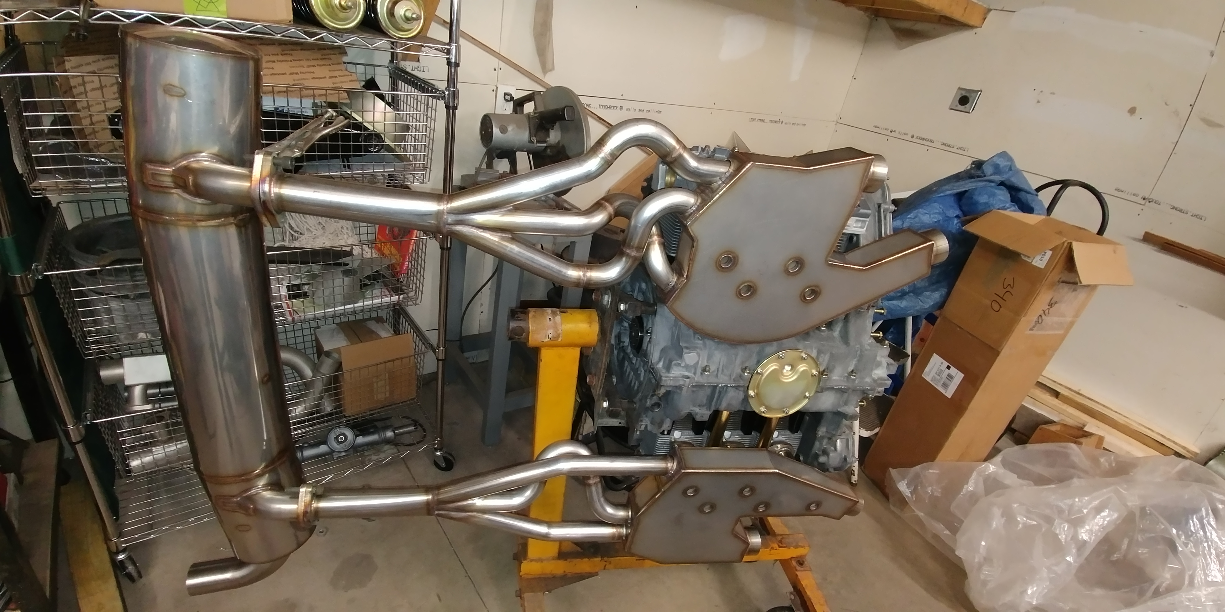

As I post this, headed down to SoCal to pick up the 2.7. Ben's exhaust bits are in the shop waiting an engine, along with Rich Johnson's motor mounts and throttle linkage kit. Fingers crossed the engine doesn't need too much work before assembly.
I've decided to drill the heads for a twin plug arrangement too.

Long time since I last updated. I brought the 2.7 home and my engine builder looked it over. It needs...lots of machining. Sending off to Ollie's next week for about $3k in machine work - shuffle pin, oil return and other stuff for the case, port and machine heads, valves, guides, for the heads, media tumble etc. I have the case certs and studs, so I did manage to save some $$. Also, the cylinders were Mahles in mint shape, ready for a new set of RS pistons.
Decided now is the time to go Twin Plug. I am having the heads drilled to accommodate a twin plug and trying to steel myself for the significant extra costs of adding a distributor, CDI boxes, and the wiring and bits. I might go single plug to start if my budget doesn't allow, but how much more cool to launch as a twin plug!
While the engine is being rebuilt, I need to source some engine tins, and hoping Ben comes through on the cast oil lines!
I located the spare part depicted above, and managed to score a brand new Engleman and Jwest fuseboxes to upgrade. Leaning towards the Engleman simply because it looks better.

Front oil cooler installed with lines, and custom shroud finished
(IMG:http://www.914world.com/bbs2/uploads_offsite/i.imgur.com-21443-1580701913.3.jpg)
(IMG:http://www.914world.com/bbs2/uploads_offsite/i.imgur.com-21443-1580701913.4.jpg)
(IMG:http://www.914world.com/bbs2/uploads_offsite/i.imgur.com-21443-1580701913.5.jpg)
(IMG:http://www.914world.com/bbs2/uploads_offsite/i.imgur.com-21443-1580701913.6.jpg)
Still need to run oil engine lines back, and rebuild transmission. I am going to go with a Tangerine Racing shift kit, which I installed on my black car.
(IMG:http://www.914world.com/bbs2/uploads_offsite/i.imgur.com-21443-1580701913.7.jpg)
I've had the 3.2 rebuilt on the black car, so my funds have been dedicated towards getting a running 914-6, and the blue car will get some more love once my bank account recovers. Till then....
