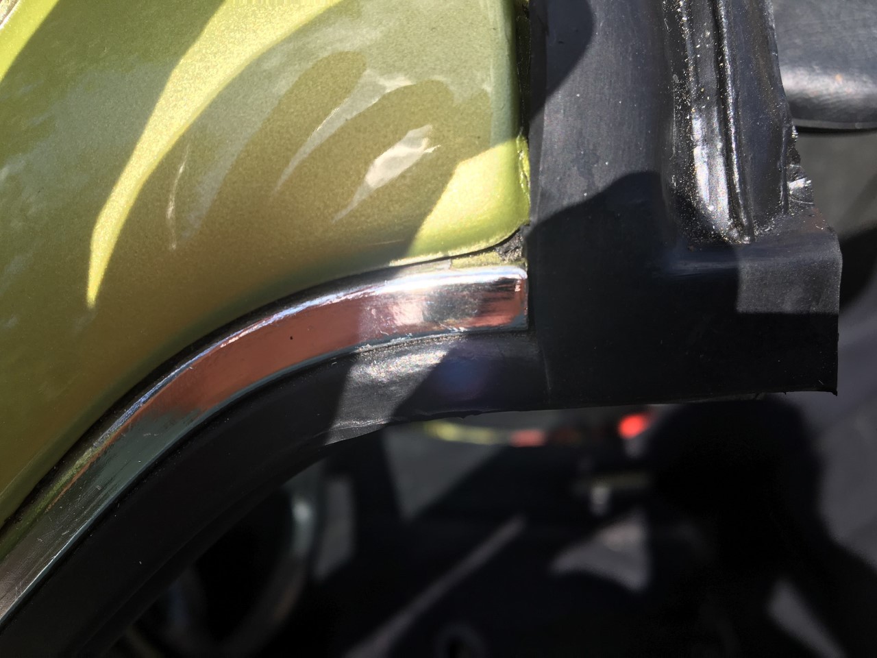

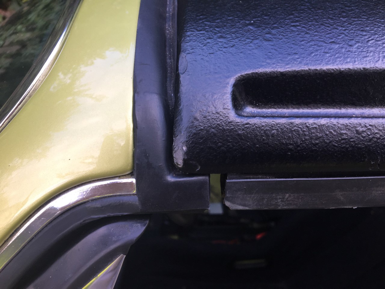

I'm also dealing with another customer that has had an issue similar. Not quite sure what the issue is here. I've had no negative input recently, so I'm wondering what we are seeing here. These look like they should fit but the corners are farther forward????
I'll share some pics maybe you can post some up here too.
The problem"seems" that the corners are holding the top back. He has checked the tabs in the corner and it's almost like it's being held off.
Has anyone else seen this?
The consensus seems to be the top section is too big. It is however a hollow and from my experience and design (duplicated factory profile)
The only thing I can think possibly could have happened is the metal came out of the fold at some point and it didn't get back in squarely.
