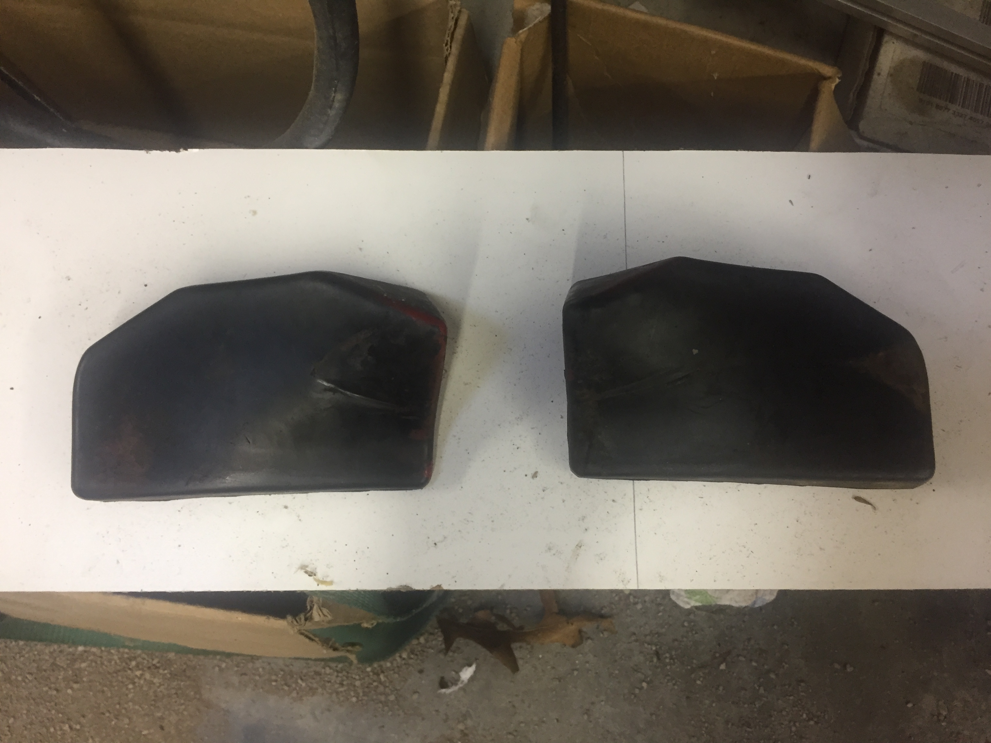

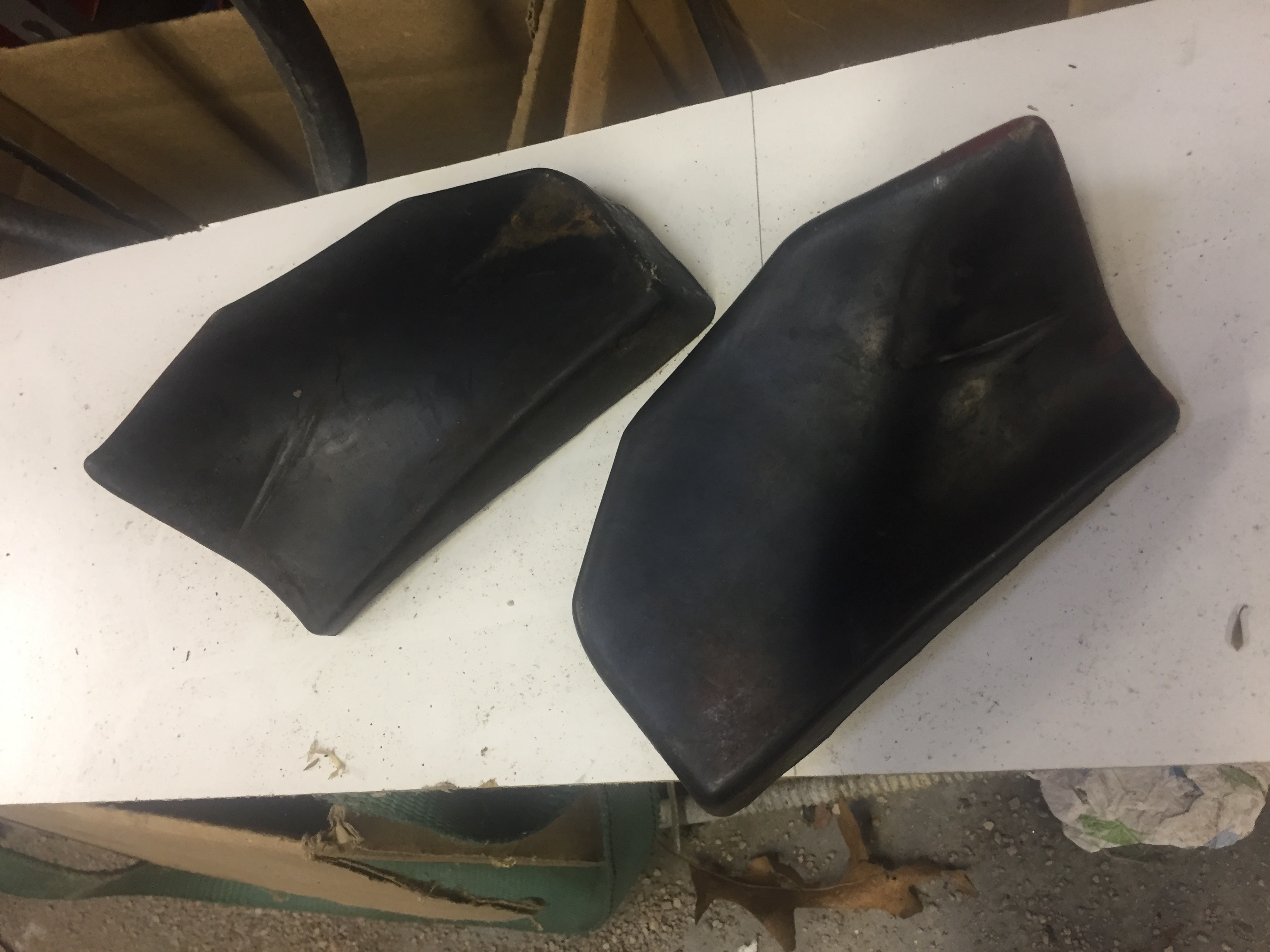

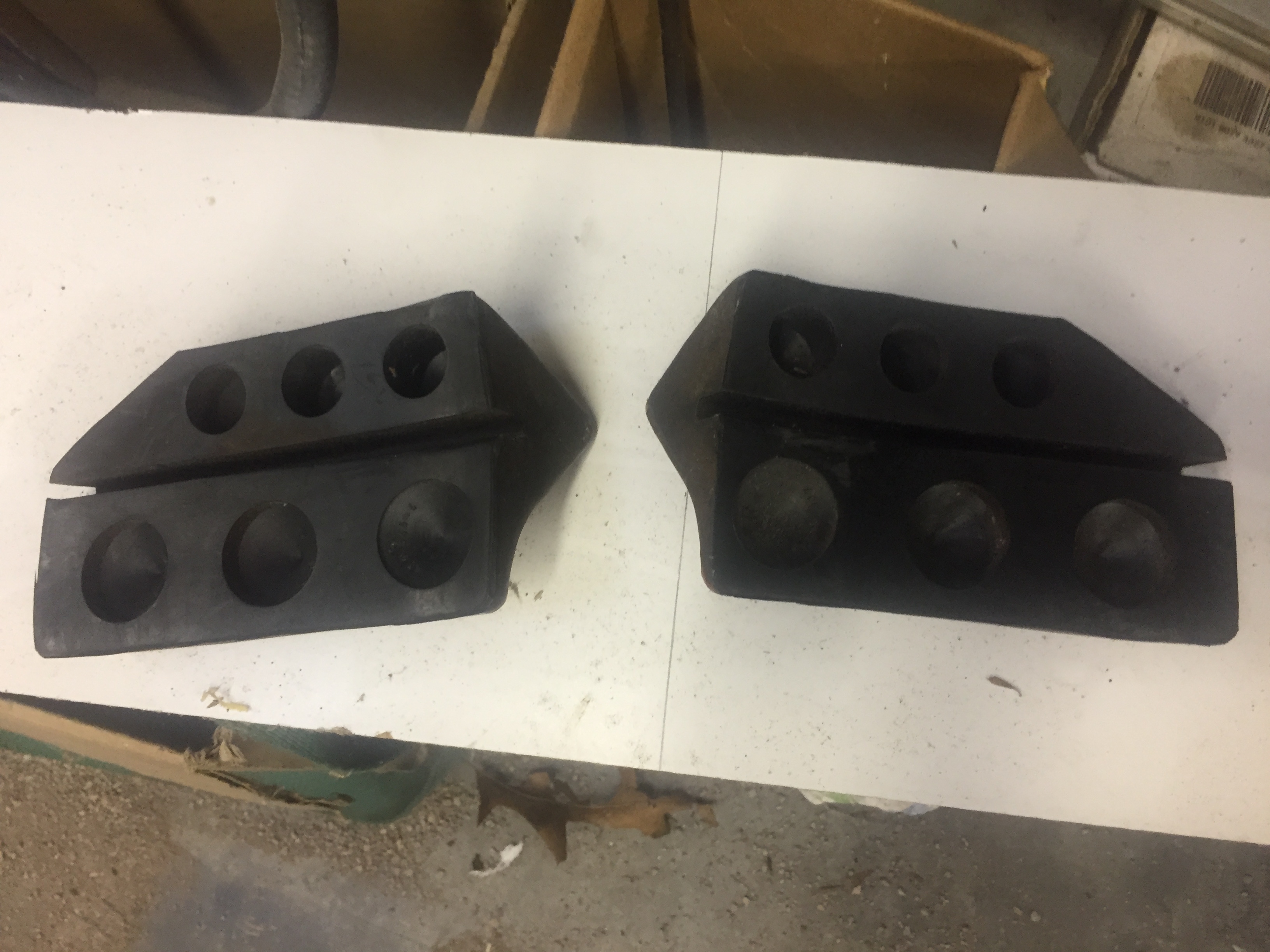

Can anyone tell me what these are & where they go? Base paint same red as body, but painted over with black. Hard rubber. Can't find anywhere on car that they would go, looks like bumper part.
one more coming....

Those are blocks that support the fuel tank in the fuel tank recess. They just "sit" in there and the tank sits on top of them (and is also has a retaining strap).

arne
post Oct 12 2017, 02:43 PM
Post #56
Serial Rescuer of old vehicles...
Posts: 811
Joined: 31-January 17
From: Eugene, Oregon
Member No.: 20,799
Gas tank supports.

QUOTE(Gatornapper @ Oct 12 2017, 04:41 PM) *
one more coming....
GN
Fuel tank supports? IIRC, they go between the body and the tank to prevent metal on metal.
Hope this helps!

Thanks Rob & Arne!
I would have NEVER guessed that. Tank not in car when I got it.
Gotta get than Haynes manual asap.....strap and felt supports are fine.
GN
