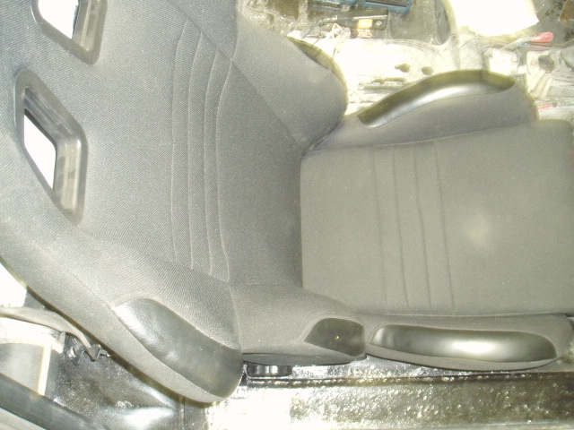

Interesting enough, while cranking the motor w/ #3,4 injectors completely out, the motor almost tried to fire up! As soon as this injector problem is solved, im thinking she will be running, hopefully tomorrow morning!!! For now all i have is a pic of the one seat i put in last nite w// the custom fabbed brakets.
