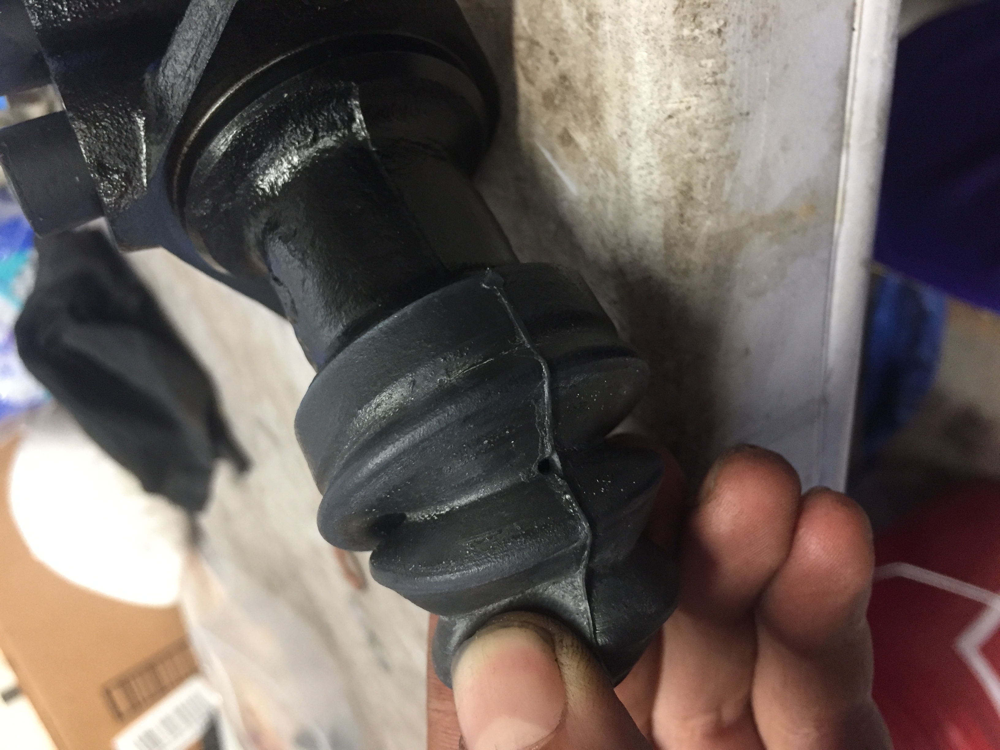

Quick question, I noticed a hole on the rubber boot. Anyone with knowledge about these Master Cylinders know if this is normal? Looks like a hole to relieve air. Just want to double check before installing, thanks. (IMG:style_emoticons/default/beerchug.gif)

DM_2000 I've seen this on other brands or they at leas... Sep 23 2017, 05:07 PM
Ed_Turbo
I've seen this on other brands or they at lea... Sep 23 2017, 05:52 PM
914Sixer Hole goes down. Weep hole to let you know you hav... Sep 23 2017, 08:02 PM
Ed_Turbo
Hole goes down. Weep hole to let you know you ha... Sep 23 2017, 09:18 PM
porschetub
Hole goes down. Weep hole to let you know you h... Sep 23 2017, 10:12 PM
76-914
[quote name='Ed_Turbo' post='2530719' date='Sep 2... Sep 24 2017, 11:36 AM
porschetub
[quote name='Ed_Turbo' post='2530719' date='Sep ... Sep 24 2017, 02:20 PM
Mikey914 It's for air
The cylinder should not leak her... Sep 25 2017, 01:57 AM
GeorgeRud I'd assume that it's there to just provide... Sep 25 2017, 08:49 AM
Ed_Turbo Quick update:
E-Mailed ATE and a german guy told ... Sep 25 2017, 04:11 PM
Perry Kiehl If it leaks you don't know it until your brake... Sep 25 2017, 06:08 PM![]() ![]() |
