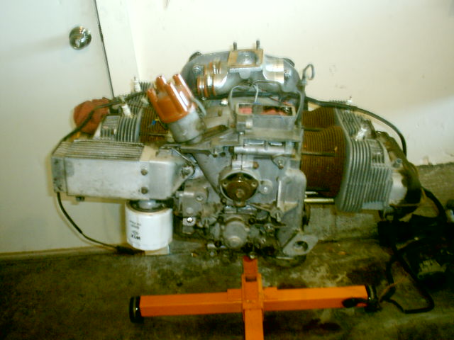

(IMG:http://www.914world.com/bbs2/html/emoticons/aktion035.gif) thanks for all the comments, heres a pic of my motor, took it out and dressing it
