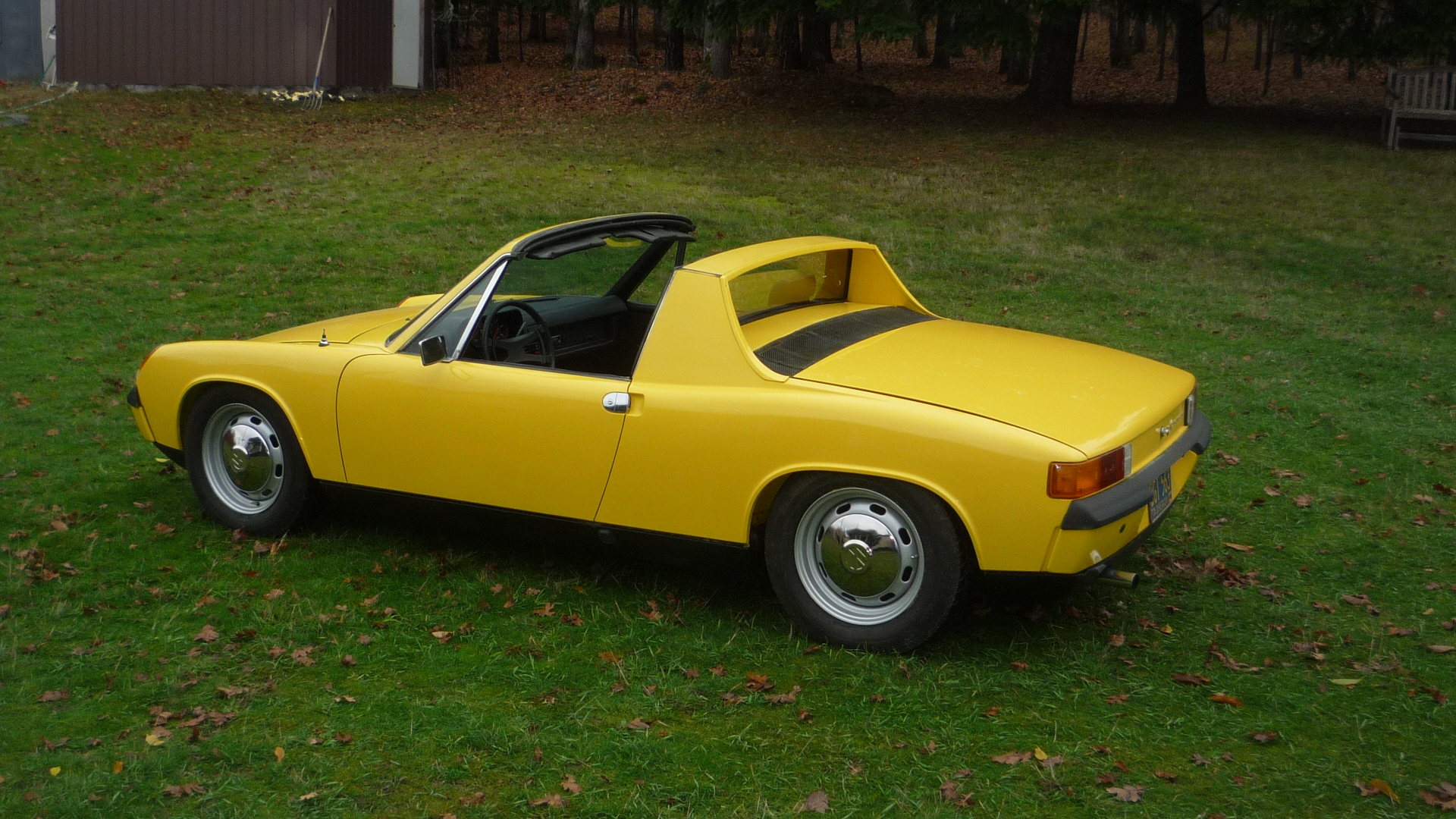

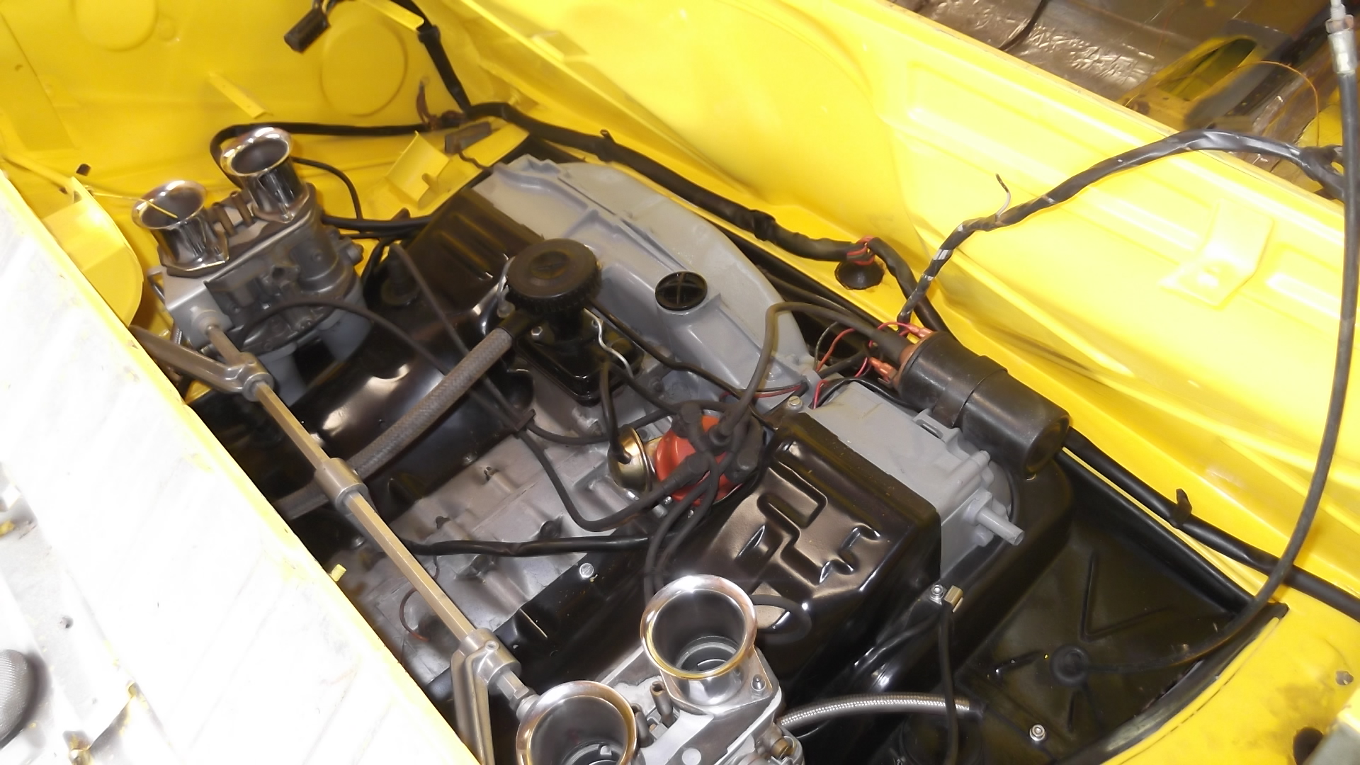

I have a 1.8 carbureted 914 Euro Spec but the Dellorto twin duo Carbs were added aftermarket. Still pretty cool nut and bolt retro mod Euro Spec Restoration

Is that a hex bar linkage? From the factory? (IMG:style_emoticons/default/biggrin.gif)

QUOTE(Elliot Cannon @ Oct 7 2017, 01:02 AM) *
Nope. This 914 originally had L-Jet FI.
CARBS and linkages were added during the Restoration.
