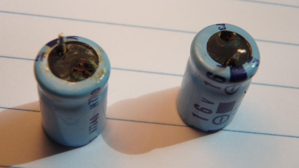

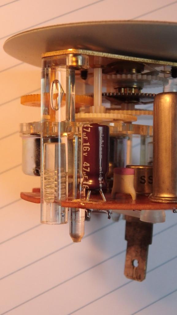

Lmaze   1974 914 2.0 Clock Repair - I removed my clock fac...   May 3 2020, 12:33 PM
Lmaze   I forgot to mention you do not need to take any ot...   May 3 2020, 12:40 PM

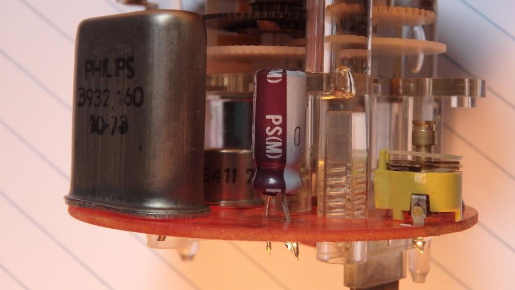

Lmaze   Update: I picked up the new capacitors today (16V ...   May 4 2020, 03:11 PM

Superhawk996   Be aware the solder on the two legs that pop apar...   May 3 2020, 04:59 PM

Lmaze   Capacitors commonly deteriorate over time. I'm...   May 3 2020, 06:35 PM

Superhawk996   :headbanger: Nice job. Glad it's working an...   May 4 2020, 05:21 PM
Lmaze   :headbanger: Nice job. Glad it's working a...   May 4 2020, 05:47 PM
Lmaze   :headbanger: Nice job. Glad it's working ...   May 4 2020, 05:49 PM
