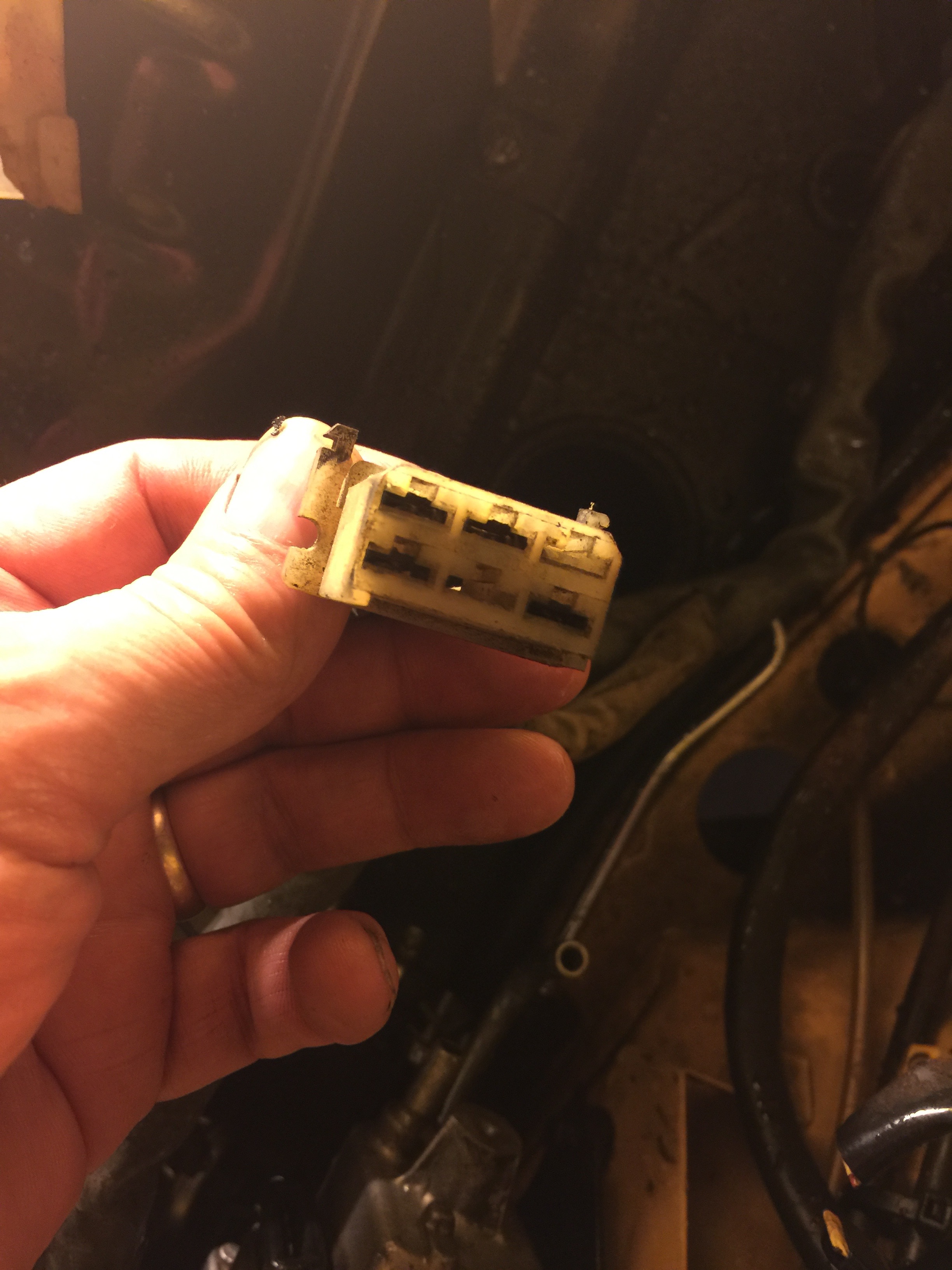

I am converting my 1.8 to a factory 2.0 with an engine swap with harness and ECU. Will my resistor pac from my 1.8 work for the 2.0?

Not completely sure of the question. Are you going to D-Jet for the 2.0? D-Jet doesn't use a resistor pack like L-Jet on the 1.8.

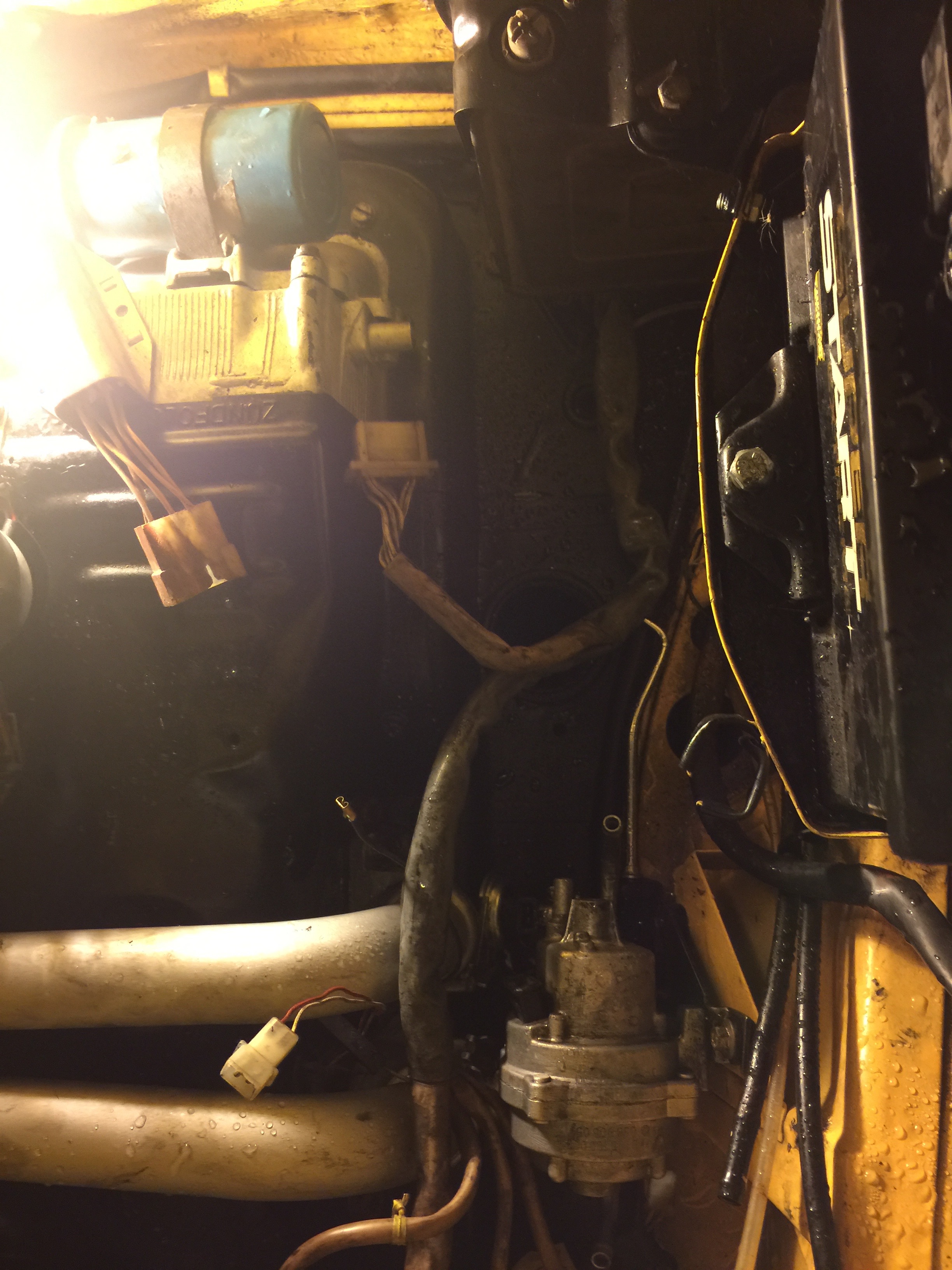

Yes it is a d jet, I have a white wide blade connector near the battery that i am trying to determine what it plugs into. Look like the same plug for the resistor block??? (IMG:style_emoticons/default/confused24.gif)
Robert
My 75 1.8 resistor block did plug into the socket, so I'm confused ? It was thinking the Djet did not use resistors
-Robert

The one wire single wide blade should be in a single pole box housing. It connects to the cyl head temp sensor near cyl 3.

its the first connector coming of the ECU wiring harness

OH. You have an FI harness from a 1975-76 2.0L CA-only model, which includes the speed limiter accessory. Even though it has the same connector as an L-jet resistor pack, DO NOT PLUG IN THE RESISTOR PACK. You can run without the speed limiter, just leave that branch dangling with nothing connected
