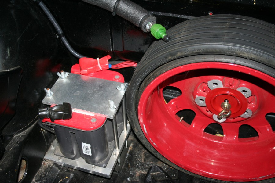

those collapsible spares were the standard spare tire in the 944's (maybe other Porsche models, too). Very light and usually pretty easy to find.

Interesting. It looks like it can be stored vertical in the fronttrunk.
