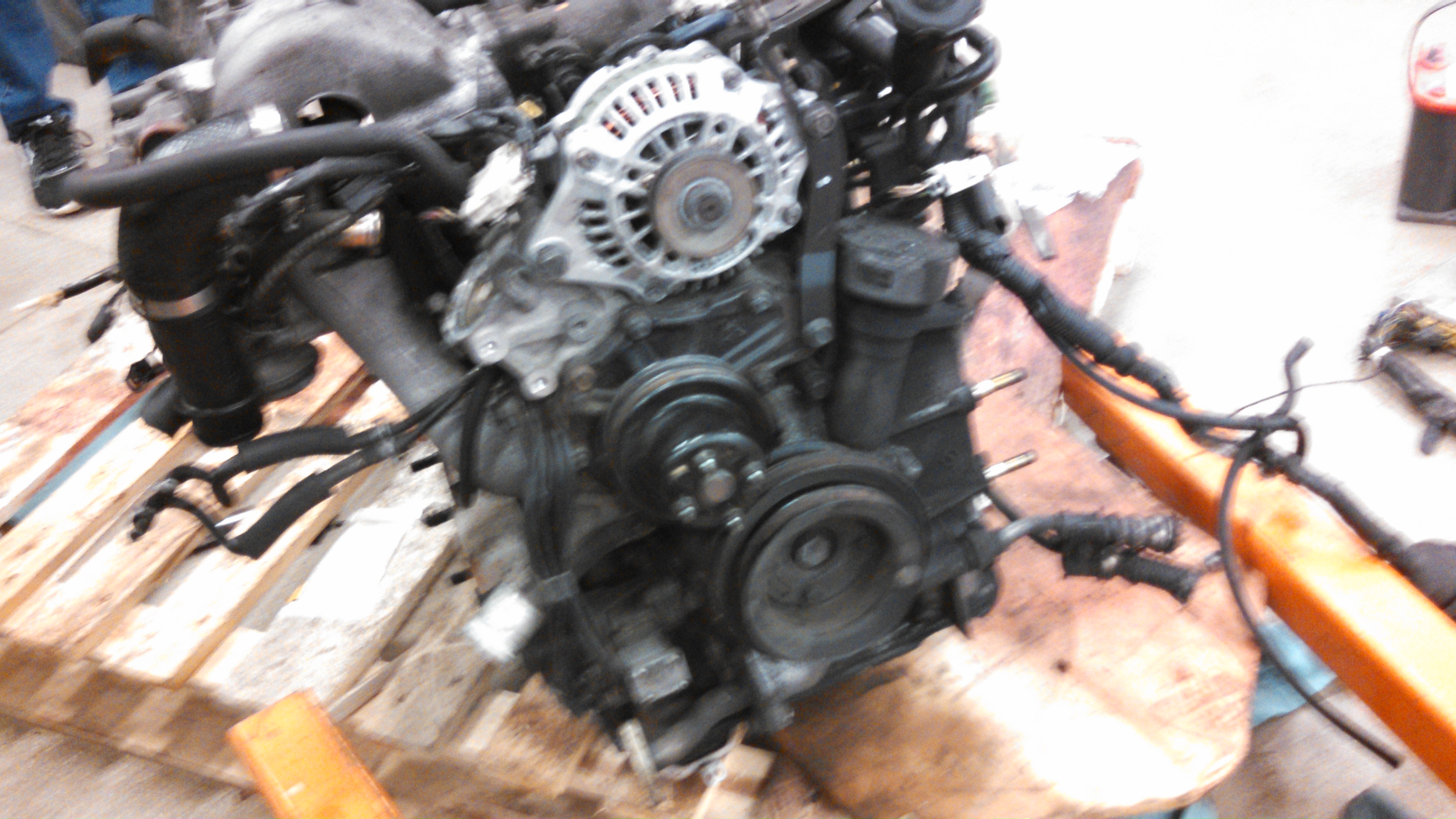

Hi guys, just a quick update on our 13B 914 swap. We've started getting our engine prepped. Took off unnecessary stuff like P/S pump, smog pump, AC compressor. We also did a compression test. Our compression tester is kinda janky in that it wont hold pressure, but we measured 55-58psi in the front rotor and 55-60psi in the rear rotor. We got our Kennedy adapter plate (IMG:style_emoticons/default/smile.gif)
Up next we're looking at other deletes. So I was looking for your opinions:
Any reason Not to do OMP delete?
IAC / ACV delete?
EGR delete?
Rats nest? <-all the vacuum stuff under the TB
I guess what Im getting at is, what are the barebone needs to run a 13B?
Hi Burrelks!
Post some pics, I would love to see another rotary 914, it's one of the rarest conversion IMHO.
The rat's nest under the TB can be eliminated, get some vacuum caps and plug all the holes up, if it's smog related you don't need it. You should not delete the OMP (oil metering pump) unless you plan to pre-mix 2 stroke oil in your fuel. Rotary engines need some oil to lube the seals. I would keep the IAC unless your fuel injection does not control it.

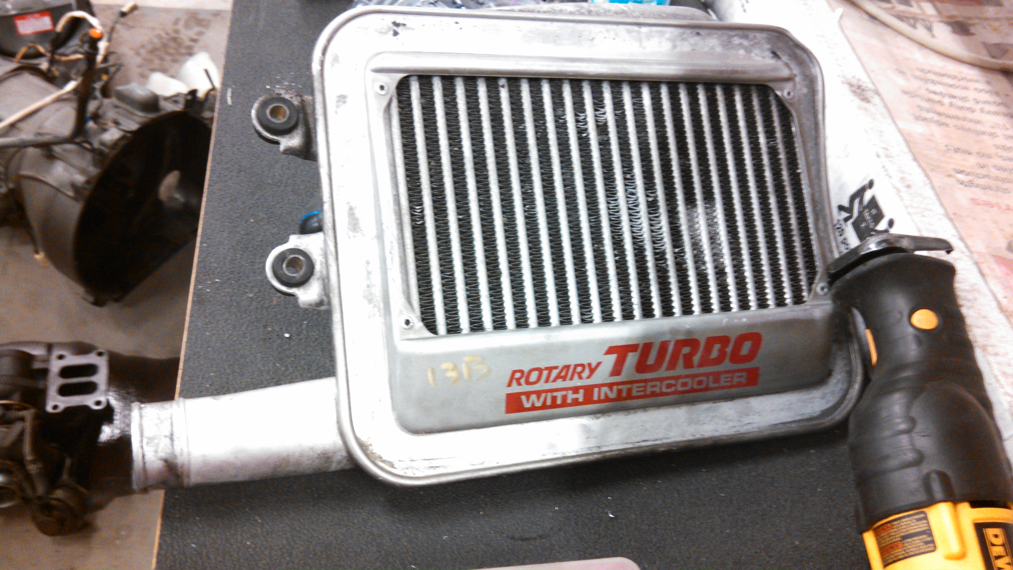

oh and our 13B came single turbo-ed. I believe its an s5 (IMG:style_emoticons/default/smile.gif)

I am using that engine too! without the turbo/intercooler (for now) I have about 1000 miles since I got her running.

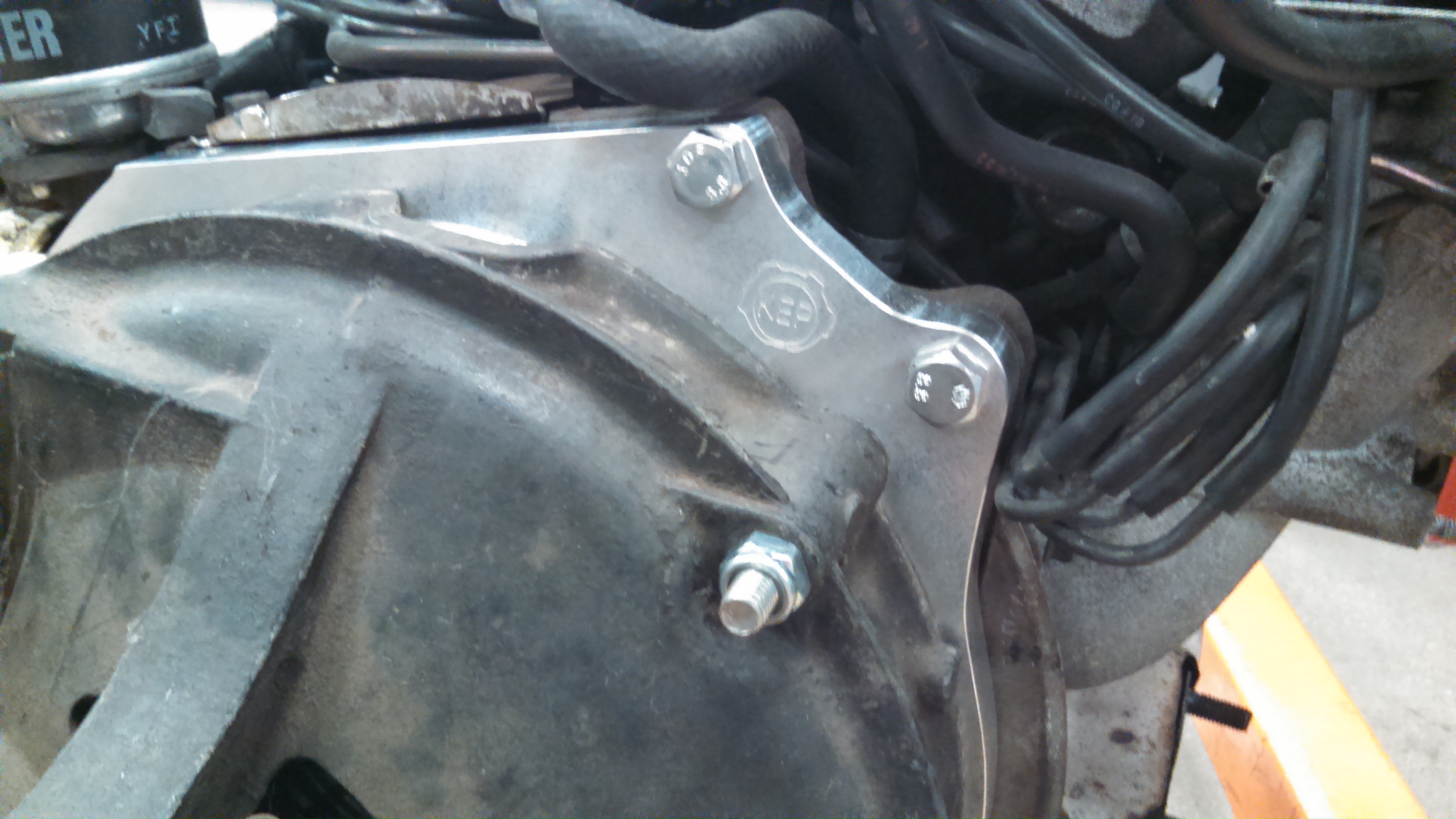

so im in the process of putting the rotary in the car. but I cant get the porsche trans on the rotary. I bought a kit from Kennedy. Put the adapter plate one, put the pilot bearing in. But i just cant get the trans all the way on.
Any help is appreciated.
Thanks,
Kyle

did you use the clutch disc alignment tool to line the splines and the pilot bearing up?

So to align the clutch, i used an old input shaft, and that didnt seem to fit in all the way either. So I might pull the pilot bearing from the VW type 2 and see what that looks like.
Thanks for the speedy responses guys! Really appreciate it!
