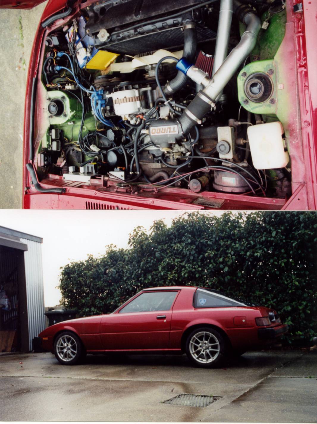

here is my old 7 good engine though not pretty, would be better in a 914 (IMG:http://www.914world.com/bbs2/html/emoticons/w00t.gif)

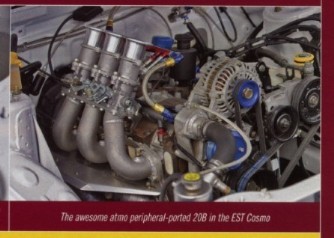

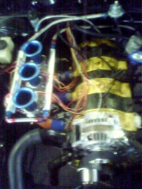

this a 20b pp with 55mm injection

the porsche i have,i have been told ran a 13bpp with the reed valves (this is not bullshit either) but was removed offered bag loads of cash the second pic is a 13b series5 j-port TURBO complete with auto

I'm putting a 3 rotor peripheral port engine into my 914. I just got all the parts I need for the rebuild ($3400 Canadian. Yikes!) The 3 rotor (20B) engine only came in the Mazda Cosmo that was available in Japan and Australia. The Cosmo was a high end luxury car along the lines of a Lexus or BMW. If you want an engine you have to get one from a car at the wrecker. Mostly what you are buying the engine for is the irons and e-shaft (crank shaft). You can use 13B/13B-REW housings, rotors, bearings, etc on your rebuild. I scored a spare e-shaft on e-bay for $500 US just in case the one in my core engine needs to be replaced.
As for the 4 rotor there indeed was one made by the factory. It came in the famous Lemans winning race car called the Mazda 787B. It still is the only japanese car to ever win at Lemans. Shortly after it won they restricted or banned the rotary from competition and will likely be the only time a rotary wins at Lemans. There are a couple of companies that make 4 rotor e-shafts but they are not cheap. A friend of mine is going to work at the #2 rotary engine builder in Japan and he had the opportunity to buy a 4 rotor e-shaft.....for only $9000 US. What a bargain! (IMG:http://www.914world.com/bbs2/html/emoticons/wink.gif) He figured that it would cost him around $30,000 Canadian to build a 4 rotor perpherial port engine and that is with him doing all the labor for free. Custom e-shafts can be bought from both Japan and in New Zealand/Australia. There is a company called "Scoot" in Japan that has a 4 rotor RX7. Do a search on the web for them and you should find several videos of the car. I have them saved to disc but would need someone to host them if you can't find them elsewhere.
banksyinoz: Good to see you again. I thought you mentioned that the 20B PP was running 51 mm throttle bodies and I asked why they went smaller than the 55 mm that I had purchased for my car. In this thread you mention they are using 55 mm throttle bodies. Which one is it. Not trying to start anything. I just want to know what they were using and if it was the 51 mm units did they have a good reason for not going bigger. It could be important to know on my build up if I am going with the wrong throttle body.
