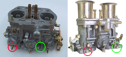

OK I always had Webbers so I new how to adjust them. Now I have Dells and how do you adjust them. (IMG:http://www.914world.com/bbs2/html/emoticons/confused24.gif) Everyone says its like adjusting weber, but they look different. The red circle on the weber is the Air Bypass adjusting screw, while on the Dells it has what looks like a vacuum nipple. The green circle both seem to be the mixture screw? The Dells are recessed and it is hard to get a screw driver in.

You are correct.

I figured the mixture srew was fine, but what about the red circled nipple, should that be connected to a vacuum hose? My dizzy doesn't have a vacumm connector, if it is for vacuum should it be blocked off

Hi,
Ports for manometer. If snugged no need to be capped.

OK but whats a monometer? Can I get a womanometer.

believe it checks manifold vaccumm pressure.
