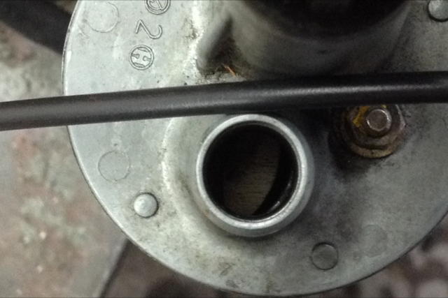

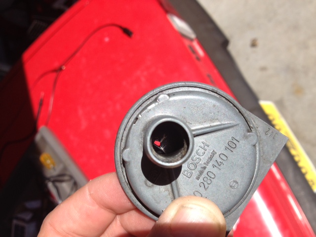

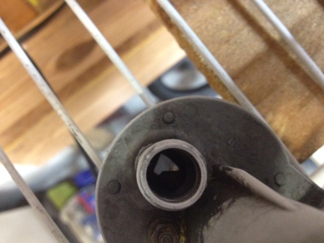

I have had my AAR off of my car and the hose connections plugged for about 6 months now. But it is getting cold and it has been recommended that I put it back in service. So I tested it. And took some pictures along the way. I did the FREEZER test and it opened.
I sat it in the sun. Very warm exterior case. Kinda tuff to hold it. It absorbed a good bit of heat.... and almost closed.
Then I broke out my handy dandy 12v drill battery and within a few seconds it was closed.
here is the question..... I tried to blow thru the closed hole and had ZERO problem doing that. So I suppose when closed that NO AIR should pass thru, correct? Will the PB Blaster cleaning help, or is this baby done for? Any ideas on fixing?

If you can blow thru the AAR after it fully closed, then it's time to junk it and get another.

The force of blowing air through the AAR far exceeds the vacuum from the plenum; all the L-Jet AARs i’ve Used allowed air to pass through when I blew into it.
The real test, ow that you know it functions, is to install it and start the engine. With a cold motor, RPMs are gonna start out higher than normal idle. The warmed engine will drop RPMs to the idle setting

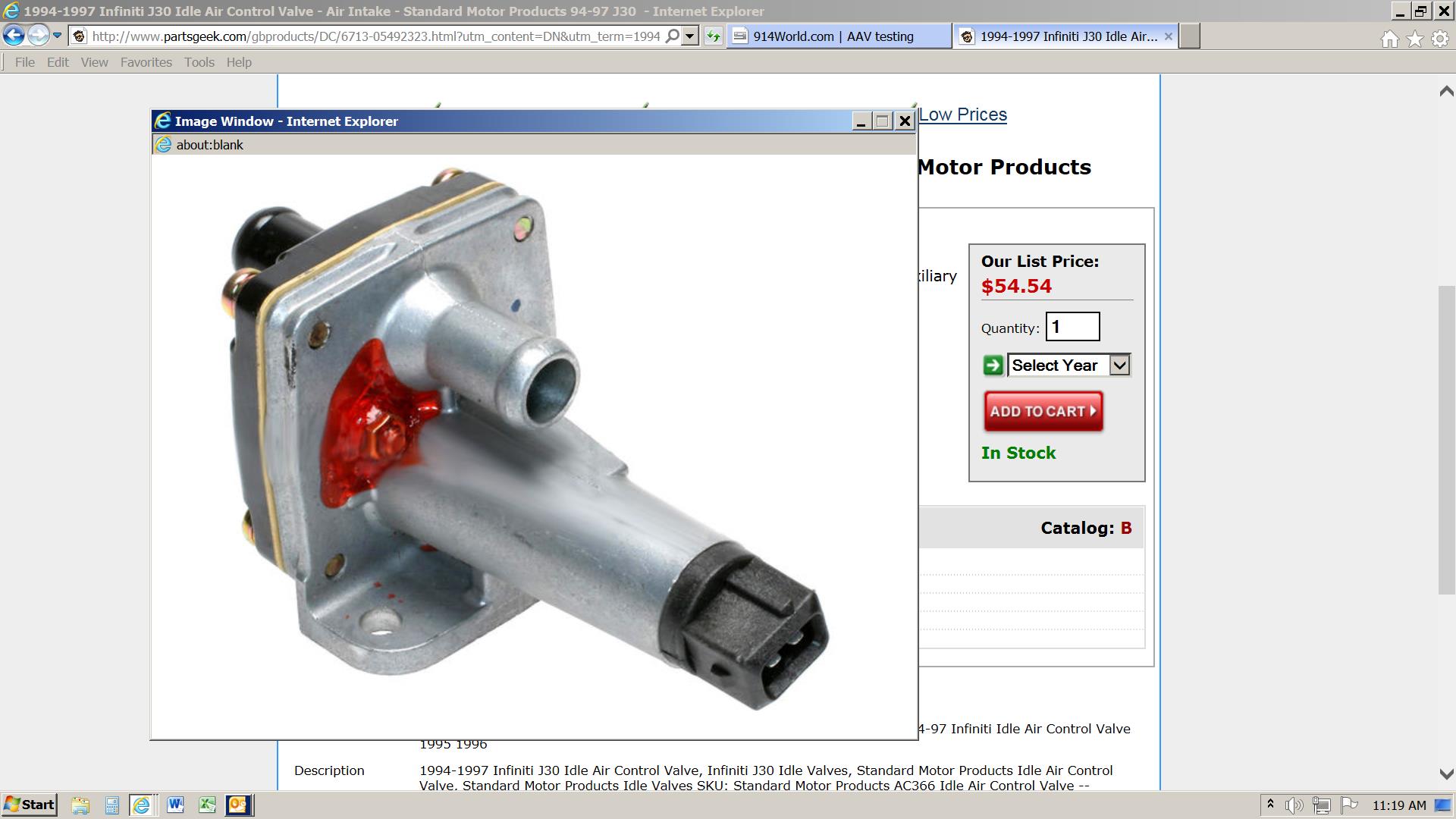

I believe that early 944 ones can be adapted to work. Probably not the correct amount of air bleed versus temperature and/or time, but better than nothing.

(IMG:style_emoticons/default/agree.gif) looks like the early 944 one (<85.5 ),I believe the Audi ones are the same also.

It is not designed to be closed completely. There is still a small amount of airflow through the AAR even after it is closed.
Just the way it was designed.

Like Jim and Clay said, same when i still have my 75 1.8 Ljet. the AAR is just like yours, it will closed but if you blow air, you can feel some that will pass it.

OK, I have an update, thanks to Philip W. He sent me a valve. I fully bench tested it.
Freezer.... door opens fully.
Room temp..... door is open maybe 3/4.
12v drill battery wired to the connectors..... door closes fully in less than a minute
The final bench test is the blow thru test. I could NOT blow thru the valve. So I would say that this valve is not designed to allow air to flow thru when closed.
So while my former valve operates.... when fully closed it has a good sized leak. I suspect that once Philip's valve is installed I will get a better, more consistent warm (hot) idle.
