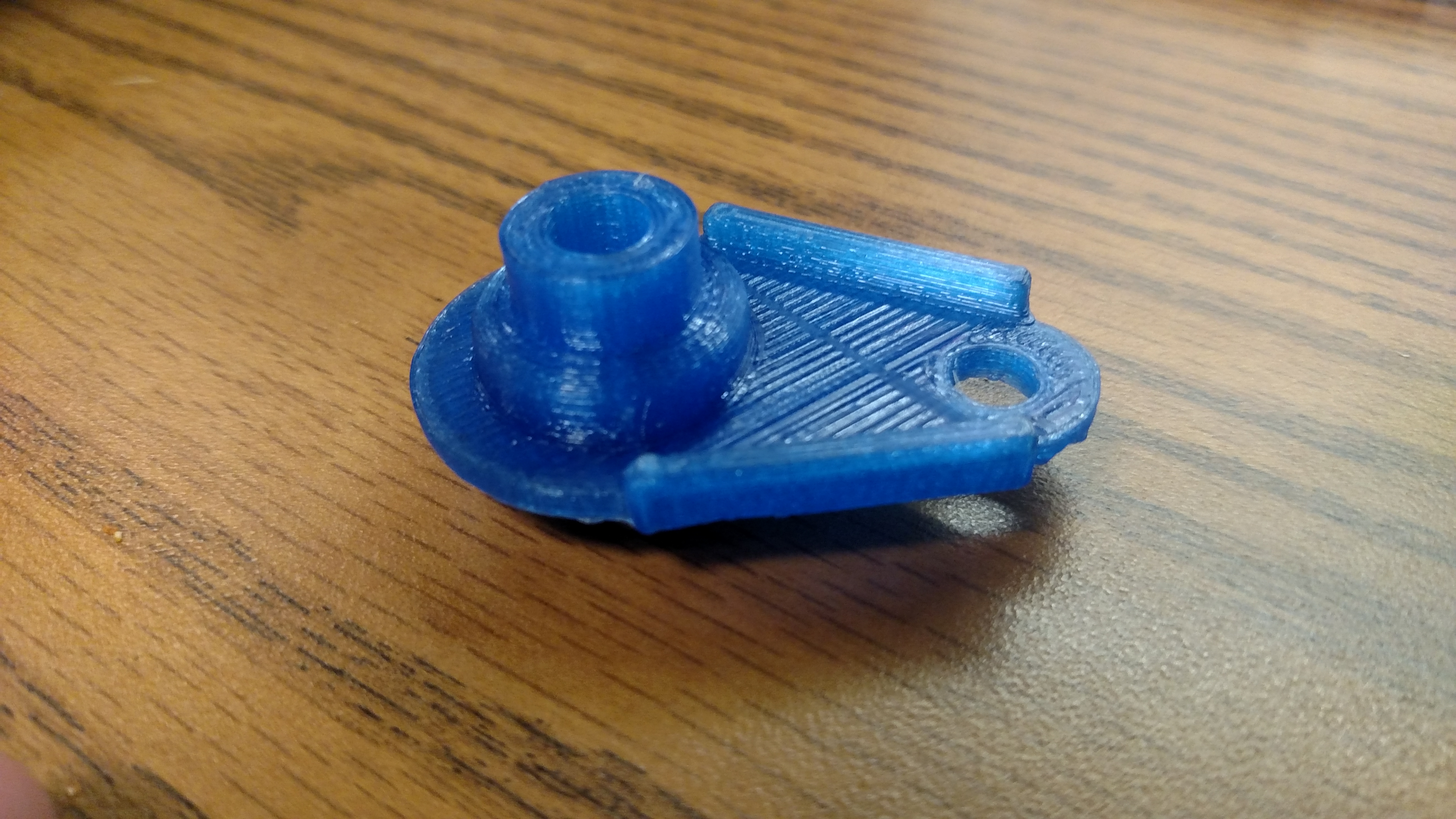

Printed on a Makergear out of PETG.

QUOTE(Zimms @ Oct 23 2017, 04:06 PM) *
What does the other side look like? I printed one copy laying down like that with PETG but the support was nasty and the bottom surface needed a lot of work. I printed the one shown before standing up. I printed 2 parts to slow down the layer time but the top of the 2 parts still needed more time per layer.
