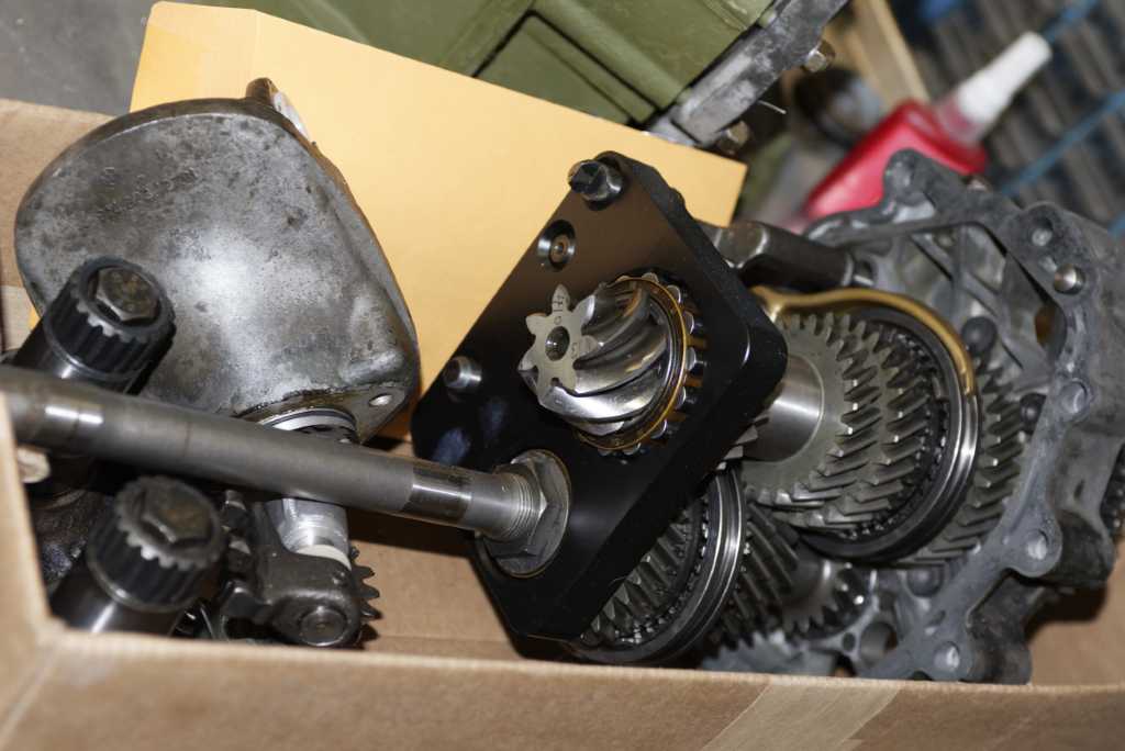

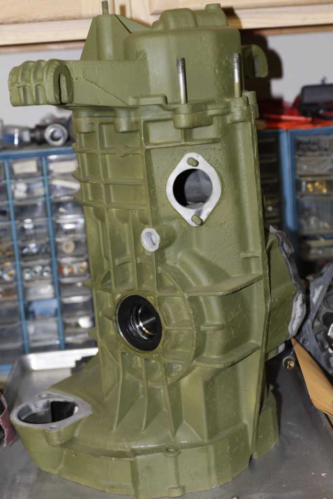

I'm looking forward to tomorrow. Last major piece of my 3.2 conversion that needs to be done before the motor can go in. The case and stack are ready for the magic to begin. Attached ImageAttached Image

QUOTE(eric914 @ Oct 20 2017, 12:46 PM) *
Eric, looking forward to tomorrow! Gonne be cleaning the shop tonight (IMG:style_emoticons/default/biggrin.gif) I sent you an email, did you get it? Got 2 on lookers wanting to swing by if OK with you. Ill PM ya.
