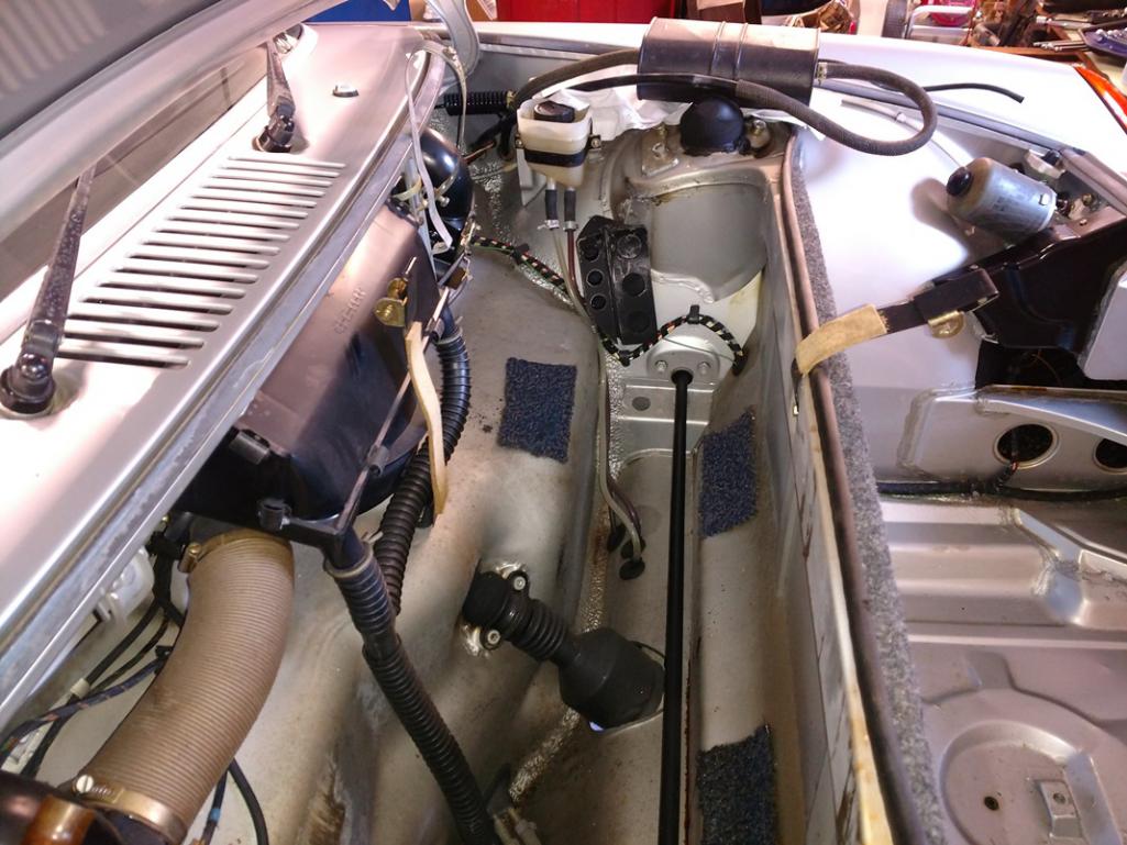

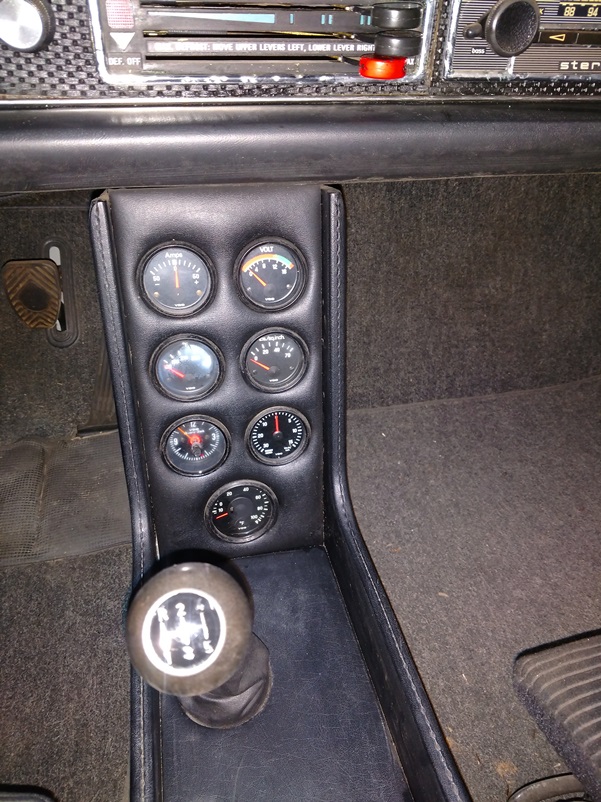

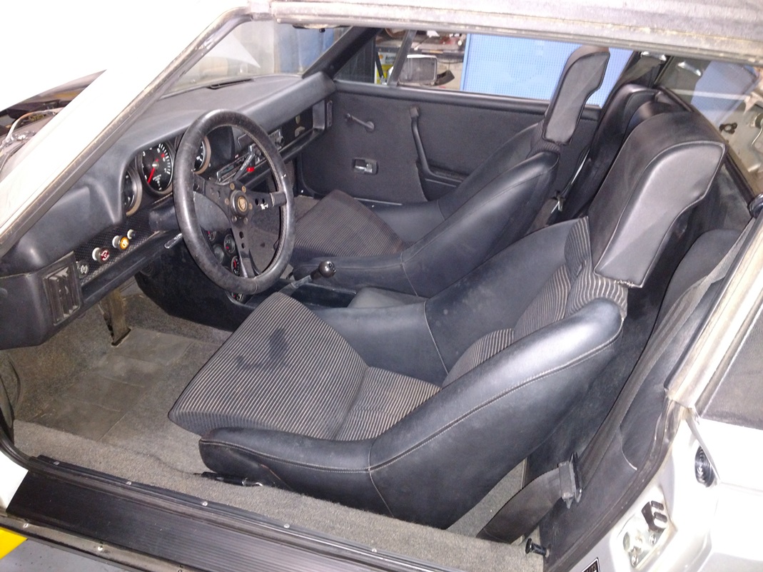

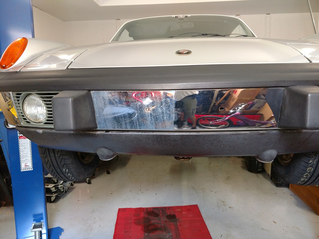

Ruprect006
post Oct 25 2017, 11:03 PM
Posts: 10
Joined: 15-October 17
From: Pensacola, FL
Member No.: 21,511

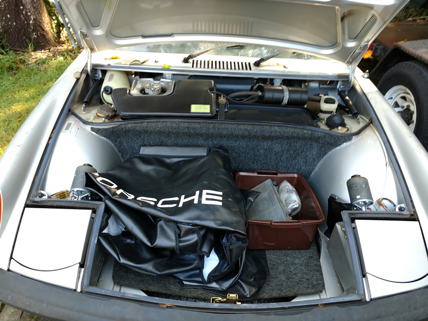

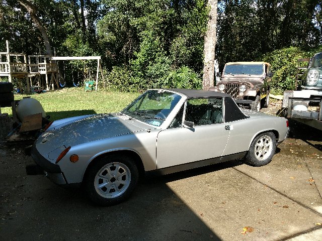

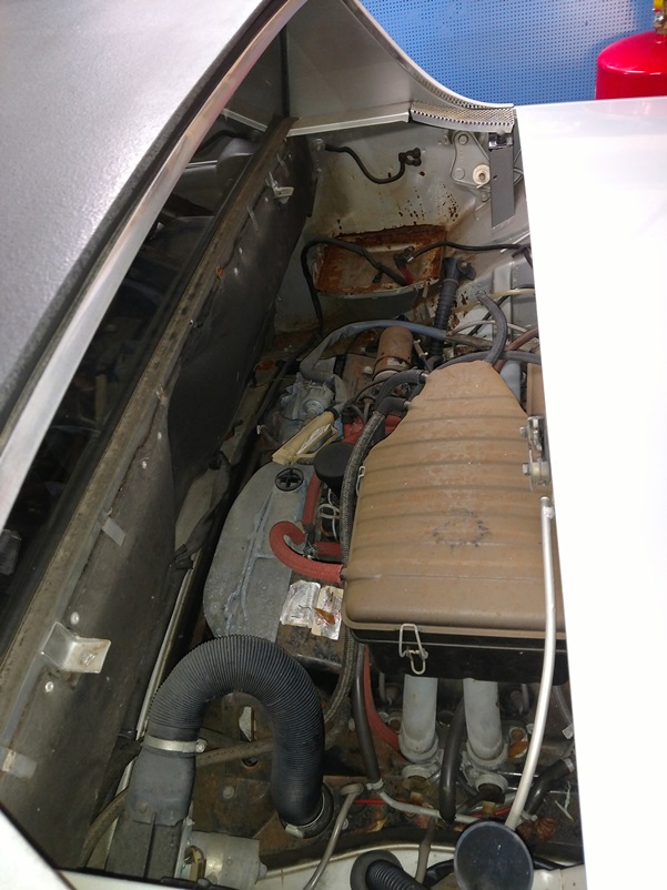

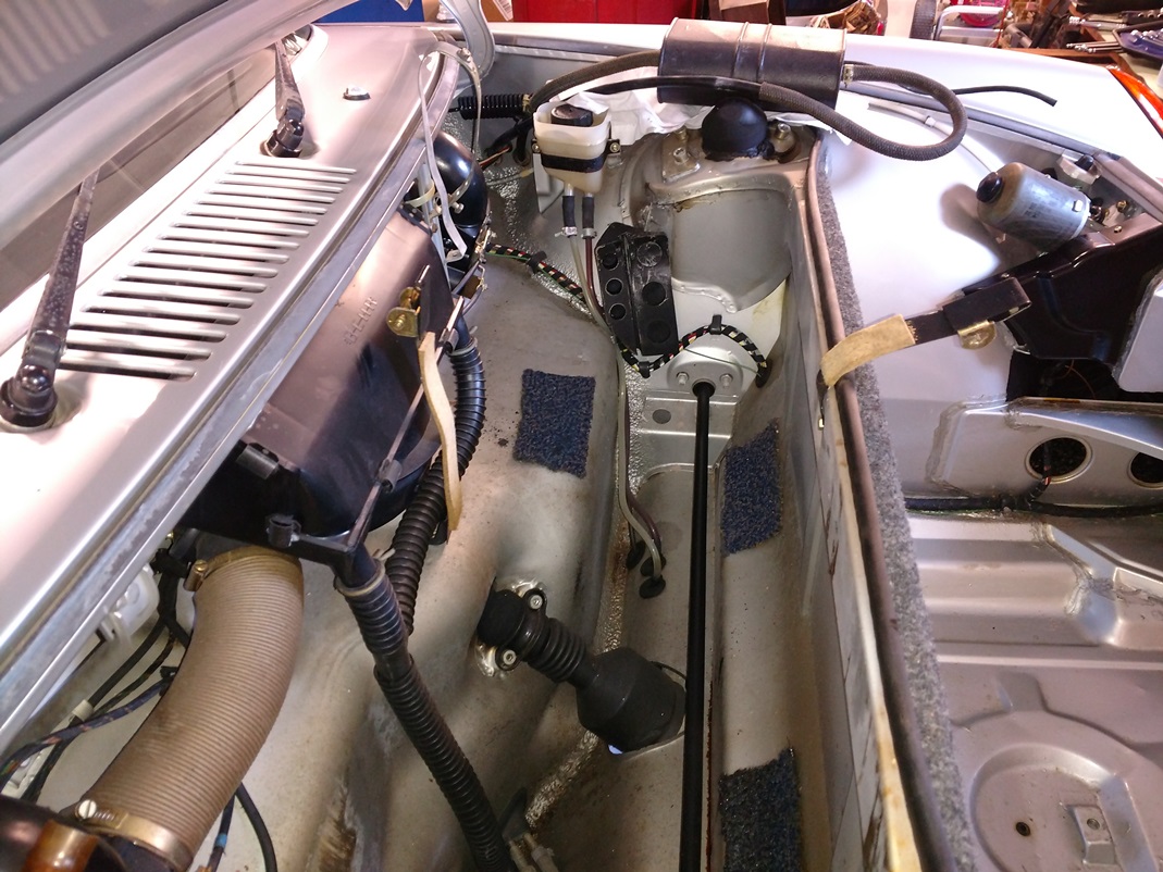

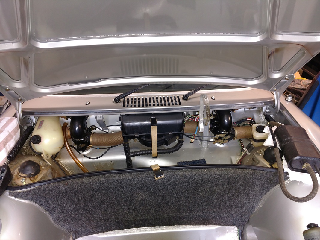

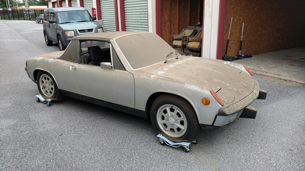

I am sorry for the delay in this post. I had some work stuff come up and got stuck out of town.
So, Wow! Thank y'all for the comments and insights! That helped me with what to do next.
I ordered the first round of parts. I have a reman fuel tank, new sending unit, gaskets, fuel screen strainer, fuel tank seals large and small, gas cap, SS lines kit, lower and upper fuel line kits, fuel filter, fuel pump, sway bar bushing set, and bosch wiper blades all due to show up tomorrow or Friday for installation this weekend.
I was able to talk with my uncle briefly and get a little more information. While the car is very original and confirmed only the 15,506 miles, apparently they put custom Scheel seats in it. My aunt also designed and my uncle installed more gauges in the vertical console. Please see the pictures.
I'm adding several pics so y'all can get an idea of what she looks like.

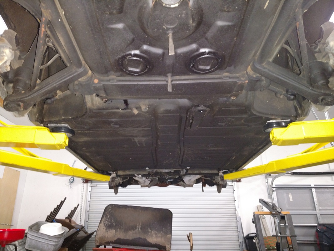

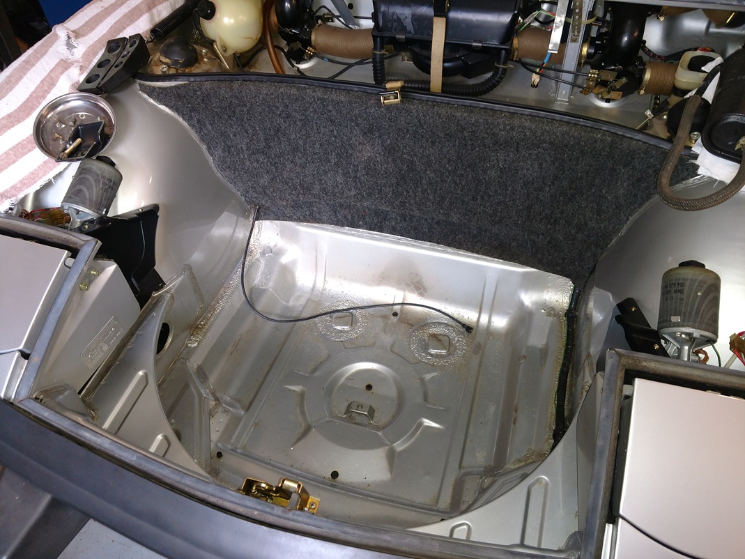

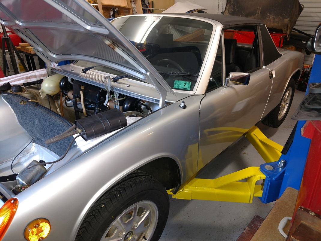

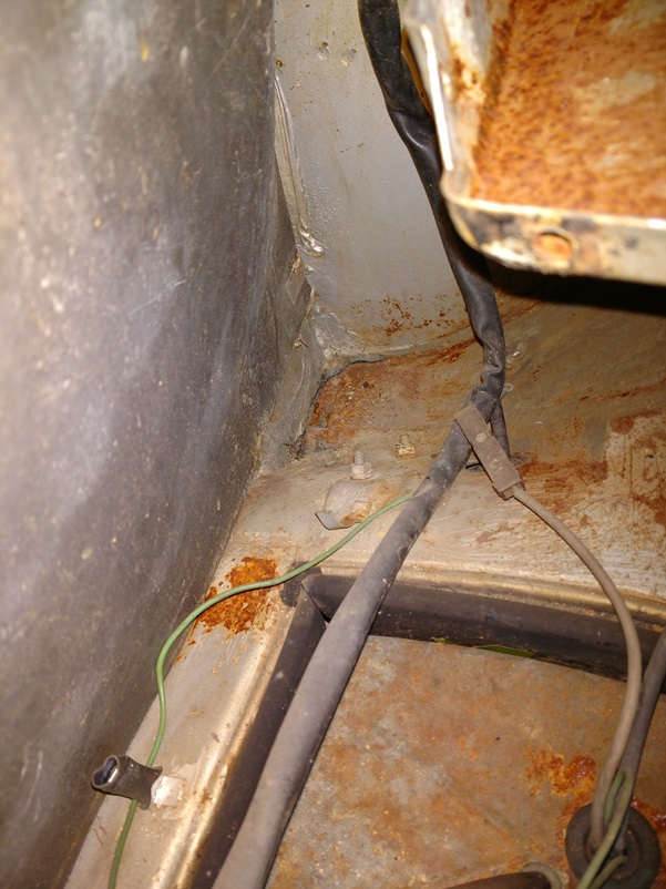

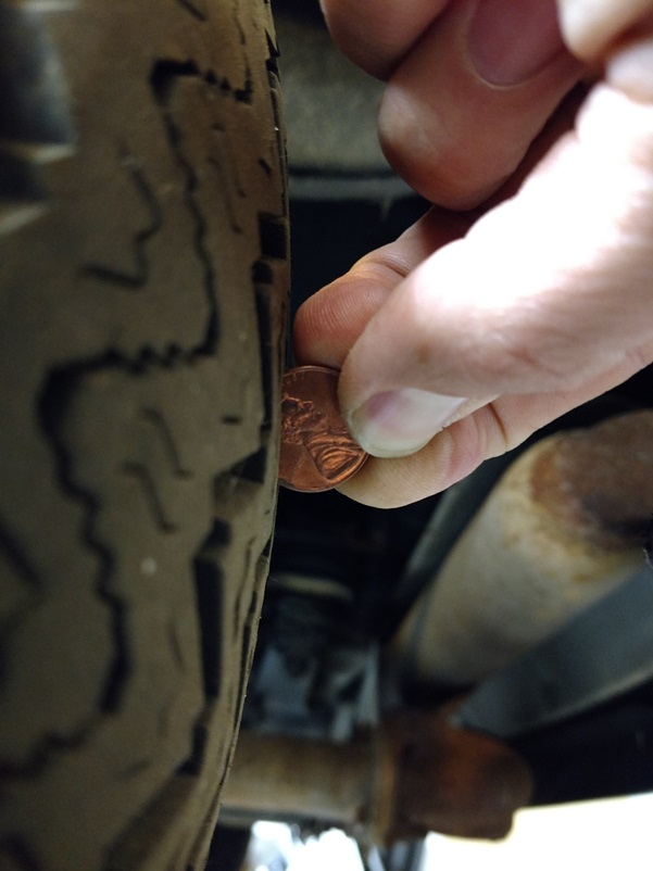

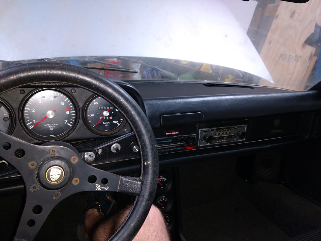

Pictures:
1. Dirty right after rolling out of storage. Correction it was 38 years.
2. Front trunk had car cover and bra for the front.
3. Tire depth left on original tires before changing for new pirelli set
4. Dash and mileage
5. Console and gauges
6. Scheel Seats
7. Before and after chrome scrubbing
8. Underbody
9. Tank out
10. Front trunk area
11. tank area
12. driver's side
13. engine bay (Engine bad cover we believe is in the trunk. Don't have keys yet to confirm.)
14. hell hole
So my next question would be what else needs to be replaced? What else is rubber that should probably go? Other hoses? Vacuum lines? Seals? Bushings?
Regarding brakes, do you think flushing the lines would be good enough, or do calipers and such need to be rebuilt?
Thanks!
Rup
Attached Image Attached Image Attached Image Attached Image Attached Image Attached Image Attached Image Attached Image Attached Image

Sweet seats! If you're wanting to go back to stock myself, and others here, would be interested in them. (IMG:style_emoticons/default/smile.gif)
The car looks like its in great shape-very nice.
ConeDodger
post Oct 26 2017, 09:41 AM
Apex killer!
Posts: 24,099
Joined: 31-December 04
From: Tahoe Area
Member No.: 3,380
Those seats are possibly Koenig. Worth a small fortune but not original. Look for a crown logo on the button sewn into the seat back. They are period correct and hard to find. I’ve seen as high as $600 each for them.
The steering wheel is of course not original.
The appearance group gauge group is of course not original.
If your uncle documented the modifications it’s a plus.
That car with that mileage if it can be documented as accurate, would sell for lots of money in the condition you rolled it out of storage.
Where’s Pat Garvey? He’d tell you you can’t change the air in the tires without ruining the originality! (IMG:style_emoticons/default/evilgrin.gif)
Find a used tank. New ones are not going to be faithfully original. Bdstone914 here will have a decent one for you.

The seats say Scheel on them. Apparently they are now Scheel-Mann
/http://scheel-mann.com/
