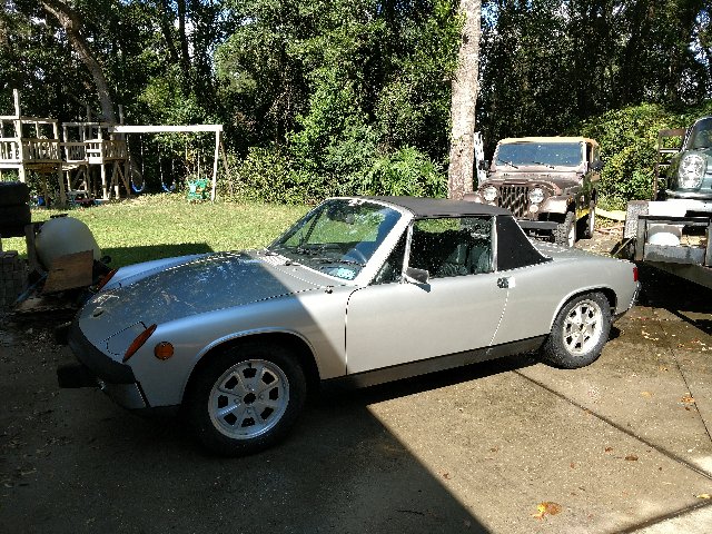

I am new to the 914 scene. I am the proud new owner of my uncle's '73 914 2.0. He drove it off the lot and it is all original. It was in storage for 37 years and I just got it out a couple weeks ago and it is now in my garage. It has 15,506 miles on it.
My questions are about what to do now. I don't want to do anything that would hurt the original condition of it and therefore the value.

Congratulations!! A low mileage 914 comes out of hibernation.
mgphoto
Kiss, keep it stock silly.
Yes update the fuel lines, maybe a 2056 down the line but she has good looking wheels.
Is the paint original? If so DON'T paint it! Buff and polish.
Keep after the little problems that should keep you busy.
She can only be original once.

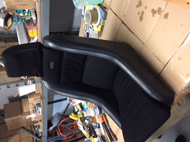

6. Scheel Seats

Sweet seats! If you're wanting to go back to stock myself, and others here, would be interested in them. smile.gif
The car looks like its in great shape-very nice.

Those seats are possibly Koenig. Worth a small fortune but not original. Look for a crown logo on the button sewn into the seat back. They are period correct and hard to find. I’ve seen as high as $600 each for them.

She cleaned up nice!

The seats say Scheel on them. Apparently they are now Scheel-Mann
/http://scheel-mann.com/

Cool find, congrats! The silver cars are a stunning 914 color. I would make every effort to keep this one original also. Or rather return it to original condition as much as possible, because there are already a number of non-original thing about it. How about that hood badge and all the dash switches?
Clean it and clean it some more before you do much more.
