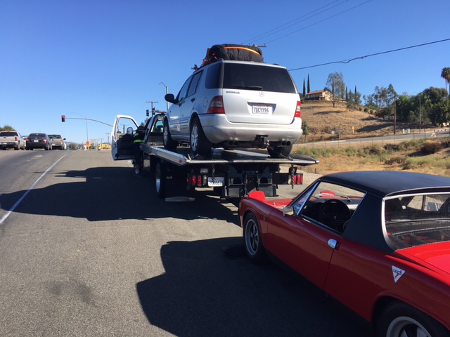

Early one morning recently i decided to drag my car to our place in Scottsdale to do some desert driving as I am sick of the traffic in OC. I started the car as usual and drove it to the back of my tow vehicle. I hooked up the towbar and aux. lights (no attached to the 914's electricals).....
As I made my way towing the 914 up the grade up on the I-10 outside of Redlands, the serpentine belt and pulley gave out on the MBZ and proceeded to leave me going 65 in lane 3 of 5 surrounded by semi's and other vehicles that did not want to let me get to the shoulder. As i muscled the no-power steering and no-brakes conundrum toward the shoulder, the car spewed fluids all over the windshield because, by this time, a piece of the pulley went thru the radiator and windshield washer resivoir trashing them along the way to a fried engine.
I managed to get to the shoulder and calledthe car and A,.... then called AA then AAA............ Eventually Gomer and the flat bed showed up and picked up the dripping ML. He then headed back to Laguna while I prepared to drive the 914 behind him back home.

Keep in mind, I drove the car to the back side of the tow vehicle quite fine. Towing it croaked it? (IMG:style_emoticons/default/WTF.gif)
So I called AA then AAA again.... and low and behold, the same driver and truck came back to hitch my 914 to the back of the flatbed that had my toasted MBZ on it.
