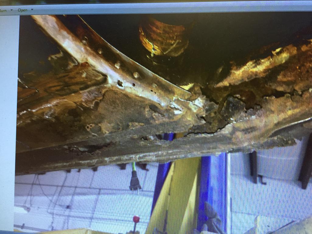

just a reminder of some of the challenges along the way- rear floor , jack points and rear outer longs were swiss cheese thanks to the Ohio winters i believe
