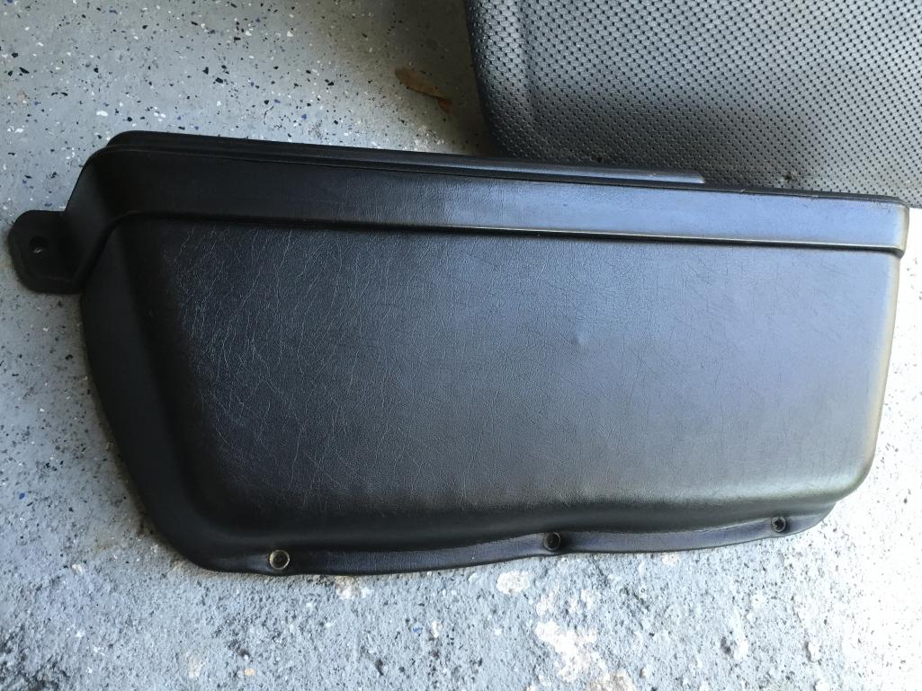

Philip W.   new door panels! these are really like new its...   Mar 5 2018, 08:13 AM
Philip W.   and an undamaged drivers pocket   Mar 5 2018, 08:14 AM
