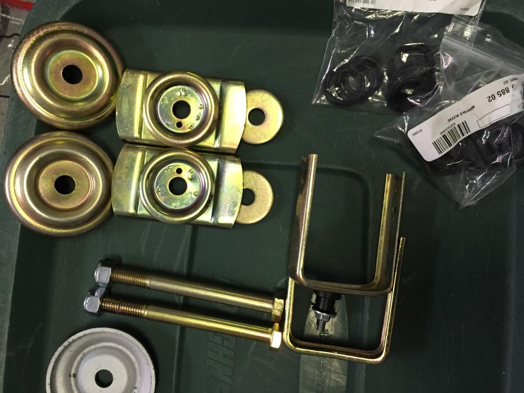

out with old and in with new, new zinc plates parts from BD Stone and some new kind of push rod tube seals from Original Customs!
Mblizzard
post Mar 19 2018, 05:14 PM
Posts: 3,033
Joined: 28-January 13
From: Knoxville Tn
Member No.: 15,438
QUOTE(Philip W. @ Mar 19 2018, 02:05 PM) *
Bruce does great work!
