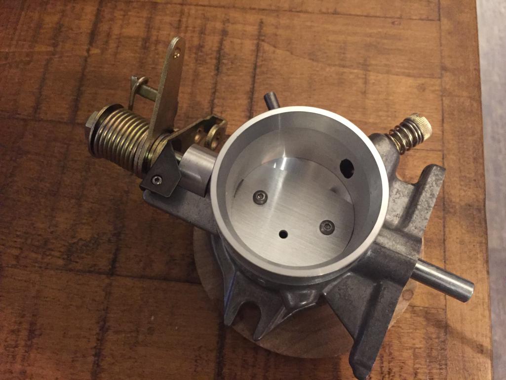

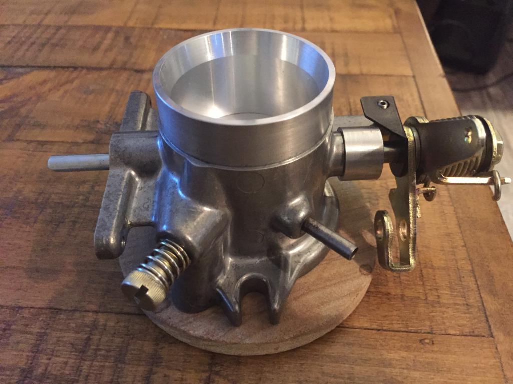

i will bet this throttle body didnt look this good brand new!
just got it back from Phil in NM. so what do you think? I also have a bag of new vac hoses, new TB seal, intake runner seals etc.
i am just buying time waiting foe the body and paint to be done. not updates in that front at this time.
