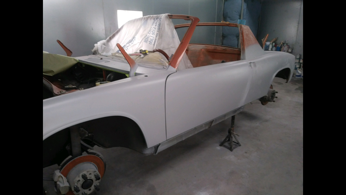

just talked to mike, touch up and repairs done welded geound etc, car had the last block and sand, final prep for paint complete this week, bottom was stripped and reprimed, ready for texture, paint will be shot next weekend!!!!
finally an update worth updating! this was delayed for several reasons, some additional repair, and then weather(humidity etc) and just schedules, but last week the floorpan and bottom trunk were painted, and then the rear trunk and the engine compartment , followed by the firewall inside and out!. The rest of the car has now been taped off and all the outer panels doors etc etc are in process of paint - 3 coats base and 3 clear, I pick up the car on Saturday !! I will post some pictures soon and am finishing up the pushrod tube seals and all the tin replacement on the motor this week so it can go back in the car next week. so many things to do...... I have been gathering parts and pieces over the past 4-5 months as time and money would allow. I am sure I have missed some stuff. I didn't get the chrome bumpers over to get chromed yet and now I am afraid I would not get them back in time to be mounted before the trip to Okteenerfest in Sept. well , that and close to a $1000 or more to get them done- I have a very nice rear early bumper and a nice early front,(also a rough later front with bumperguards). Will see how it all goes but I would like to get new front Sekurit glass and might order this from dealer, not sure how else to do it hear. any advice would be nice.

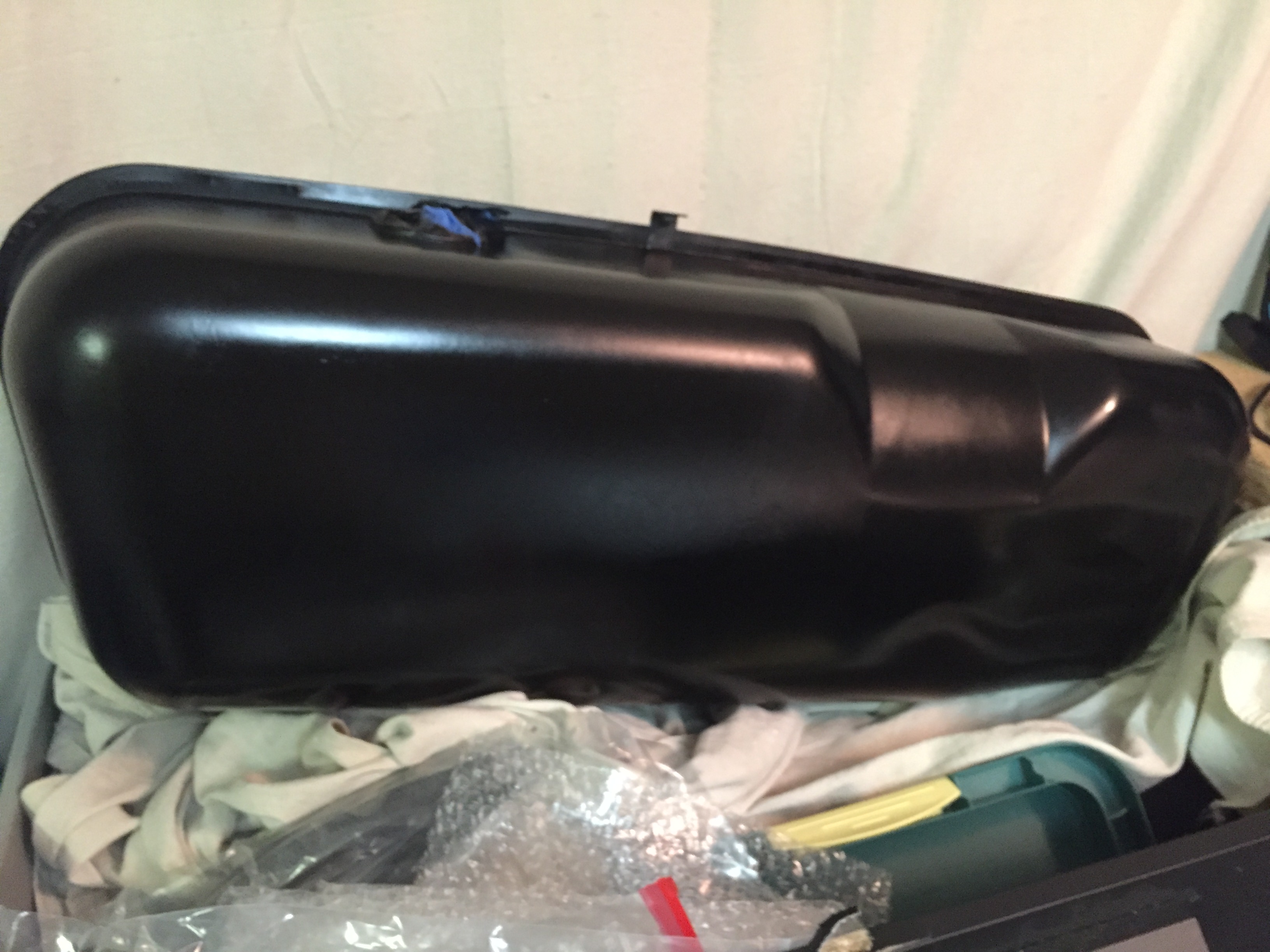

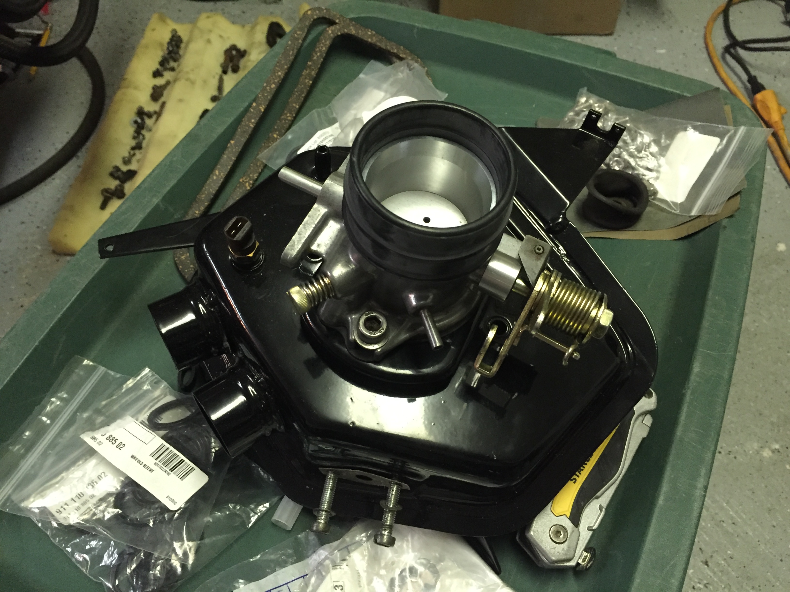

Painted the tank over the weekend, few other bits like fitting the air deflector cooling flaps on the fan housing , and mounted the rebuilt throttle body on the newly repainted plenum. small steps but progress none the less. (IMG:style_emoticons/default/icon_bump.gif)

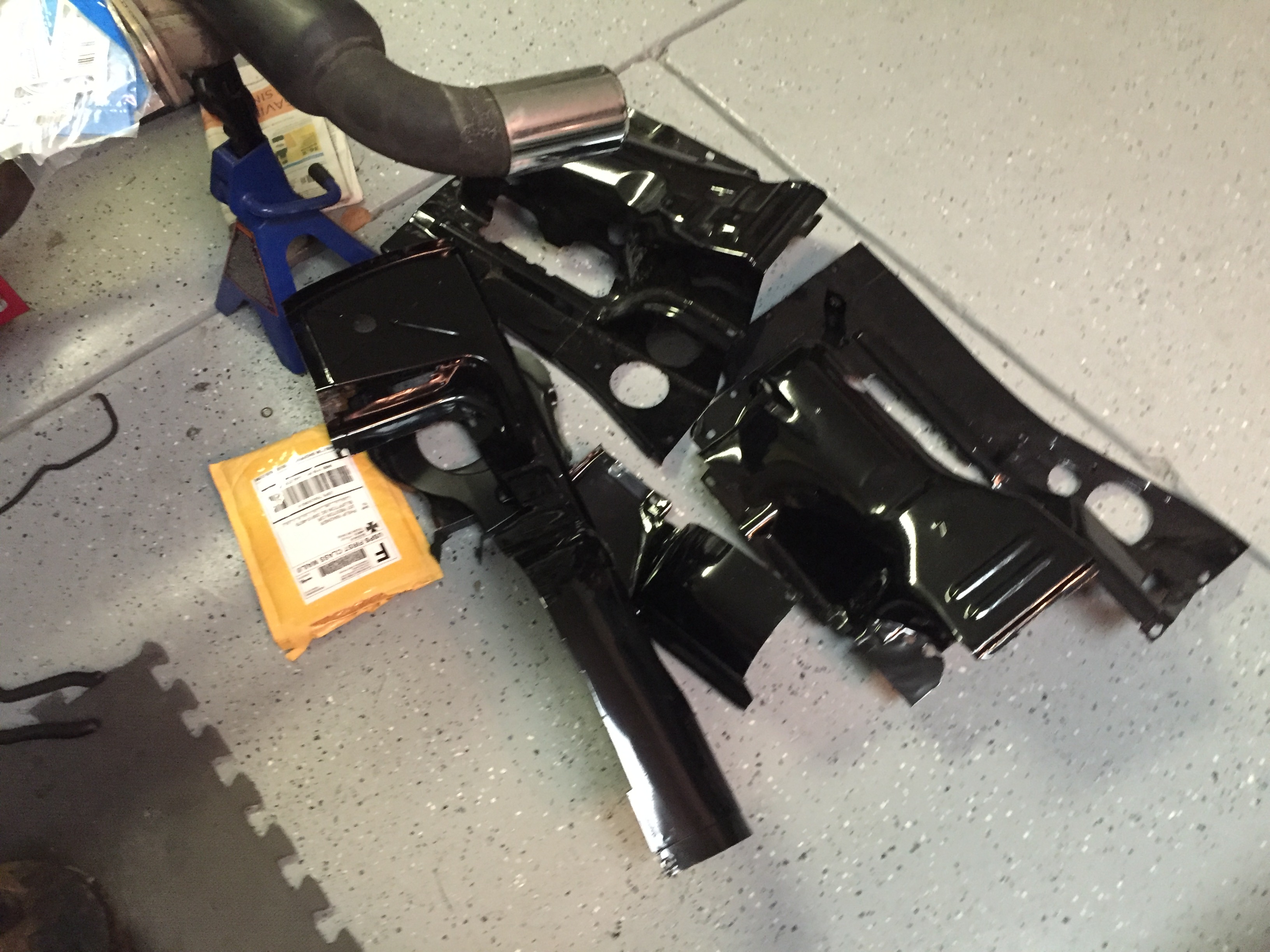

motor refresh assembly progress

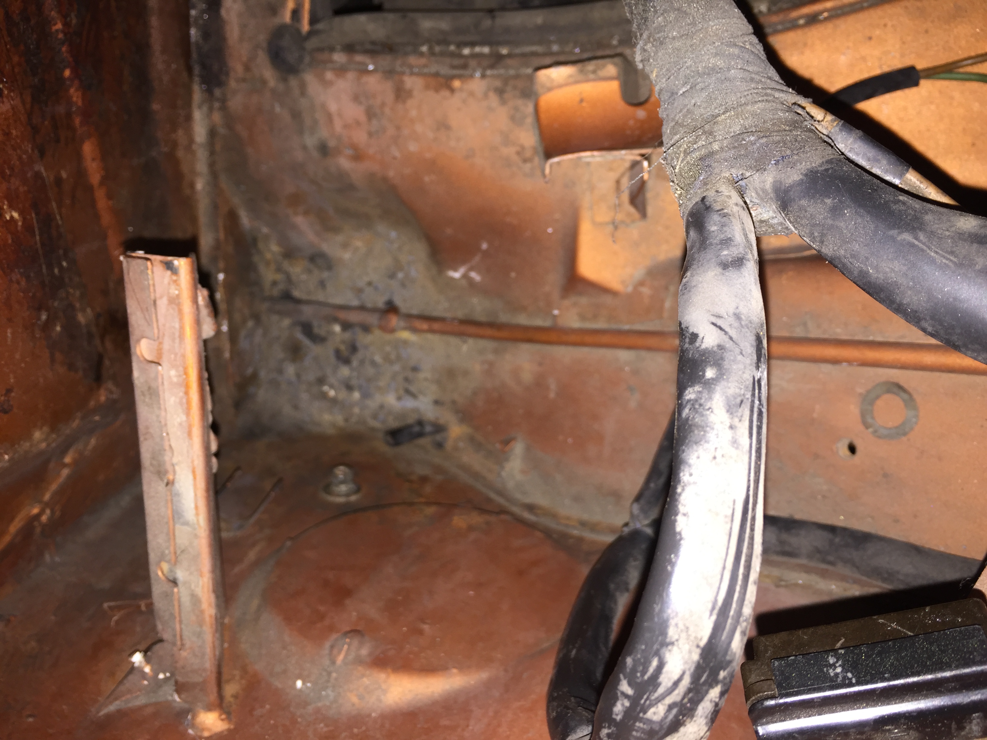

this was last week right before final prep for paint

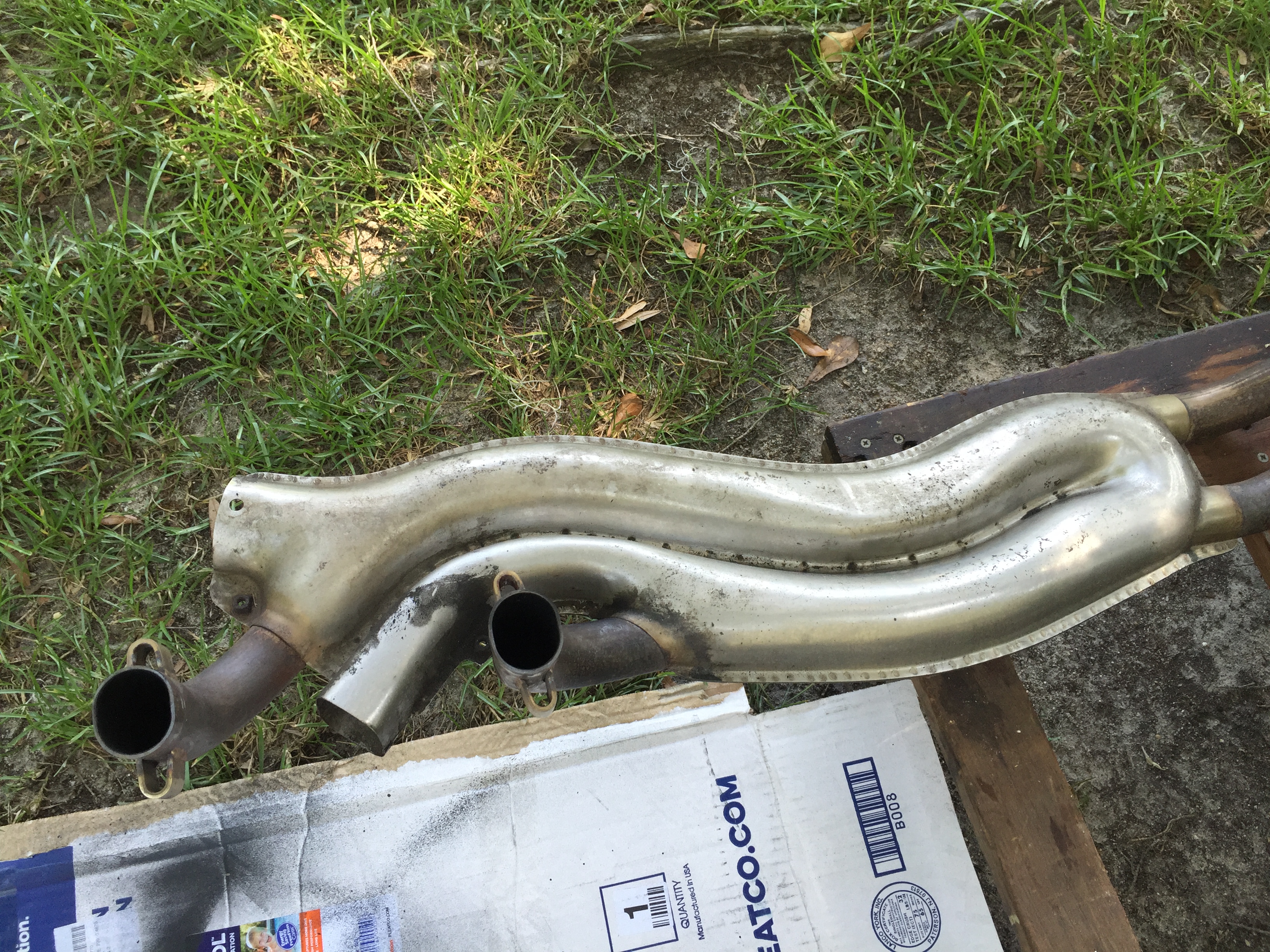

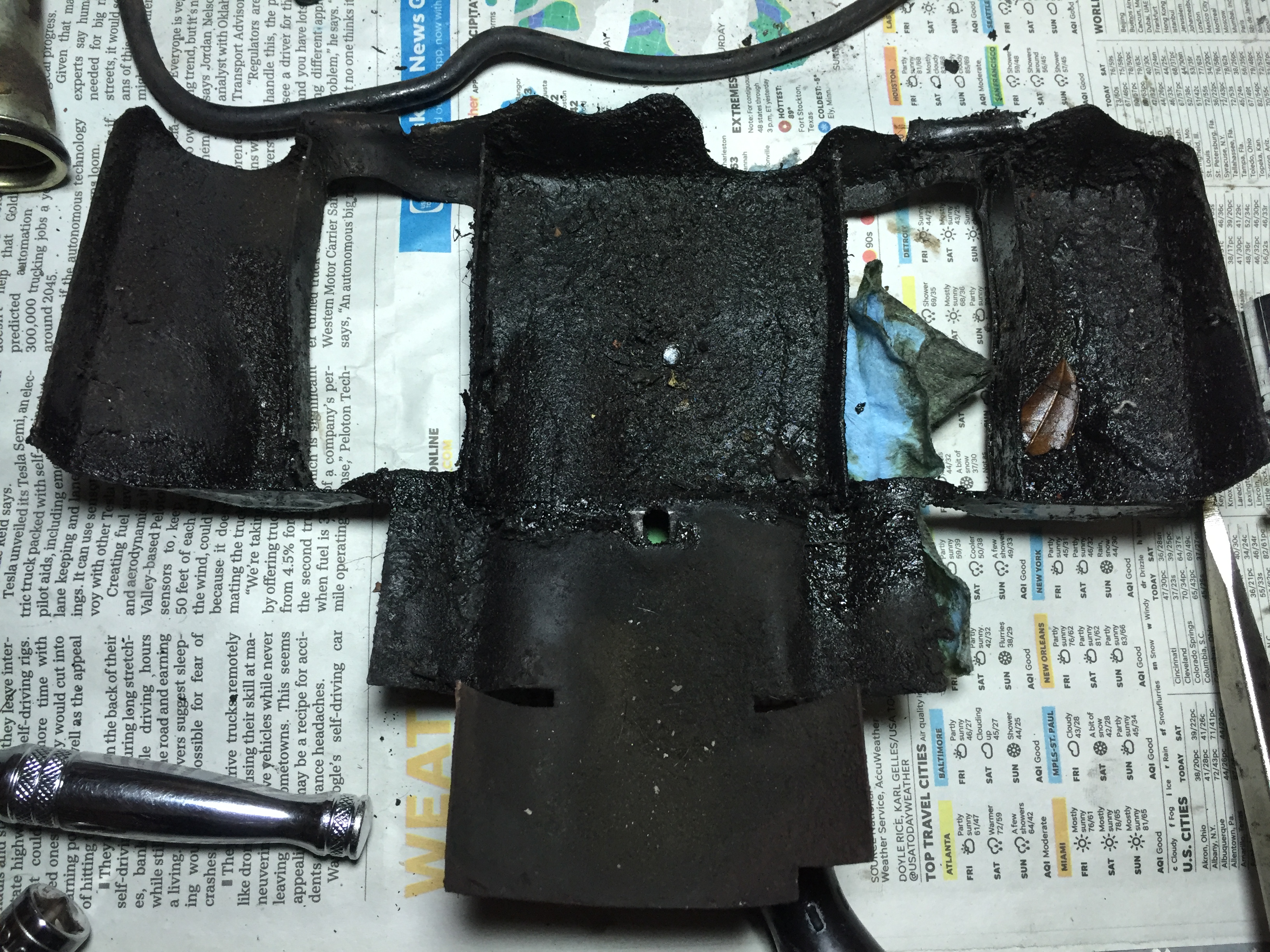

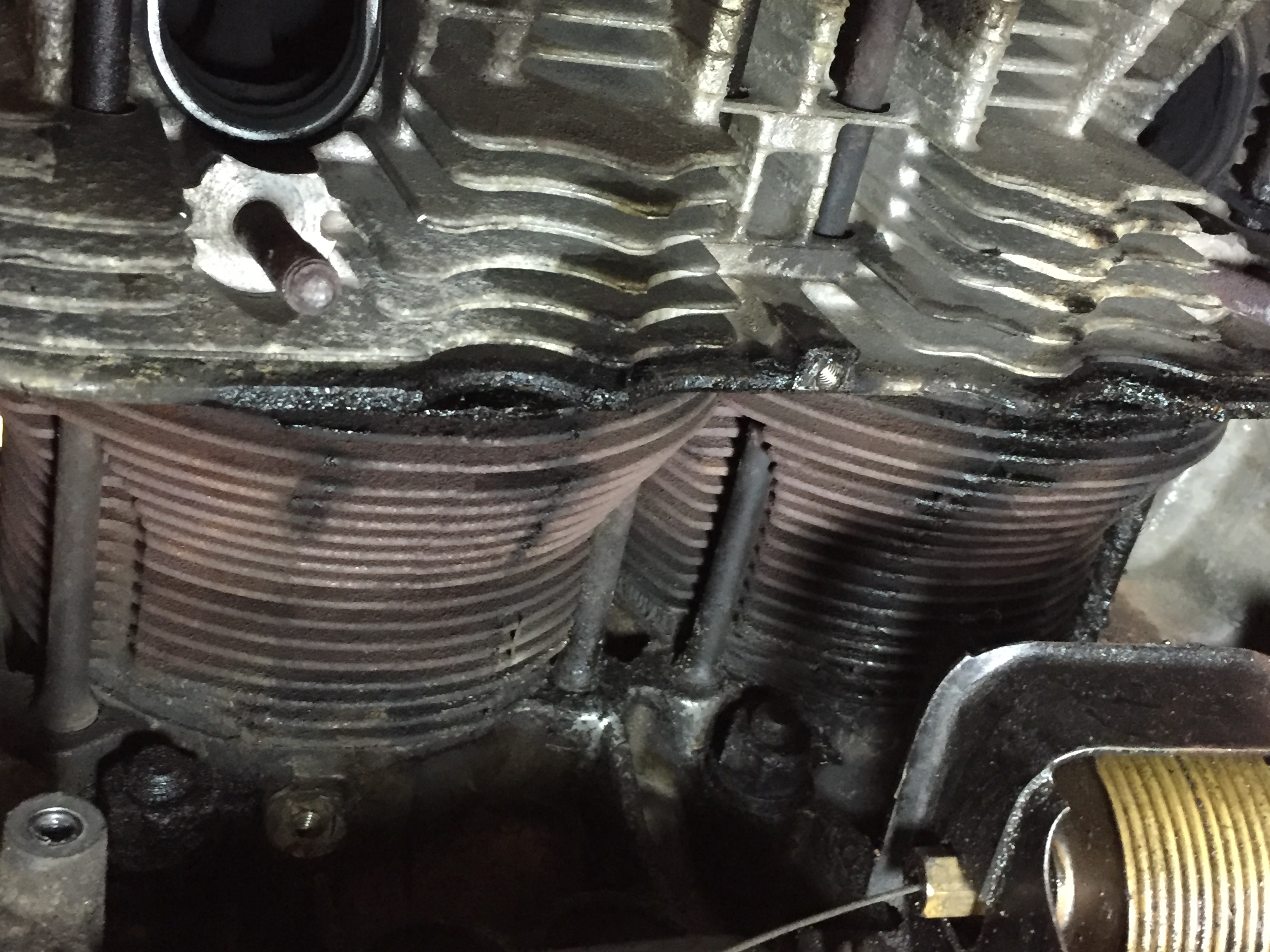

old dirty oily undercylinder air deflector
DRPHIL914
post Jun 28 2018, 08:27 AM
Post #112
Dr. Phil
Posts: 5,971
Joined: 9-December 09
From: Kennesaw, GA
Member No.: 11,106

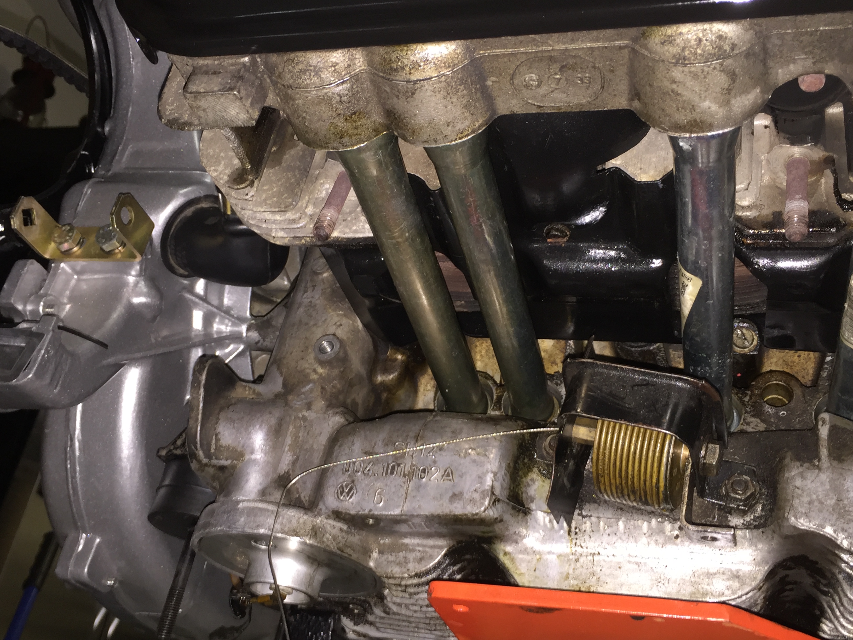

not sure how bad the cylinder head leak is i think this was over a very long time.
new tubes ans seals in place

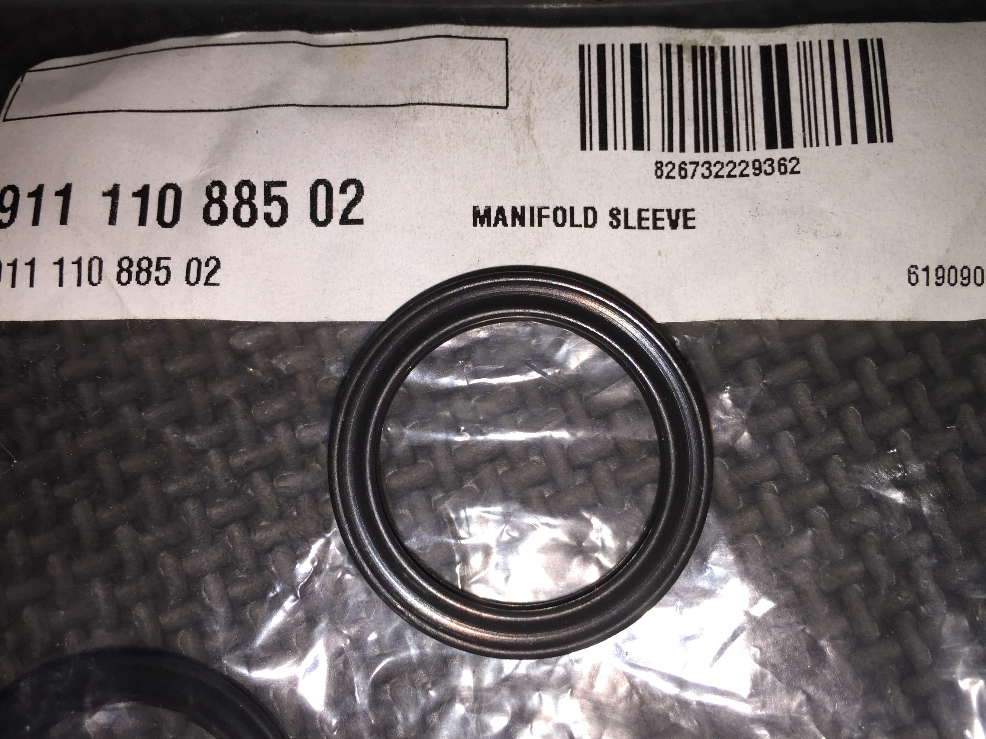

new seals from Mcmark and will see how they work.

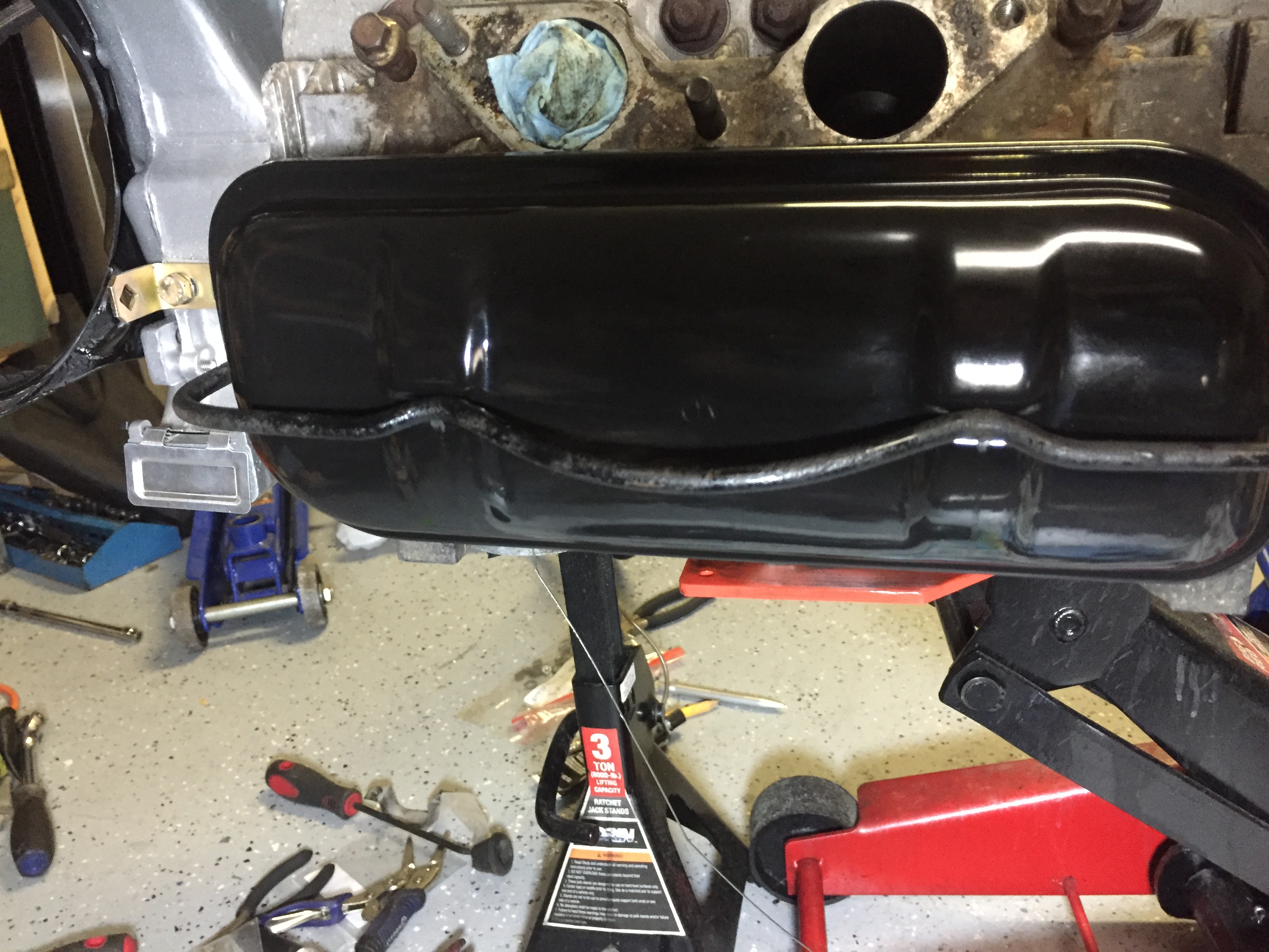

new powdercoated valve covers from Bruce Stone

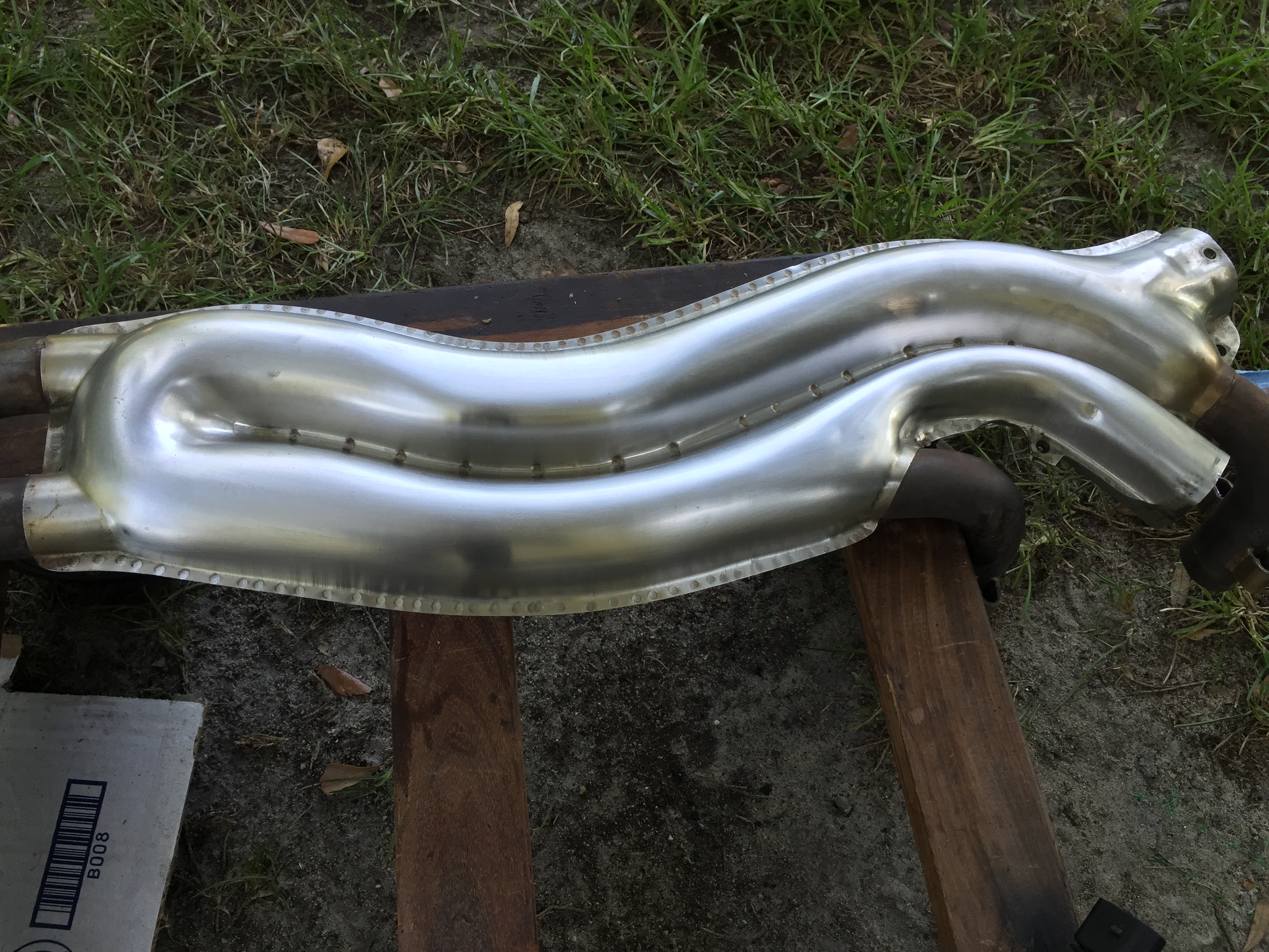

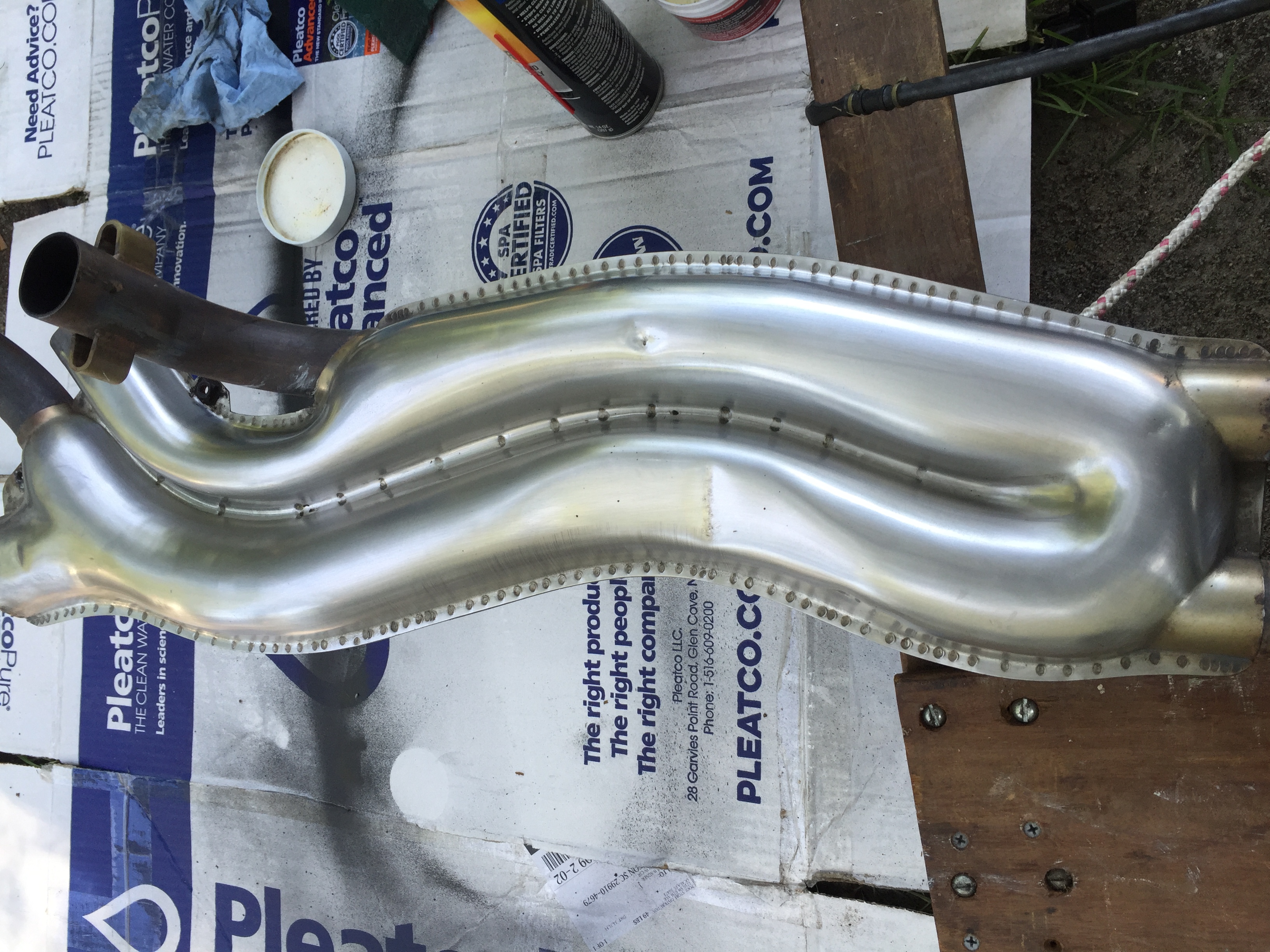

might not see this from below when in the car but still wanted to clean and polish the top side of these

before-- wasnt too bad for 5 years of use

and bottoms just as nice- SS is pretty easy to polish up- green scotch brite pad and some h2o then a bit of Mothers Mag and aluminum polish
