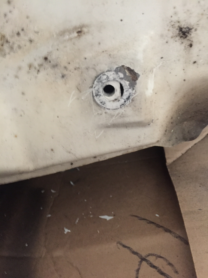

Just holes with nuts welded to the back side. Guys use captured nuts? in the new holes. Riv nuts?
DRPHIL914
post Jul 12 2018, 08:13 AM
Post #182
Dr. Phil
Posts: 5,971
Joined: 9-December 09
From: Kennesaw, GA
Member No.: 11,106
where would the spot be ?

Phil - I’ve got my car apart and will take a pic of the front, specifically the fog light area, for you during my lunch break.

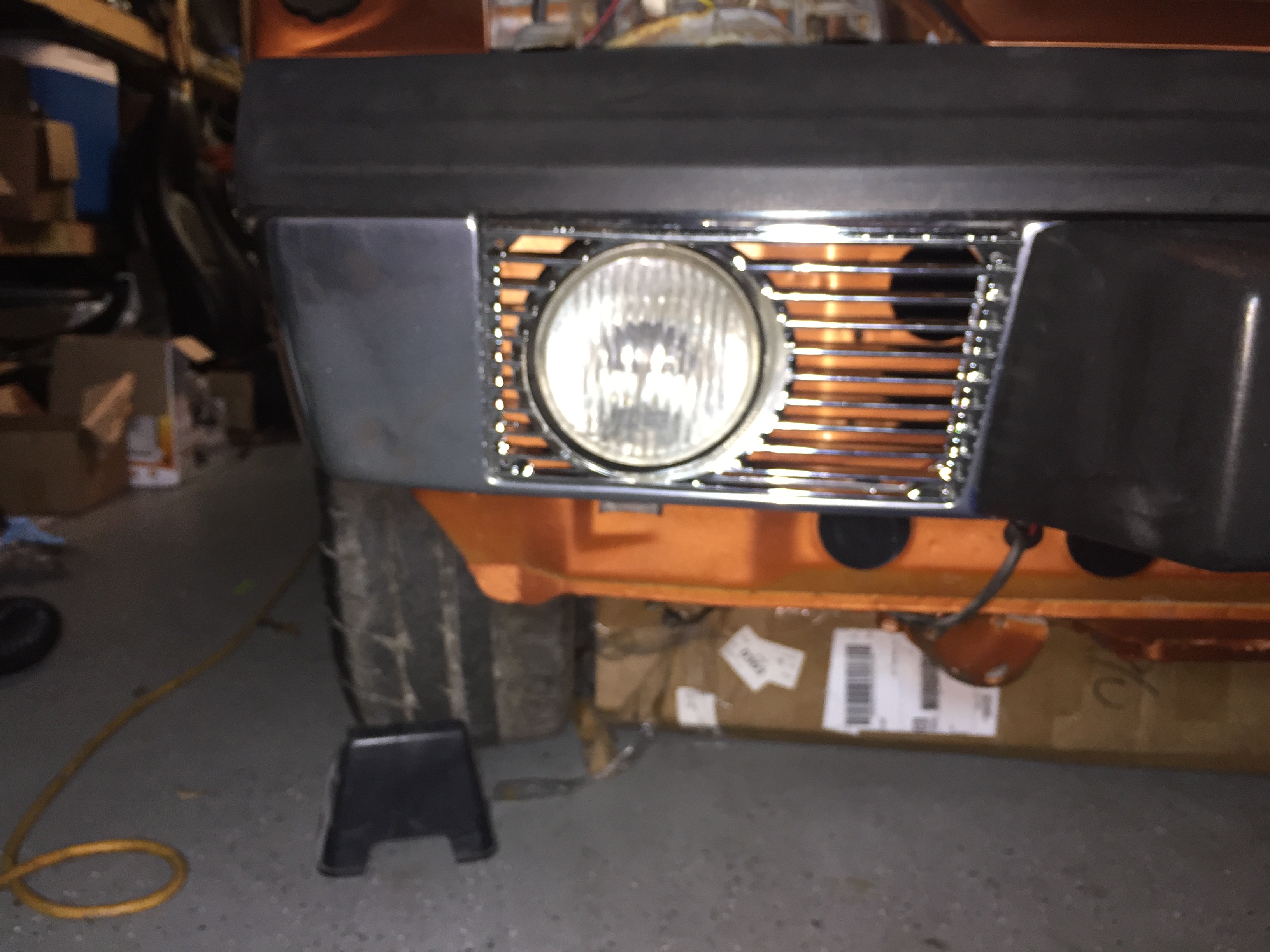

Here you go. Sorry for the bad pics. I’m a terrible photographer :
First one shows driver’s side, next is passenger side and last one shows the captive nut for the fog light bolt. The hole that sits higher and just above one of the body holes is for the horn.

looks like the spot that sticks out slightly is still there even though there are a few differences in the early Vs late panel, but I think I can do a mock up and see if that mounts up and aligns up, - my horn was on the under side on the 75, the mount bold rusted off on the driver side though so I will now mount it under the bumper just like you had on yours, I will just have to drill another hole ugh! wish I had done that when I did the bumper mount holes before the paint was applied.

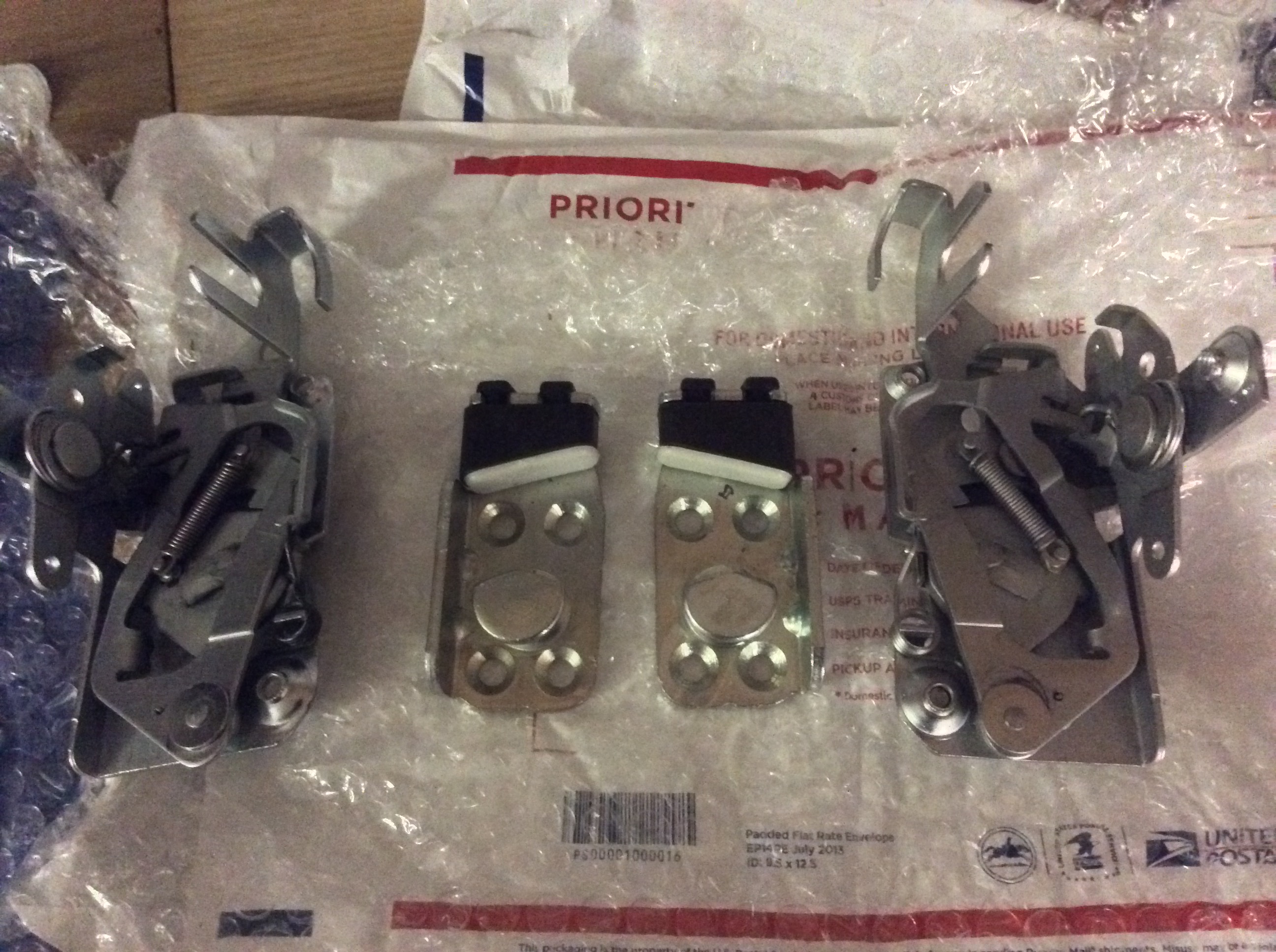

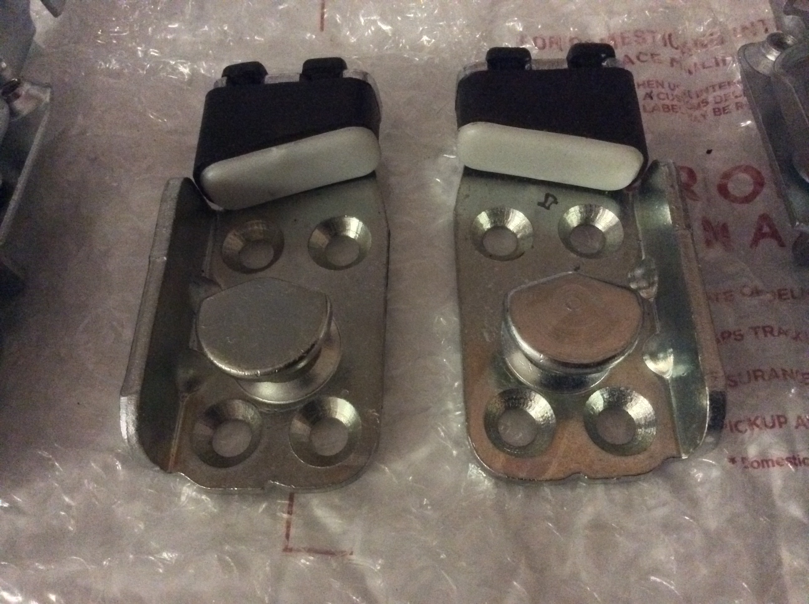

more stuff from Bruce! now i can get my doors put back together , will look and work like new! as luck would have it i won brand new outer door handles from Stoddard 2 years ago at the Okteenerfest! very excited to get at this stuff this weekend! New windshield scheduled to be delivered to Porsche tuesday! i am also getting the full door rebuild kit from 914rubber. door assembly will be interesting, it is nice to be able to put it all back in rust free doors!

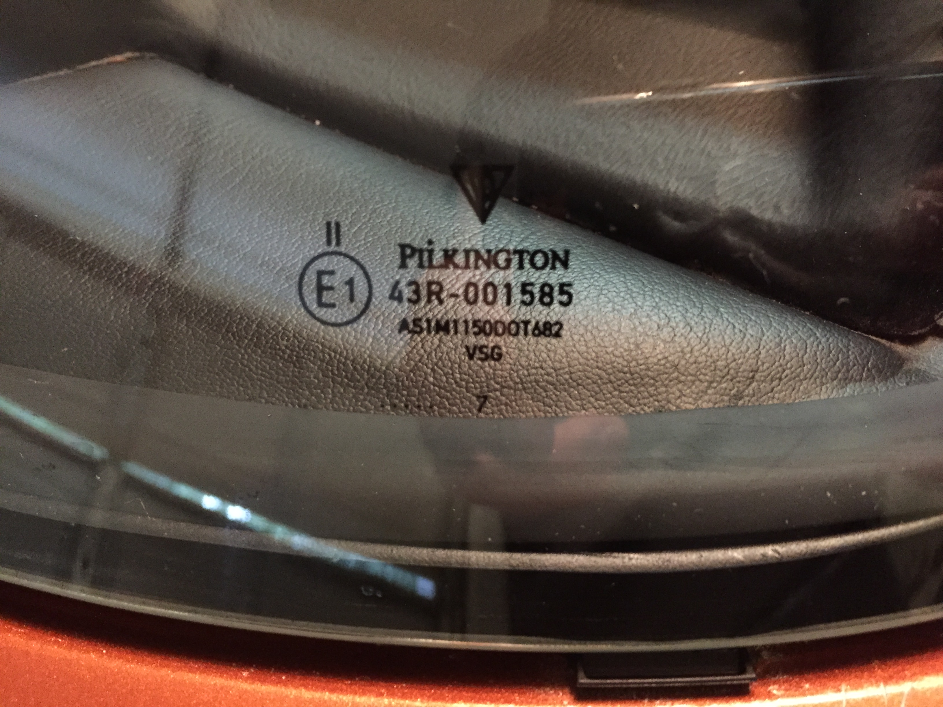

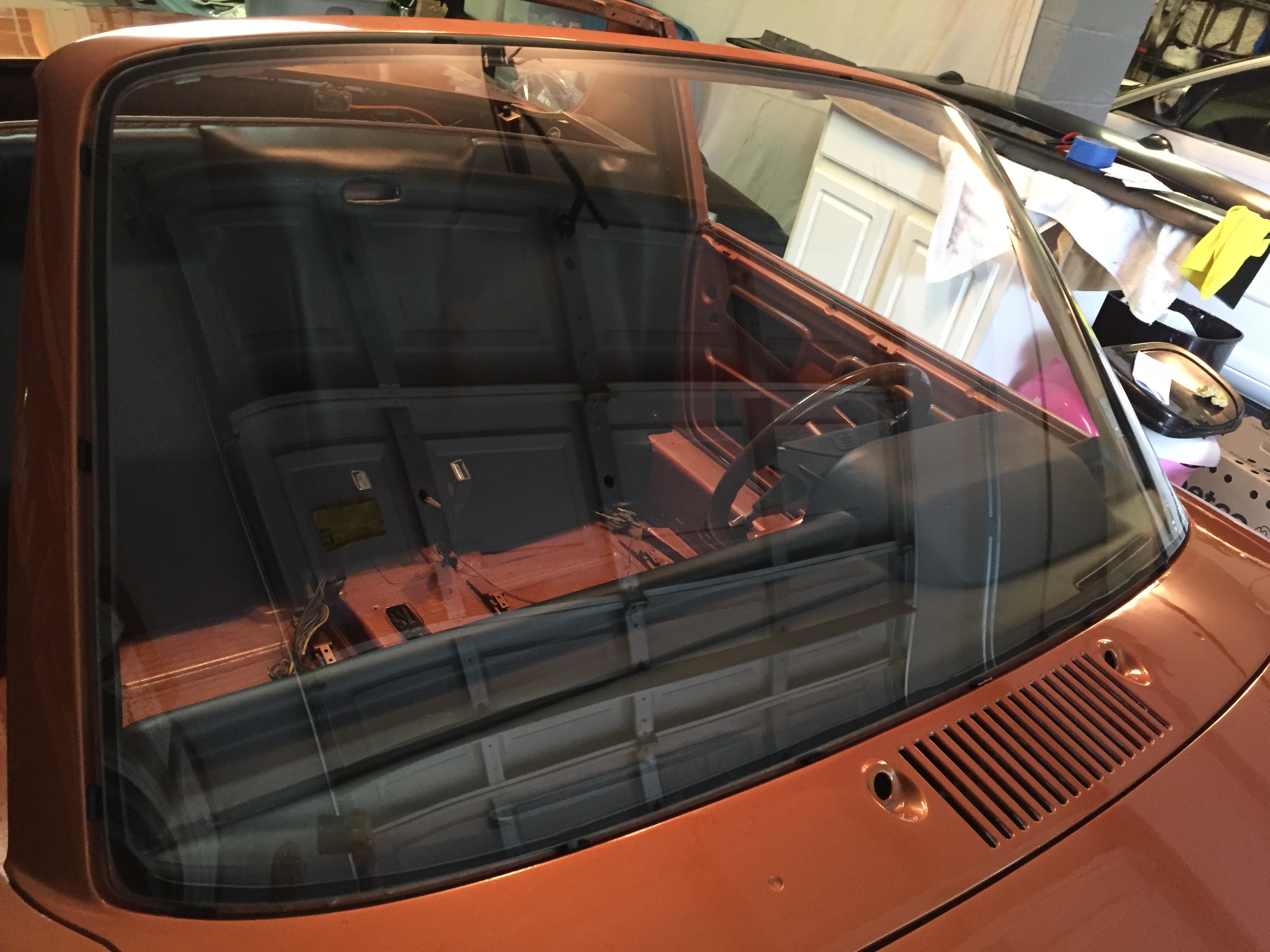

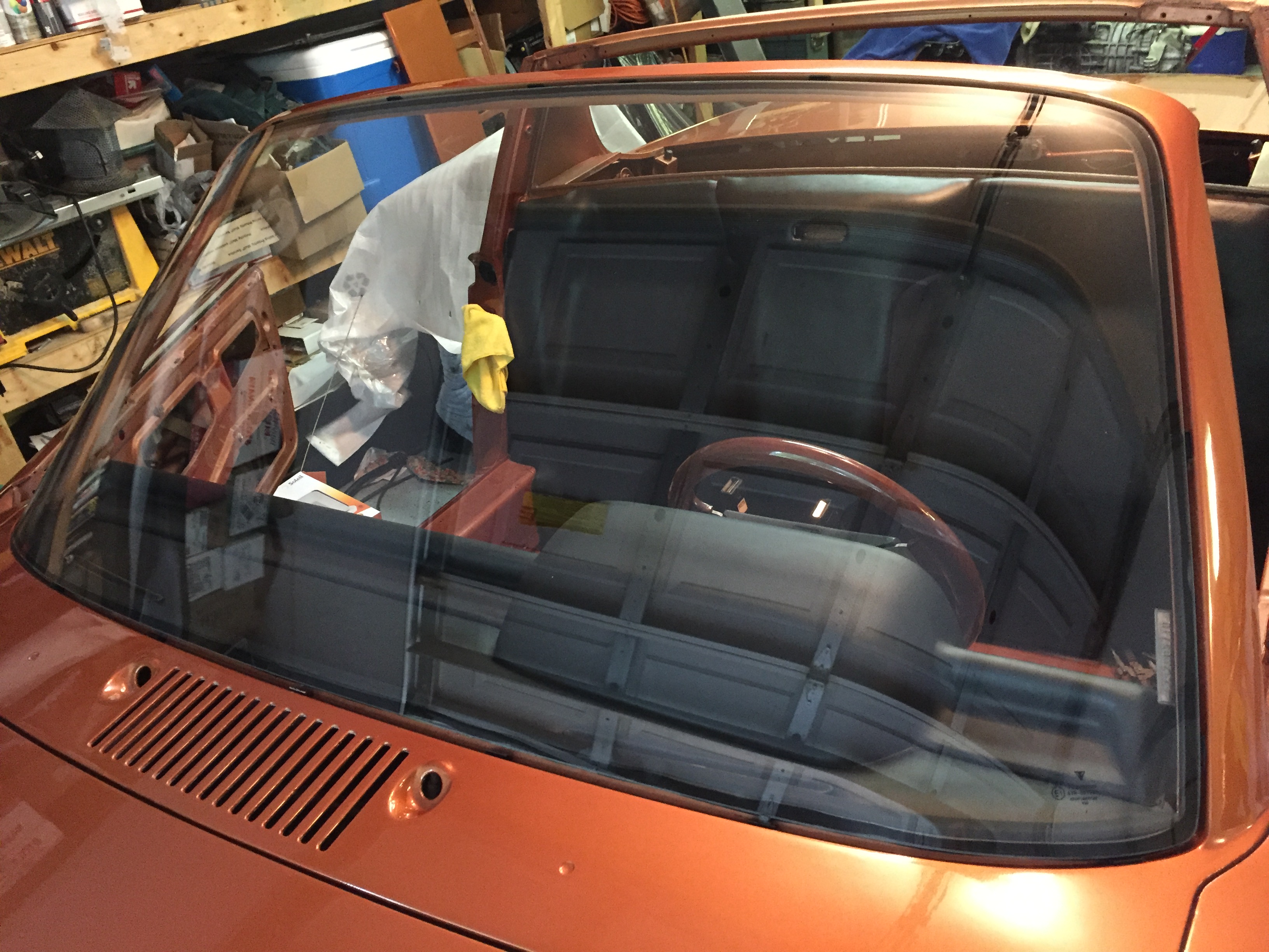

New window in place, so as another member from Austrailia said of his the OEM Porsche supplied window is Pilkington, who bought out Sigla.

so maybe hard to see with reflexions off glass from outside.
so i have to thank Mark Whitesell for having included a few extra trim retaining clips, because in the process of tapping them into place severl broke! There is a amall push pin that sticks out but is supposed to be tapped in after the back side retainer thing is popped into the hole. they dont go in easily, so i found if you pull the small pin out completely tap the clip into place into the hole and then tap the pin in which of course spreads out the thing in the hole and tightens it holding the clip in place. I broke 2 clips in half trying to tap them in place so be careful, and make sure you have a few extr just in case!
DRPHIL914
post Jul 20 2018, 12:04 PM

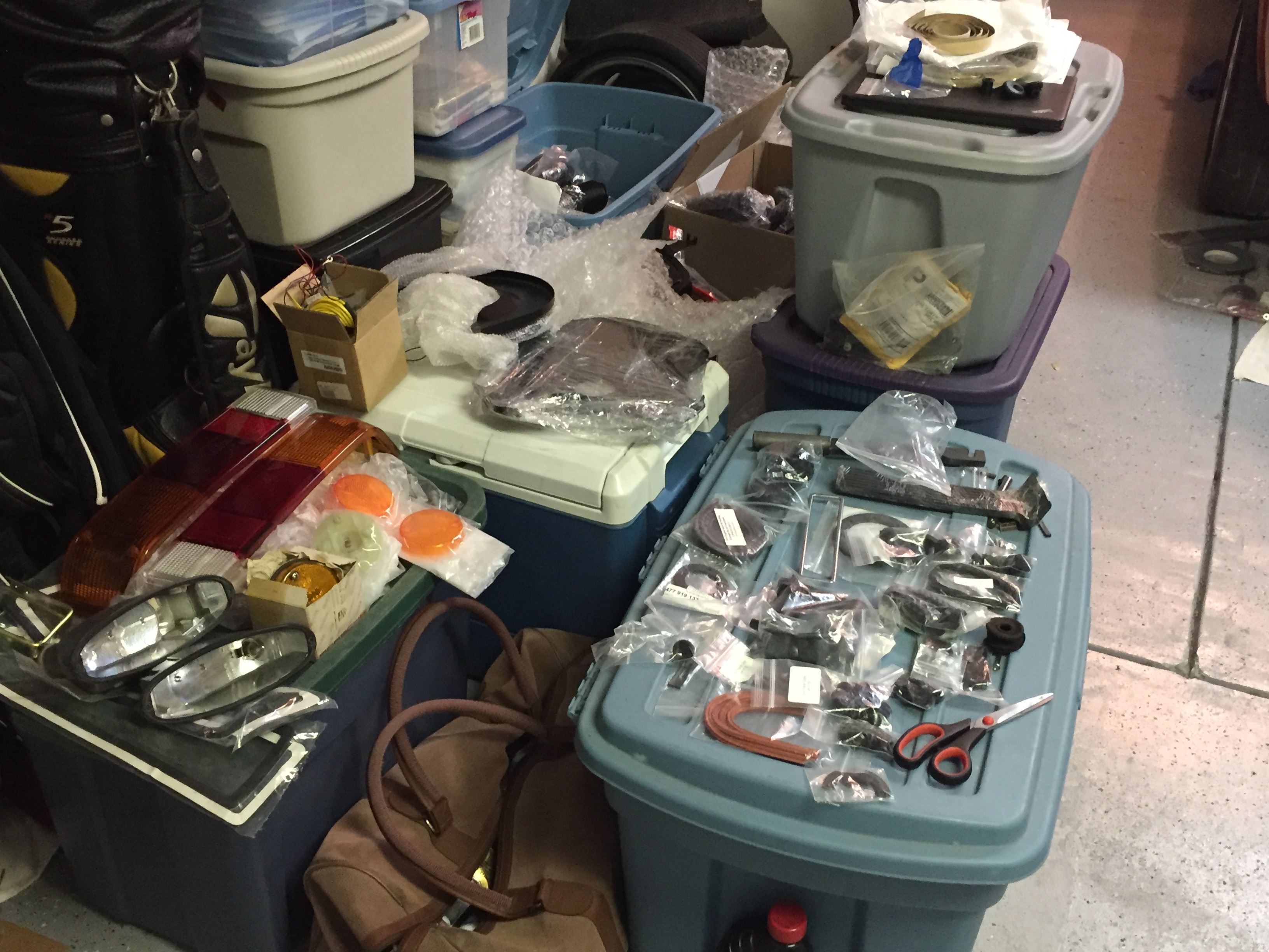

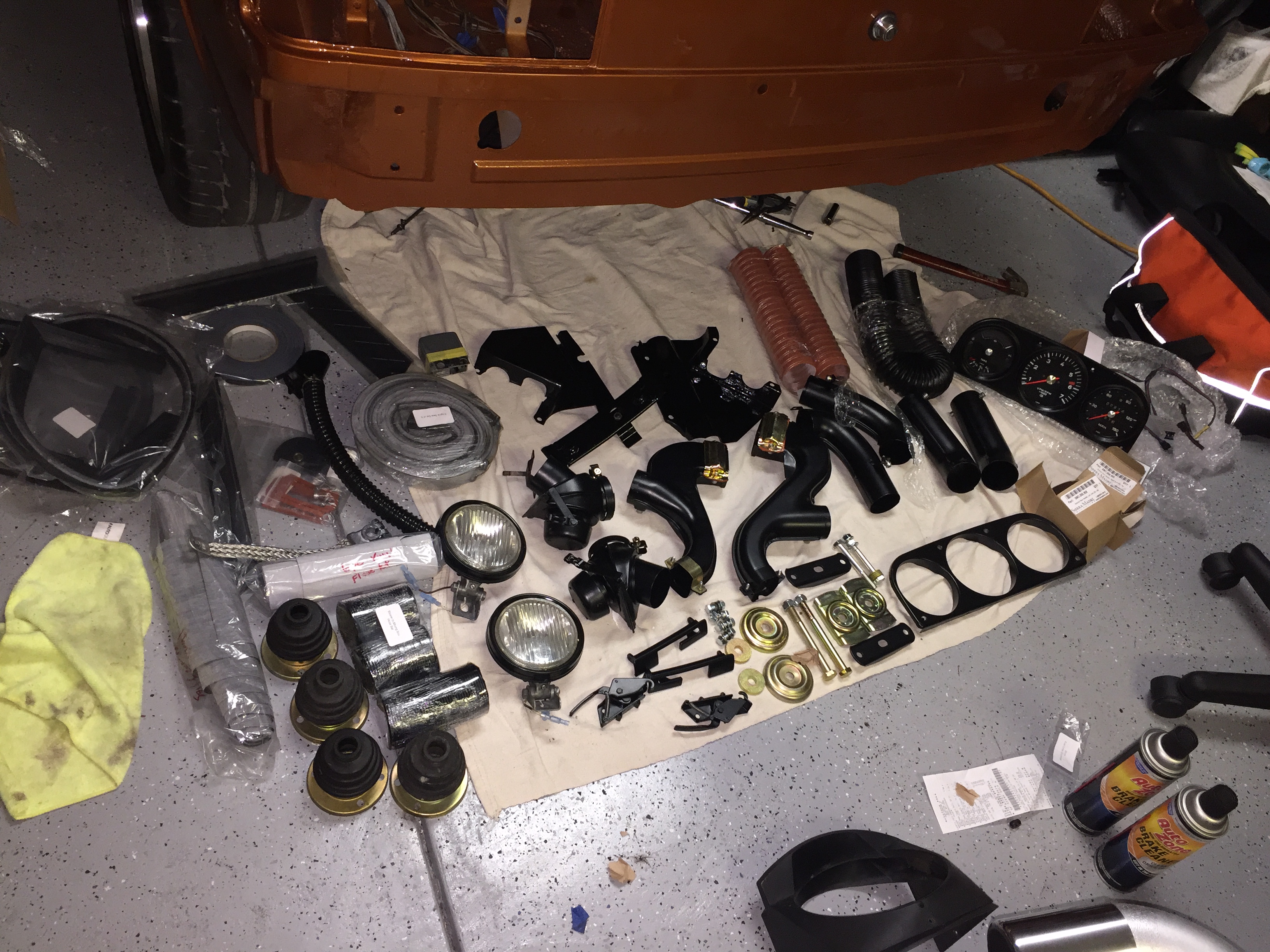

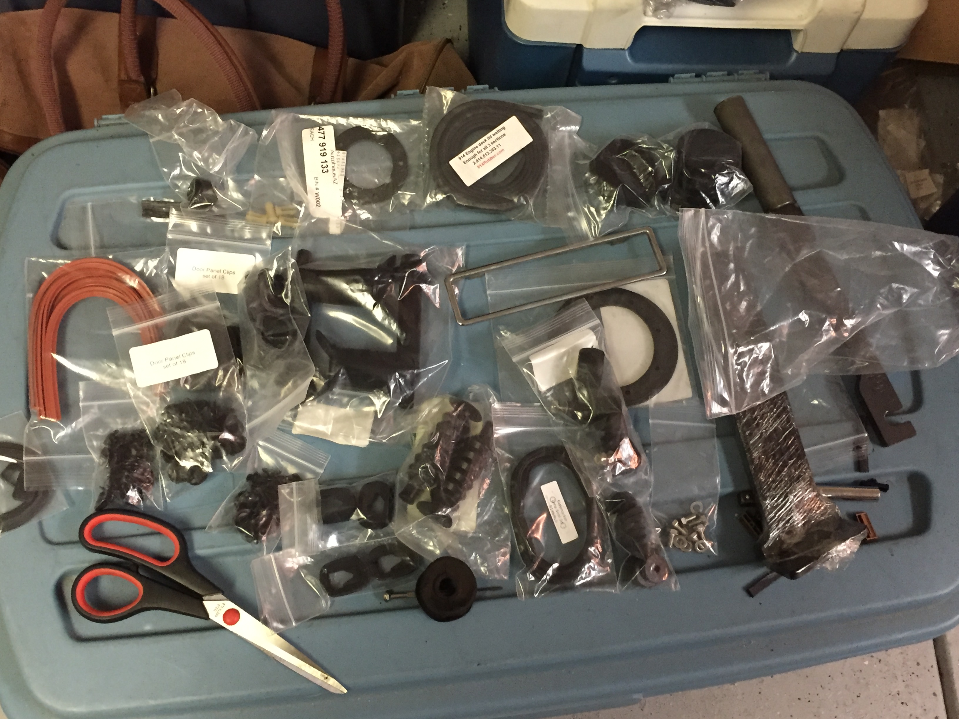

its time to get organized ! this is not even everything, i have new carpet kit, etc etc,
there is the LED gauge kit , the new never used outer door handles, all kinds of seals ans gromets and etc, all the heater tube parts, brackets and hinges and targa bar latches all thst black stuff and the zinc plated stuff you see are from Bruce Stone. Fuel line kit feom AA ans vac line kit too. it was overwelming me today and i didnt know quite where to start, so my friend Jim came over and we did the valve clearance then reinstalled the HE and exhaust. First time i did that myself. having someone with experience is helpful. i had 3 resources, my Tech Tips, the Haynes manual and Pelican parts tech article- this was so much easier with motor out and the HE stuff not in the way. ended up doing the pelican and Capt. Crusty’s way, pretty fast and easy.
After that i pulled out the old plastic lines, and installed the stainless -that job is not done due to the small lines not lining up with the late car clips, i am still waiting dor someone that has done this to post a pic or comment on how to get them in correct position (IMG:style_emoticons/default/confused24.gif) , still fairly productive day .
i had stuff in 8 different bins , and as i would order parts i tried to keep it together but i have extras from ordering stuff i forgot i had already.

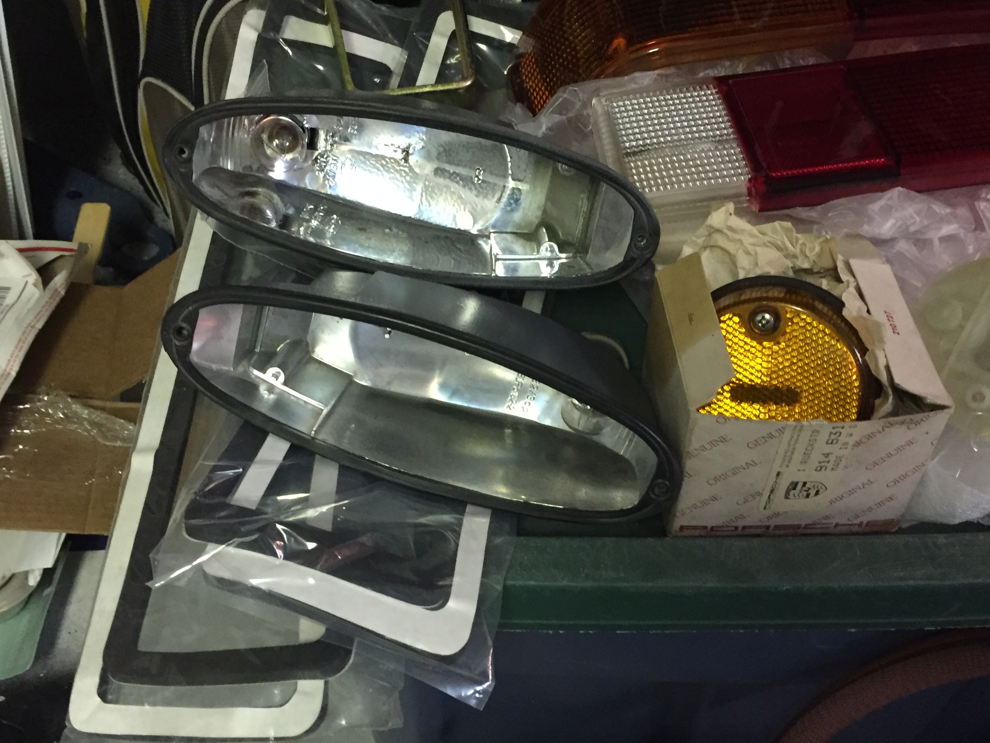

lots of stuff ! the shiney new looking turn signal buckes are from Brad at 914ltd

i have a few needs yet-
1. i found a beautiful NOS Hela side marker assembly, and as nice as my repro 914rubber ones are, i would like to source another side marker lense to go with it .

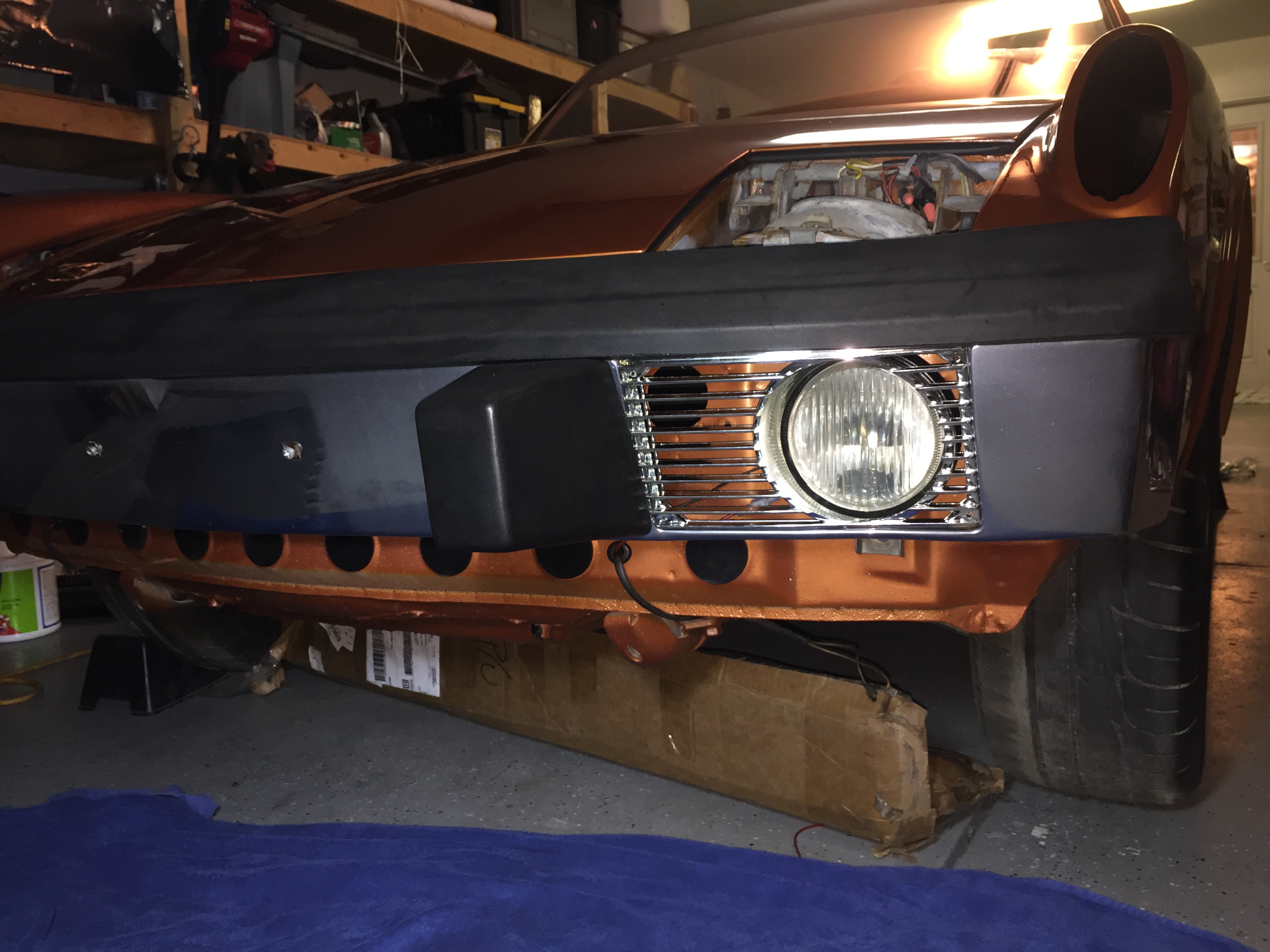

fog lights mounted today- had to do something today! had to locate where to place the mount, easy to do by mocking it up and making sure light is in the proper position and angle. i also had to modify the wiring due to the ‘75 ones usually were self grounding to the bumper. So wired, mounted and aligned. next up i have to mount the new Hela double horns. i am trying to decide if i ahould put them behind bumper sa the earlier cars had it or under where they were before with the bub’s.
