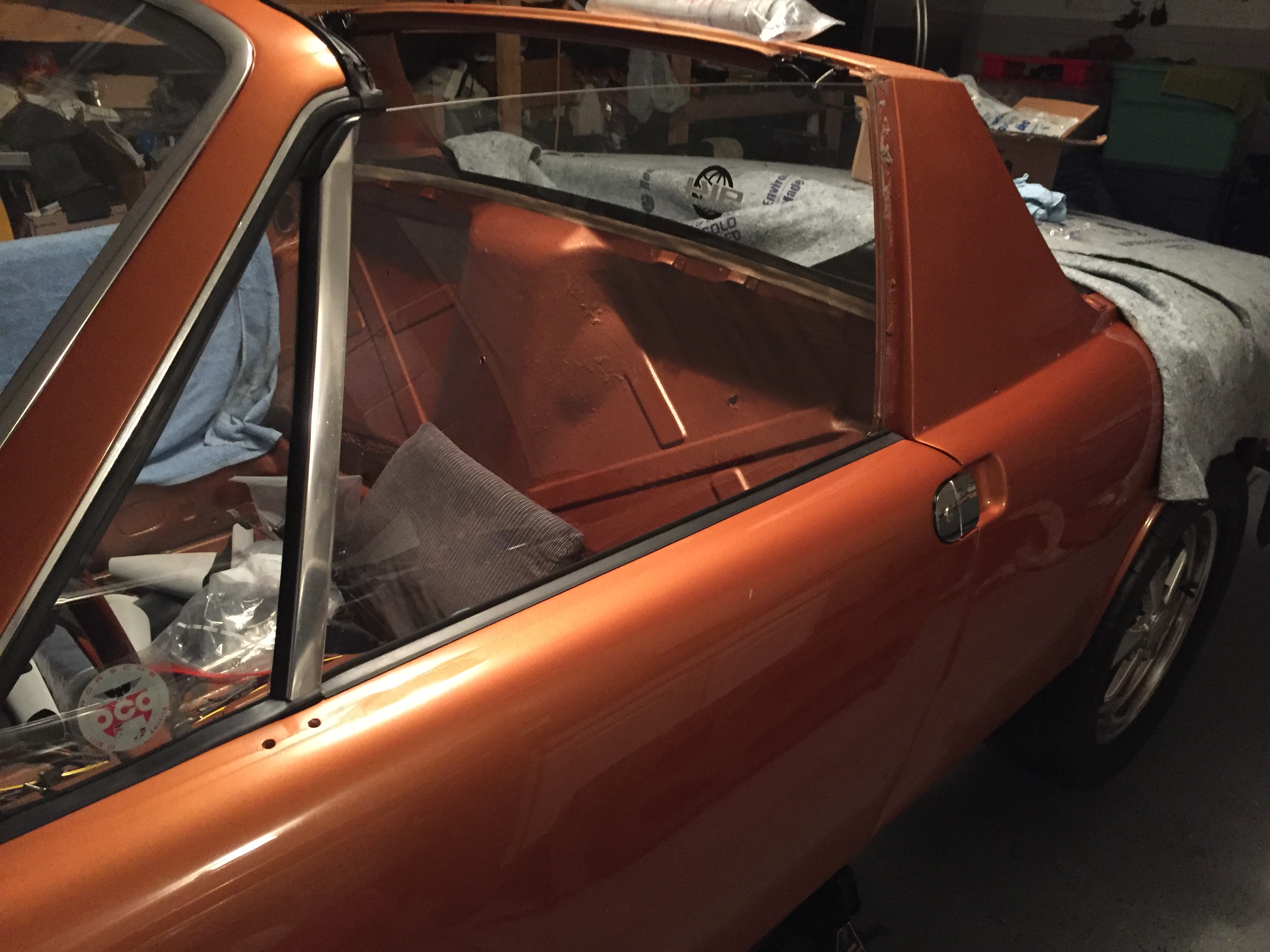

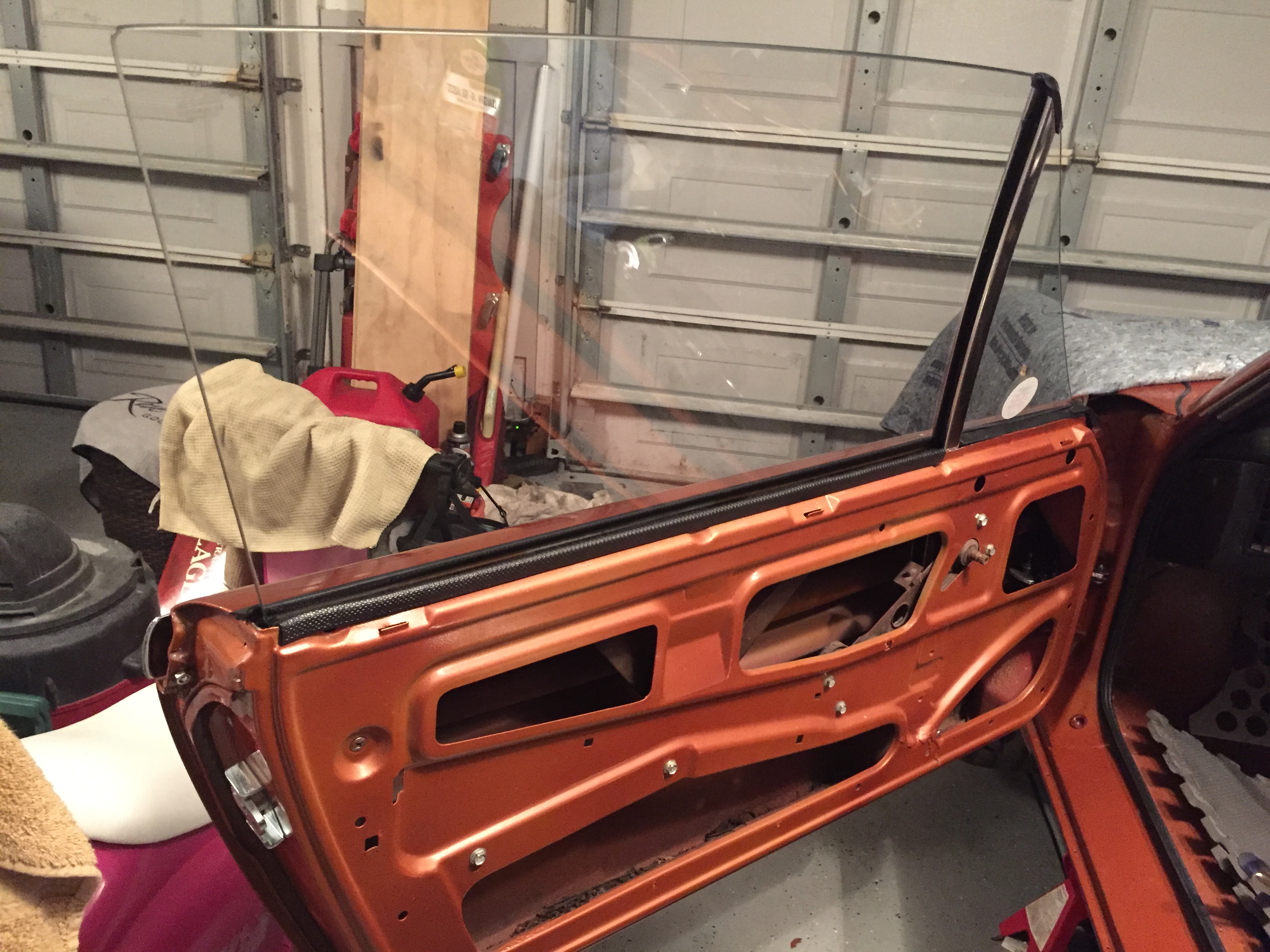

new rear sway bar bushings yesterday,
tonight i went to work on the driver door again- first i decided to test a different seal. i pit the seal amd the wing vent glass on then lubed the track and slid it down from top, and then worked on gettimg that with it in the frame down into the door. this time i was able to get it in far enough that the glass did not hit the a-pillar and seal.
adjusted the height and angle of the glass, then installed the regulator mechanism and main glass. that was interesting, not as easy as it looks. but figured it out.
So the driver s door has seals and glass! now i await the targa trim chrome from Sunset Porsche. once this arrives i will do the new targa bar vinyl and trim. Layed out the carpet - tomorrow i will again fight the passenger door glass- i am waiting for the alternator and a few other bits before putting motor back in.

QUOTE(DRPHIL914 @ Aug 27 2018, 08:49 PM) *
That's a major victory!

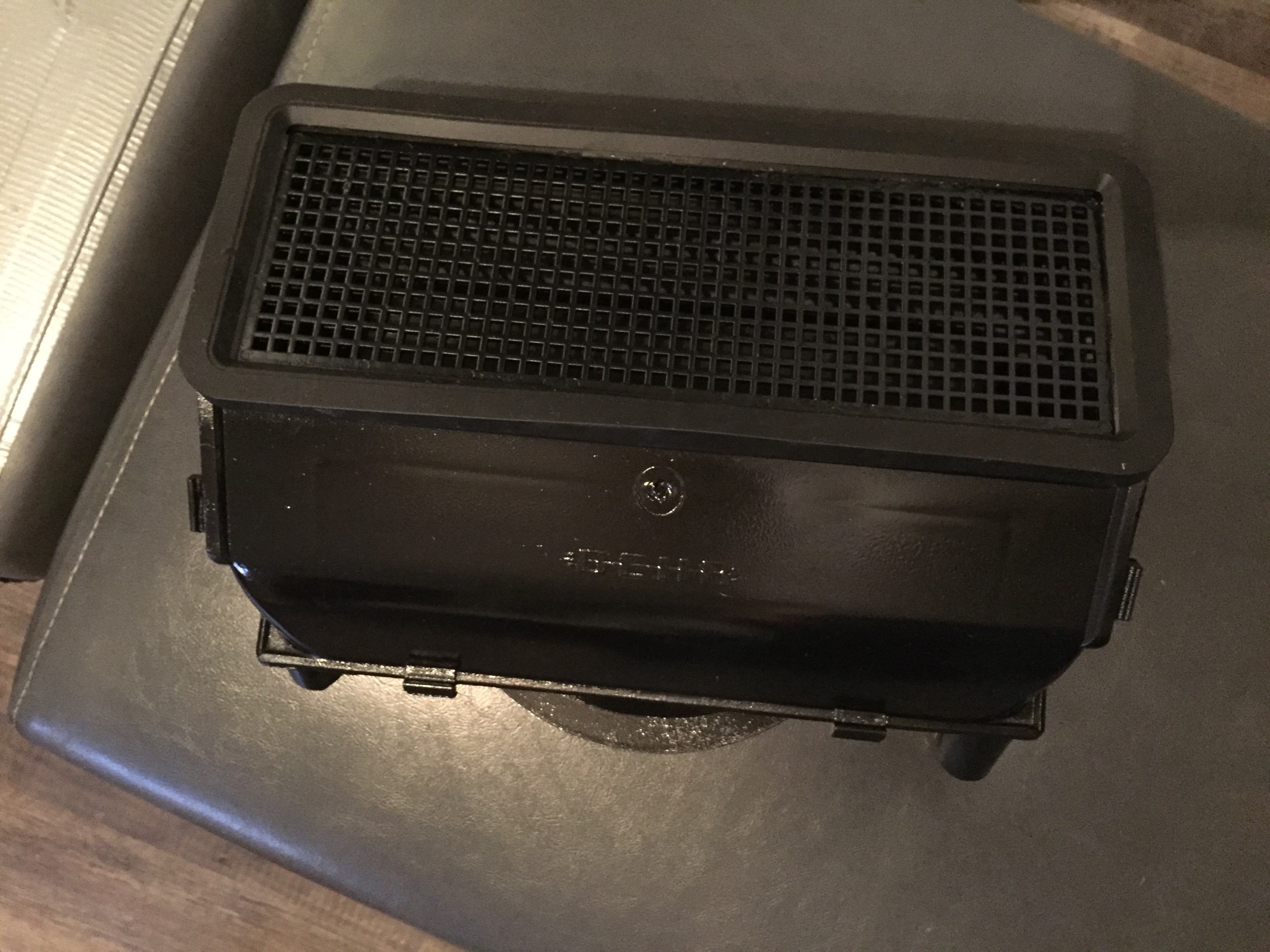

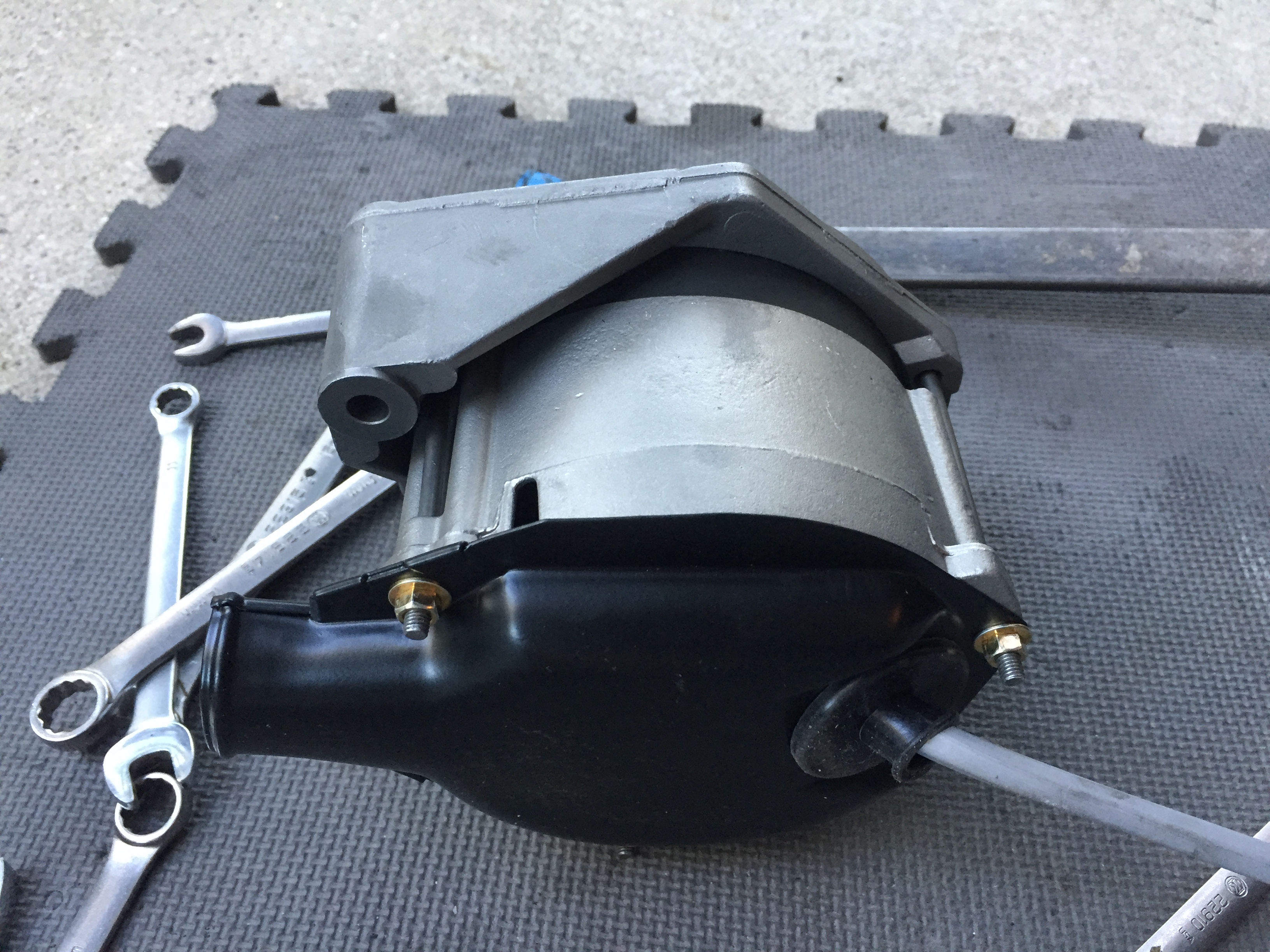

this arrived today, but i have to wait for my new back plate to get this installed- i hope it comes soon!

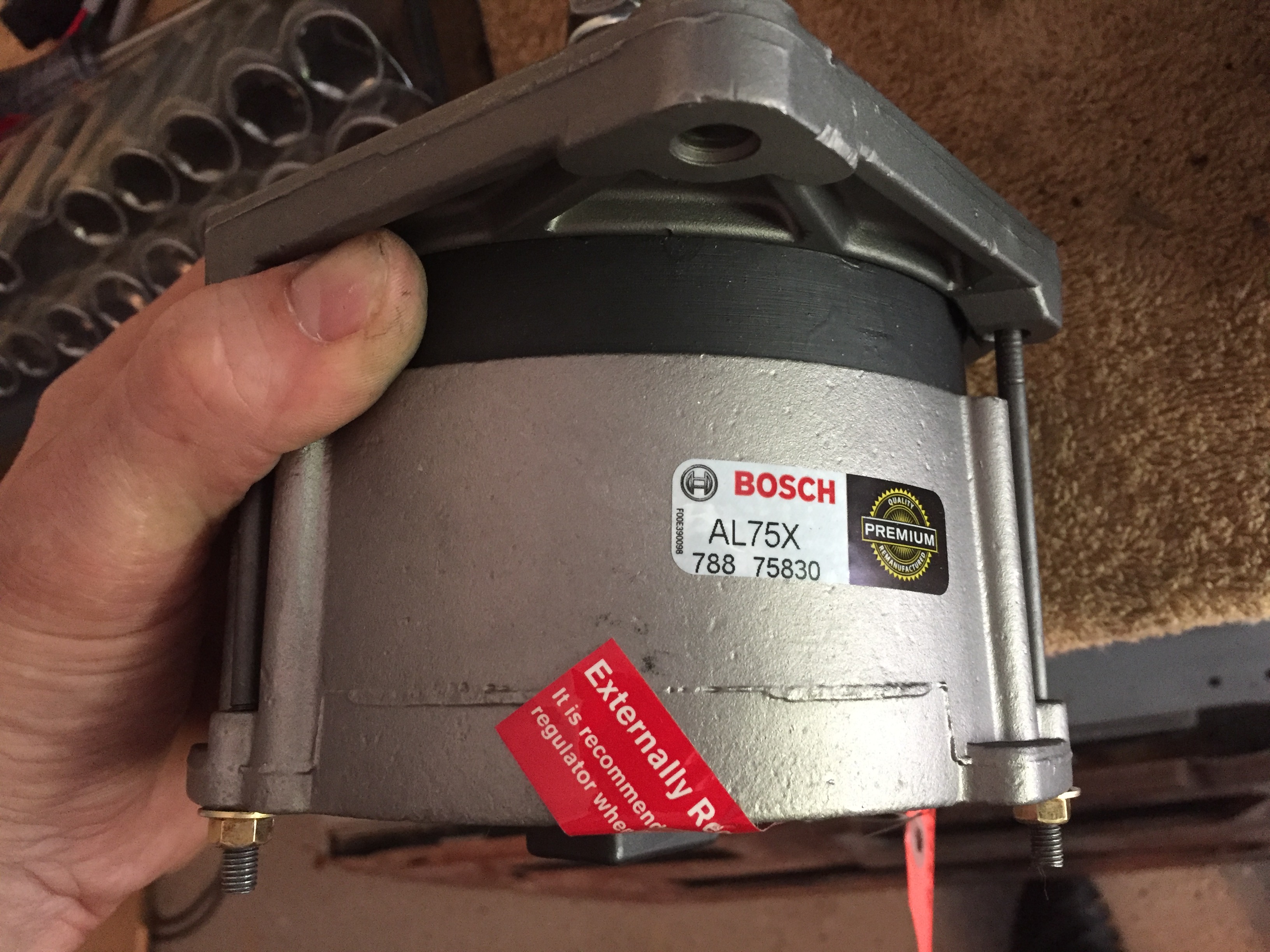

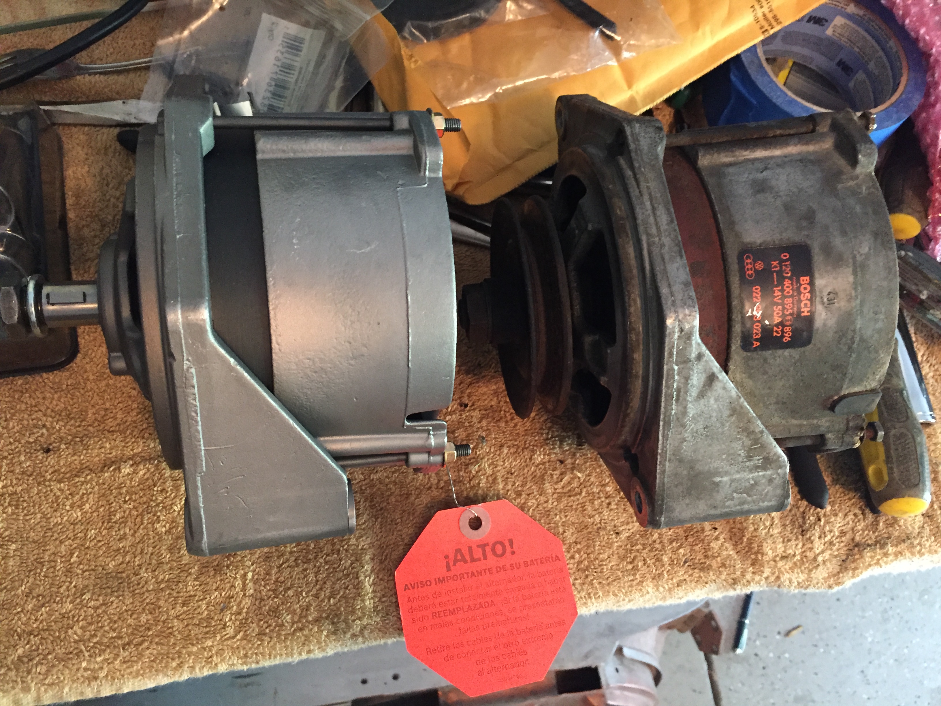

old vs new- upgrade from 50 amp to 75amp,
they recommend a new VR , is the NOS one i just got from 914sixer.com

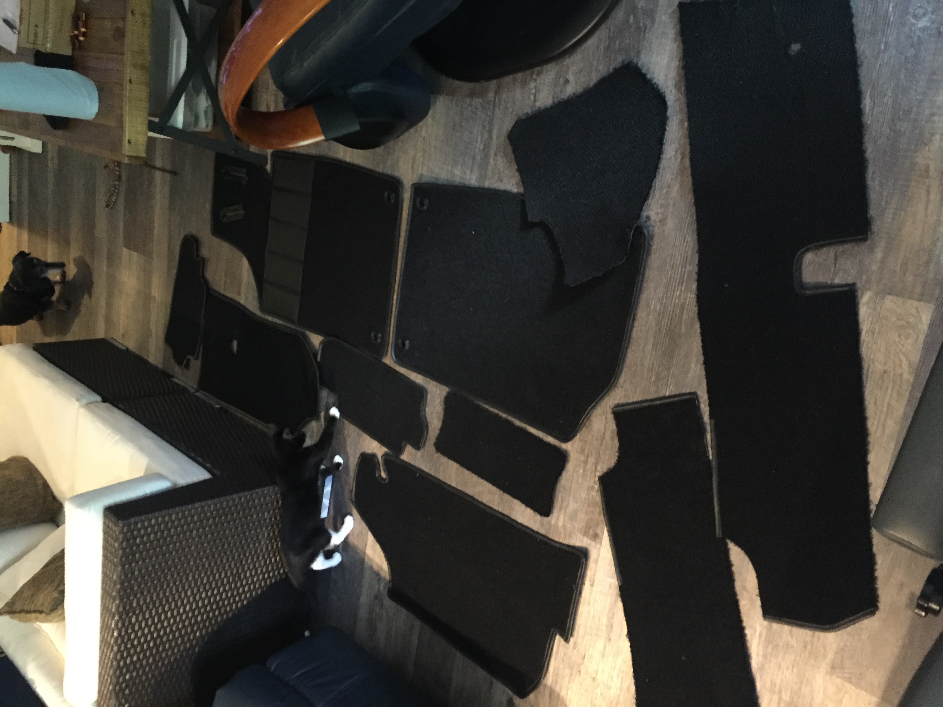

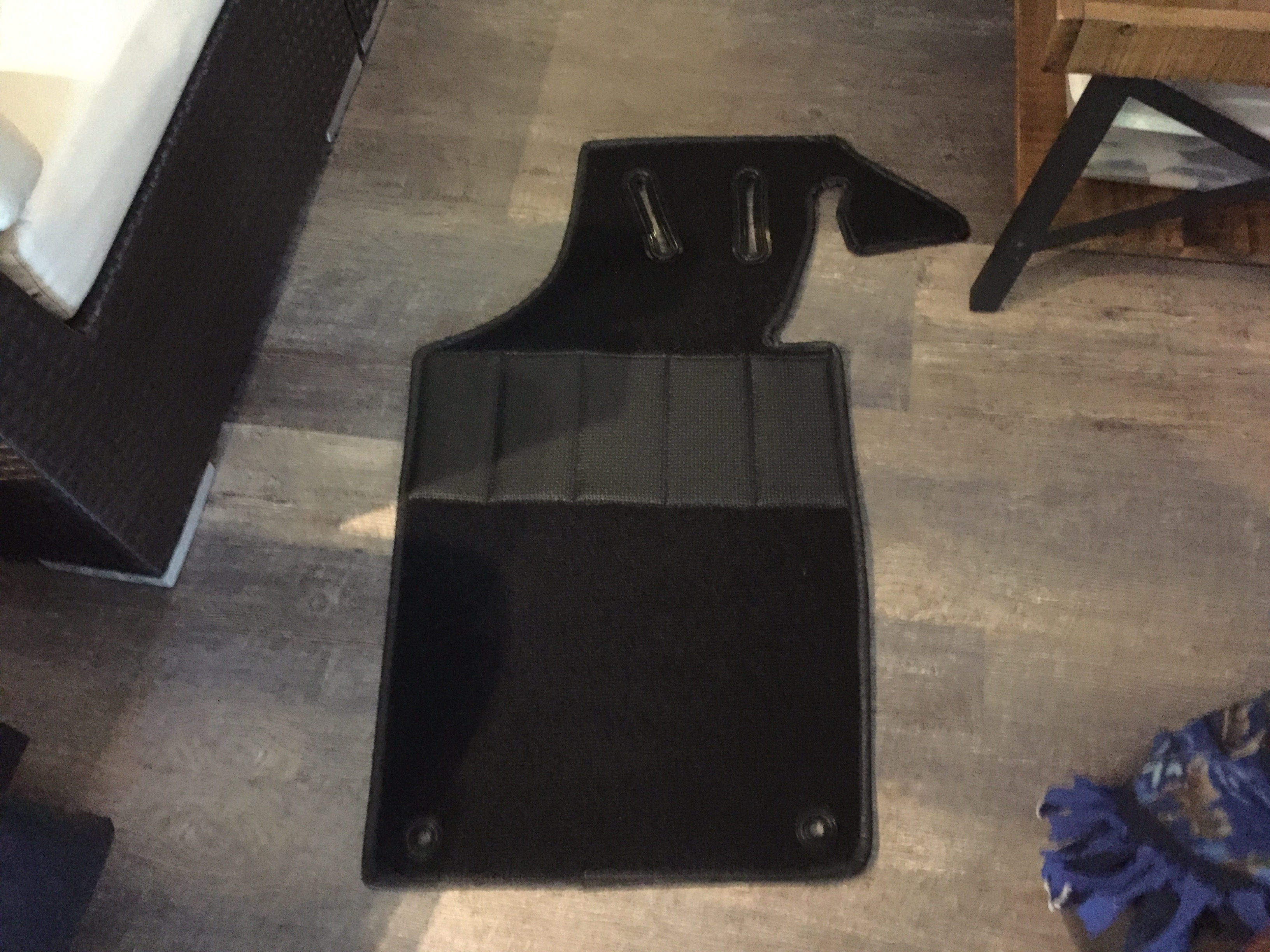

carpets! getting ready to install after putting the vinyl in place

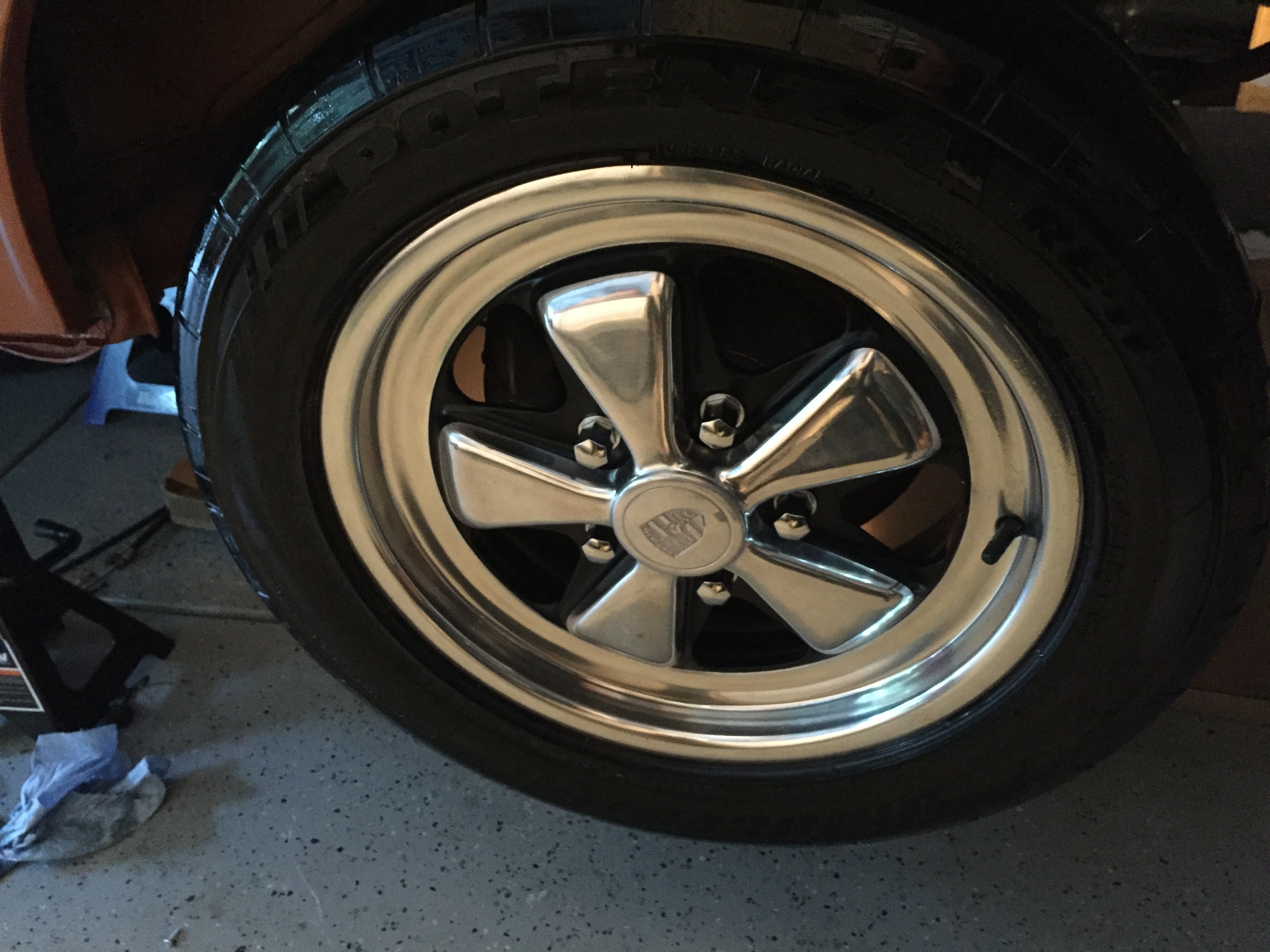

never run before 16x6”

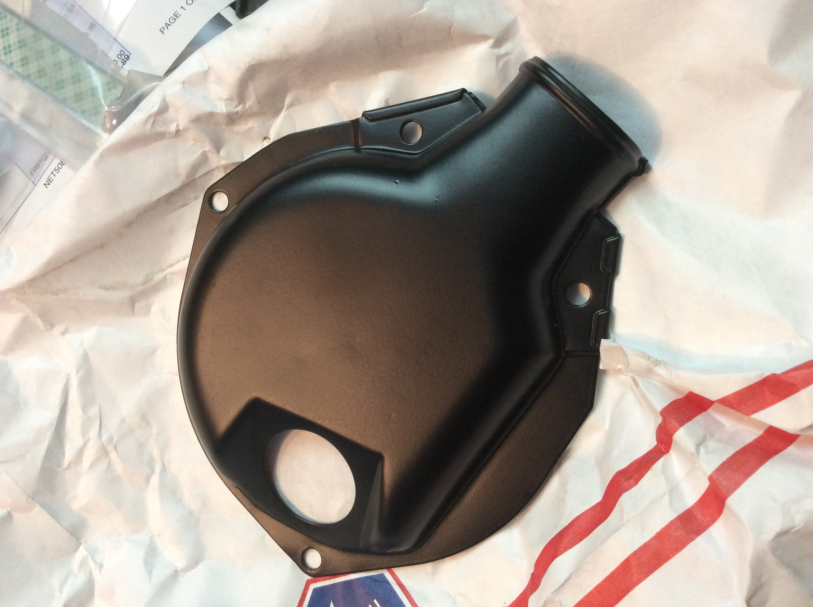

new alternator with new wiring, new back plate

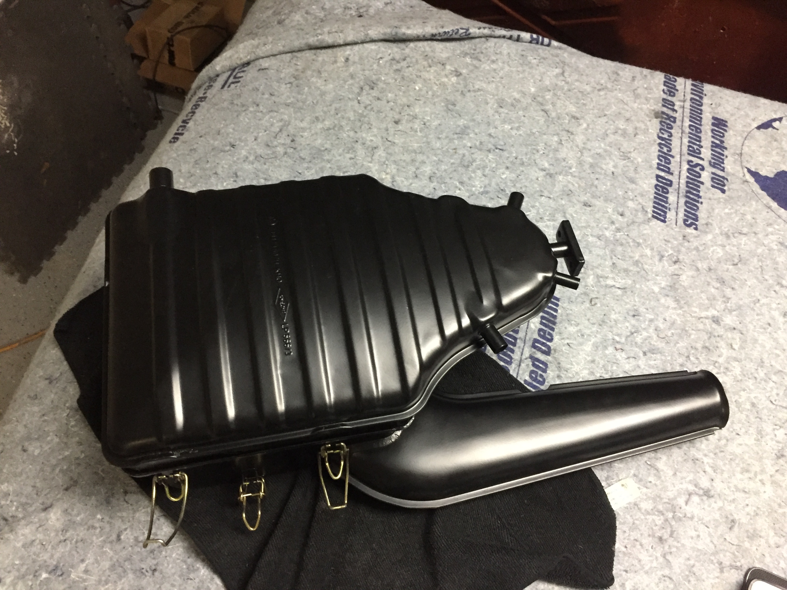

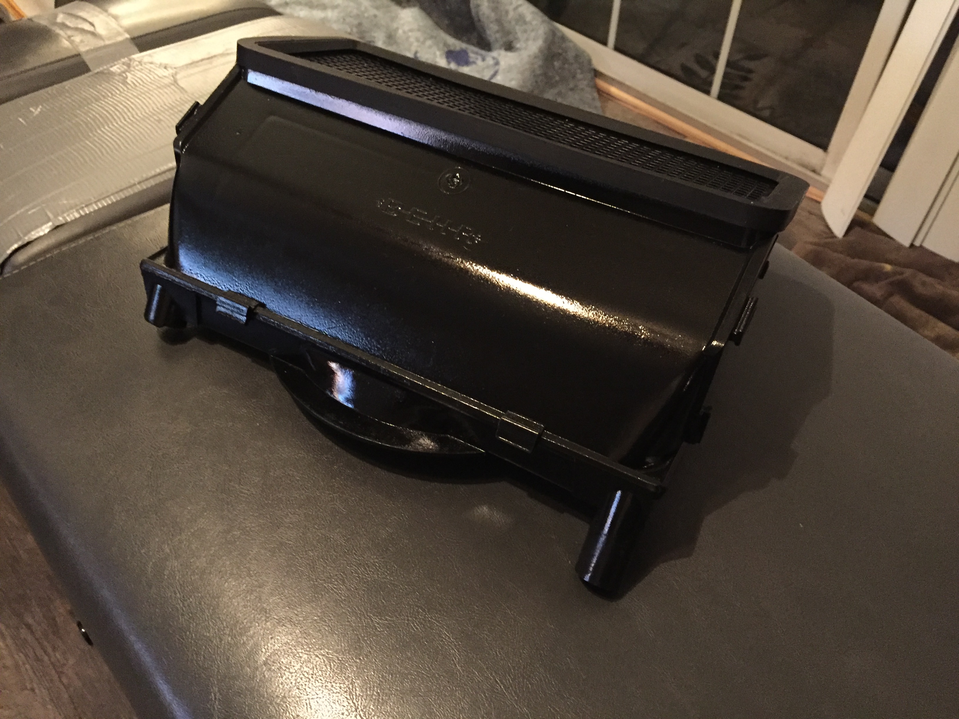

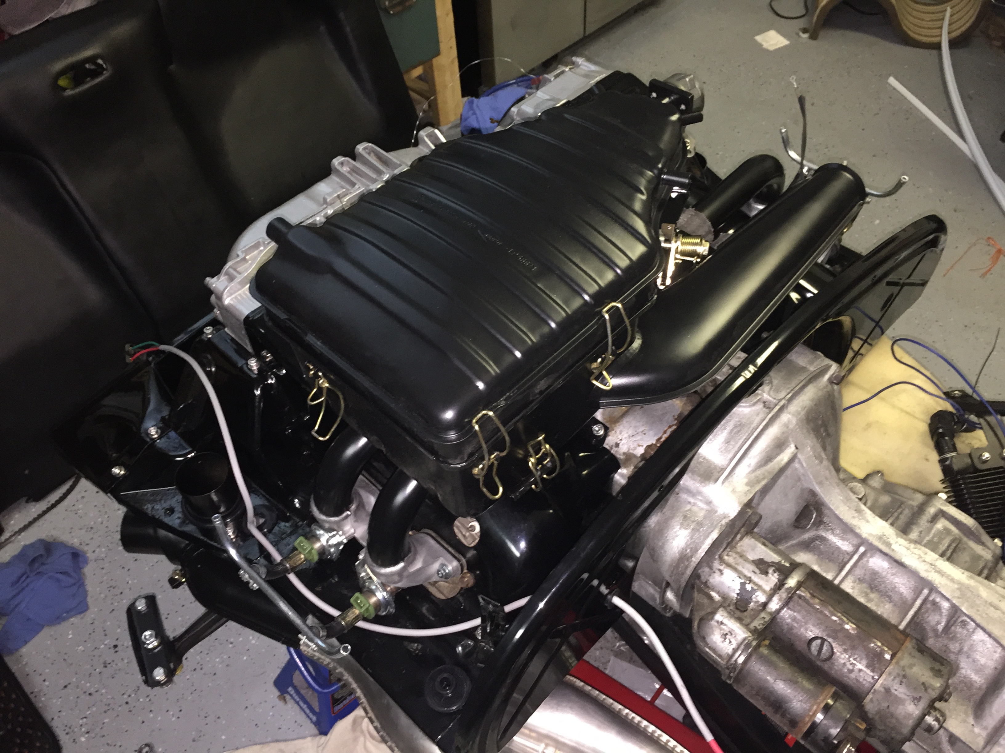

my newly powdercoated air box from Broce Stone came today, here is a test fit

QUOTE(DRPHIL914 @ Aug 29 2018, 04:50 PM) *
Nice! What size tire is that?
