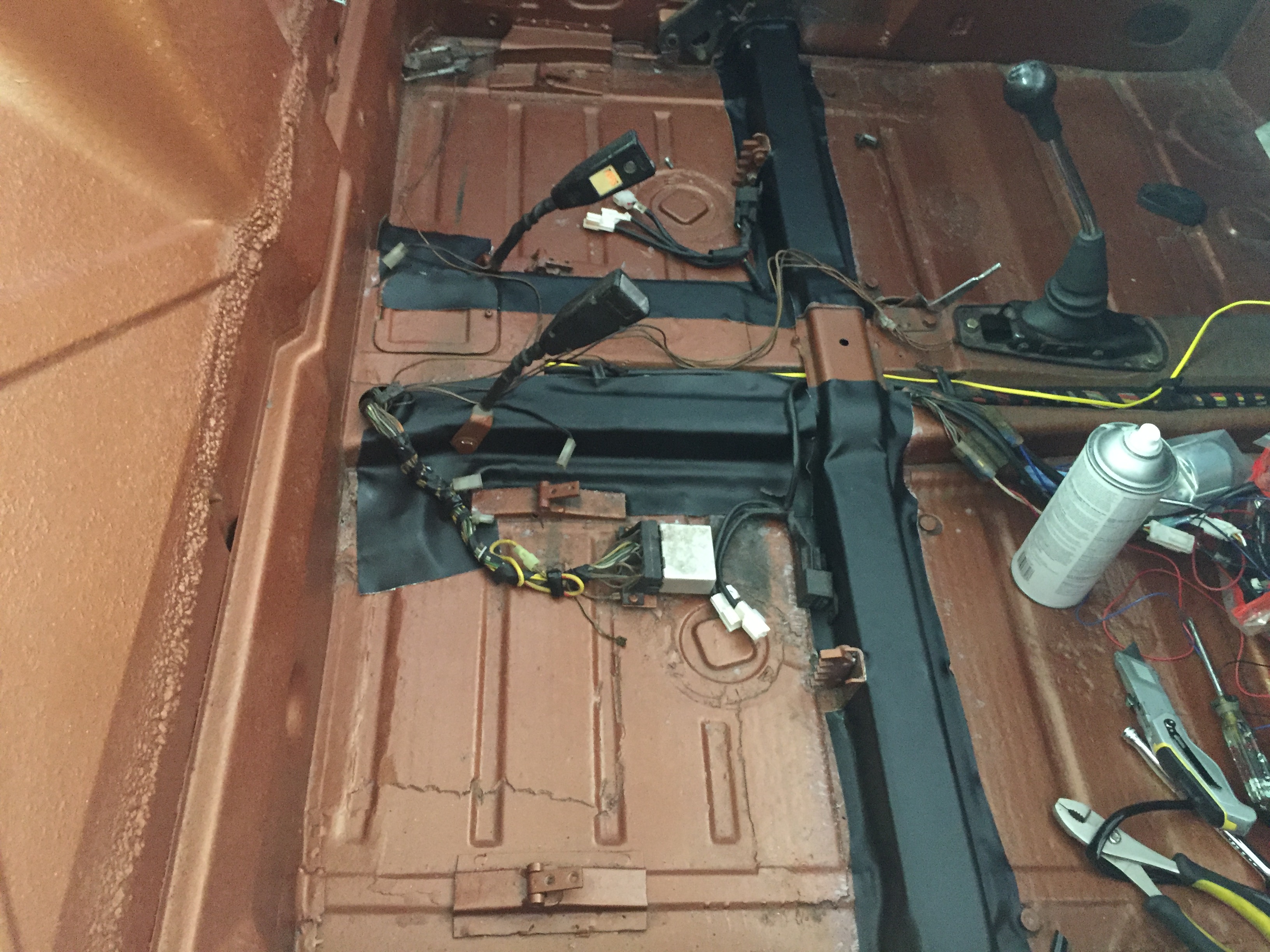

what is this screw down in middle of the picture? looks like you would mount something there? am i missing something?

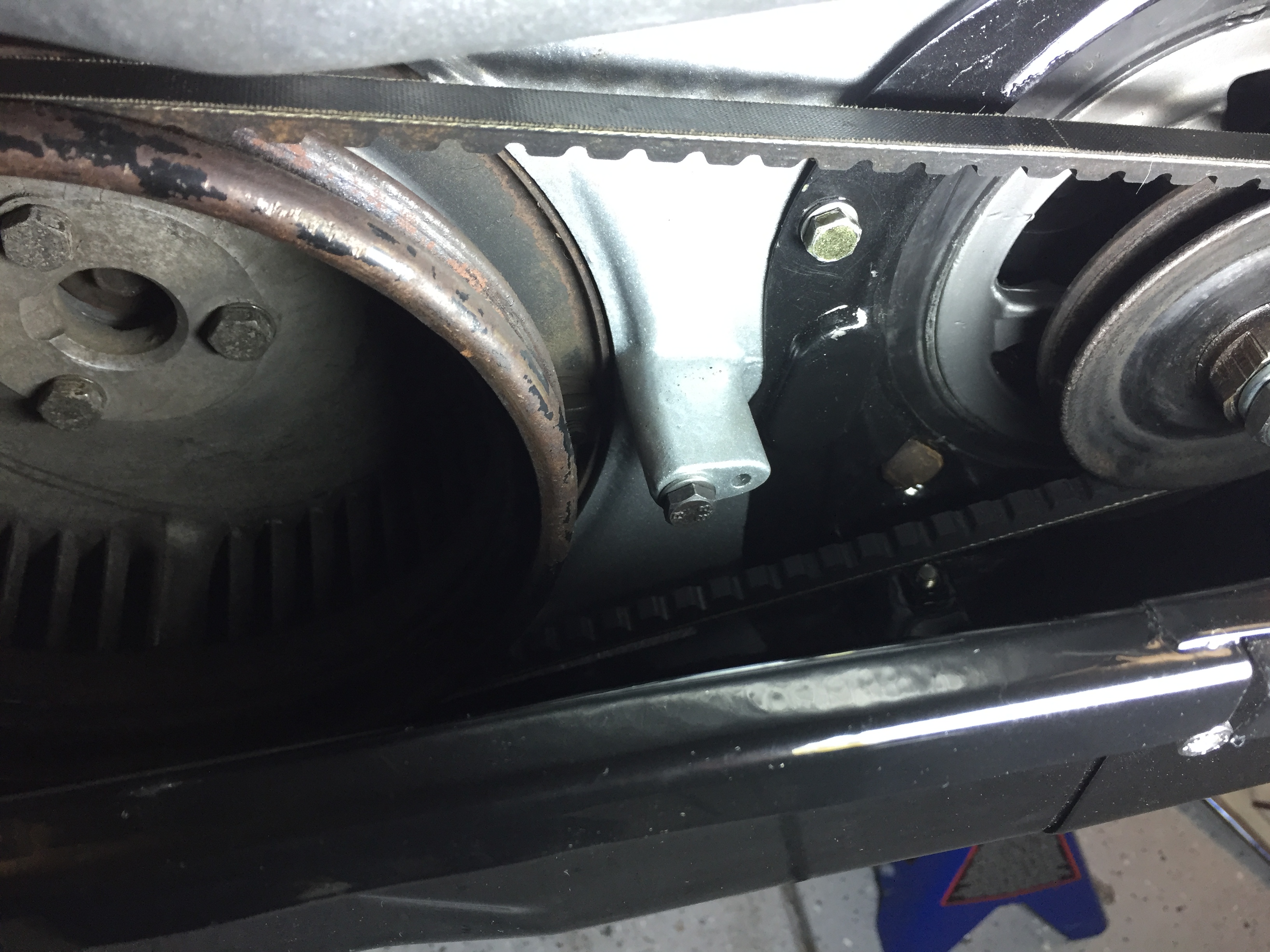

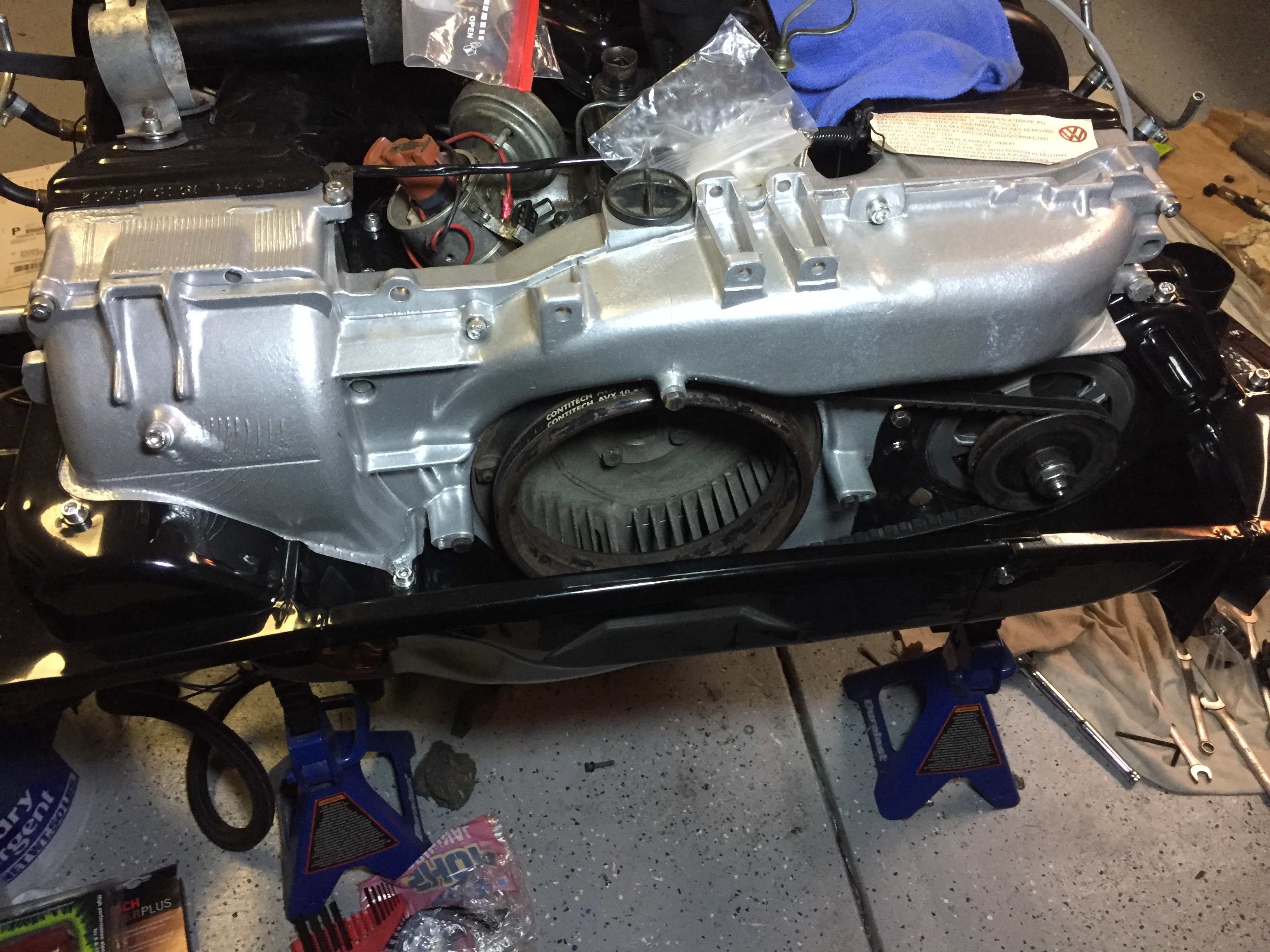

cleaned up after instal of the belt and tightening down the alternator.
how do i know if this belt is pulled tight enough??

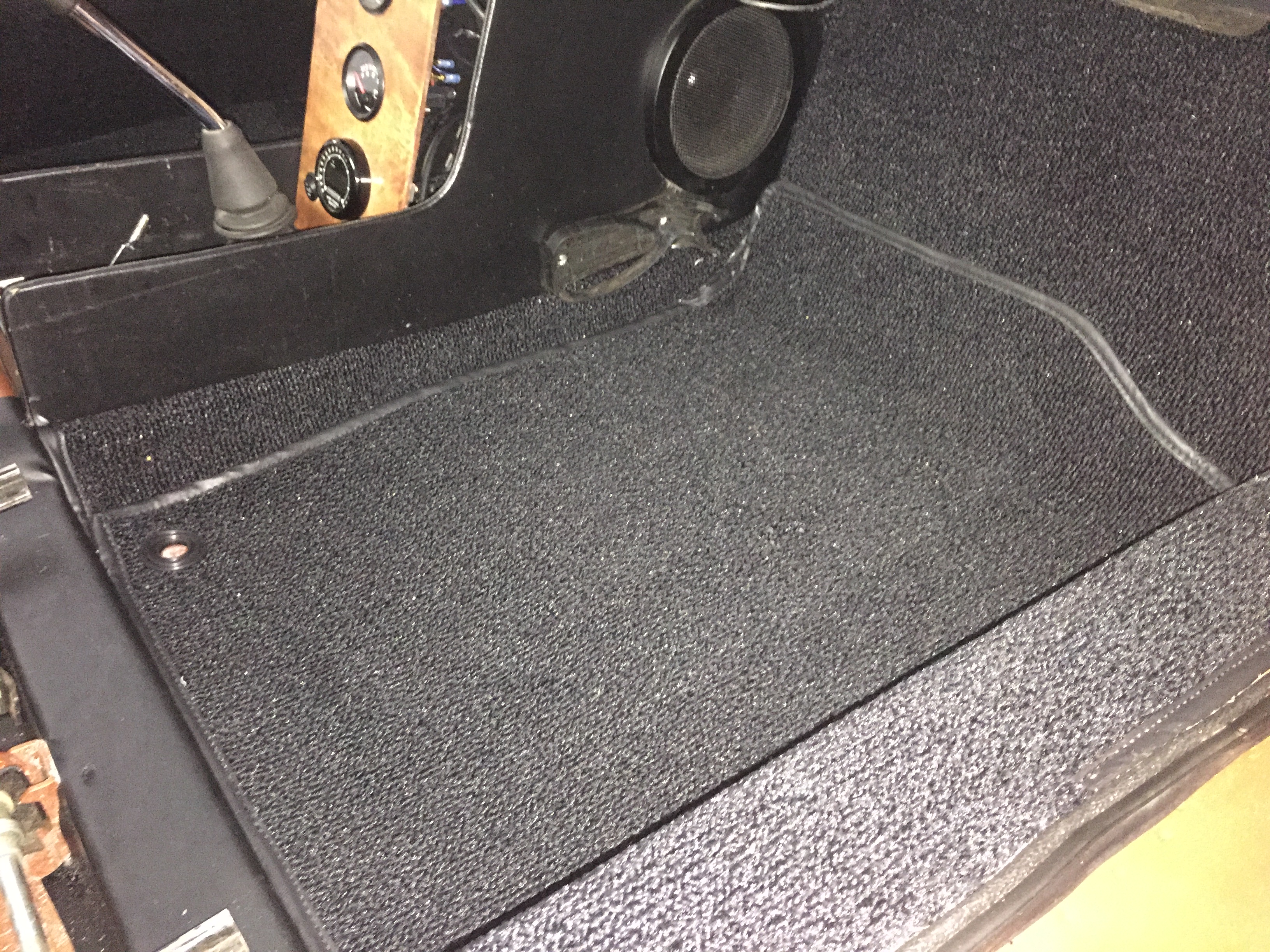

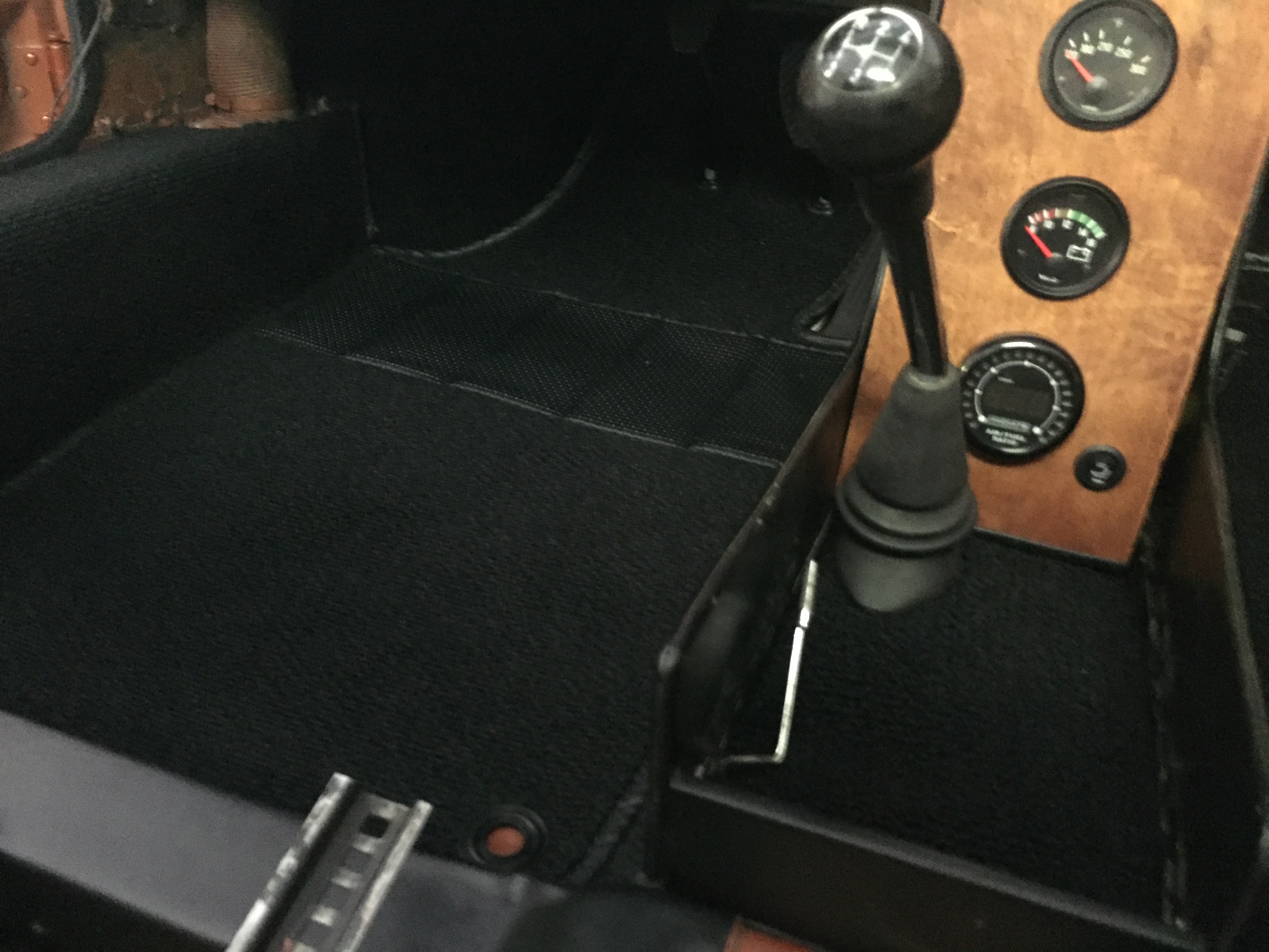

new german loop carpet, center console in, rugs in

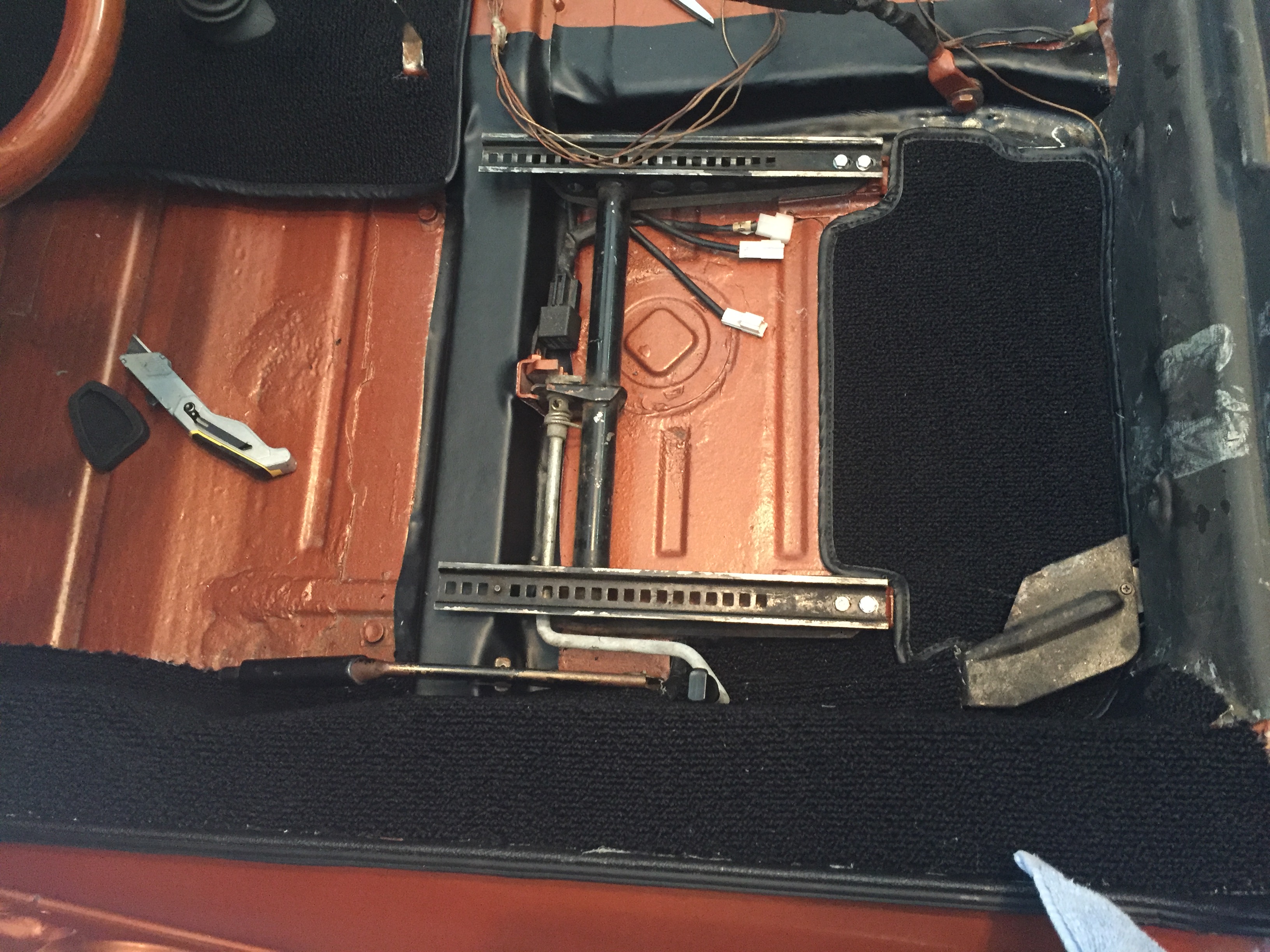

more

morerr

one more

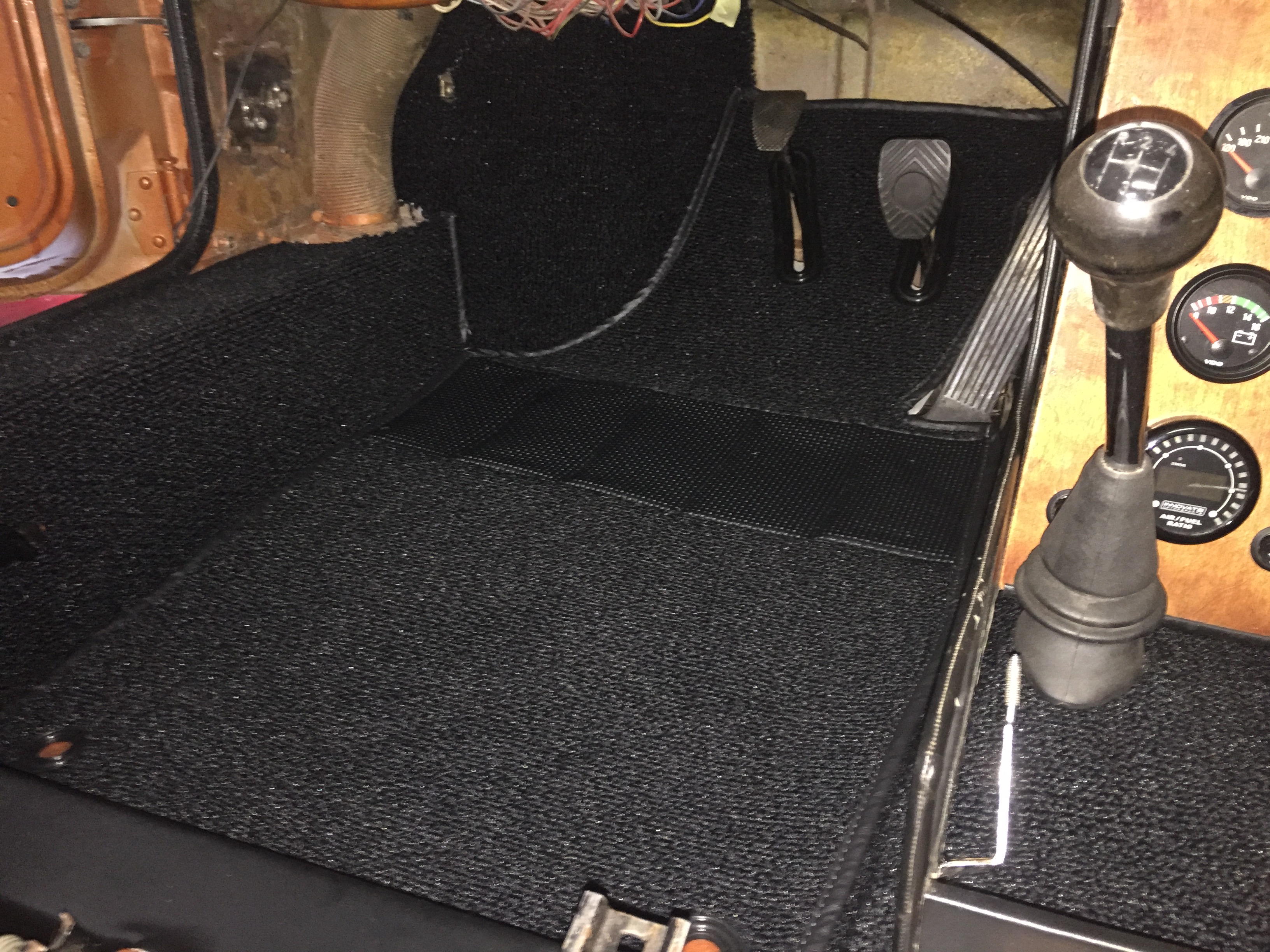

carpets fit pretty good, Mark did a good job- slight alteration on the drivers side around the e-brake area, but turned out fine. i used up a huge can of spray stuff heavy duty, have to go back and get the stuff for the sail panel trim- Auto Zone does not carry the 3M 90, so i have to check out Advanced-
post Sep 1 2018, 03:17 PM
Post #293
914-6 GT in waiting
Posts: 20,959
Joined: 19-September 09
Member No.: 10,825
QUOTE(DRPHIL914 @ Sep 1 2018, 05:05 PM) *
The big box hardware stores usually have it.

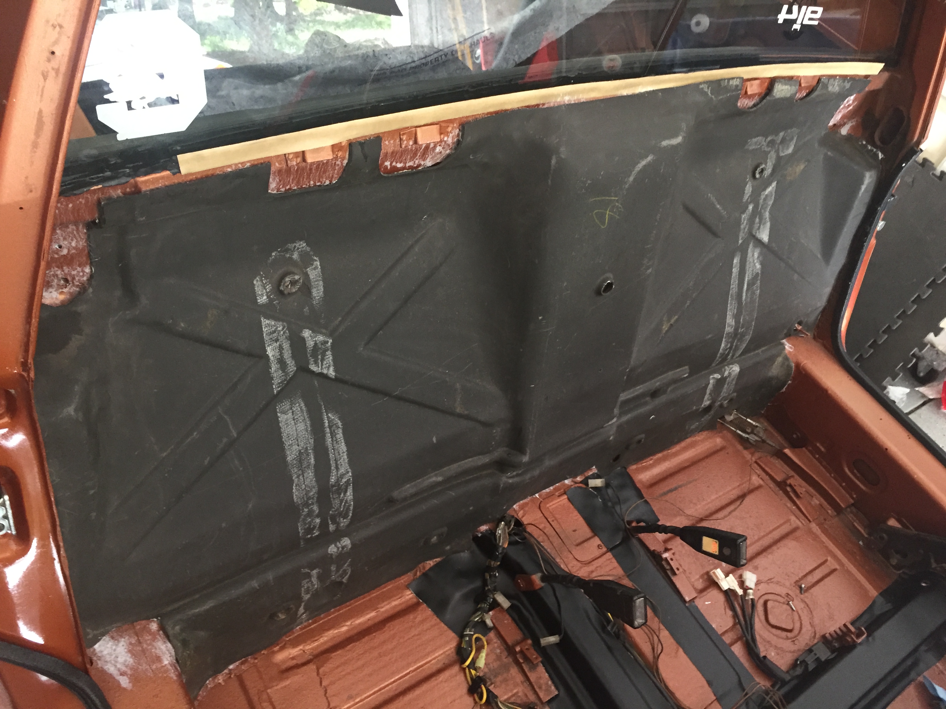

what order in reassembly do the targa bar pieces and interior trim fo in?
i have the seat belts back in, next is the side trim then back pad?
i have to put on the new sail panel teim and targa vinyl - so that first, then the bolster, anything else i am missing?

QUOTE(DRPHIL914 @ Sep 1 2018, 04:51 PM) *
Sounds like you pretty much have the correct order figured out.
Go slow on that sail panel/targa vinyl.
Measure twice cut once for sure.
On all this stuff including the carpeting, I used a contact spray adhesive vs a spray glue.
This contact adhesive really holds things down, but you get one chance to place it right.
So alignment aids (like tape) really help.
Also having an assistant for the long piece that goes across the top was essential for me.
The side sail pieces you can do yourself.
Place the trim beforehand so you can see where that side sail vinyl needs to go so that it's covered up by the trim.
Then take the trim off and get that vinyl in there.
Good luck.

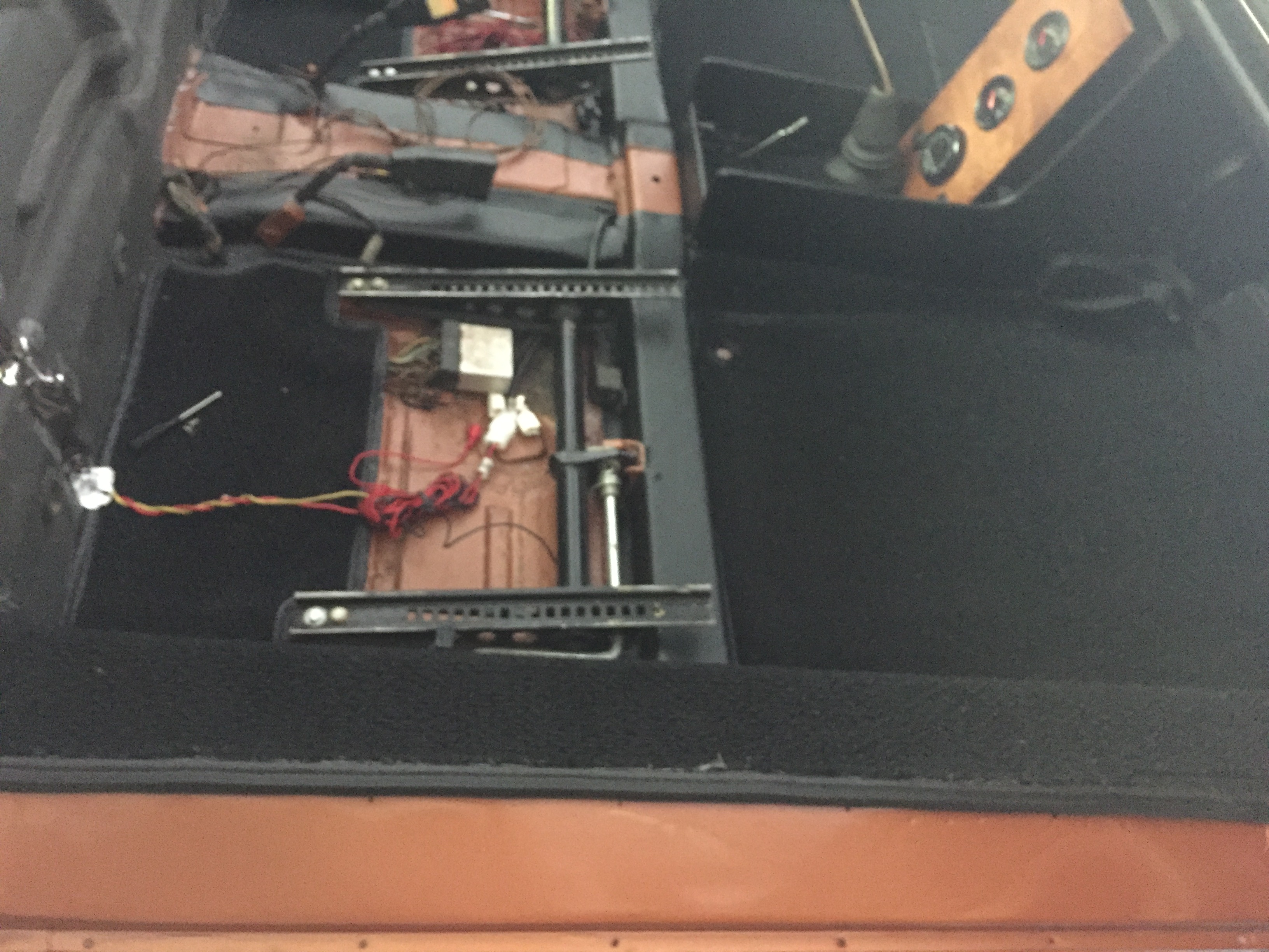

drivers side is all in and works but does not close flush, might try your method and check the 2 clicks,
going to fight the passenger side later today, once i get the air box and gas tank in first!
got the carpet in , close to getting my back pad and seats .

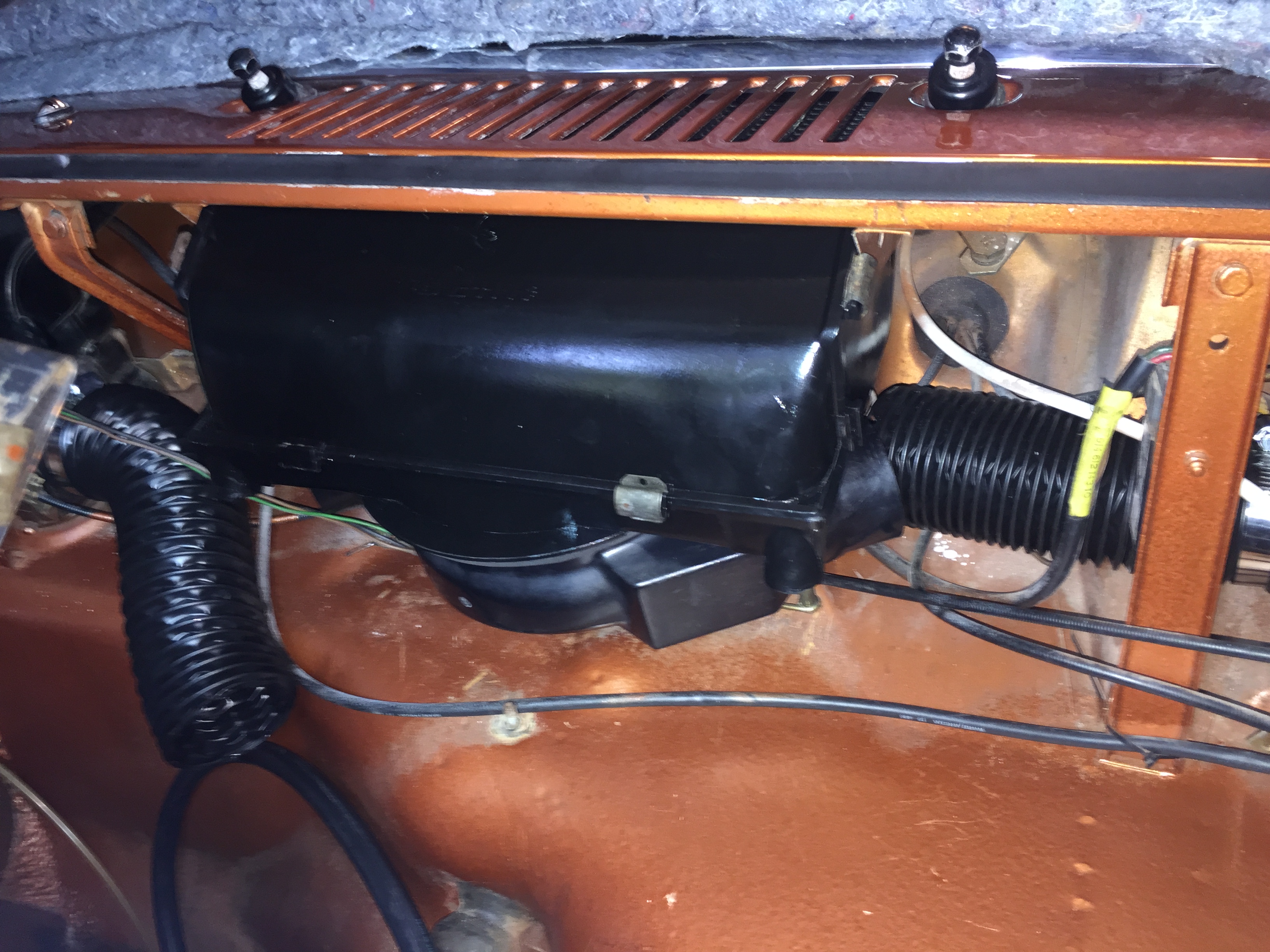

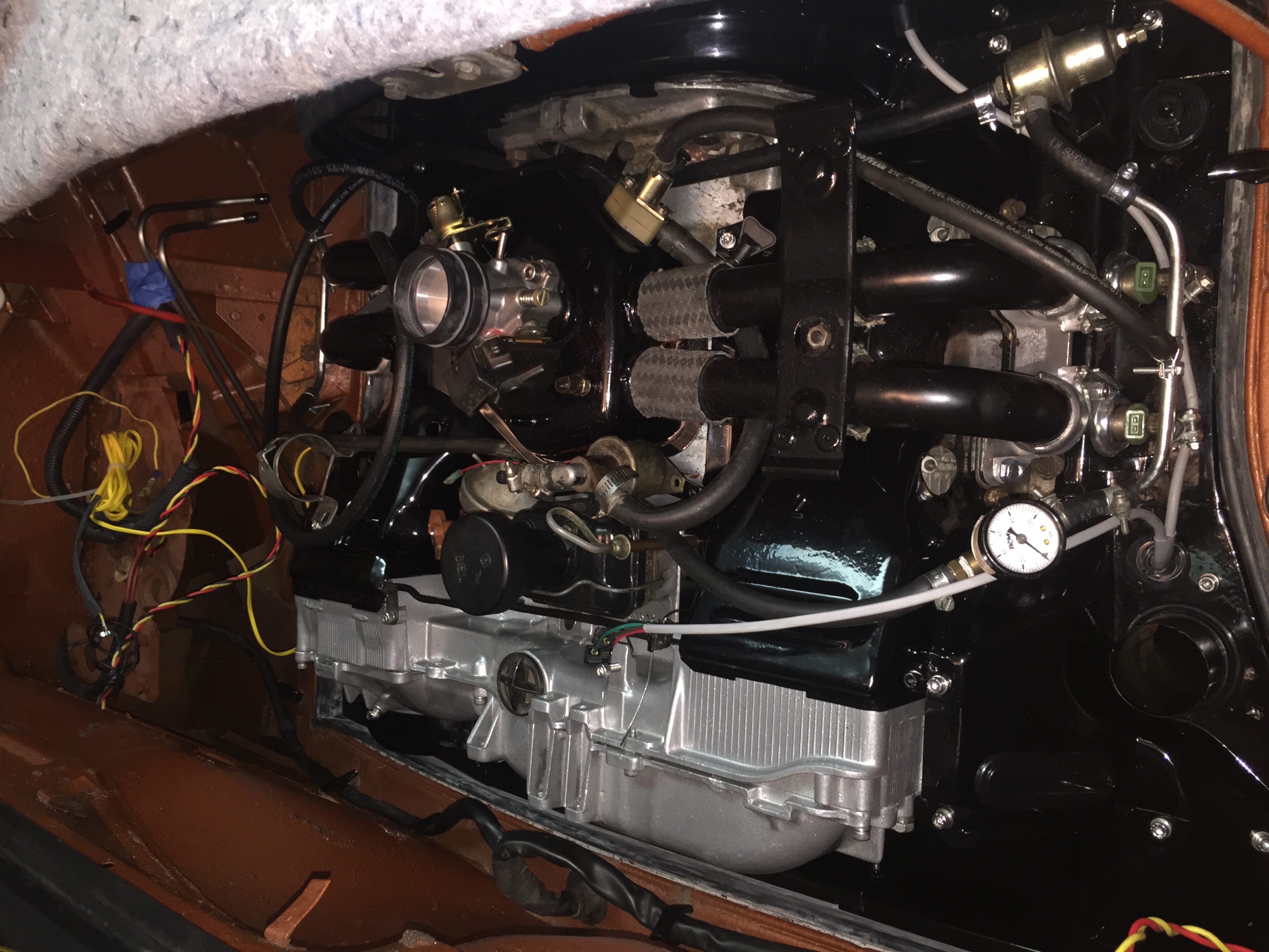

success! the air box is in
tested the fan works great but my controller may need to be replaced but not now, i took apart the blower and did new seals, cleaned it out and checked the resistors too, put it all back together and new seals between upper ans lower box, and at the top screen
