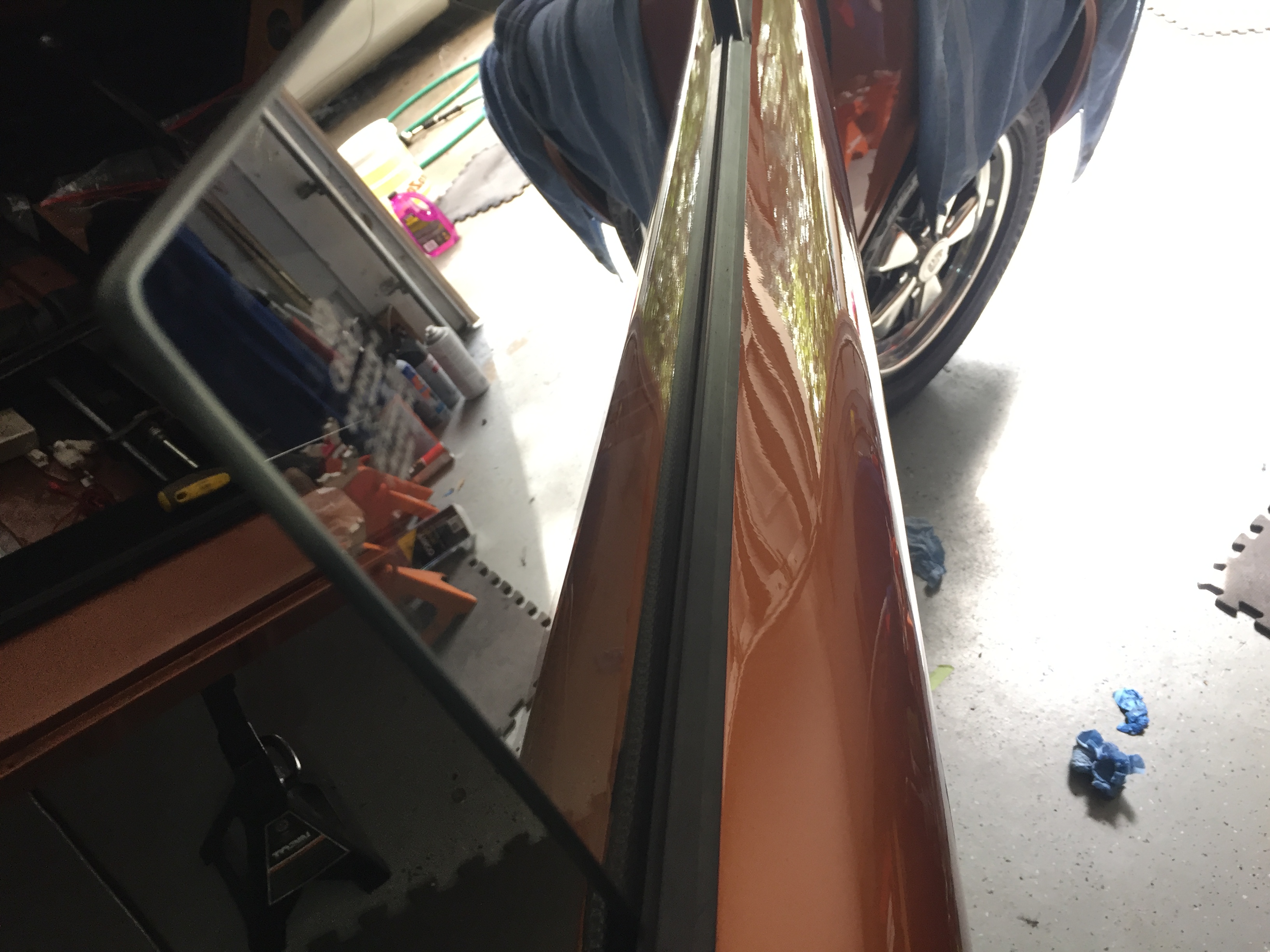

1. installed the seals on the passenger door- yea thats right! window installed, all the fuzzies etc.

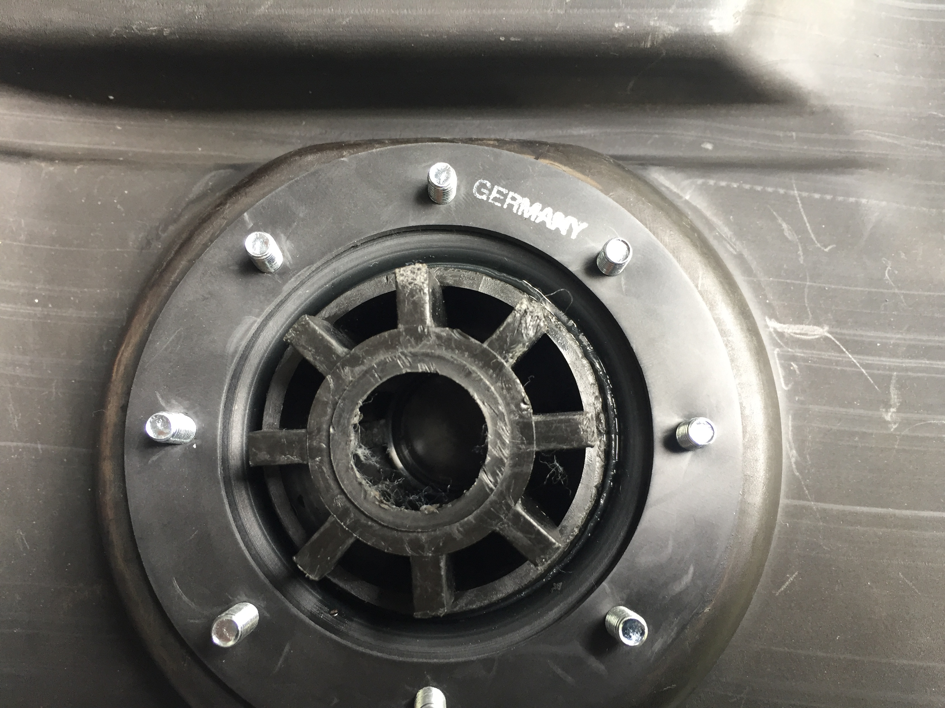

new seals for the tank

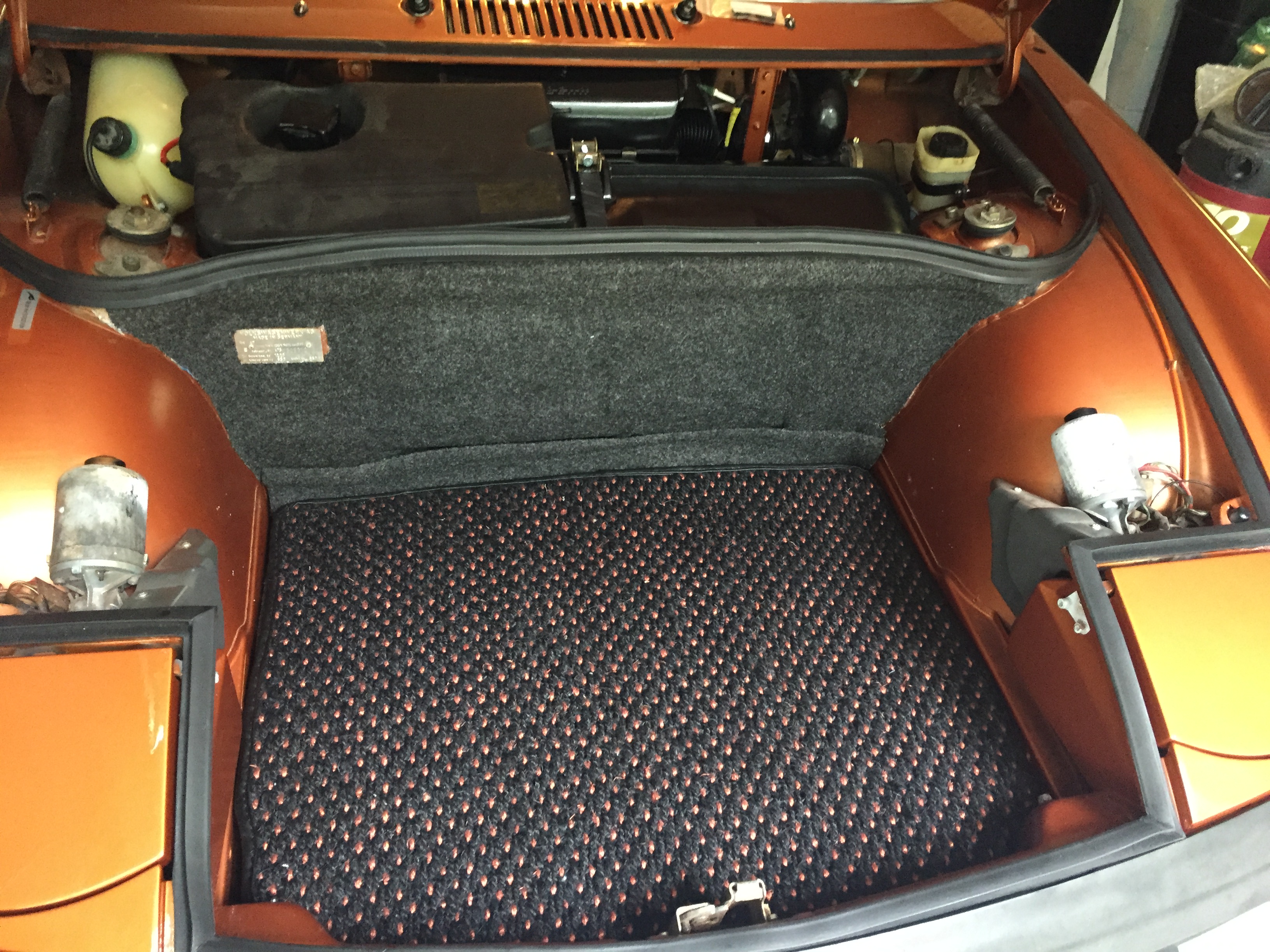

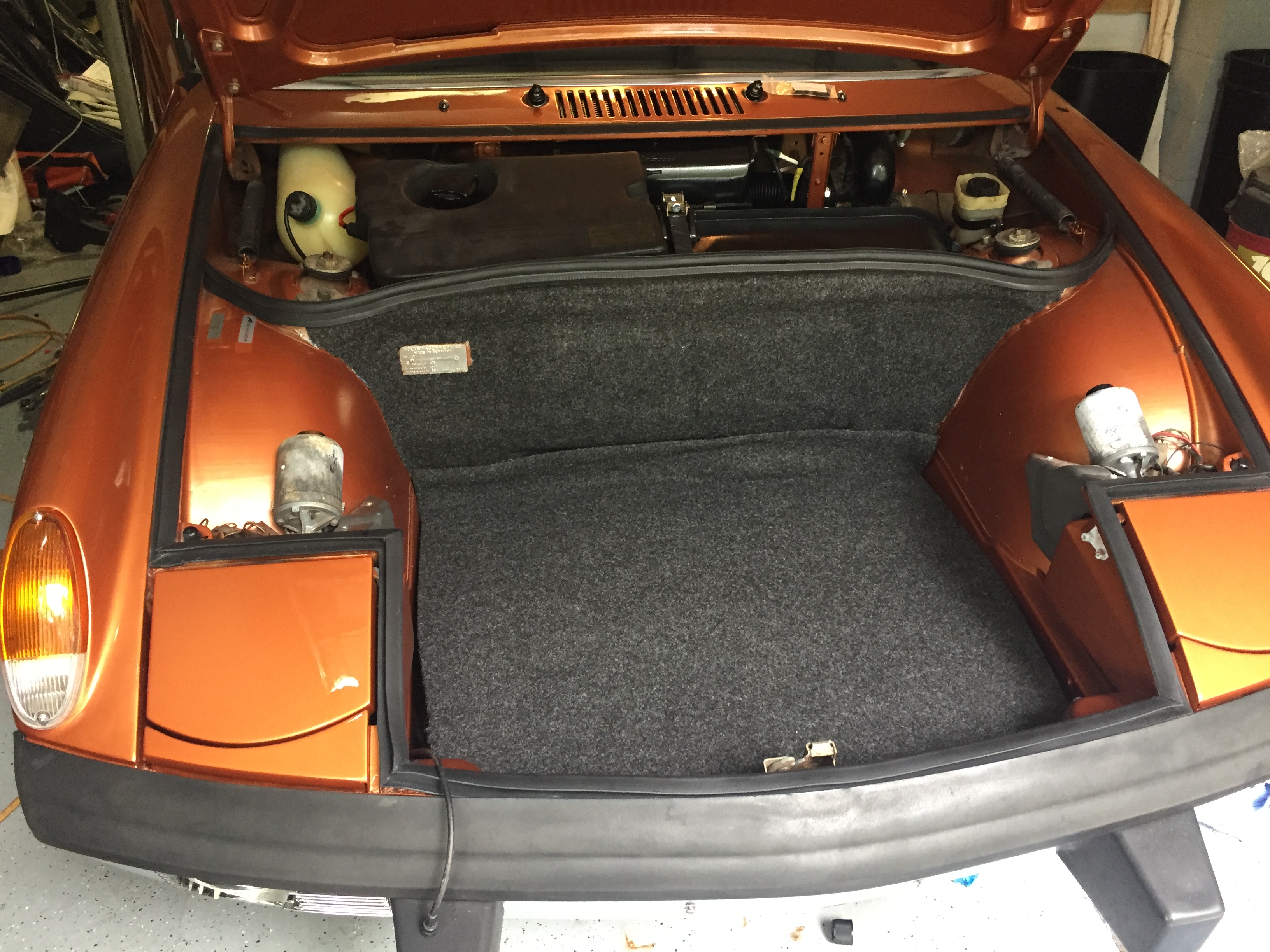

new felt on trunk wall
DRPHIL914
post Sep 3 2018, 08:37 PM
Post #307
Dr. Phil
Posts: 5,971
Joined: 9-December 09
From: Kennesaw, GA
Member No.: 11,106
was some overspray on the old felt- also have a nice cocomat for front trunk

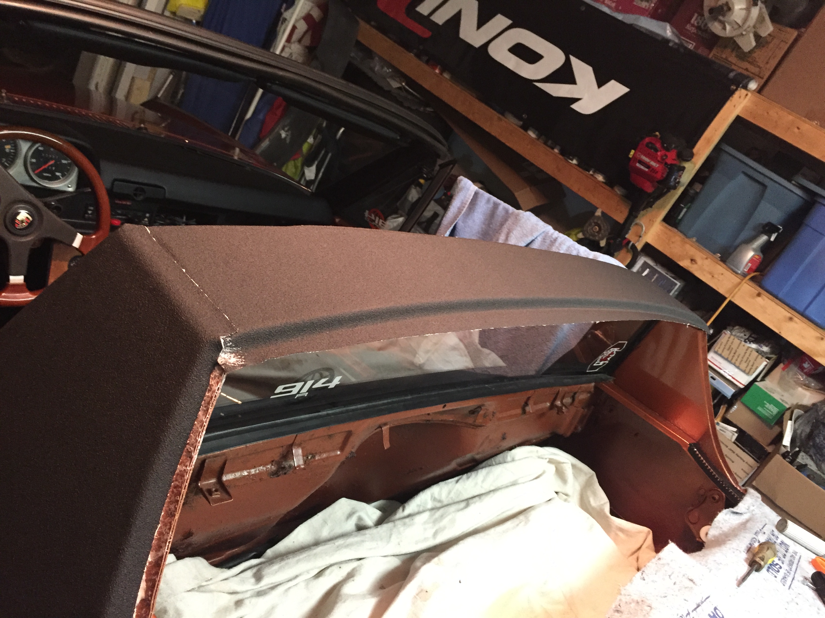

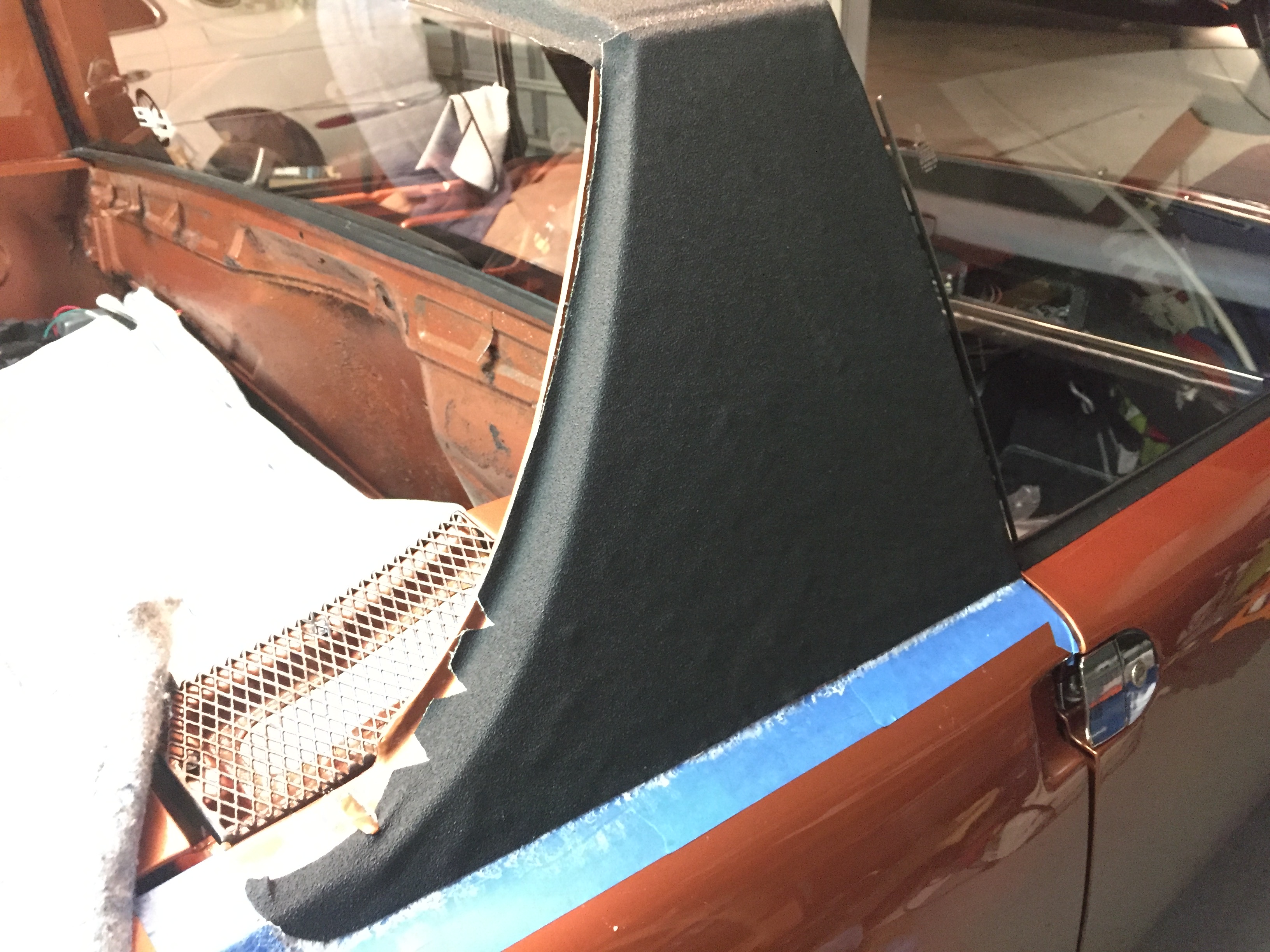

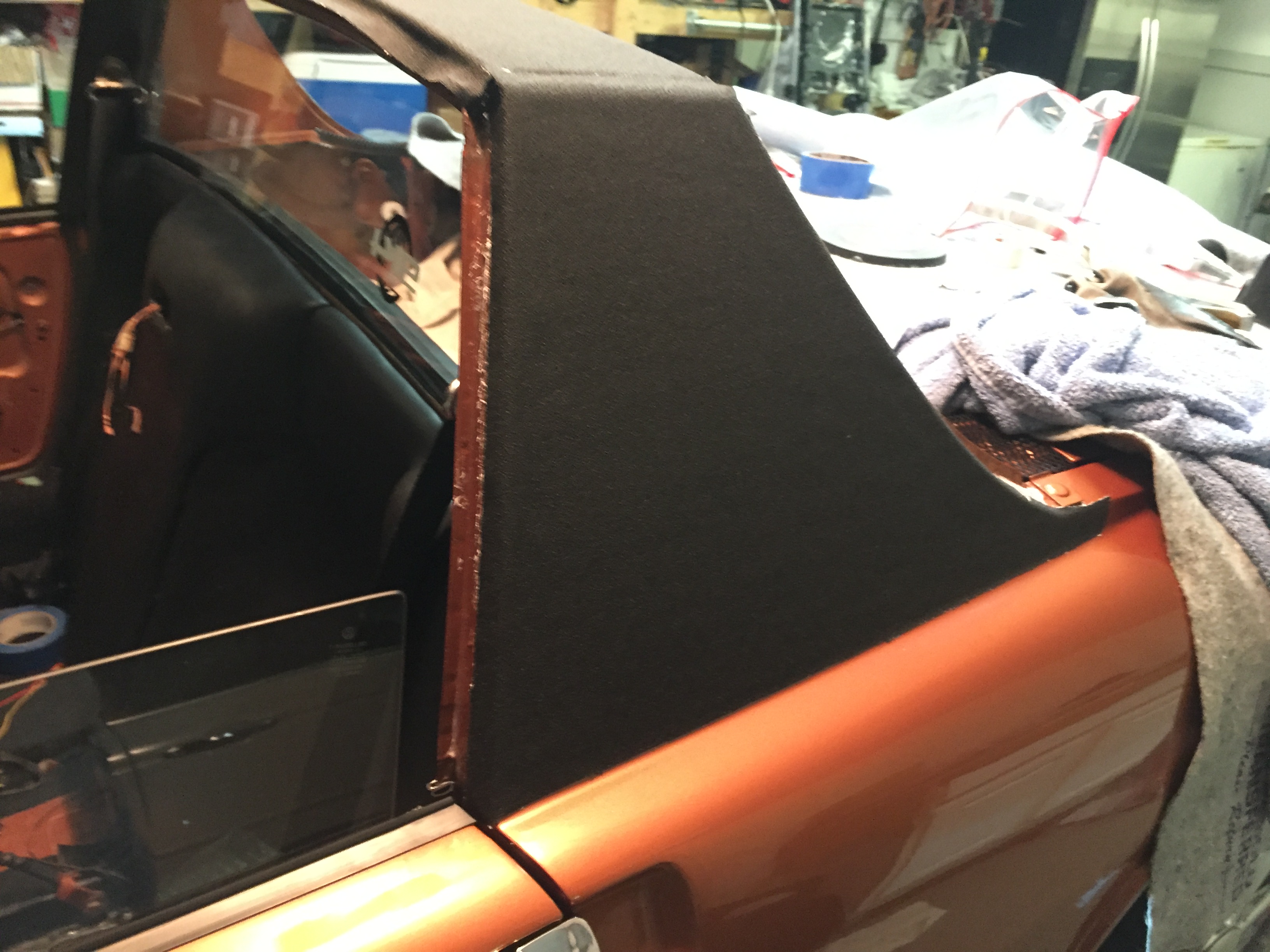

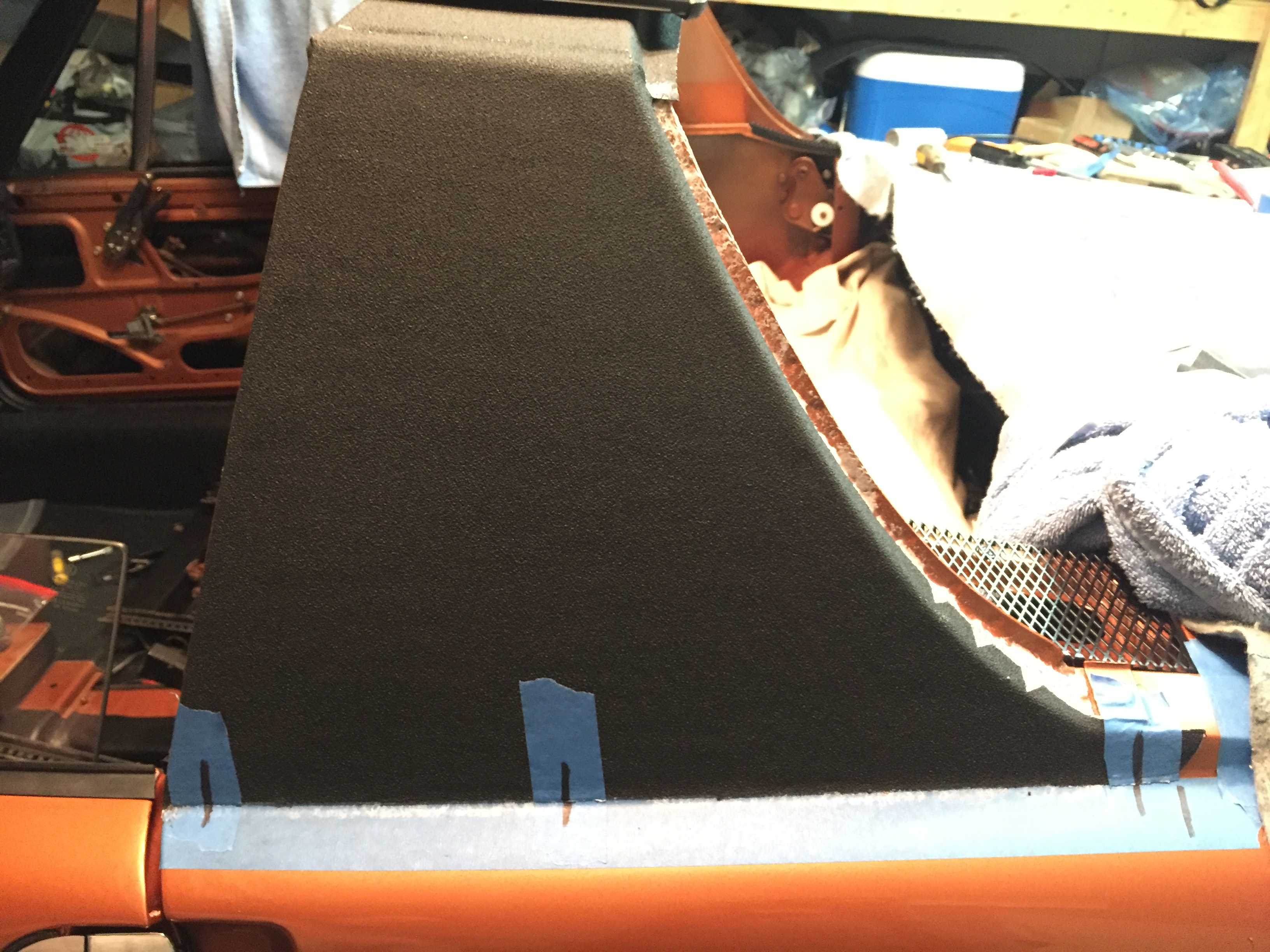

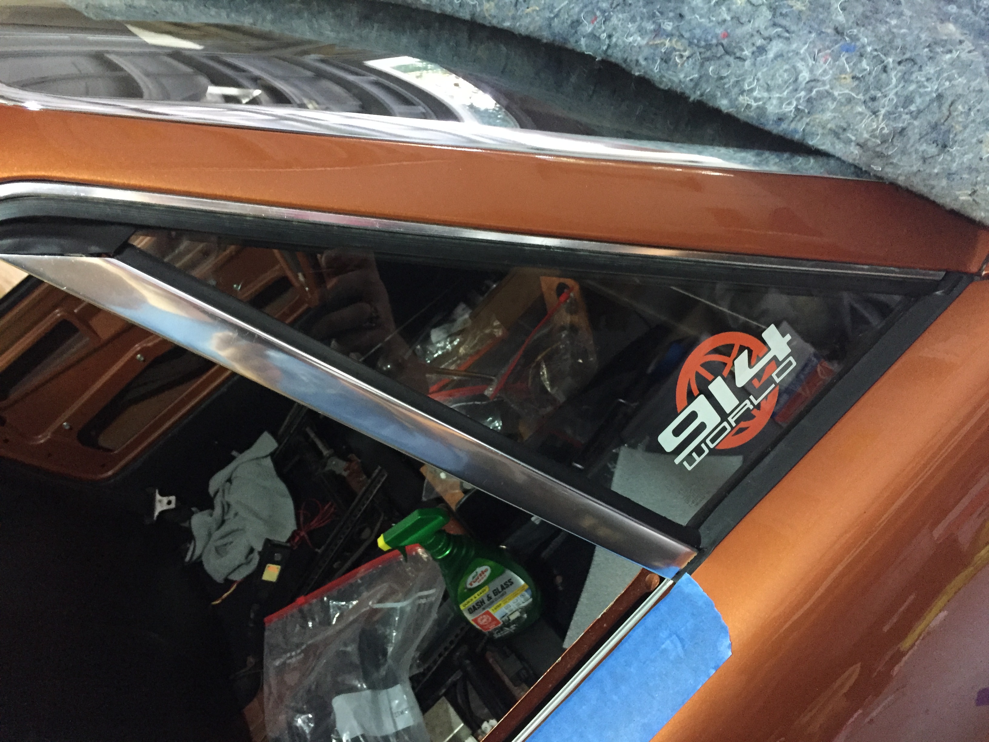

so, here is the story on the vinyl -
will probably have to re do the right side- I was a bit short on the cut and knew it might not fit, sure was tight , i think it would have been ok but no room for errors, well i had to pull it off and my mistake was trying to put it back on, cleaned up the panel, reglued it but it is now not smooth, a bit bumpy and that is not satisfactory so i have to reorder righr side sail vinyl- Calling Mark , hello 914rubber, i have a special request!

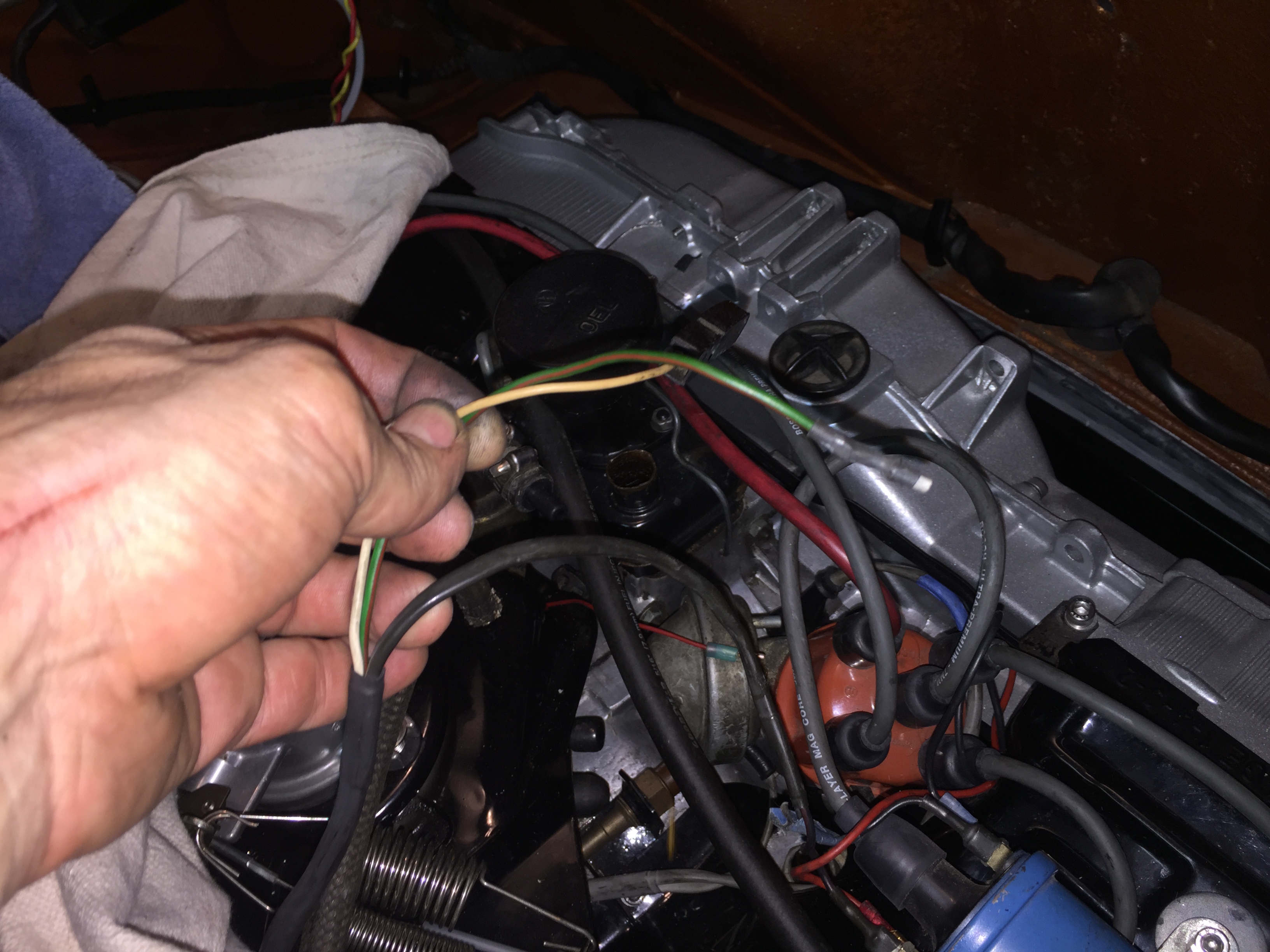

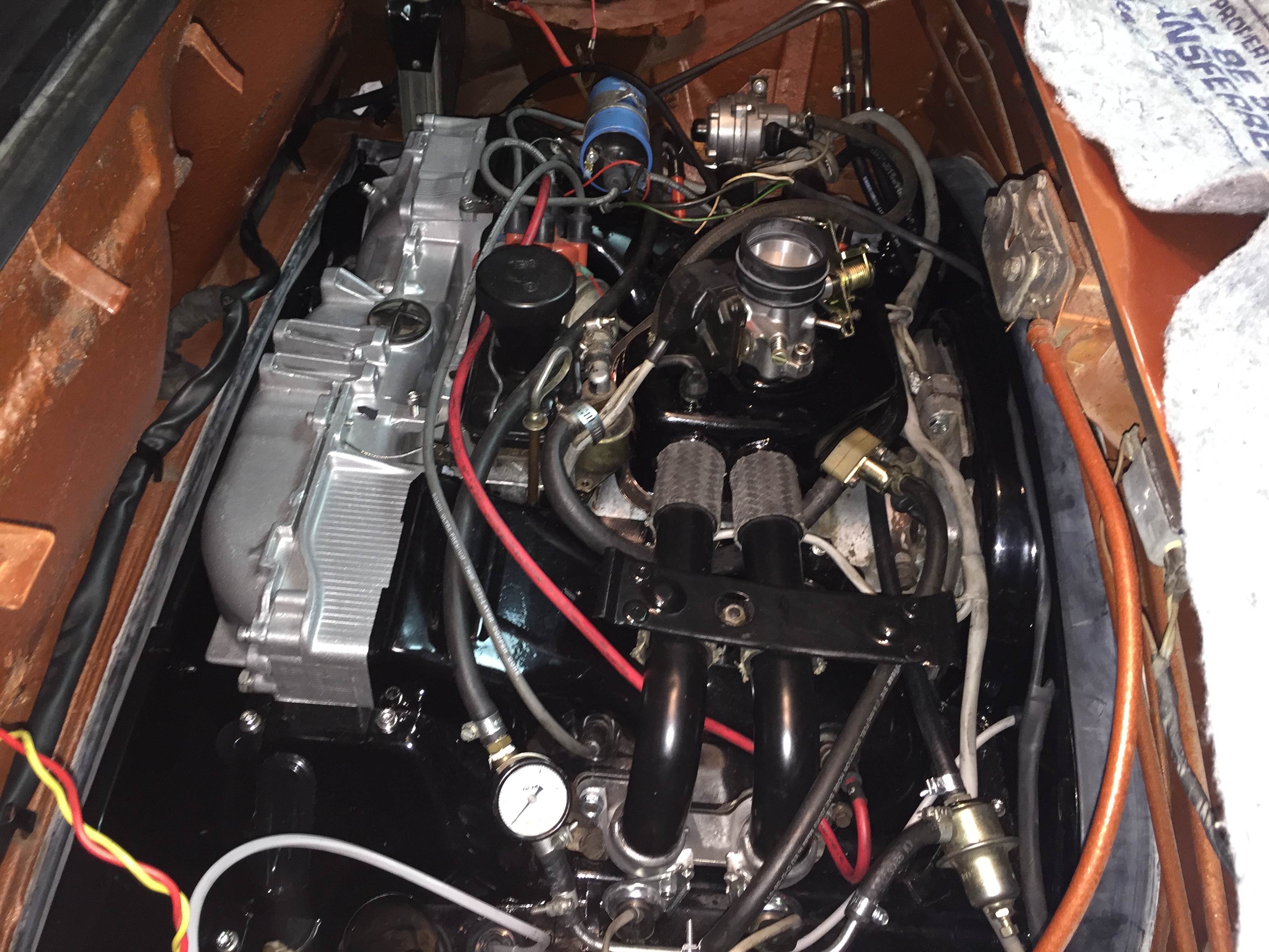

so these wires come off of the same harness that goes to the coil, one is white , other is green/red- where do they go?
DRPHIL914
post Sep 3 2018, 09:30 PM
Post #312
Dr. Phil
Posts: 5,971
From: Kennesaw, GA
Member No.: 11,106
QUOTE(DRPHIL914 @ Sep 3 2018, 10:55 PM) *
- oil pressure switch and the aar, right?
IronHillRestorations
post Sep 4 2018, 05:31 AM
Post #313
I. I. R. C.
Posts: 6,958
Joined: 18-March 03
From: West TN
Member No.: 439
QUOTE(DRPHIL914 @ Sep 3 2018, 07:30 PM) *
Yes

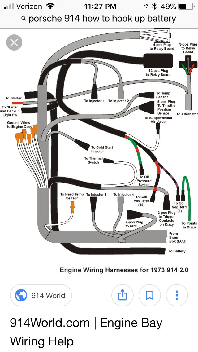

found this diagram for the FI wiring with colors a labels , very helpful.
getting close, ready to add the vac lines!

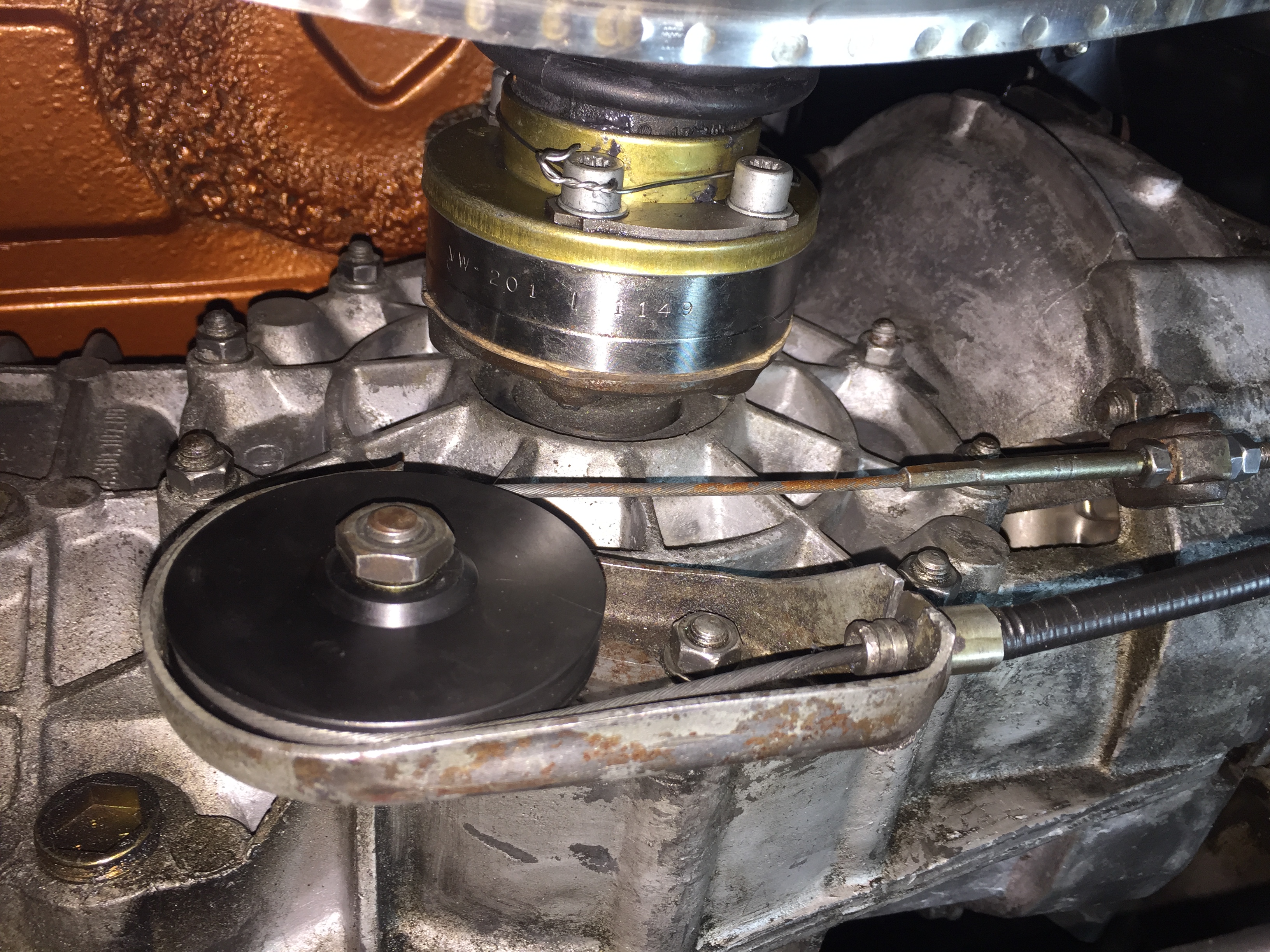

new CV boots, NOS from 914sixer, so now the 6 hole flange is gone, no more slinging grease all over! safety wire in place, also new retainer band on the shift linkage cover,
