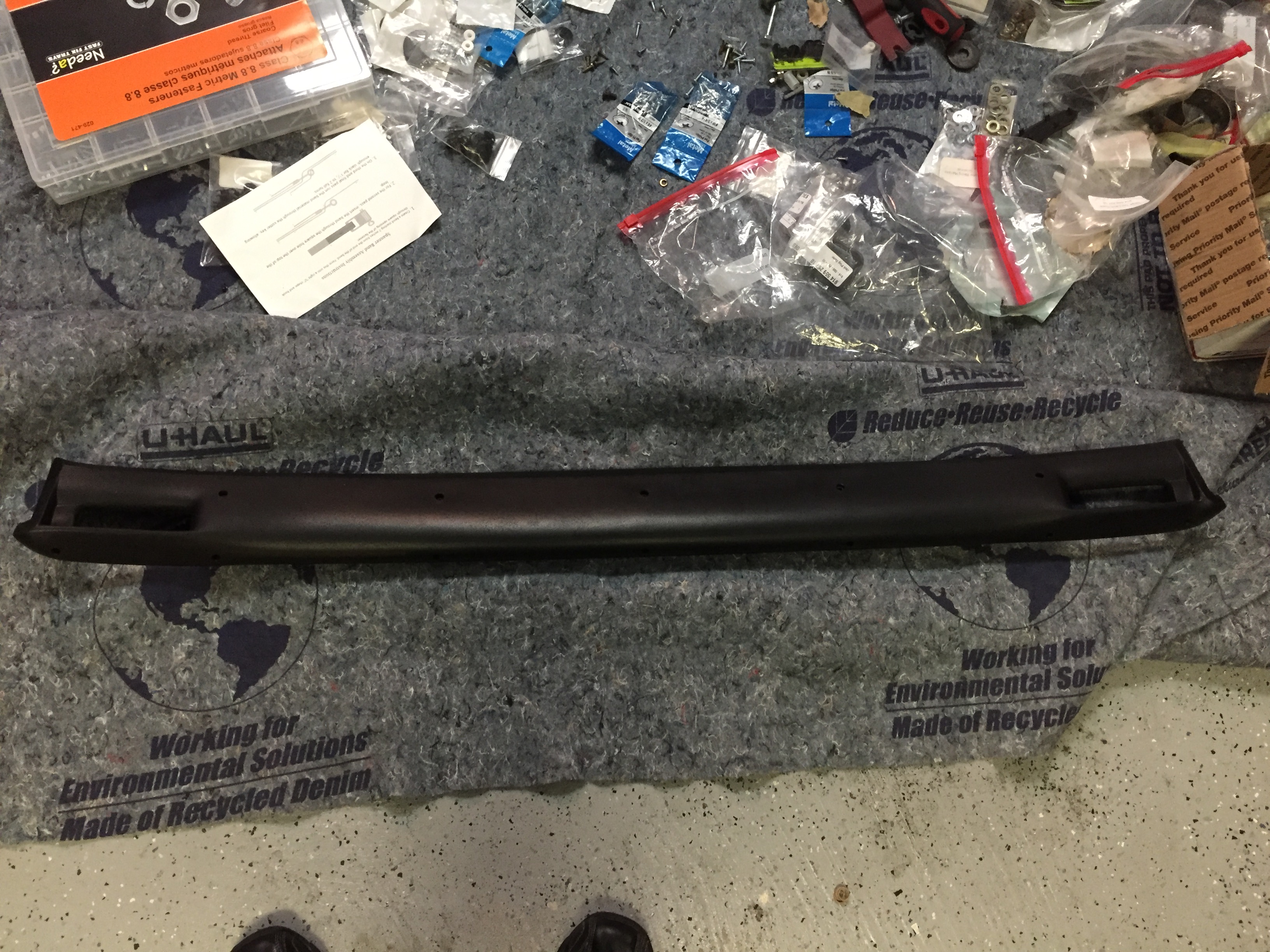

before installation

This rear targa bolster is the repro one being carried by 914rubber but i think has been made by AA - anyway the fit and finish is super and this will last a lifetime and not peel crack etc like the original ones. Yes, they can probably improve the grain to be more accurate for the concourse weenies but this is great for me and it really looks super, now for finishing off the rest of the trim around the targa bar/ sail panels. i have a few parts due in the next few days that i am excited about getting on the car to finish it up.

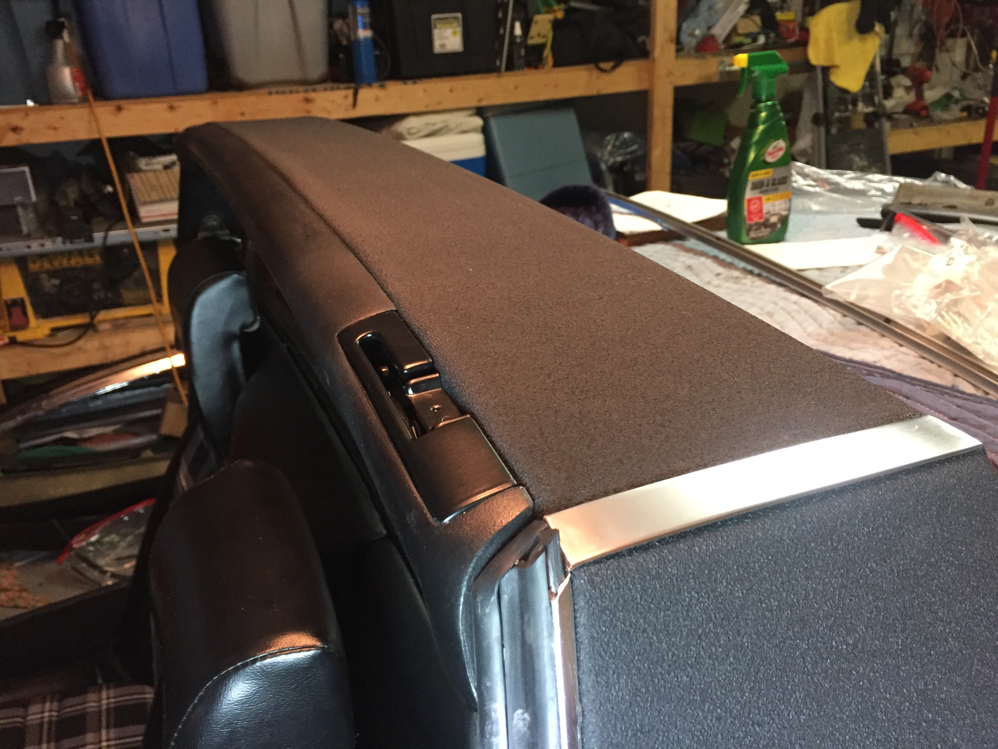

any assembly instructions for the rear sail panel trim? what is the order of assembly?
also having issues with the adhesive we used for this the edges are coming up along back side of the targa bar. could it be the heat and humidity? thinking about hitting the edges that pulled up with contact cement and see if that will hold it down. both the permatex heavy duty and the 3M99 not holding well.
- it looks like the bottom edge trim, followed by the vertical trim and seal at front of the sail, and then the rear back targa bar trim followed last by the curved rear sail panel trim.
I hope that is right. We will try and get this done tomorrow along with getting the rest of the vacuum hose on and the oil cooler moved and remounted, then I should be able to put the oil and gas in and we will try and see if it will fire up.
Lots of new stuff on there, new alternator and belt, new front crank seals and oil cooler and seals, all new fuel lines and vac lines. about the only thing I didn't put on new is the starter is the same and the transmission was not removed, as it was rebuilt and resealed a few years ago at the Dr. Evil clinic in VA.

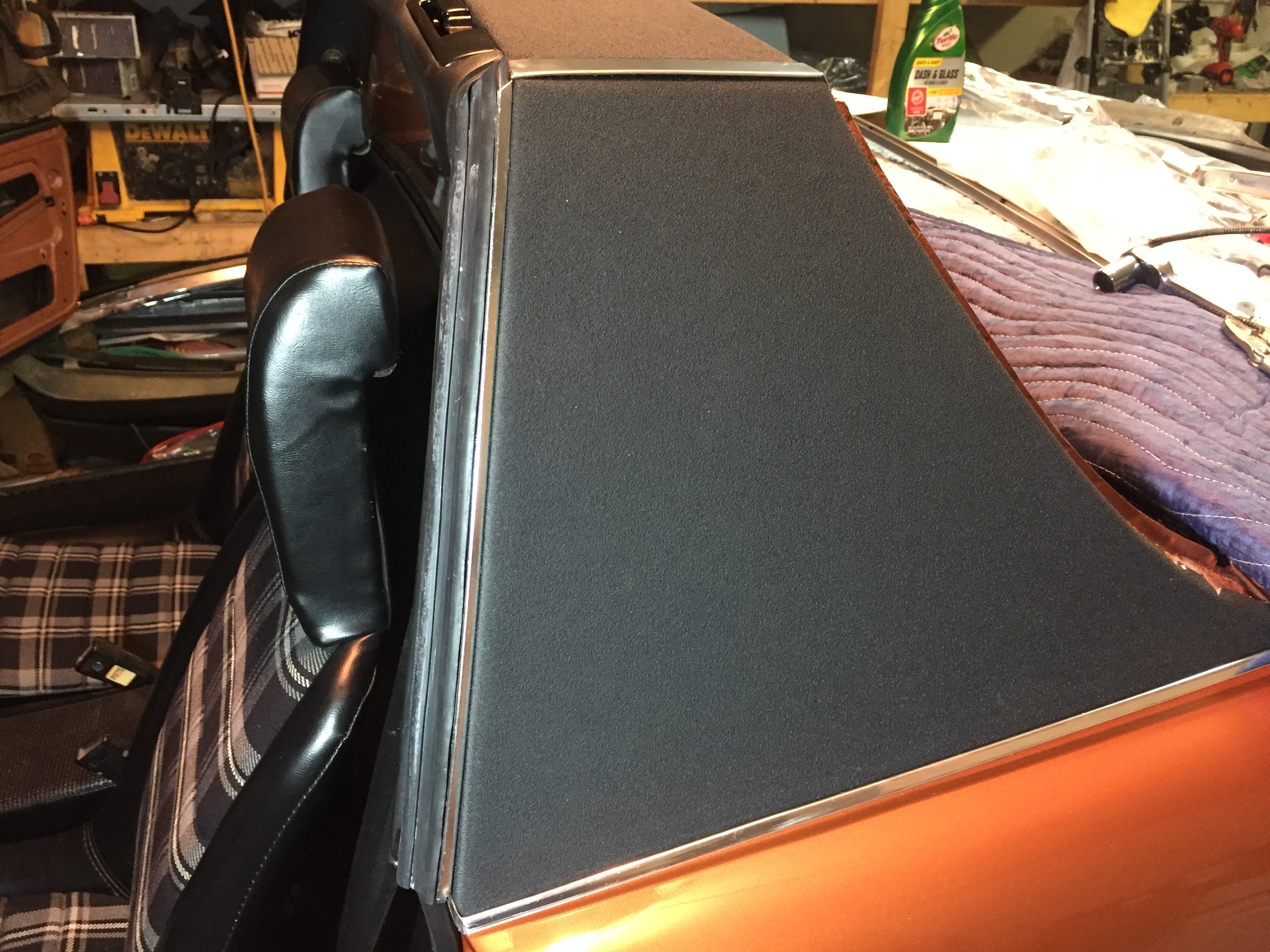

sail trim, vertical window seal, top trim and bottom in place on driver side

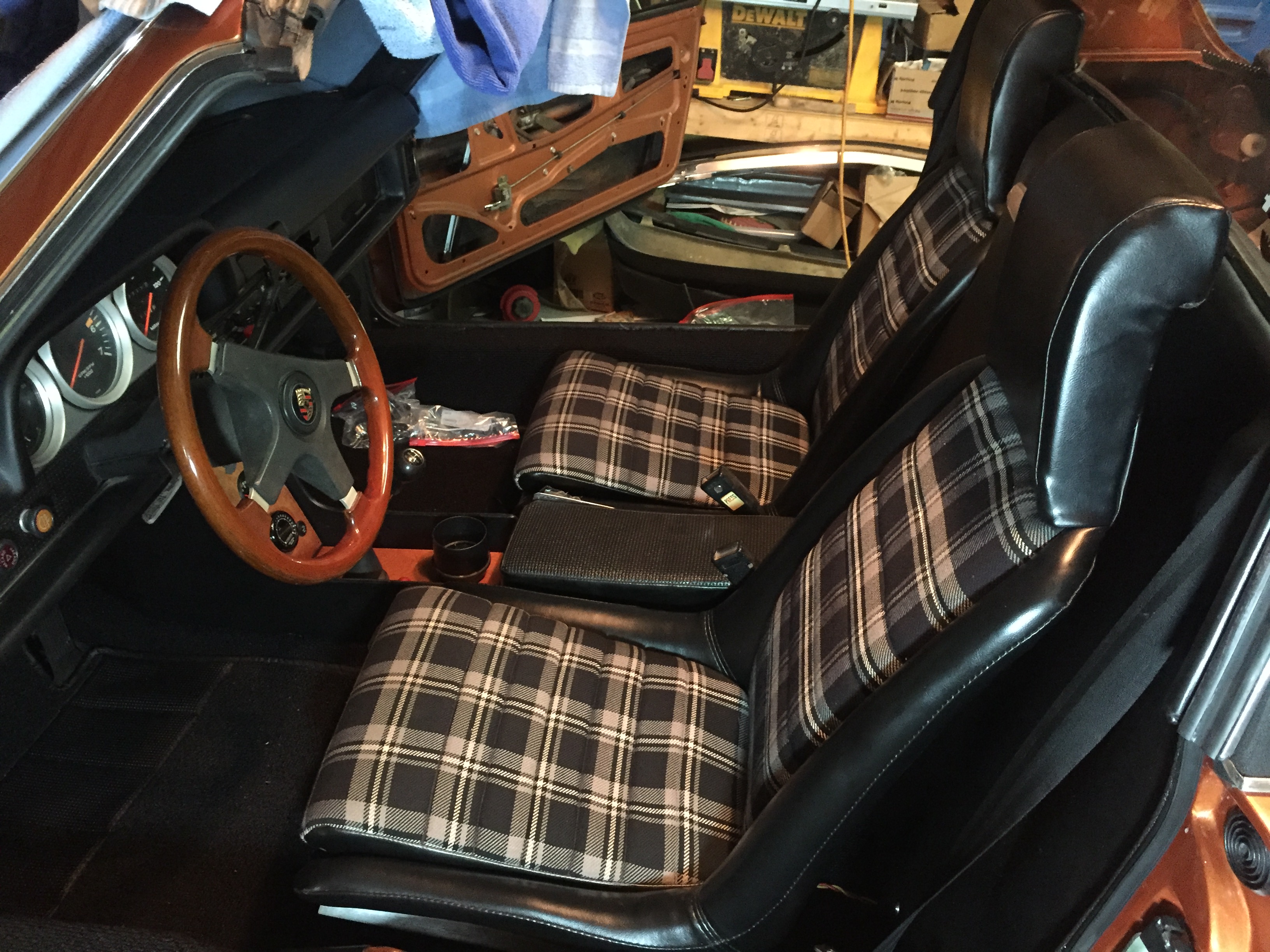

inners in with seat belts retractors , seats ,

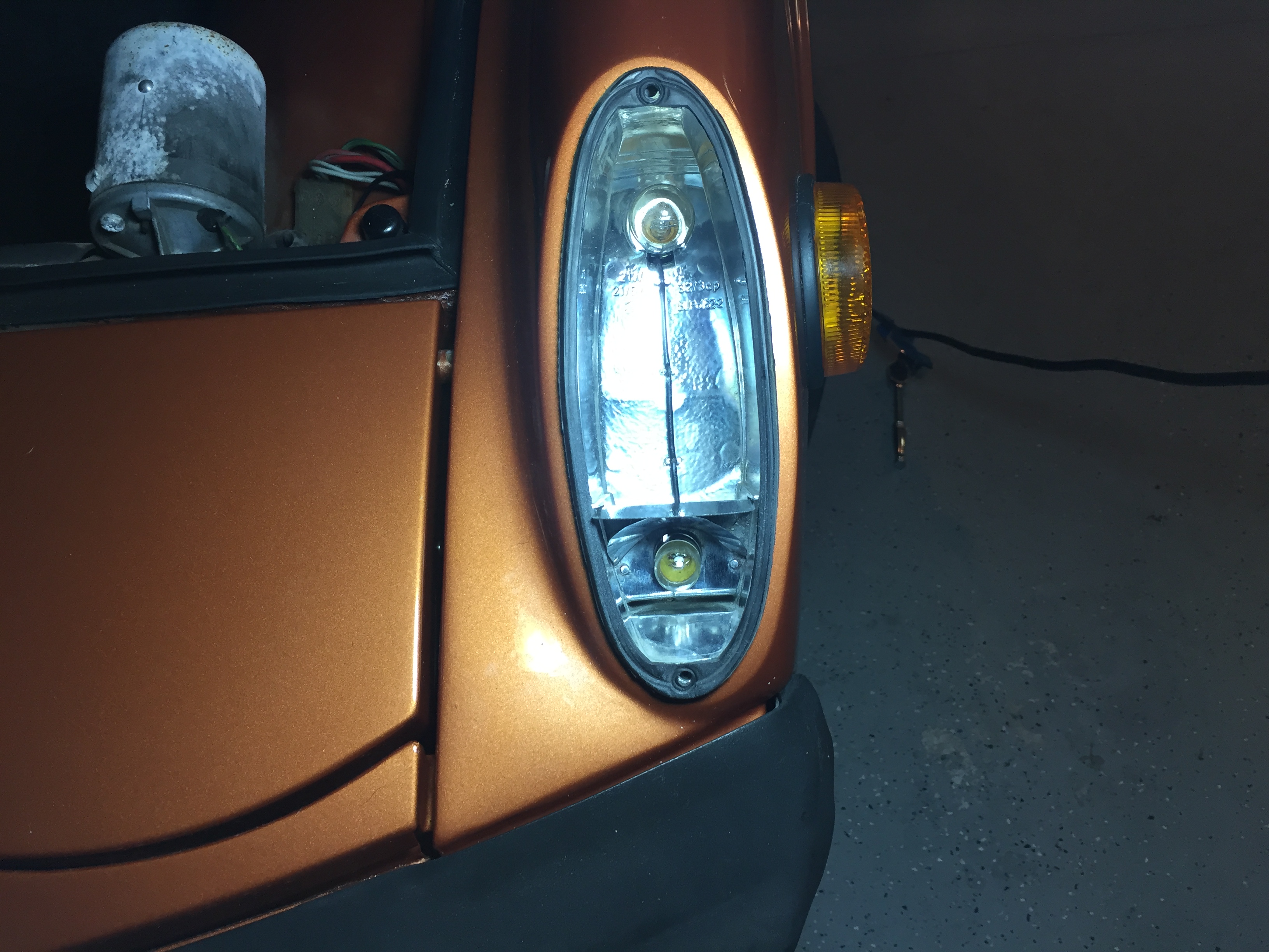

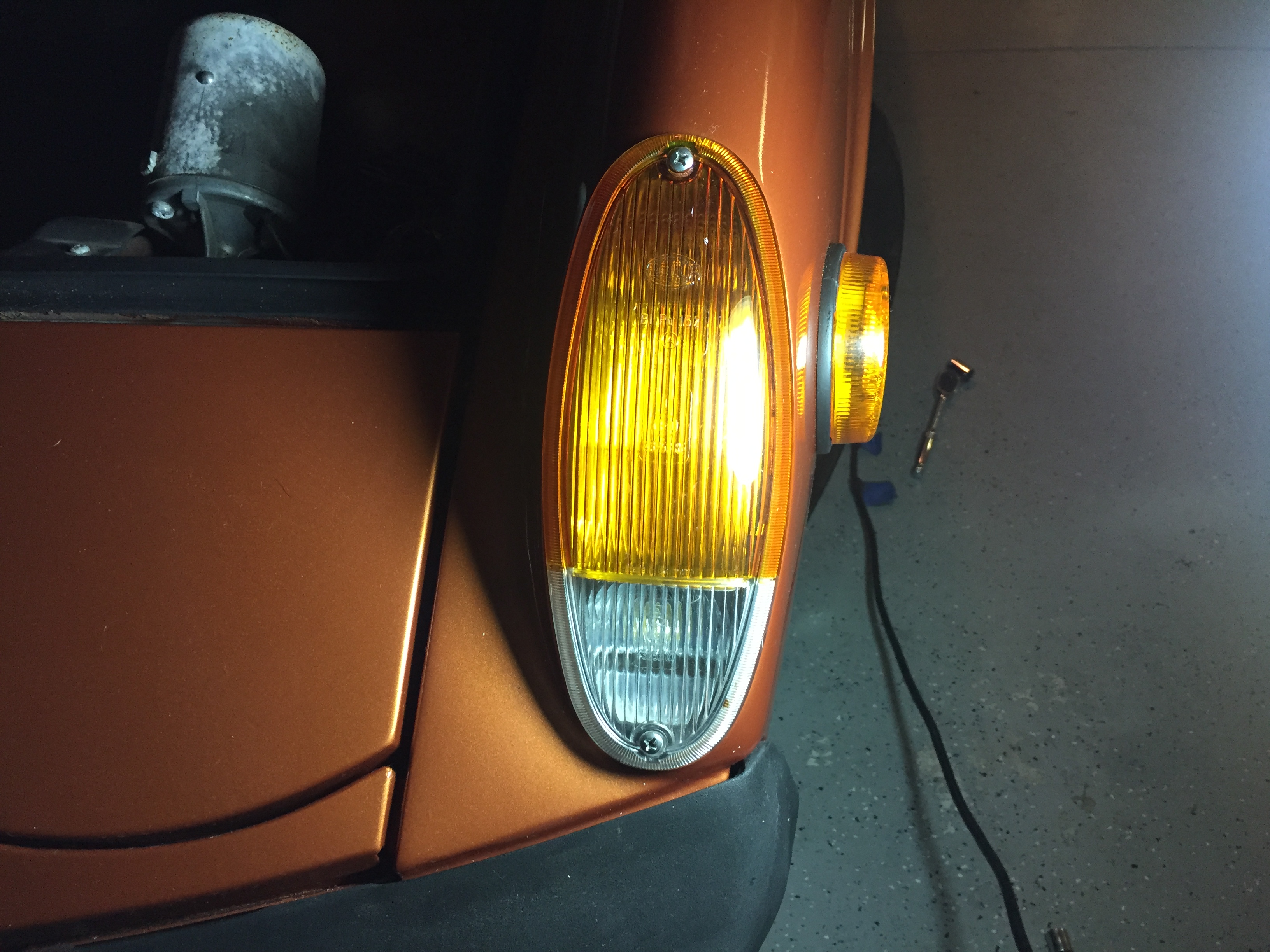

one side euro conversion done

A lot of progress. Congrats!
rhodyguy
post Sep 7 2018, 08:21 PM
Post #336
Posts: 22,254
Joined: 2-March 03
From: Orion's Bell. The BELL!
Member No.: 378
WOW! Seats look super. Your car has turned out very nice.

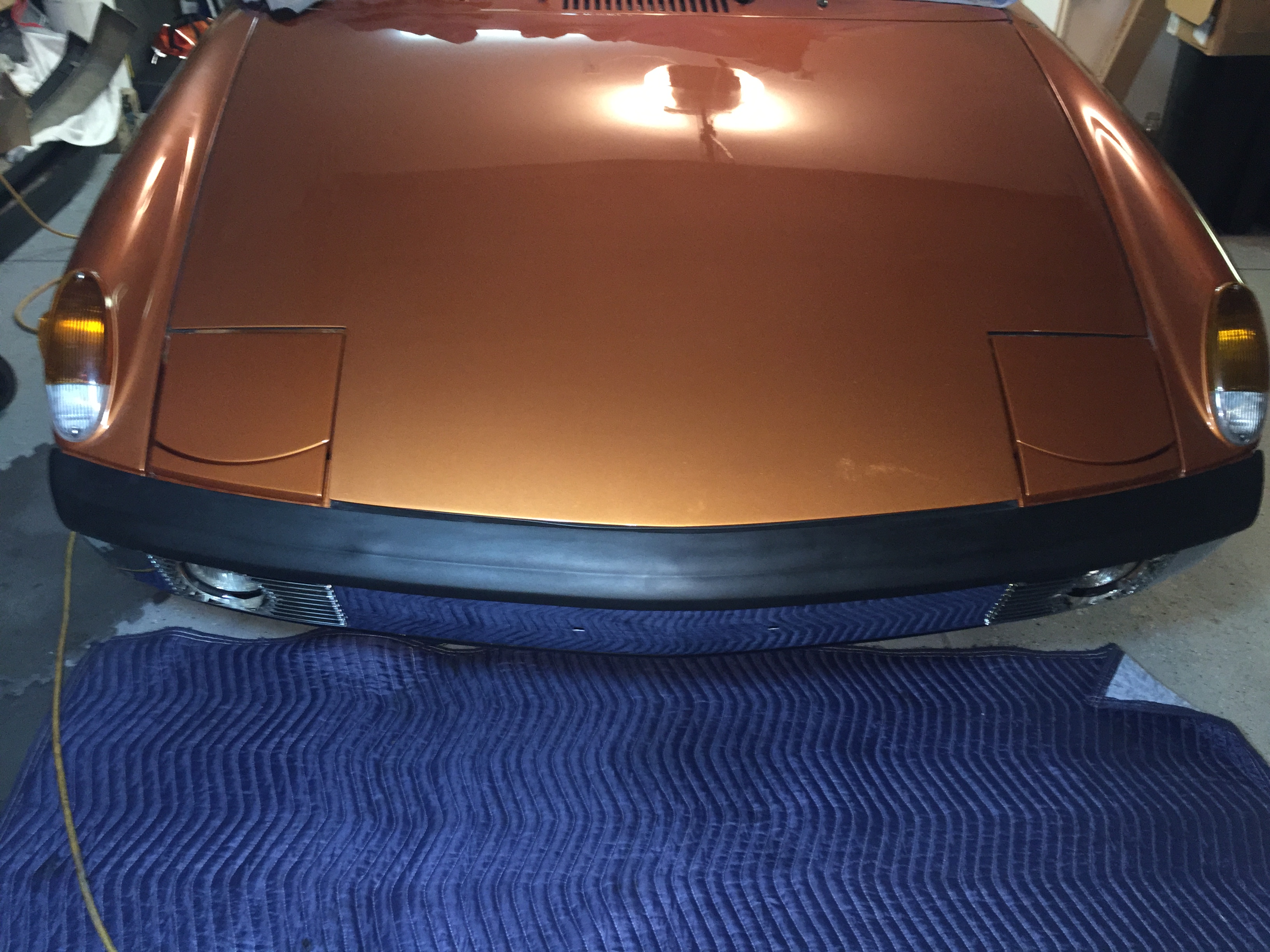

post Sep 7 2018, 09:42 PM
Post #337
Dr. Phil
Posts: 5,971
Joined: 9-December 09
From: Kennesaw, GA
Member No.: 11,106
thanks Kevin, thank you for the help and assistance parts wise too!

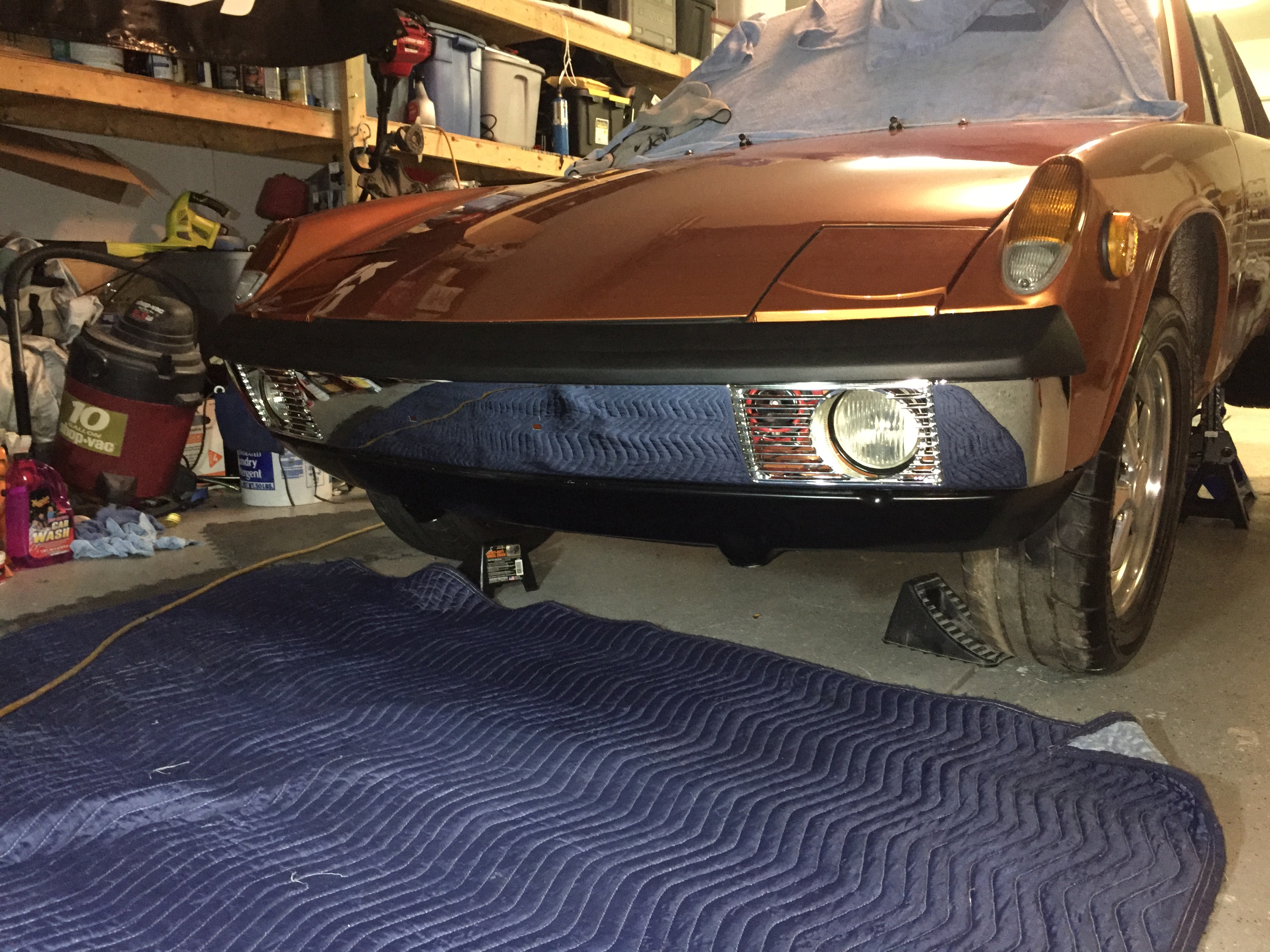

i just finished putting the early new rechromed bumper on, i will take better pictures in light tomorrow , new 914rubber topper on it as well.
