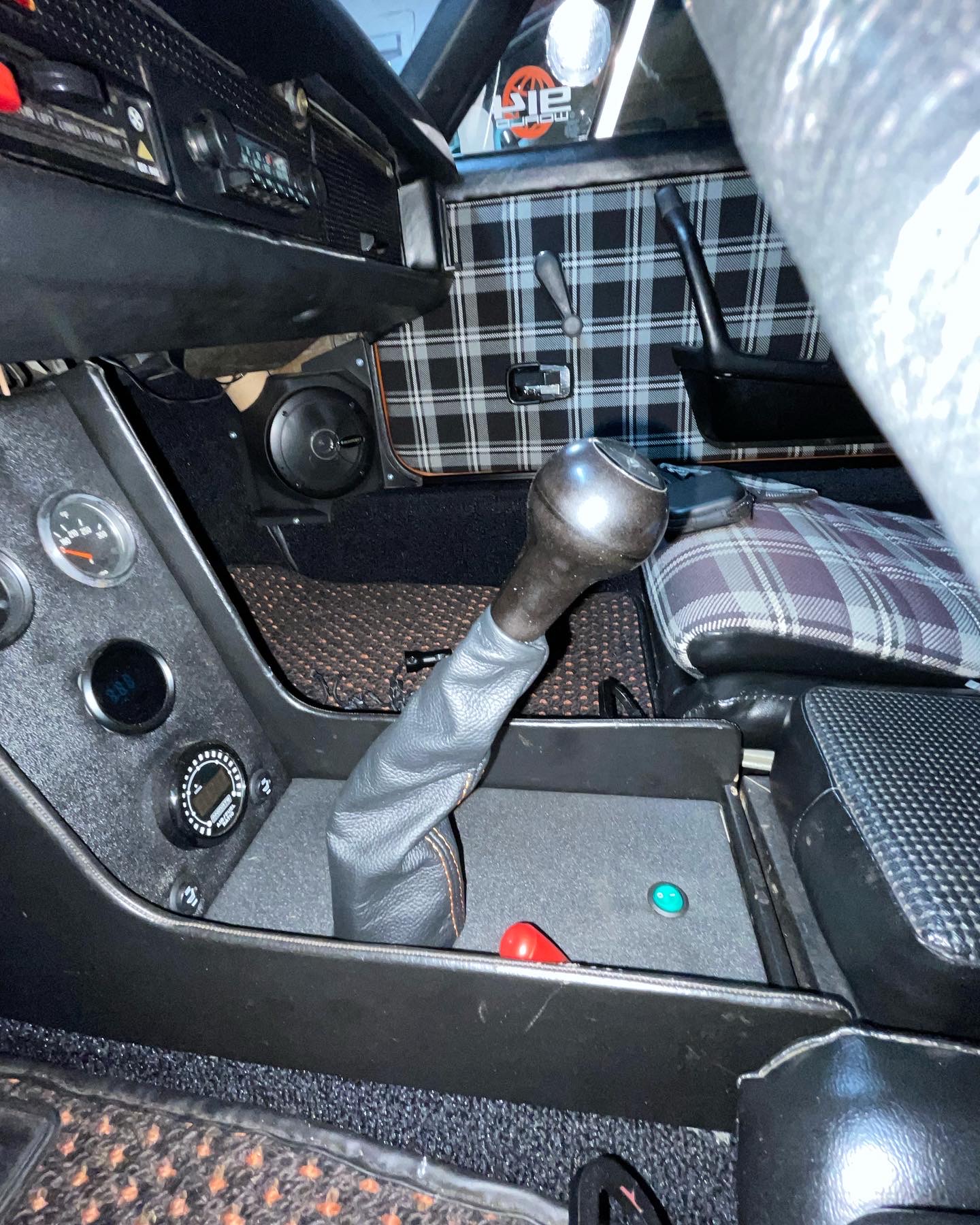

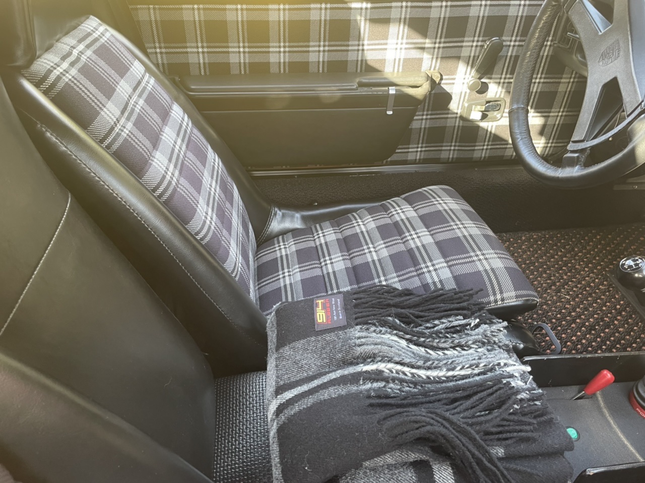

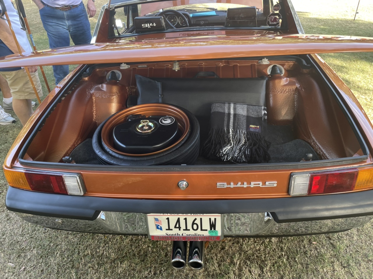

New custom leather shift boot, and the new tartan Scottish wool blanket from 914rubber , which is a awesome addition to coordinating with the interior and matching travel bags

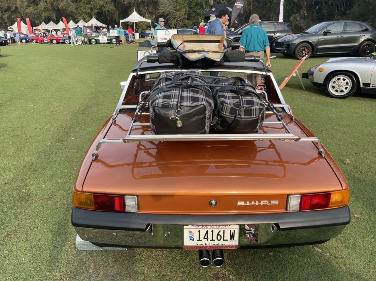

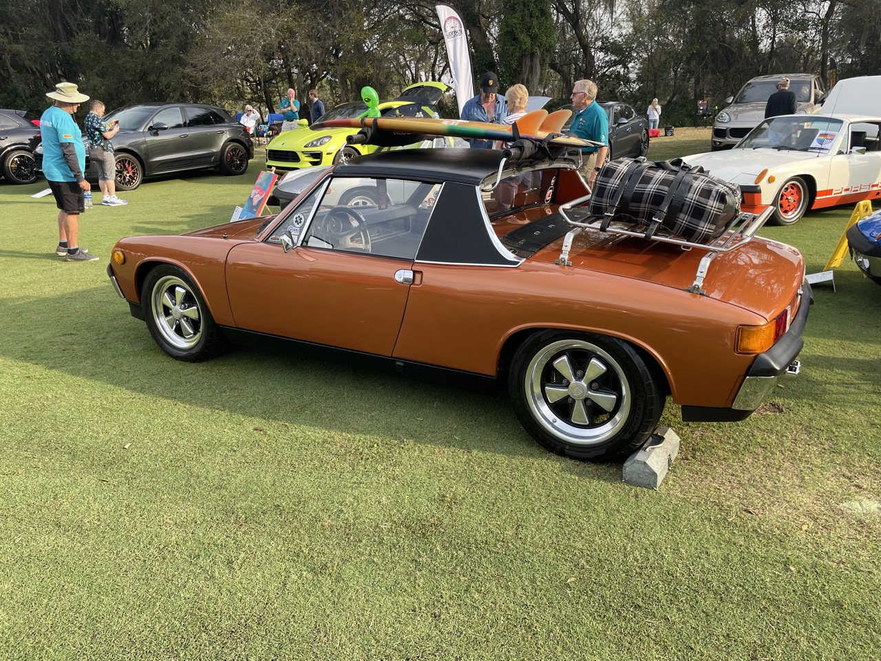

well now that we are back up and running (Thanks Sir Andy!!!!) thought i’d post on my recent showing at the HHI Concours, i may have done that on a different thread like “what did you do to your 914 today” but need to put it here too.
Order of Merit Award at the “Car Club Jamboree” 2 weeks back.

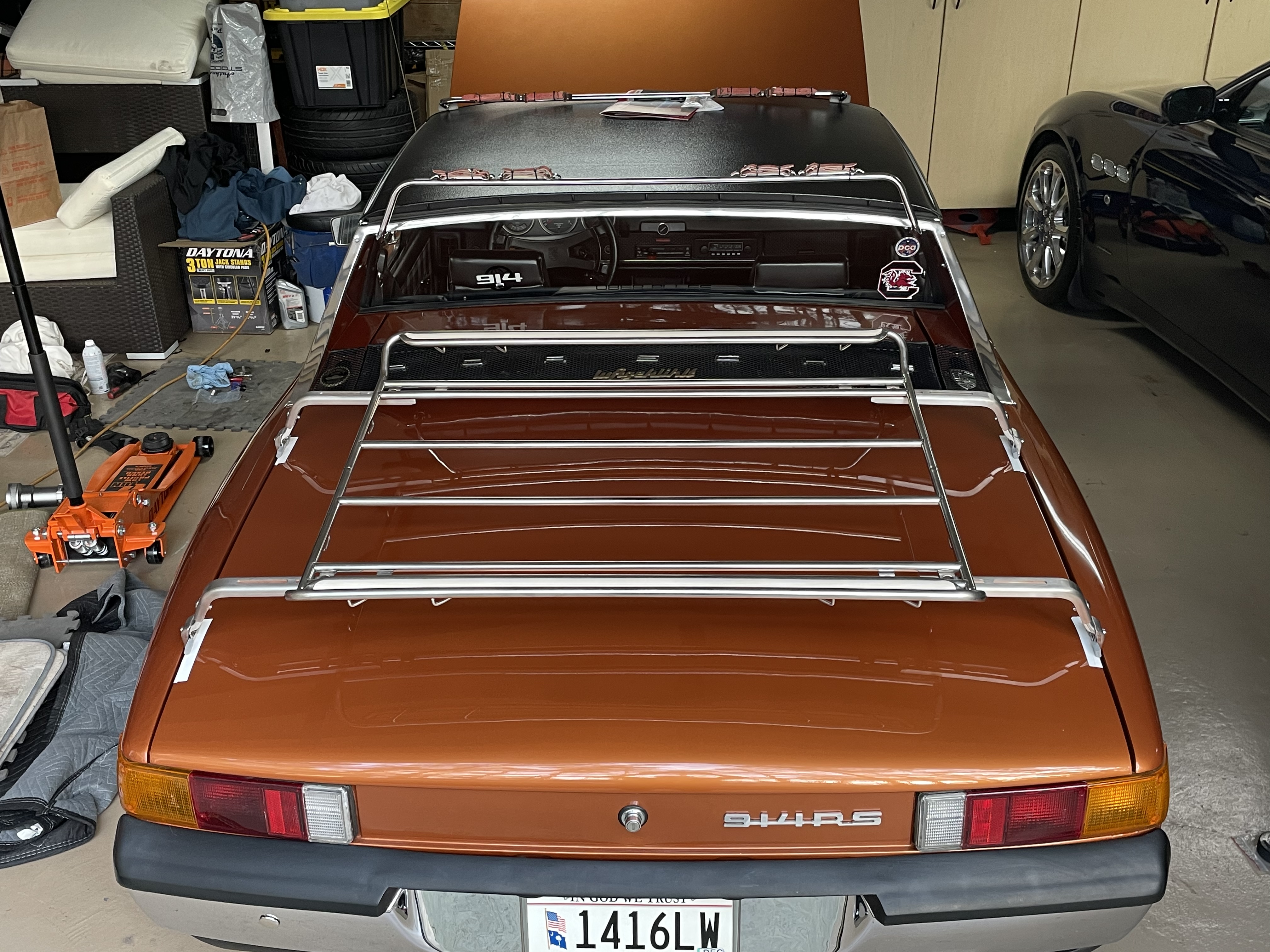

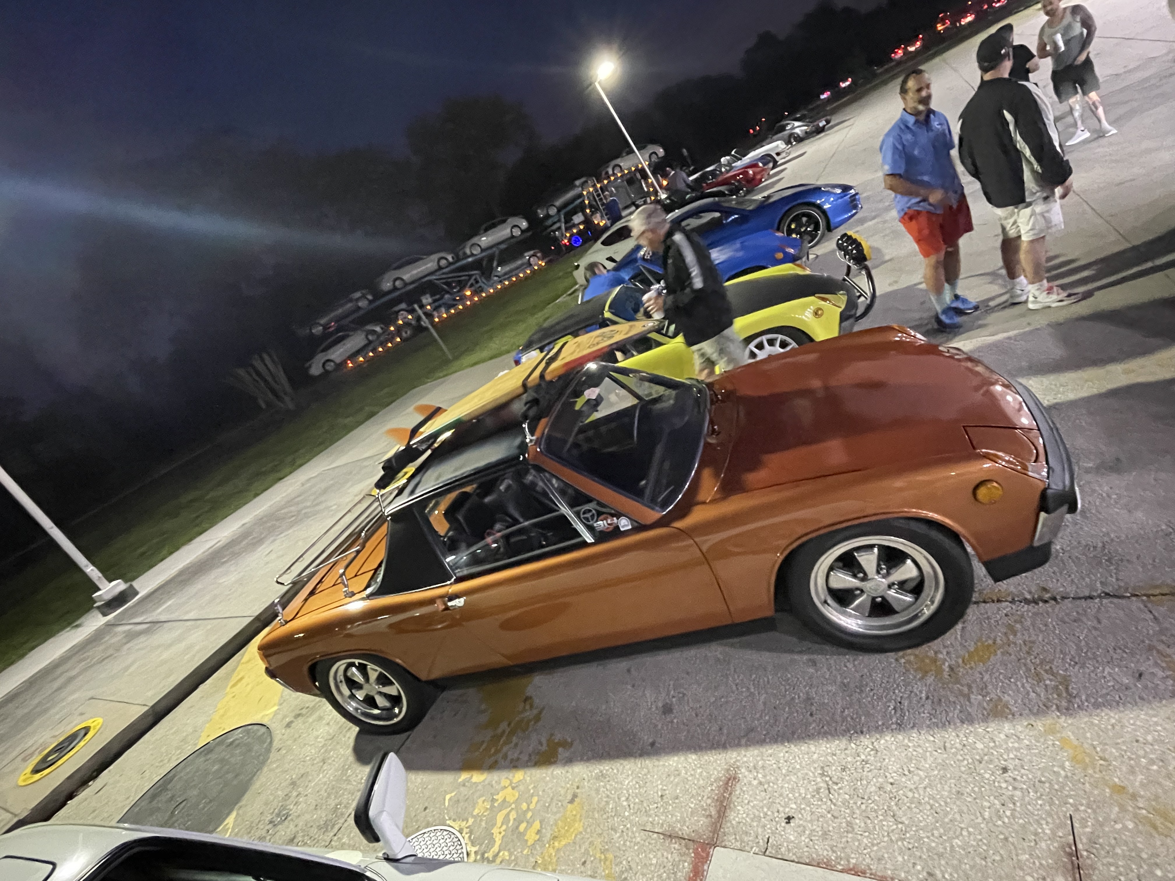

update to the thread as i try and keep some recent or current happenings to document the ongoing saga of 914 ownership!

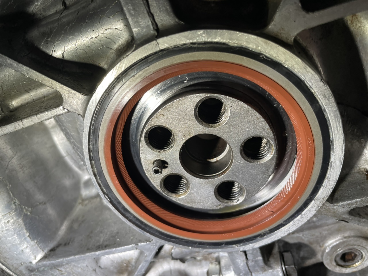

since last november the Motor had to comeback out to again take care of a RMS leak, and having now driven it 500 miles since and been to Werks Reunion this month, so far so good so cheers to Ehrling RMS seals boo to VR,
Great trip met Magnus Walker etc

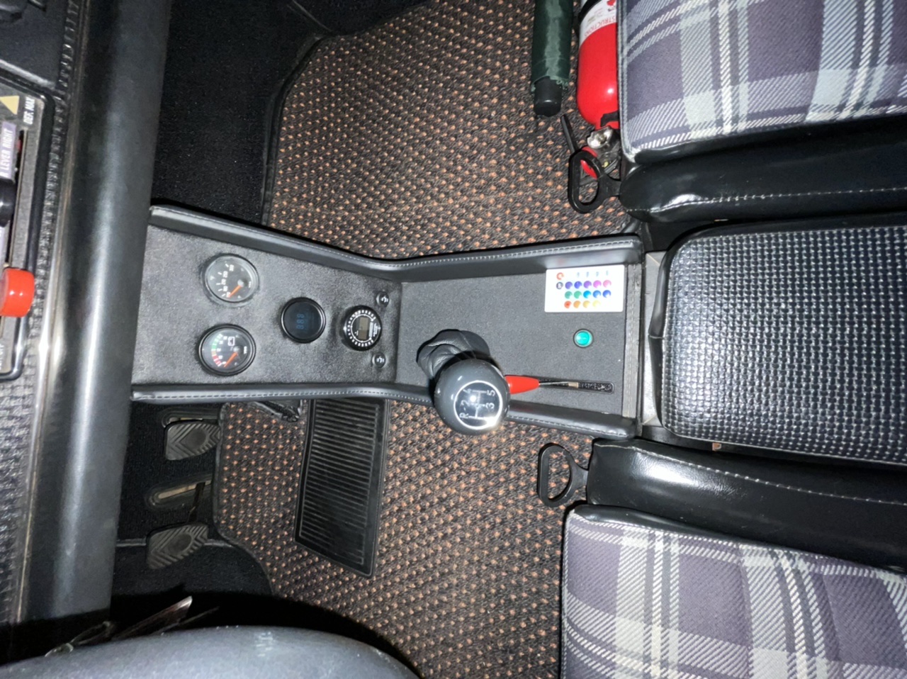

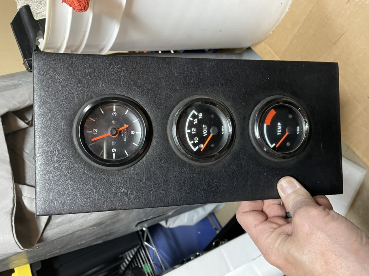

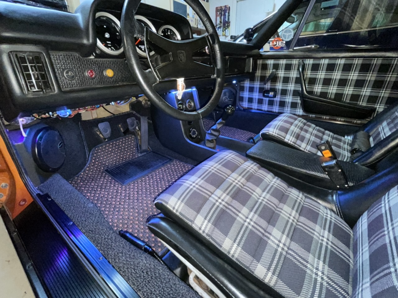

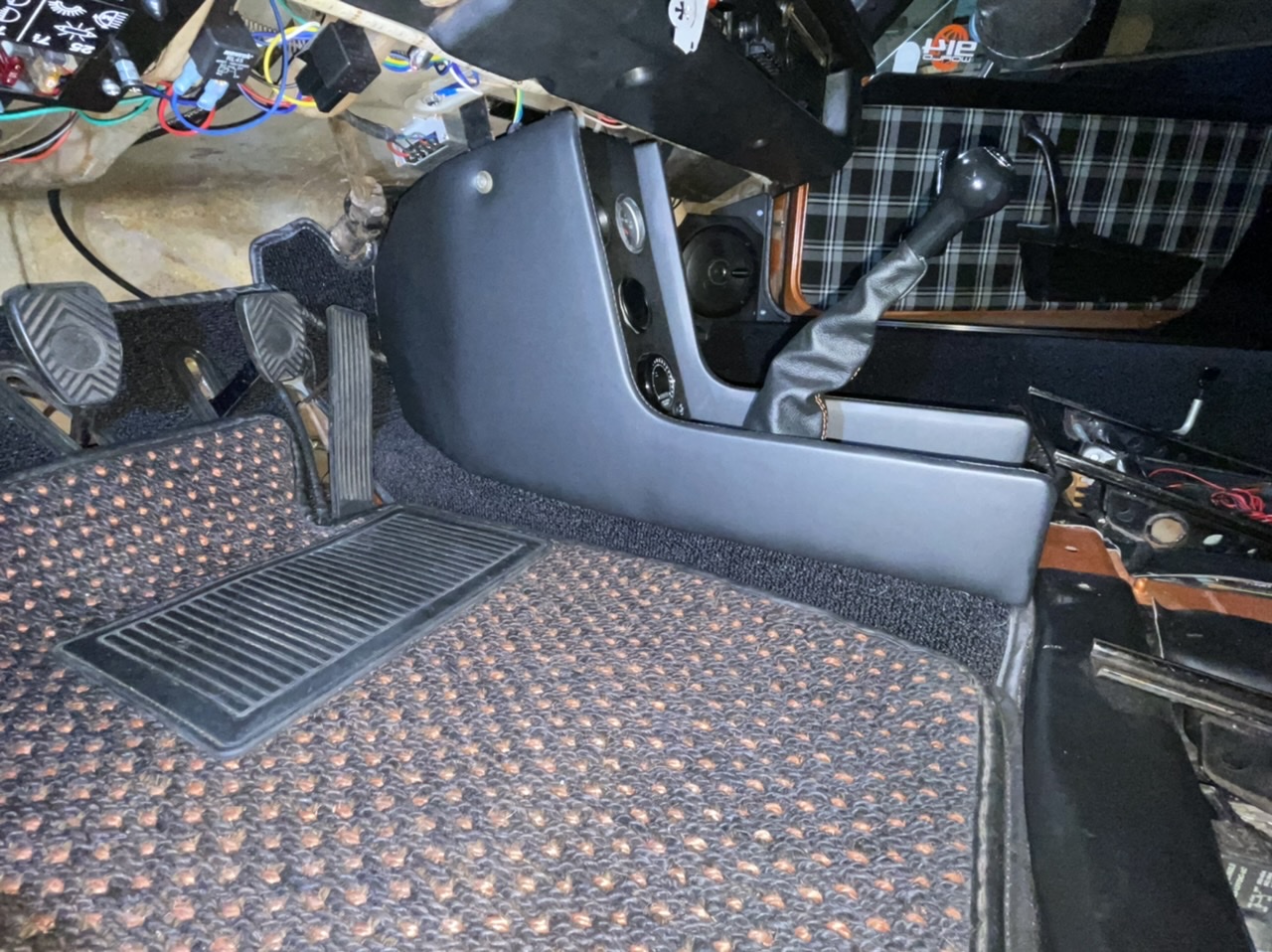

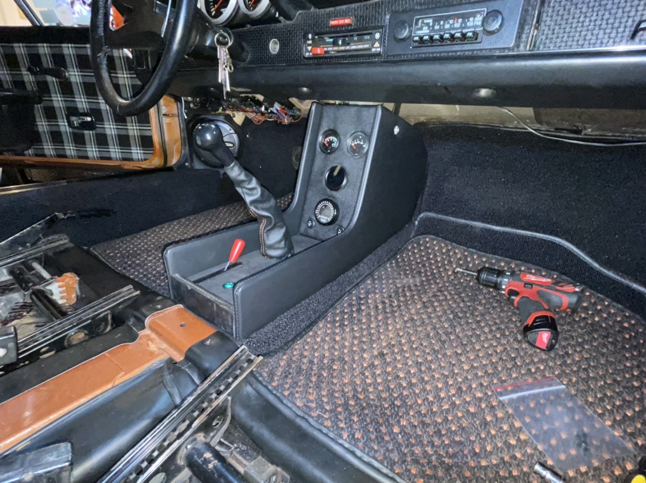

New additions to the car recently is a new to me OEM center console! the original one had been removed by a previous owner, and Roch from 914werke.com out west passes this on to me and it’s now in my car so the aftermarket repro one is gone!
also coming this week are new A-pillar trims from 914rubber and aalso new lower outer rocker panels in aluminum, from a 914 member here, so more pictures to come, but while motor was out it got new fuel lines, injectors, ans RMS with new purse rod tube seal and the motor got detailed and cleaned currently reads 11,200 miles so that is since the repaint ans body work almost 4 years ago, and 2500 since new motor build 2 years ago.
Attached Image Attached Image Attached Image Attached Image Attached Image Attached Image Attached Image Attached Image

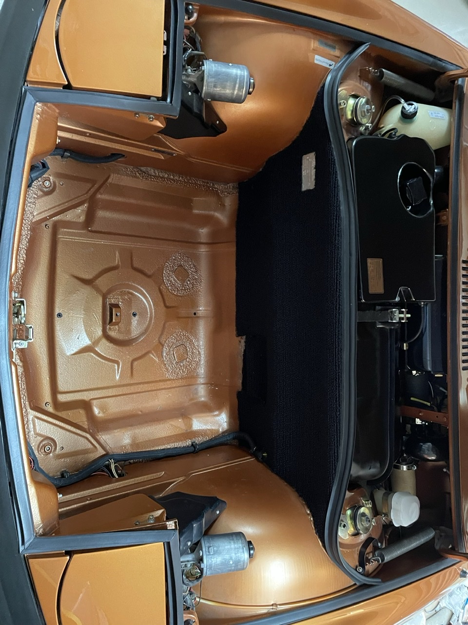

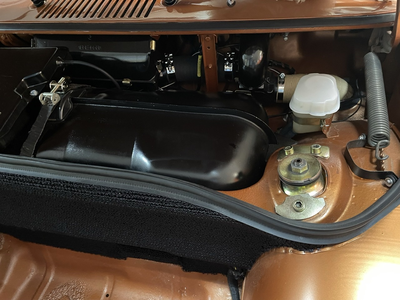

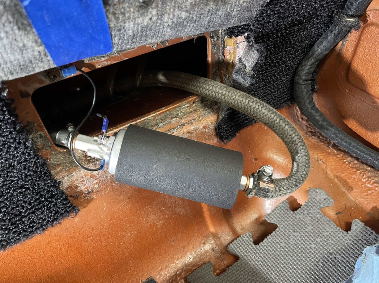

also had to install new fuel pump, old ones was probably 14 years old and the check valve in it was failing.
new pump, all cleaned up.

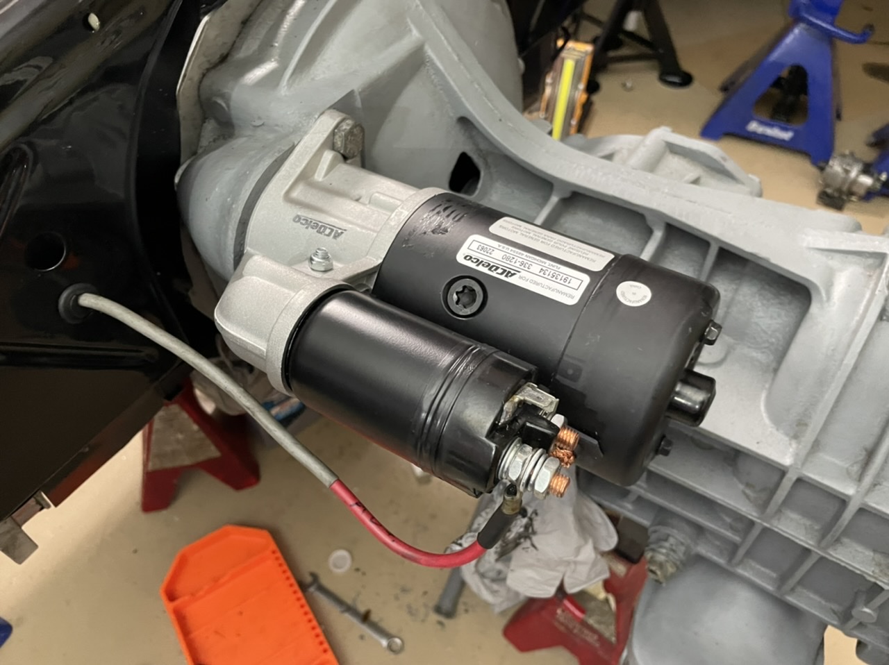

and new starter

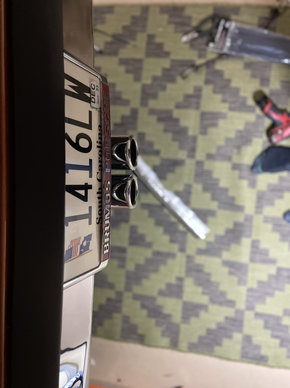

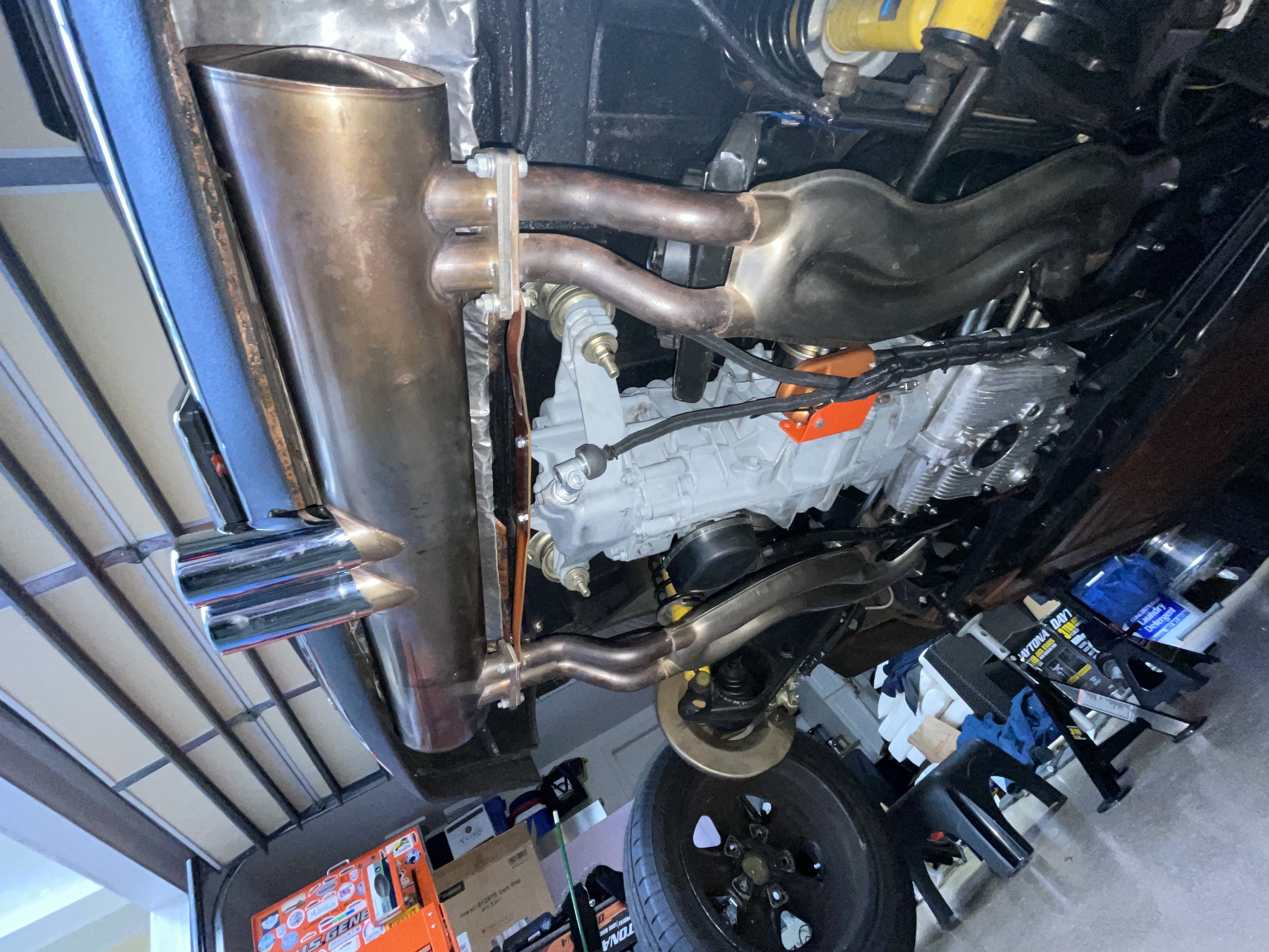

i also shortened the tailpipes about 1.5”, they stuck out further than i thought looked good.
looks good with a couple new pieces of freshly painted tin,

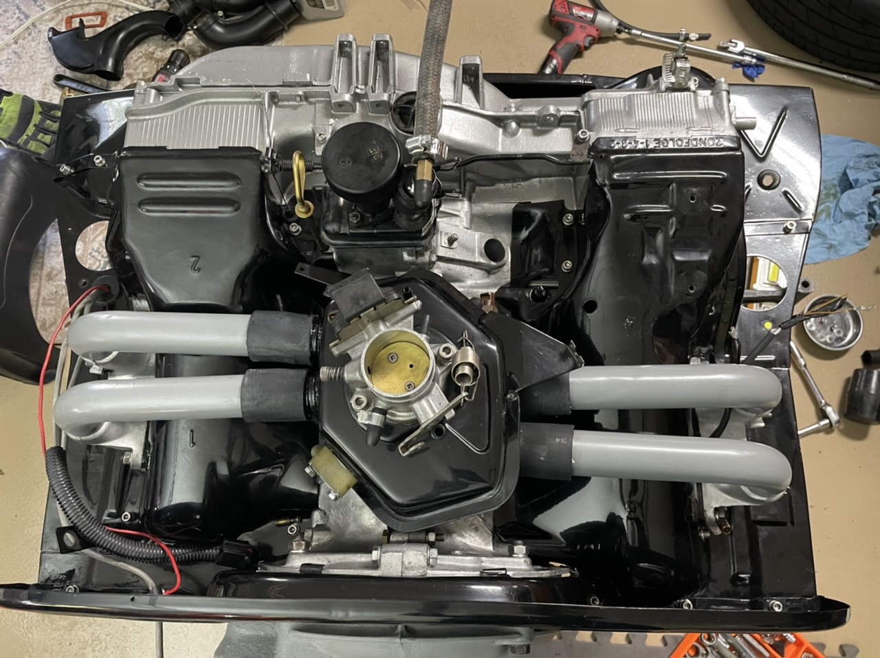

forgot to mention as well new intake runners and hoses and seals the other intake runners were not stock color , i had several sets ans recently got these from Bruce Stone,

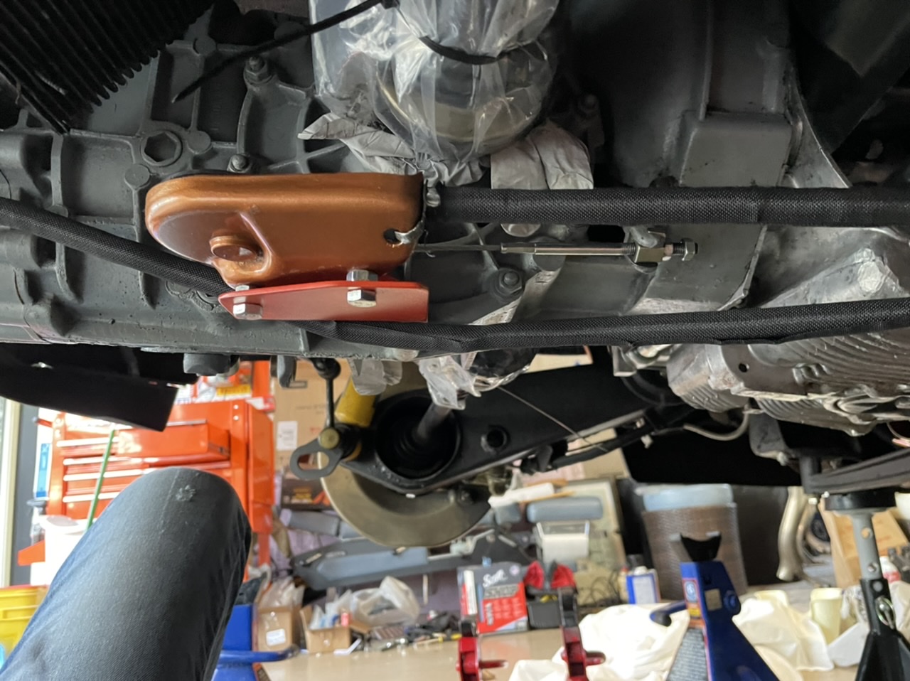

the new clutch cable adaptor from Tangerine Racing is nice , now it’s not lower than the rear of the motor.

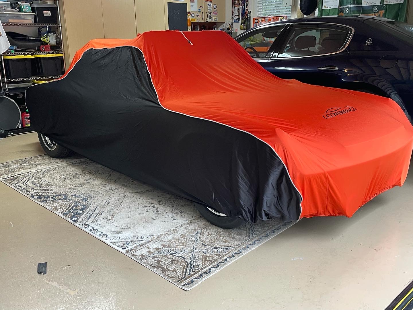

i do like my cover king car cover..

- also new shift knob and new leather shift boot- i really should make anew list for 2022-2023 , but thats why i post it here to help remind myselft whats been done and when.

Dr Phil - Very nice work. Your car looks terrific. I really like the new tailpipe length- looks great. (IMG:style_emoticons/default/beerchug.gif)

update: i am very happy to report my RMS is not leaking now, 2 months of driving following replacement. unfortunately somehow i didn’t get the left side rocker cover to seal well so it’s dripping on the heat exchanger on left side- SO i got new gaskets, ans will pull that this weekend and will use a gasket sealer i think maybe the cover might have distortion or warping not sure. that bottom edge has done that before, last time i had this issue too and it took a second try to get properly sealed. i am hoping that’s all it is and not a push rod tube again , i went thru a lot in february to pull so all new seals on those! other than that the motor is running great! problem is every time i want to get it out we have a major storm front come thru.

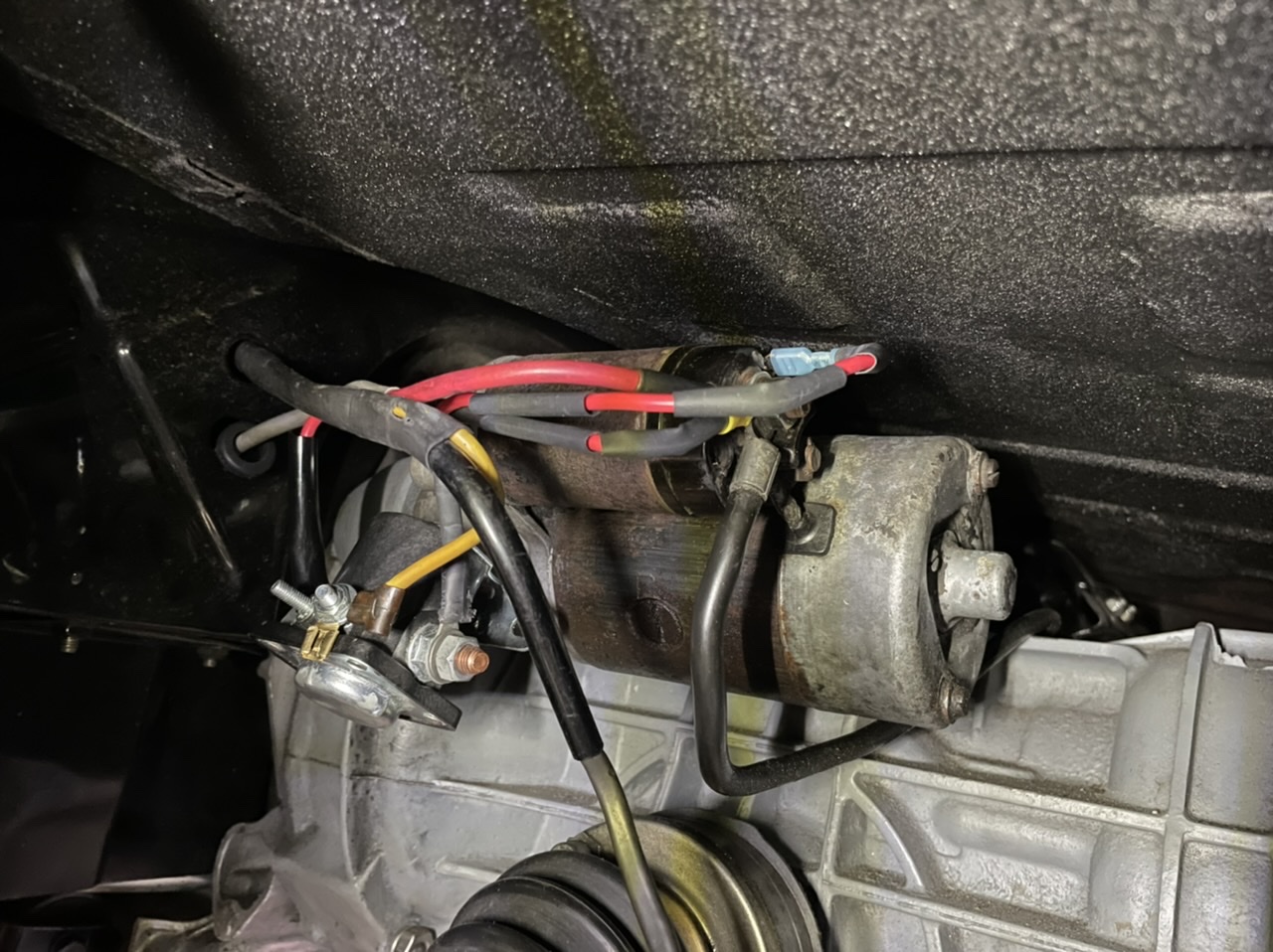

Oh sh!t moment last night! while installing my starter tray/ford solenoid i was cleaning up and checking stuff. never ever have i had a cv bold back out, i used new schnor washers, torqued to spec but here we are, a very close call! these will get driven on a day and then rechecked and then safety wired before Okteenerfest trip , that was a close call!!

Ford Solenoid install-
look at post 446, you see there is a new starter, that got pulled the solenoid failed, in fact 2 of them in 6 months, so the old reliable went back in, and is now in the car as picutured but, i also want to clean up the wire connections specifically the red ones at the + post, these are looking a bit worn and could be an issue with getting the voltage needed as well, but so far with old reliable no issues now, but just in case, adding this ford solenoid as well.
